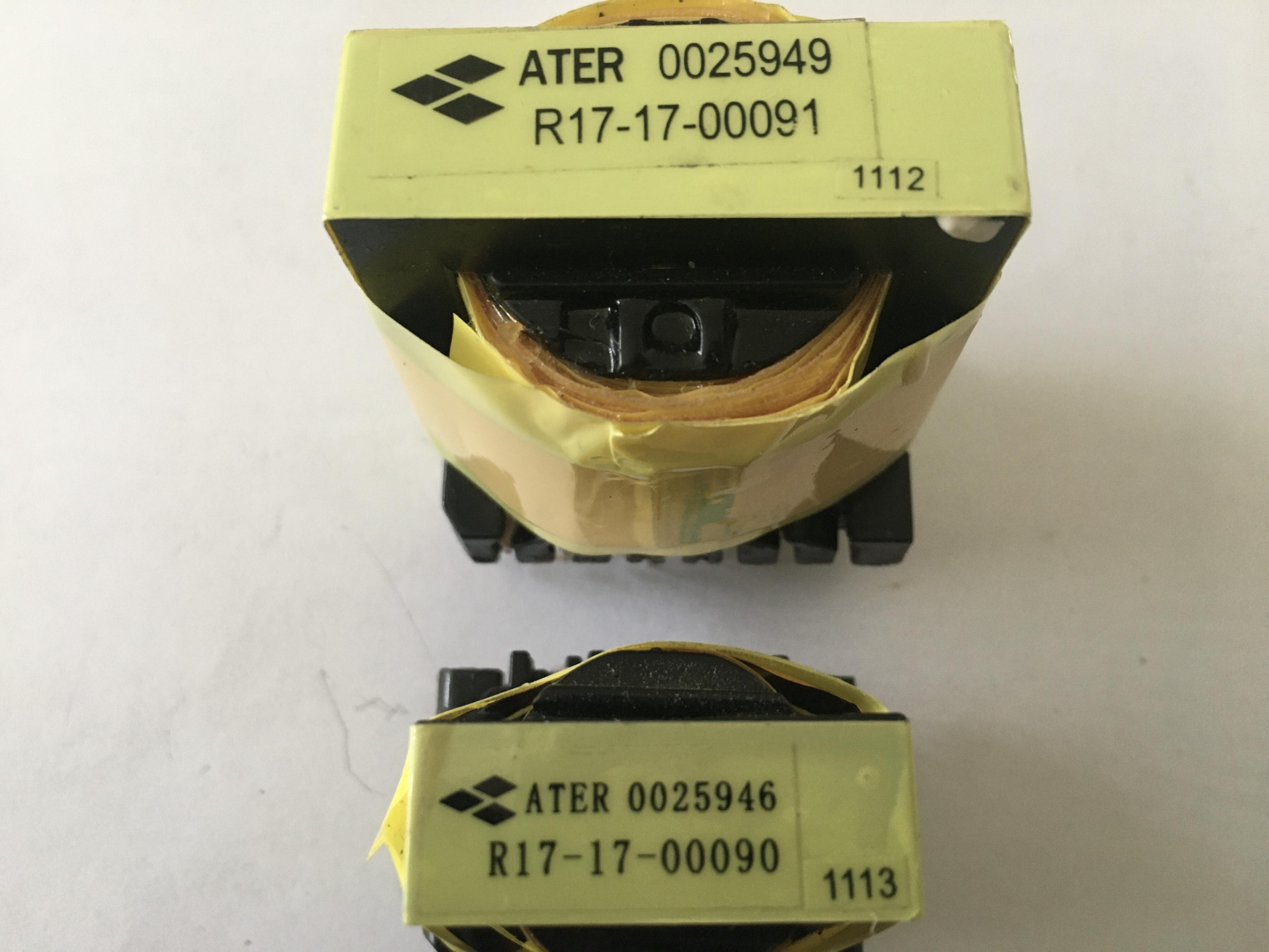

Does anyone have information on the following transformers?
They are both out of a blown Mackie SRM1801 smps. ATAR 25949 andATAR 0025946.
Any information regarding secondary output voltages would be appreciated. Availability and/or a supplier or suitable alternative would also be appreciated.
Pics are attached.
Thank you.
If they came from an SMPS, you pretty much need to find the exact thing. They are not working at mains frequencies, and won't have standard 240 to 12v ratios or such. Yours may be faulty, but in my experience, those small transformers very rarely fail. What have you determined is wrong with them? They will have naturally low resistances in the windings
I don't know which is which here, but typically one or both may provide power supply voltages, but they won't be driven by sine waves nor from mains levels. In many SMPS though the transformer may be a driver, a switching circuit pulses the transformer which in turn drives the gates of MOSFETs or other switching transistors.
Get the schematics from Mackie. I just checked their web site, the SRM1801 is available for download. T2 is a driver type. T1 is the output. But I find way more common in SMPS are shorted rectifiers on the secondary side. And of course shorted driver switching transistors. Sometimes failed controller ICs. At the mains input stage, thoe thermistors ccan open.
If you are not familiar with SMPS service, STOP, read up on it. They can be very dangerous. They rectify and filter the mains directly. And on the primary side, all those circuits have a "ground" or common that is NOT EARTH. Note the ground symbols for that section all have the little sine wave inside. Those sit at about -170vDC with respect to earth. Connect a scope grund there and you will blow somethin gup.

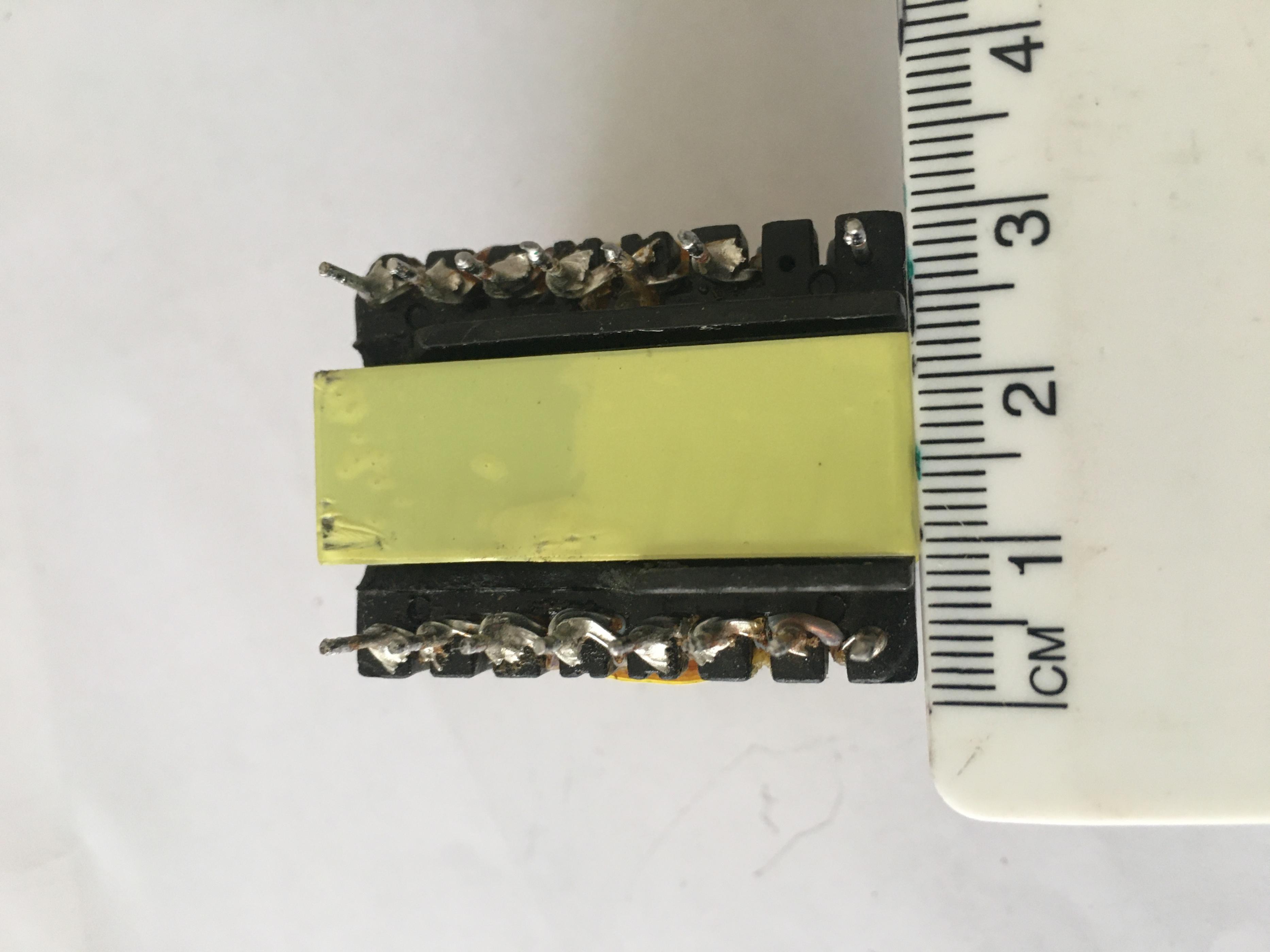

Is it normal for these transformers to measure OL across the poles?
Specifically , which poles ? (primary ? secondary ? which precise pins?)
PS: Often times the connection between the two primaries (refering to T1) is done on board , so for example if you pull T1 off the board and measure across (1,2) and (5,6) you will see O/C
PPS: Often times there are also dummy pins added for physical security
Sorry about the ambiguous nature of my question.
On the ATER 0025949 (see attached pic)
With the tx oriented as per attached pic:
On the bottom row of pins from left to right I get continuity on
pins 1 and 3, pins 1 and 5,
pins 2 and 4, pins 2 and 6,
pins 3 and 5,
pins 5 and 7
On the upper row of pins, from left to right I get connectivity between
Pins 1 and 3, pins 1 and 5.
Pins 2 and 4, pins 4 and 6
Pin 3 and 5
Hope this is helpful, I am unable to source a data sheet to be more specific.
If the above test proves helpful, I will repeat on the AT 0025946
Thank you MikePP

I hope you noted which orientation the TX was in when you removed.... ?😱
(and which was which)
They usually have an index pin arrangement to avoid you putting it in back to front.
But from the photo I can't tell which is primary, nor secondary 😕
The circuit diagram is very clear re pin numbers, you should be able to translate to the part in front of you and where to expect a continuity**
(** ok, it's a low impedance winding not continuity exactly)

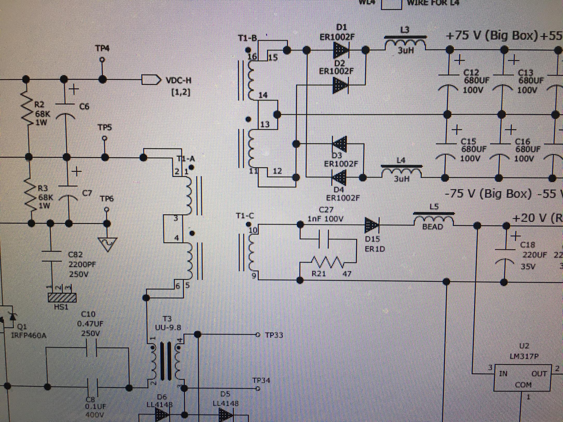

I managed to identify pin 1 from the following:
1j the schematic indicates pin 1 connected to TP5 - flipping the board over indicates it is the lower left pin. when viewed from the top.
2) The pin on the tx has the plastic clipped off the corner- visible in the pics!
With reference to the test pics, Pin 1 is the first pin top left row.
Off you go then 😛 - you've got everything you need, confirm all the windings are present/intact
As per schematic attached,I tested 00259349 Tx and it appears to be good. Since tx is off the pcb i had to test the inductor Pins 1 and 2, 3 and 4 at (TP33 and TP34).
Thanks all!
With the help of a more experienced diyaudio member, I managed to trace the problem to the failed KA3525A PWM.
Once the chip was replaced all voltages were present as per the schematic.
For the benefit of anyone interested, I have attached the schematic to illustrate the role and location of the KA3525A PWM in the circuit.
PLEASE HEED WARNINGS ISSUED BY OTHER MEMBERS IN PREVIOUS POSTS!
SMPS ARE DANGEROUS - AS IS ALL WORK WITH ELECTRICITY!
