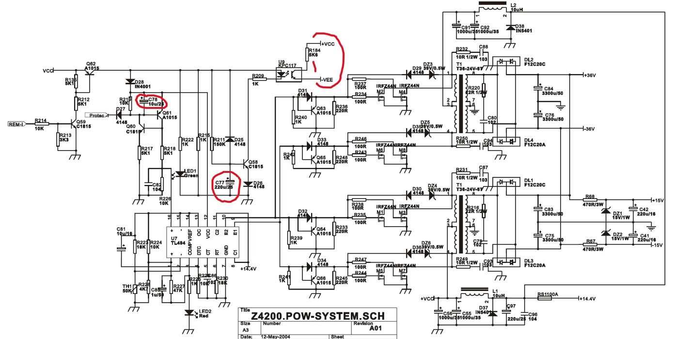

I'm new here so I hope I'm posting this in the right place. I have a MacAudio Car audio amplifier z4100 which I'm trying to fix.
It seams I have high voltage coming from Protect signal to TL494 IC controller , turning the overload red led ON. There isn't audio at any of the outputs.
There are some set of transistors (C5198 & A1941 pairs) getting extremelly hot together with their 5W ceramic resistance. (mainly Channel 3 and 4)
I uploaded some Schematics thet I found of z4200 model which is quite similar. The marks in red were not done by me. So, it doesn't refer to my problem.
Any help will be appreciated!
Thanks!
