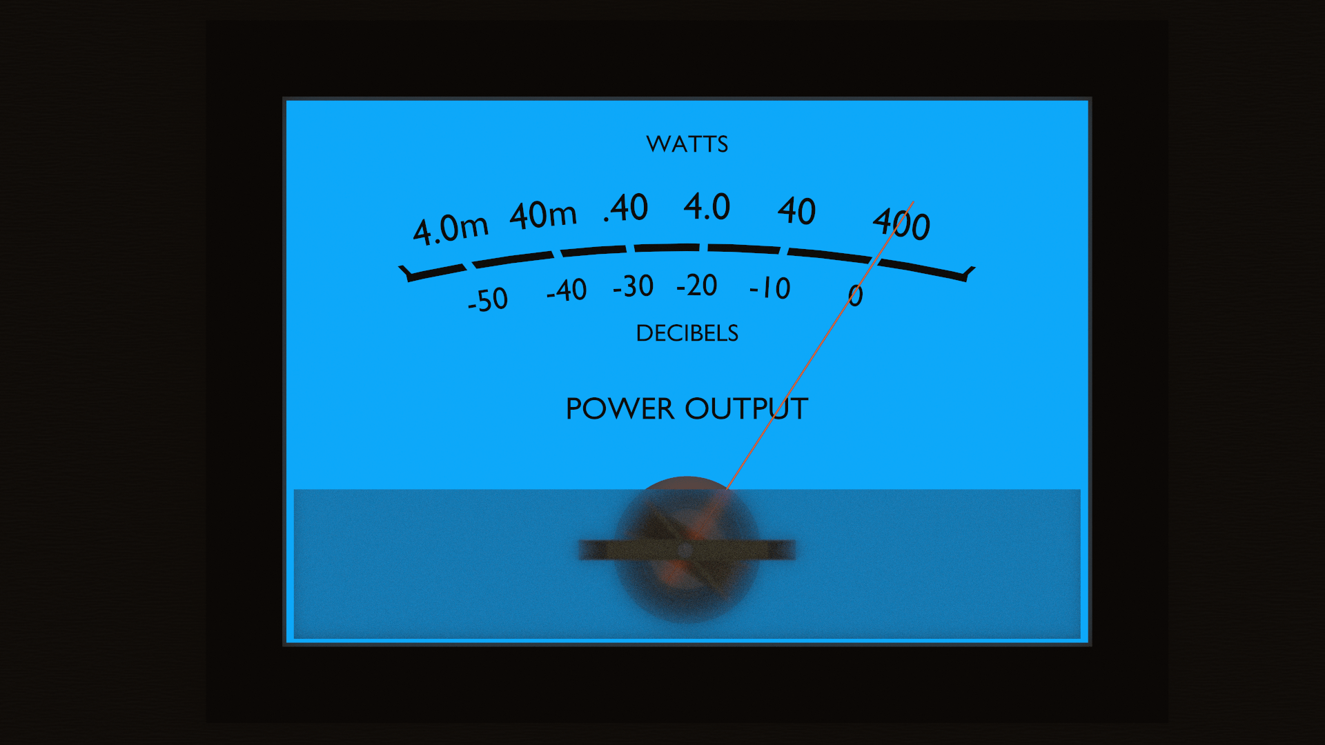

Two 40" You have to have left and right. This was the model. The speed should be just about real time with a fast graphics card.

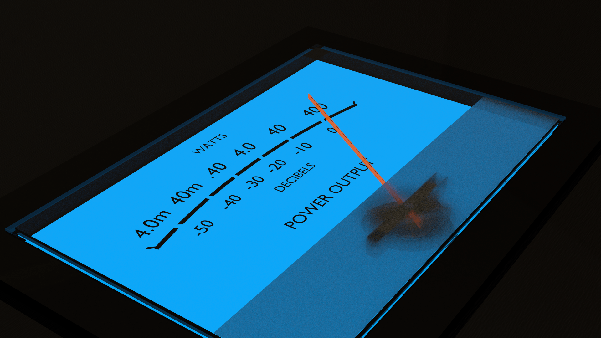

You're seeing the depth of it. It's narrow when viewed from the front.
I've done a lot of useless things in life. This would have been just another. It would have been just to amuse myself.
