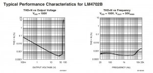

Then why don't we make lm4702 and LME49810.

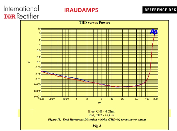

IRAUDAMP5 ,IRAUDAMP7S
They have lower distortion. Greater power. 100-500W 8R
Thd is very low. 0.0003-0.005%
In addition, you need to understand. Chip index is not equal to circuit board index.
Generally, circuit board indicators such as iraudamp7s are indicators of actual use.

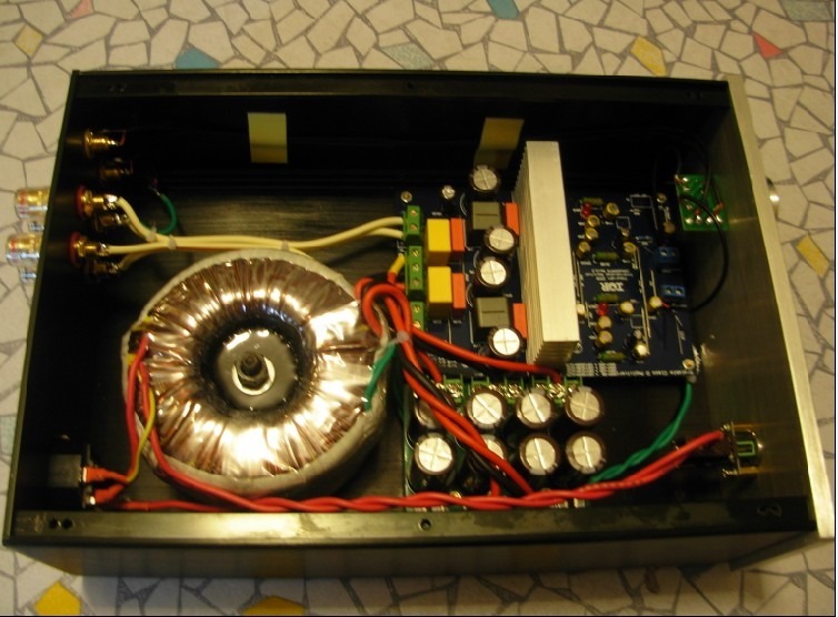

Then compare it. I have an lm4702bta+ tta1943 5200x4
There is also an iraudamp7s. I often listen to these two machines.

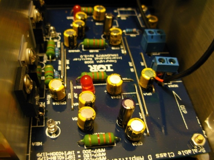

Ar least 3 times I pointed out that caps could be 1210 size X7R 50V or film. They seem to be key factor for better performance.
Film input caps (direct inprovement over ceramic caps), onboard linear regulator, good output filtering etc. It seems making things cheap is deep in your system as no one asks you to make it cheap.
Your own board has the small inferior caps so what do you want to express?
Capacitance is just one aspect of what I said.Ar least 3 times I pointed out that caps could be 1210 size X7R 50V or film. They seem to be key factor for better performance.

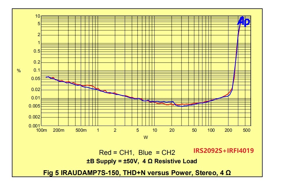

But please don't say it's the best amplifier. Whether distortion thd, power. Or current output capability. More than 10 years ago, the irs2092s or analog lm4702 was many times better than it.

If you must use class D. The scheme of irs2092s + irfi4019 can be considered. Many businesses sell this solution very cheaply. Great power, excellent performance.

I feel sorry. Because I have used a lot of 06030805 capacitors.If I would have some time!
I like this chip.
With some additions, like FE, corrections regarding type of coupling/filtering caps and other thing, could be a nice module.
PS: it´s absolute wrong to say 0603 or 0805 ceramic caps are bad, or would died rapidely. Sure, I don´t know where you´re buying crap.
Deux centimes,
JP
There is a lot of damage. If you are interested, you can follow my l20se amplifier link.
Many people are damaged because of 106 ceramic capacitors. Finally, I changed the capacitor. 50V 10uF BP electrolytic capacitor is used. Let me have a lot of trouble.
