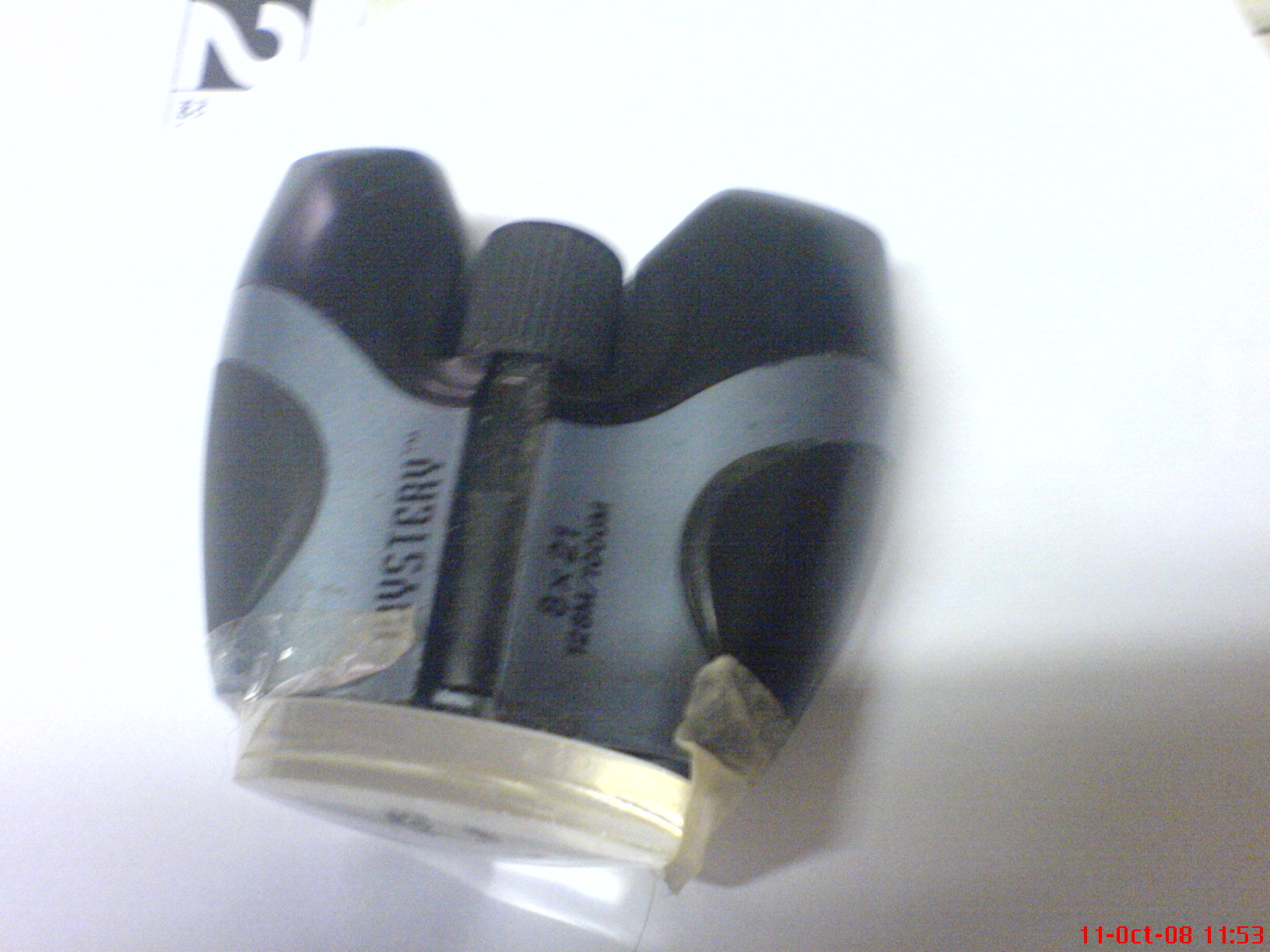

Hey Zero Cool
See here.cheap porro Bins + 50mm lens
Regards Max
