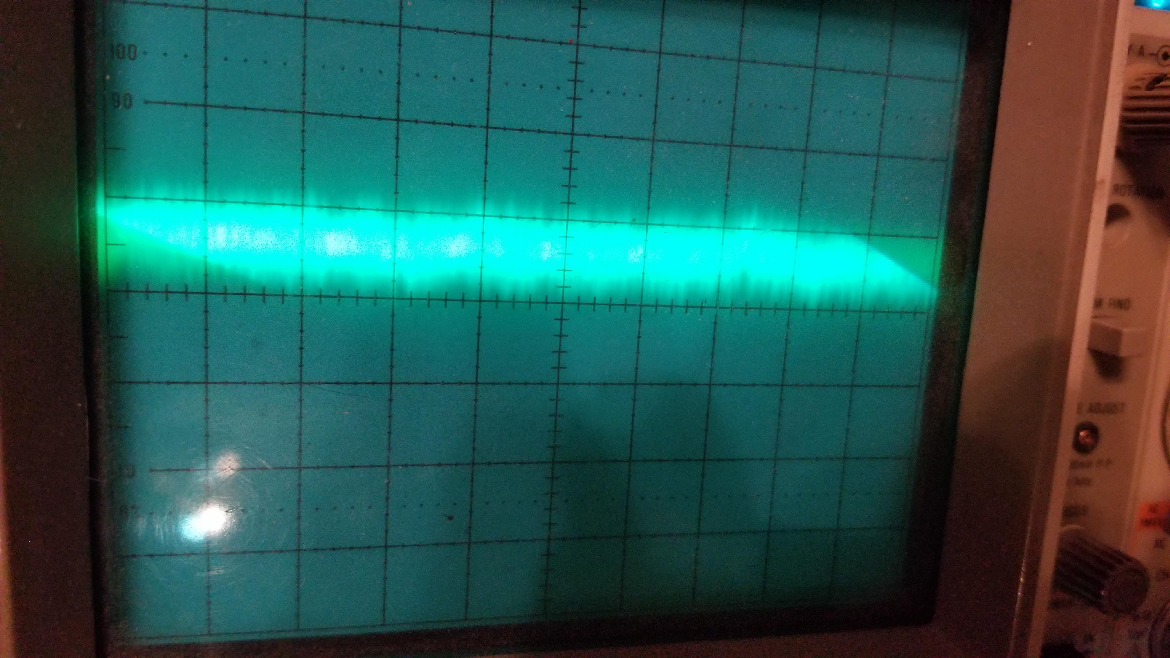

Now, when you look at the sine wave output with your 'scope, what does it look like? Can you attach a picture of the screen?

There is no place for me to attach any images. On the scope nothing looks any different on the left channel than it does on the good channel at any setting. The only time there is a difference is when there is actual audio. Sorry. Thanks again for your help.
Terry
Lets see what happens with this attached image.
This is the image I got with the scope set to the lowest voltage possible. The other channel has the exact same pattern. the noise is only present when I am actually playing audio and as I said only on the left channel. Another observation I made; I ran a 1khz signal through both channels and turned the input up until I reached 100 watts output on the vu meter for the good channel. The bad channel(left) only shows about 80 watts. Doubt this is much of a clue to anything but thought I would throw that in.
