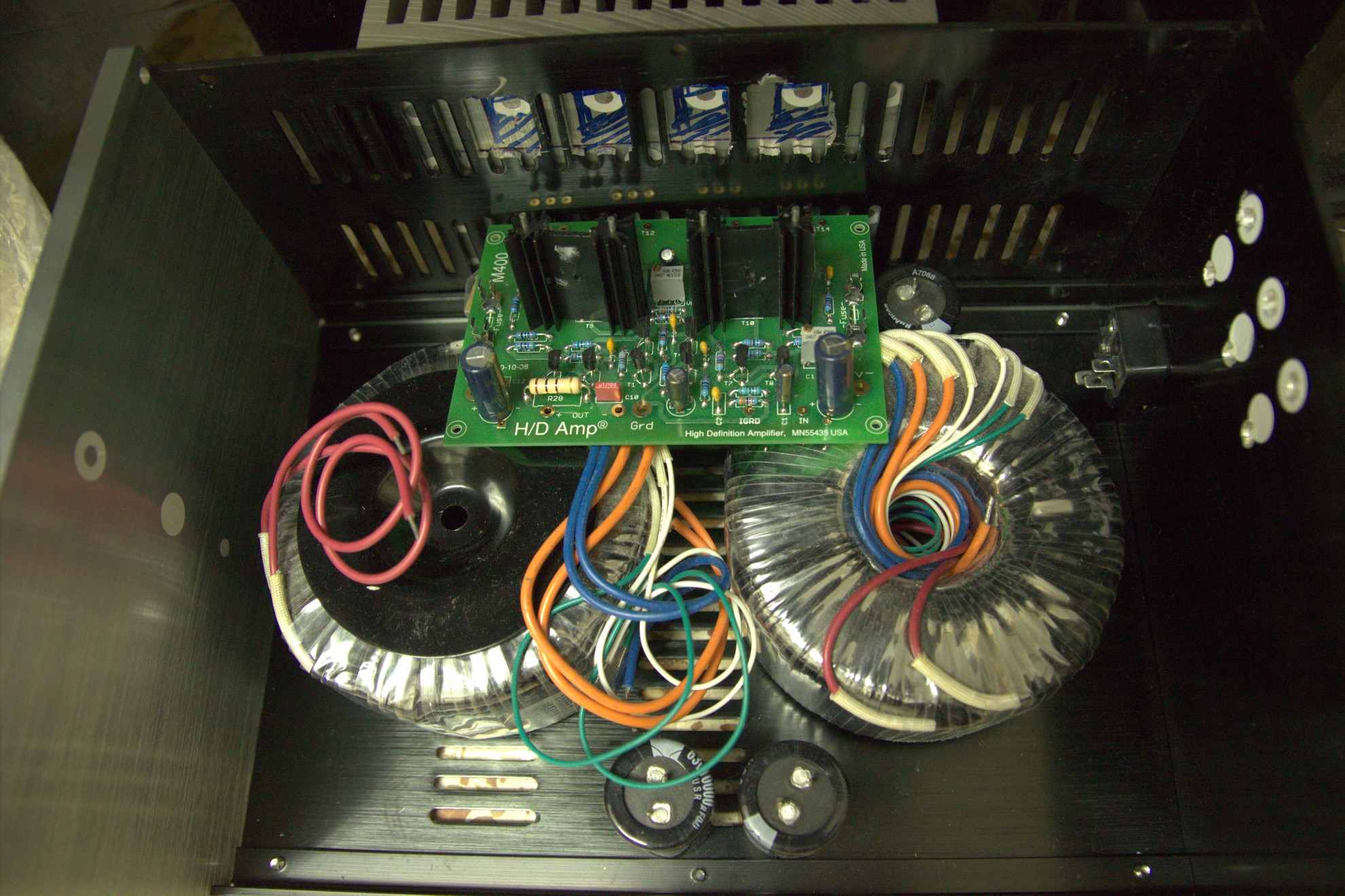

Would it be ok to change the orientation of the main mosfets? I want to attach them to the heatsink horizontal on the up side of the amp case? Will it affect the sound? I'm trying to make the amp compact which limits the ways I could place the components.
yes u can do this
You absolutely cannot lay a power heatsink flat without forced air (fan) and expect it to cool effectively. Finned heatsinks reguire vertical arrangement for the heated air to rise naturally, flowing unimpeded up the line of the fins, otherwise, the reduction in dissipation can be as much as 80% of the heatsink's design rating.

Thank you for your detailed explanation, Ian, you saved me a lot of future headache and melted mosfets. The heatsinks I have are of dimensions which will make a far from compact amp size since they're 20cm high or so (instead of wide and short, this is the only one which the store had in stock). I'm thinking about position them vertically inside a "perforated" case and using a big and very slow fan to circulate air through them.
I hope you plan to obtain the correct size of heatsink to suit your amplifier. We have discussed this previously but I will make a suggestion for size, if you aren't aware or are simply copying the kit PCB without having its specifications.
First, don't be limited by what you can buy locally. The sizes you linked to previously were for low power, perhaps class D chipamps but you have 2 x 200W class AB Mosfet amplifiers to cool, in a warm climate. These make serious heat and those toy heatsinks just won't work, even with fans running fast.
I estimate that each amplifier will require a heatsink of better (less) than approximately 0.5degrees K/Watt). For a 2U rack case heatsink height of ~80mm, that is a heatsink 45 mm deep x 250 wide minimum. You need 2 of those for convection cooling. Here is an illustration of economical local products. The type MF25-75 is probably a good type, bearing in mind that: wide spaced fins (say 10mm pitch) + low and wide sinks are more efficient than tall and narrow forms for convection cooling: http://www.conradheatsinks.com/products/

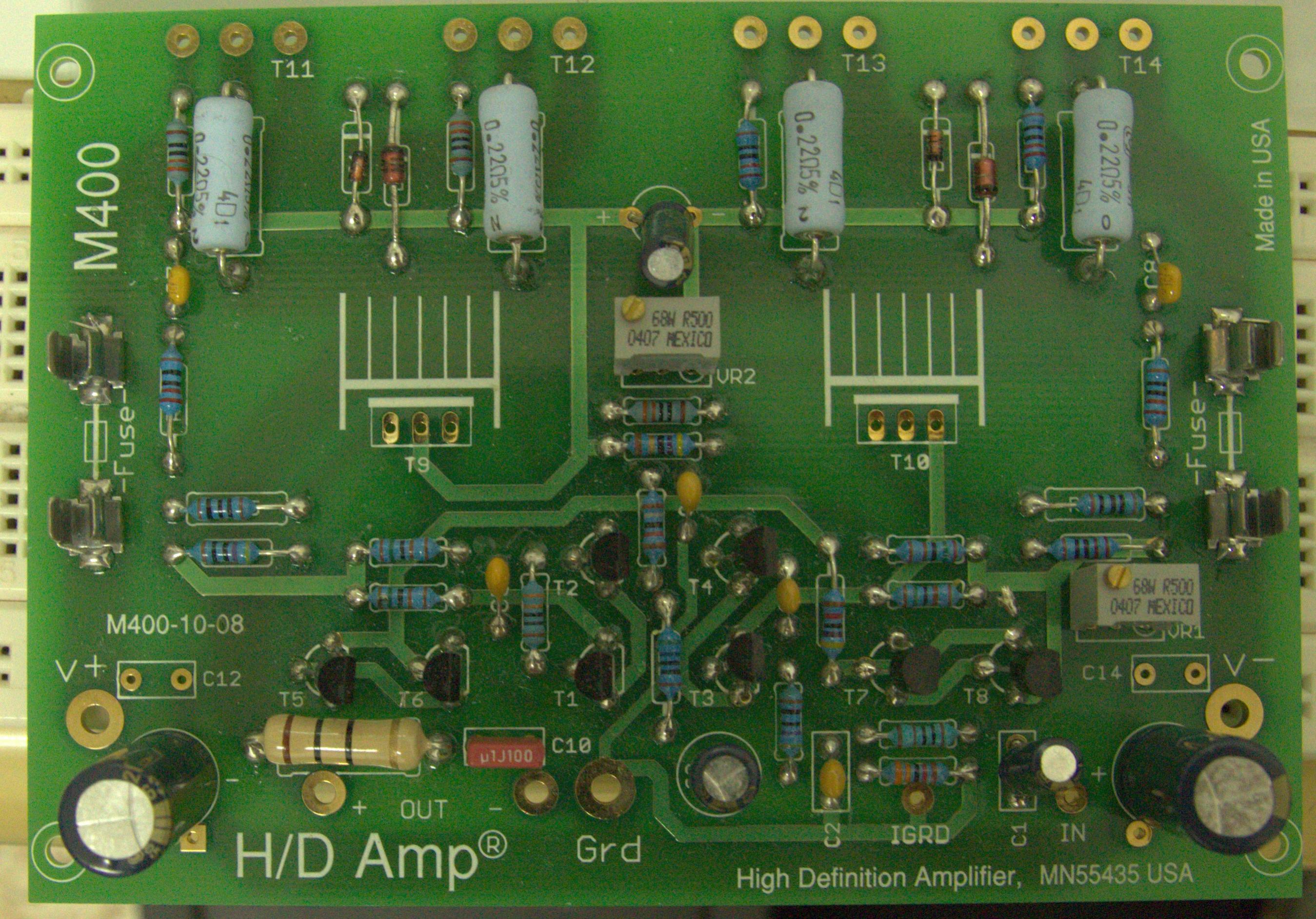

This is a little embarrassing, but could someone who built it know where these parts go on the PCB? The small transistors K1058, J162, and high wattage transistors 2 x c2911, and 2 x a1209 go on slots numbered 9 to 14.
The domain I ordered it from is down(http://www.hdamp.com/M400.html) and I have no documentation for it.

Thank you for the suggestion! I can see in the photo the mosfet location on the board, T11-T12 are the K1058, T13-T14 are the J162, but I still don't know where the A1209 and C2911 go (T9 and T10 left).
If someone could tell from the parts, I'll try to make a schematic from the parts to "reverse engineer" the circuit.

I went over through my pm's and looks like the T11-T14 are to be insulated from the heatsink (for some reason). T9 is the 1209 component, T10 is 2911.
Doing a build with no publicly available documentation has its downsides...

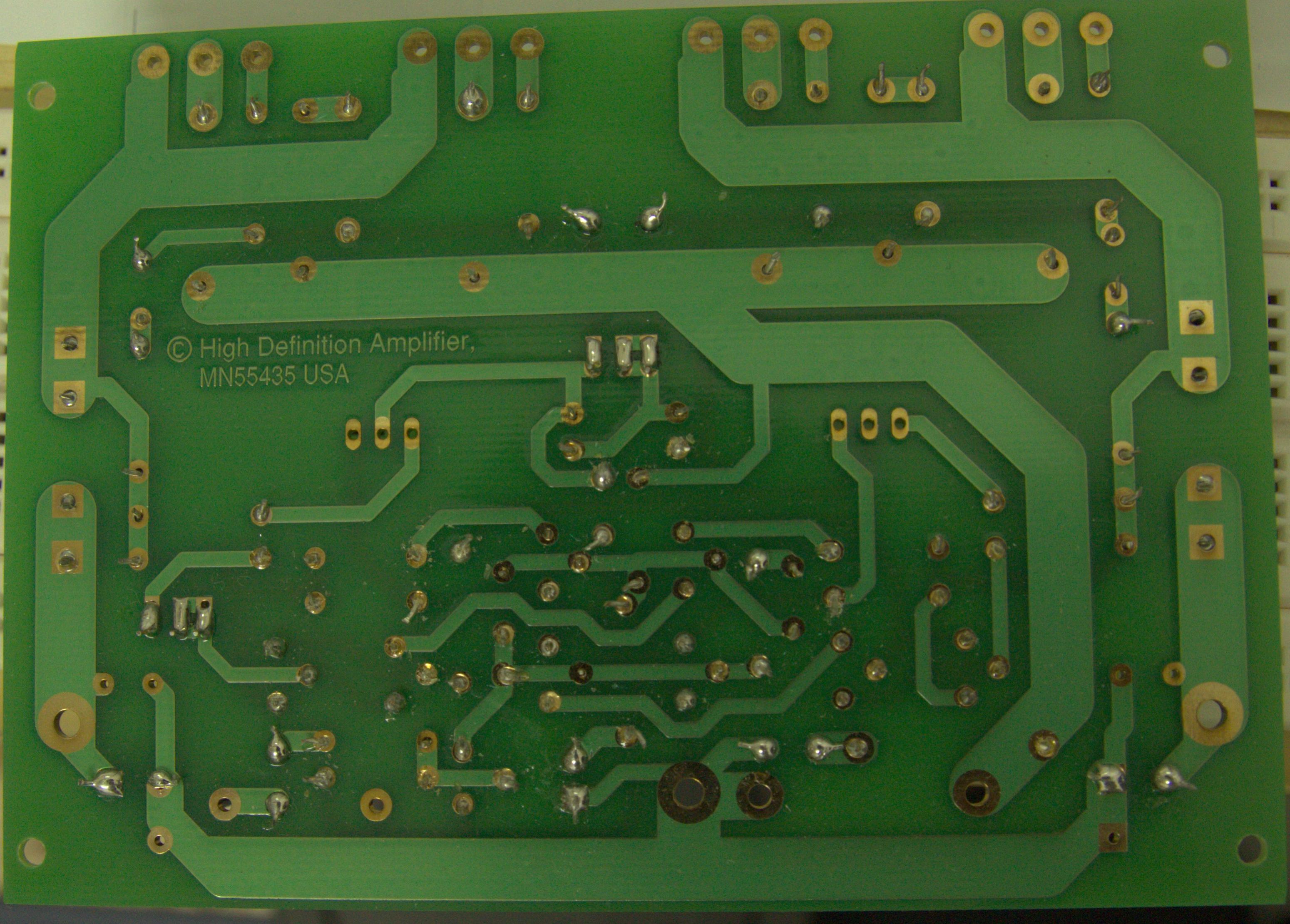

Someone asked me for images of the board. I don't have the part list so if someone has it, please share it as it could help other builders, which is what this community is about:
This is roughly the chassis arrangement I'm planning, and it's going to be crowded. Hopefully there'll be no interference due to the short distances between some parts.

Now there's only piece of information required to complete it. Does anybody know which voltages the variable resistors VR1 and VR2 should be tuned for?

Just discovered this a year later .. VR1 is used to set dc offset to zero at the output.
Vr2 is for setting the operating current of the output mosfet , I set it to 20mv across
the big resistor. This board is very well designed, I listened to it every day the last 5 yrs.
With a simple 20k pot, it sounded more alive than my other Yamaha A2100.
