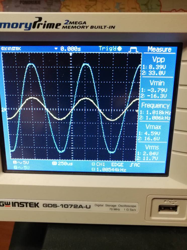

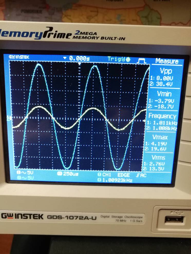

Having a free moment, I tried to check the amplifier with the oscilloscope. I checked the gain, power and frequency characteristics as far as I can operate the oscilloscope and generator.
I did this using dummy load 4 and 8R. Everything looks ok except for a square signal test at 4R. At an amplitude of 8 Vpp, the triangle and sine are at the clipping limit. The square signal causes a squeak inside, the amplifier and speaker protection turns off the output for a while - then there is silence. There is a sequence of protection operation - on / off. I can't see anything specific on the oscilloscope.
I am asking for help and advice or should I worry about it?
Does the amplifier still work?

All I do is my first time so I already have many mistakes behind me. I thought that since sine and triangle do not distort the amplifier at amplitude 8Vpp, so will the rectangle. Hope I didn't destroy anything.
Pictures are with 4R load. Second, when DC protect board is off.

Looking at your oscilloscope shot, the output Vrms=15.9V at 4R, which is 4.0A! P=63W. 😱

8Vpp is a 1W at 8 ohms, how could it be near clipping? What is the diference between 4 and 8 ohms load? That dosn't suond right..

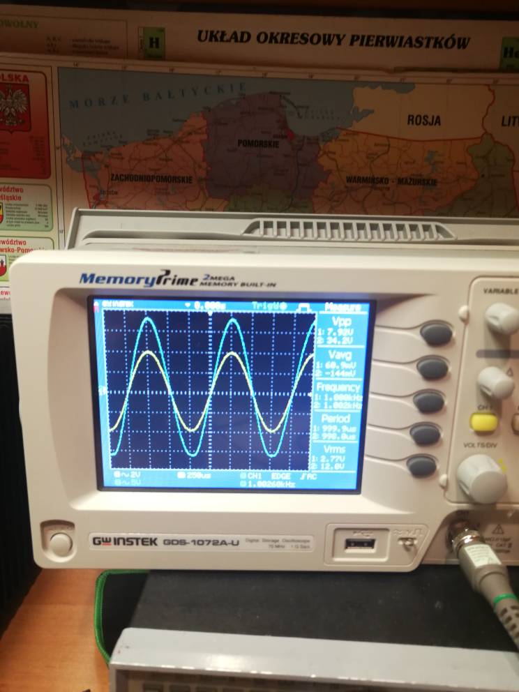

However, there is a problem. Under load 4R, one channel has both sine and triangle signals distorts on the oscilloscope. The second channel cuts the tops asymmetrically. Additionally, the bias floats when adjusting the amplitude. Apart from replacing the 0.47R resistors, I have no idea what to check
Correct me if I'm wrong. Isn't the M2X a balanced design with a bridge output ? In the pic of the first post I see the scope probe ground clipped to one side of the dummy load resistor. If the scope is grounded as it should be, that would certainly trip any speaker protection.

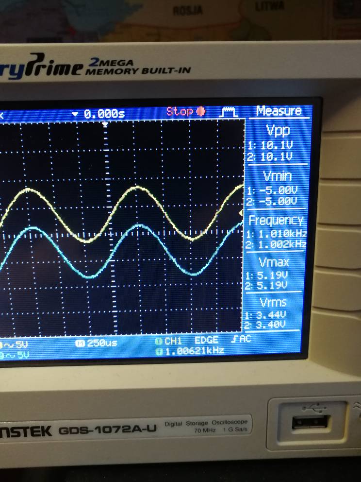

I replaced the resistors. This is what the signals on both channels look like. The powers measured at 8 and 4R are 22.8W and 32.6W.
I checked the amplifier with a sine wave from 10hz-100hz at 1Vrms at the input. With a load of 4R I hear the sound of the signal between 5-8khz from the inside of the amplifier (it modulates "quieter-louder" depending on the frequency) . At 8R it is also audible but quieter. The oscilloscope shows nothing special in this range. Should I be worried?

NO, you should stop worrying.
The amp behaves exactly as it should.
You could try to compensate for different gains of output MOSFETs (they are not complementary pair; they have different specs -> check the spec sheets), by carefully tuning the R13 and R14 resistors, but you'll be looking only at one specific parameter - slightly uneven clipping. So, stop worrying.

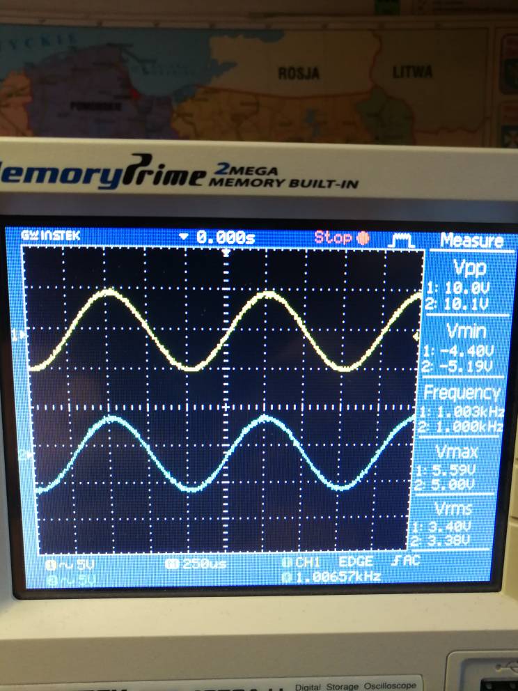

You could also see if the drive signals are of the same amplitude. For this, you do not have to drive the amp into clipping. Just measure the amplitude of signals at R8 and R9 referenced to the ground at something like few volts of RMS output. Make sure you put the probe away from the gates to prevent oscillations AND the probe is set at 1:10
If you can not stop worrying, build Aleph J which is not a push-pull design.
The output transistor swill sing when stressed the way you are stressing them; you should hear the good old TO3's ... 🙂

I also checked, as you advised, the signal on r8 and r9. This is what it looks like.
