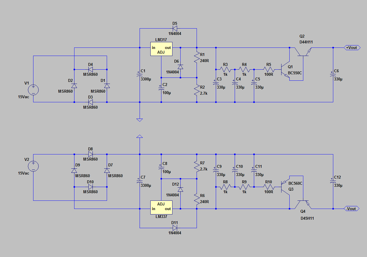

Sorry boys.
I had a terrible week on my work and I didn´t nothing on the amp.
On the PSU, I removed Q1~4 and I bridged it, removed led´s and I changed LM337/317 for other too but I have the same problem, voltaje drop to 14,80volt and -14,40volt. So I guess that I have a problem with the msr860 or maybe on the 5K trimpots that we have on R2.
This latest schematics you posted is not the same as in post#1 (Nazar shunt).
This is just a normal LM317/337 followed by a BJT cap multiplier, as used in the F5-HA.
The cap multiplier works in open loop and has some finite output impedance.
So some voltage drop is normal.
This has been proven to work in multiple examples of F5-HA using our PCBs.
So I cannot understand what your problem is.
If the output voltage is stable you can just trim out the DC offset as mentioned before.
Or just use the DC servo.
Patrick

Thanks Patrick
I confused the schemes, the last one that I have set is the correct one.
I didn´t know that the voltage drop was normal . I thought this was a problem with my PSU. I can compensate the output voltage of each rail with the trimpot but I never get to have 15 volts in the output. The maximum voltage I get is 14'80volt in the negative rail and about 15volt in the positive.
When both rails were decompensated, the offset in the amplifier was terrible
I will try to use the amplifier with B + -14,5 volt and then I will eliminate the C2.

You can also adjust the output voltage under load by adjusting the values of R2 and R7 in the power supply schematics.
Connect the PSU to the amp (without headphones).
Use a 5k trimmer, preset to ~2.7k in place of R2 and R7.
Adjust the trimmers until you get exactly 15.0V at the regulator output.
Then measure the values and replace with fixed resistors.
When this is done, then measure the output voltage of the amp with the input shorted to Gnd and C2 bypassed.
Adjust the trimmer as you have before.
Let it run for an hour and see if it is stable over time.
Easiest is still to use a DC servo.
Patrick

Thanks Patrick
Ok, Done. 2.7K in r2 and r7. 15 Volt on regulators output. (13,6 volt both rails in the Psu output).
Why measure on the regulator output and not on the PSU output? And why Fer has 15volt on the output if he uses the same PSU?
I understand that my problem has been trying to reach 15 volts on the PSU's output. For some reason, I didn´t get it on the negative rail and it caused a mismatch in the offset.
Done. Now offset is very very stable. Around 0~2mVolt all time with a soft drift (I used all parts matched)
I need to check with headphones but now it looks good.
I meant PSU output, sorry for the misunderstanding.
I have no idea.
Did you measure (match) the hfe of the transistors in the regulators ?
Patrick

I can´t find the issue of this PSU.
I use 2SC4793 (Q2), BC550 (Q1) and 2SA1837 (Q4), BC560 (Q3) like F5ha PSU too.
I need use arround 17 volt on the output regulator for measure 14volt on the out put and trafo work a bit hot (15Vac@2Amp) It´s not normal.

> I need use arround 17 volt on the output regulator for measure 14volt on the output
That is certainly not normal.
Why would it draw 2A when the bias is only 160mA ?
Also not normal.
But as I can tell they are not my PCBs, so not much I can do for you.
The regulator circuit is certainly not the cause of your problems.
> I think I'm going to forget about these plates and use a simpler PSU.
Both followers have good PSRR.
So I would just use a standard 317/337 for now if I were you.
And it is always wise to test the PSUs on their own before putting them to an amp.
You can check all the DC voltages to start with.
Your previous post :
" 15 Volt on regulators output. (13,6 volt both rails in the Psu output)."
is normal. I expect a difference of ~1.3V between regulator out and PSU out.
Patrick
