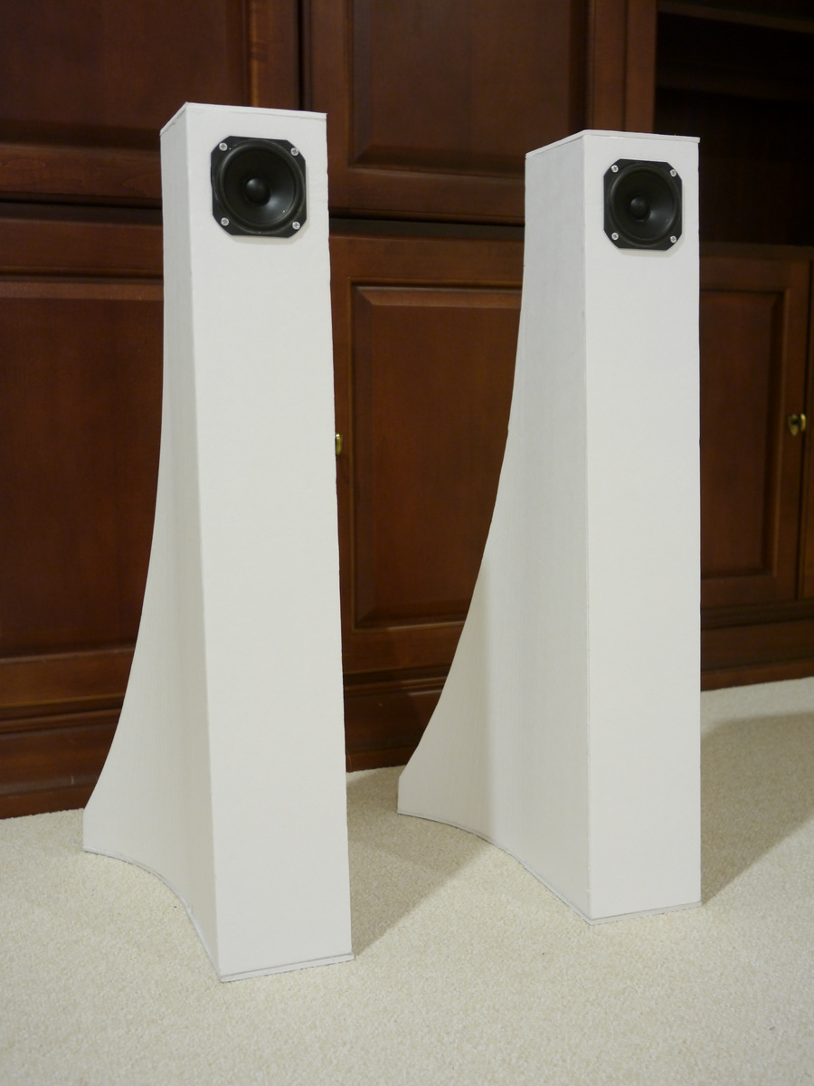

Build it with foam core first to get a feel of the sound, super fast and doesn't cost anything if you have drivers already. I built an FH3-inspired horn and really like how it sounds. It has really helped to give me confidence to build it in wood later.
http://www.diyaudio.com/forums/full-range/227460-fh3-inspired-foam-core-mini-build-3.html
And if you don't like how it sounds, you have only lost a day of your labor. If you like how it sounds, like I did, you have a set of nice sounding speakers that you can use in places where you ordinarily would not take a heavy, expensive speaker. 🙂

For a quick and dirty foam core horn, you can butt-join the panels together with hot melt glue. The numerous channels on the inside provide a lot of supporting bracing underneath the panels so it will still be quite rigid. The exterior panels just need to be airtight and the hot melt glue joint does that very nicely. If you wanted, you can add a thin layer of paper on the outside of the butt joint with PVA glue and it will increase strength and rigidity and make it look like one big piece.
Uline sells bigger pieces of foam core (96 x 48 inches in fact but they want $15/sheet and you have to buy a carton so it is prohibitively expensive). 48 x 96" White Foamboard S-11755 - Uline
The Elmer's brand board which is really nice and perfect for exterior panels is available in 36 x 24 in size so that only 2 would have to be butt joined. But again, price may be prohibitive to buy a carton of 25. At least it is only about $4 ea or $100 a carton. But if you think about how many speaker projects you can make for the $100, it doesn't seem so bad... hmmm...
