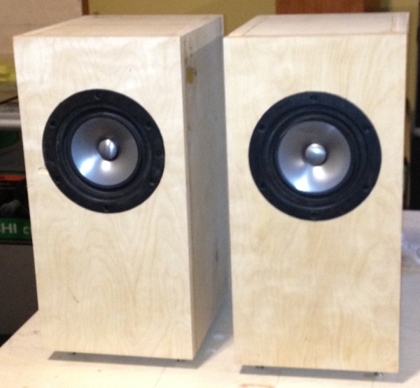

My friend has asked me to build him a pair of speakers. I have a pair of Alpair 10.2 on the way and I am having difficulty deciding what enclosure to build for them. It is pretty-much down to either Mr. Brines' "M10-A10" enclosure, or Woden "Silbury" enclosure. WAF is not an issue for my friend, but he does not want to supplement bass with a sub. He will be using an NAD 315BEE for the foreseeable future.
I have read Bob's listening notes on the "M10-A10", but I have not been able to find much of the same on the "Silbury".
My friend's goals are maximizing the bass potential of these excellent drivers, but quality, speed and cohesiveness of said bass must not suffer.
Has anyone heard the A10.2 in both of these enclosures?
Bob and Scott, what do you feel are the design highlights of your respective designs?
Does anyone think there is an even better enclosure for the 10.2 ?
Thanks in advance for any/all opinions!

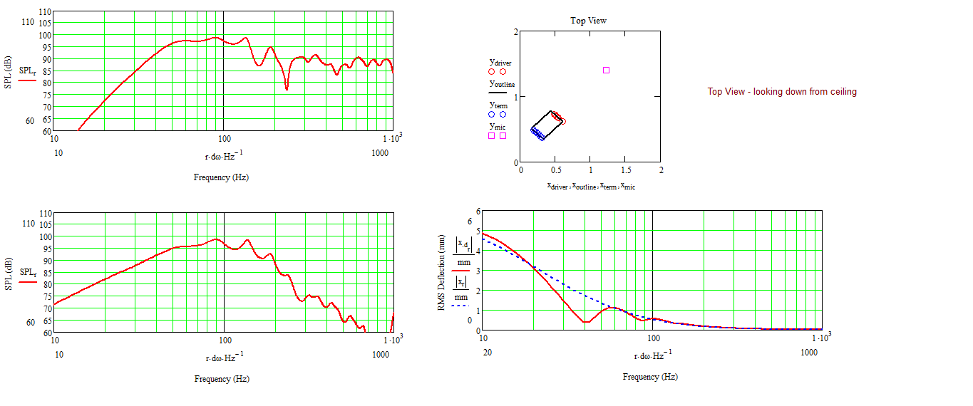

Scott, have you got simulated or measured FR curves of the 10.2 Silbury?

Indeed I have. My usual response though is 'what would you like them to look like?' This is the issue with in-room response curves; within certain broad trends, it's possible to make them look pretty much however you want them to look by changing the measurement / simulation conditions. FWIW though, here's an example. Box angled 45 degrees into the room; 1m distance, on-axis, carpeted floor, 8ft ceiling, edges of the front baffle 2ft from the front & side walls. As you can see, it's a high-gain design to allow greater placement fexibility since you can get rid of what you don't require. Once damped to ~flat, F10 will be similar to Bob's MLTL, but the overall sound will be very different on the bottom end given the respective radiating areas etc.
FWIW, I still suspect your friend will be better off with Bob's MLTL.

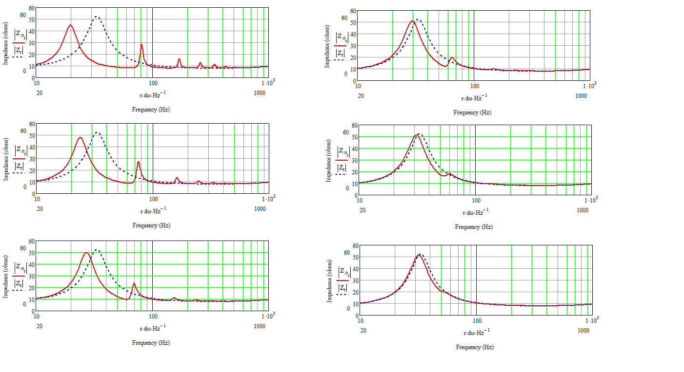

Scott, with a horn, can you nearfield mic the driver and the horn mouth and combine them like a ported speaker, or how do you do that? I've got no experience with horns. I worked on a horn with the alpair10BW but wasn't sure what to do with that. I wasn't so concerned with bass anyways, just the >300hz frequency response which wasn't affected by my farfield measurement.
Edit - I did measure impedance which was crazy in the bass region. This wasn't a surprise really though, I expected that. I wasn't sure how to determine tuning from it though. 2 or 3 troughs in the impedance iirc.
You can, assuming quasi-anechoic is required. If you've got a design that employs boundary loading, i.e. the room boundaries actualy form a part of the horn expansion, it gets a bit more complicated, since removing that means the final part of the horn has gone AWOL, which throws the results.
The impedance measurements you mention you took sounds about par for the course, since the cabinet presumably wasn't impedance matched down to the 1/4 wave cutoff frequency (F0). Ergo, below Fc (the frequency to which it's impedance matched) you've got pipe harmonic resonances. Here you go; a series of impedance values arranged in two columns, top to bottom. This is a pipe of fixed axial length, throat area, and driver location, expanding in a linear fashion (i.e. a conical horn). The driver is generic, the actual dimensions of the pipe were fairly arbitary, although I set length to approximately 1/2 wave at 100Hz. Top left has the smallest terminus area. Bottom right the largest. You can see the harmonics gradually vanish as terminus area increases until its finally getting near to being impedance matched at F0, leaving just the single large peak at tuning.

When I was doing the the design for the M10-A10, I needed something to break in the the drivers, so I built a pair of Pensil's. Six boards and some polyfil. Done! They sound pretty darn good too. I have a problem, though, with stuffing out unwanted harmonics. So I went about designing out the majority of the bad harmonics, and rather that stuff the cabinet, I line the cabinet with 1" fiberglass. The result is a cabinet with much less volume and somewhat better bass response. I am told that the M10-A10 can be a bit boomy, and if yours is, a bit of port damping will fix it.
I am quite happy with the M10-A10. It is one of my better designs, up there with my FT-1600 and the TT-2000. But then, the choice is yours.

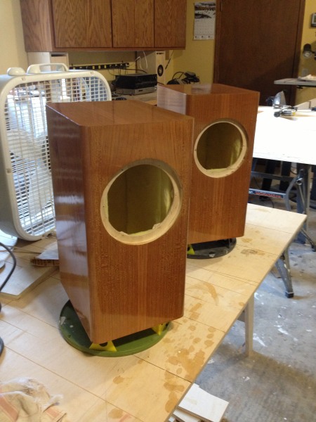

Out of interest Bob, and briefly OT, what happened to those BRs you were doing?
Oh, they're doing fine. I finished the prototypes and they are the current speakers in my 2-ch. I have offered they for beta testing through my personal forum. The boxes I will use for demo's are in cherry with a high gloss finish. Pictures attached. The bass that comes out of those little boxes is crazy. F10 just below 40Hz, and at an 80dB listening level, there is room for some bass boost. For those going to Dallas for LSAF, I will have these there.
A note on the high gloss finish: I did it just to prove to myself that I could do it. But it anyone wants to buy a set, add $200 just for the finish. It is a mother bear.
