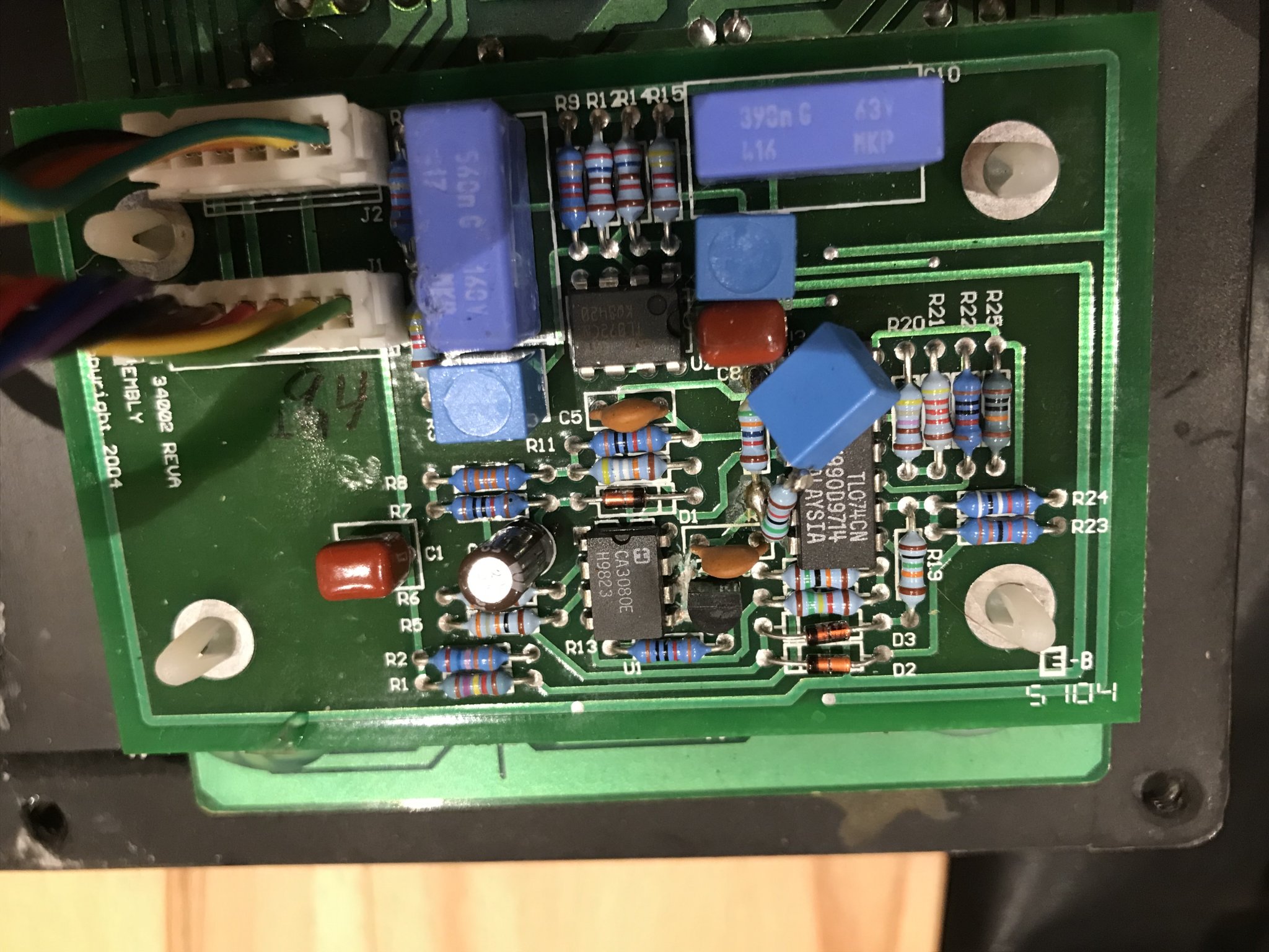

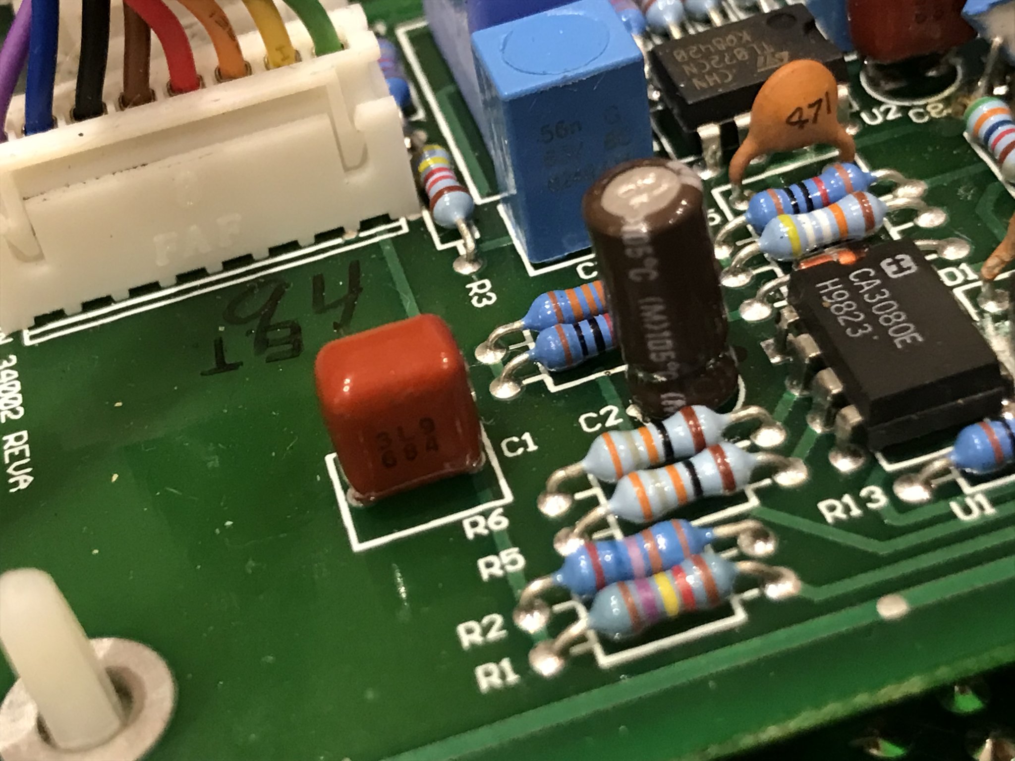

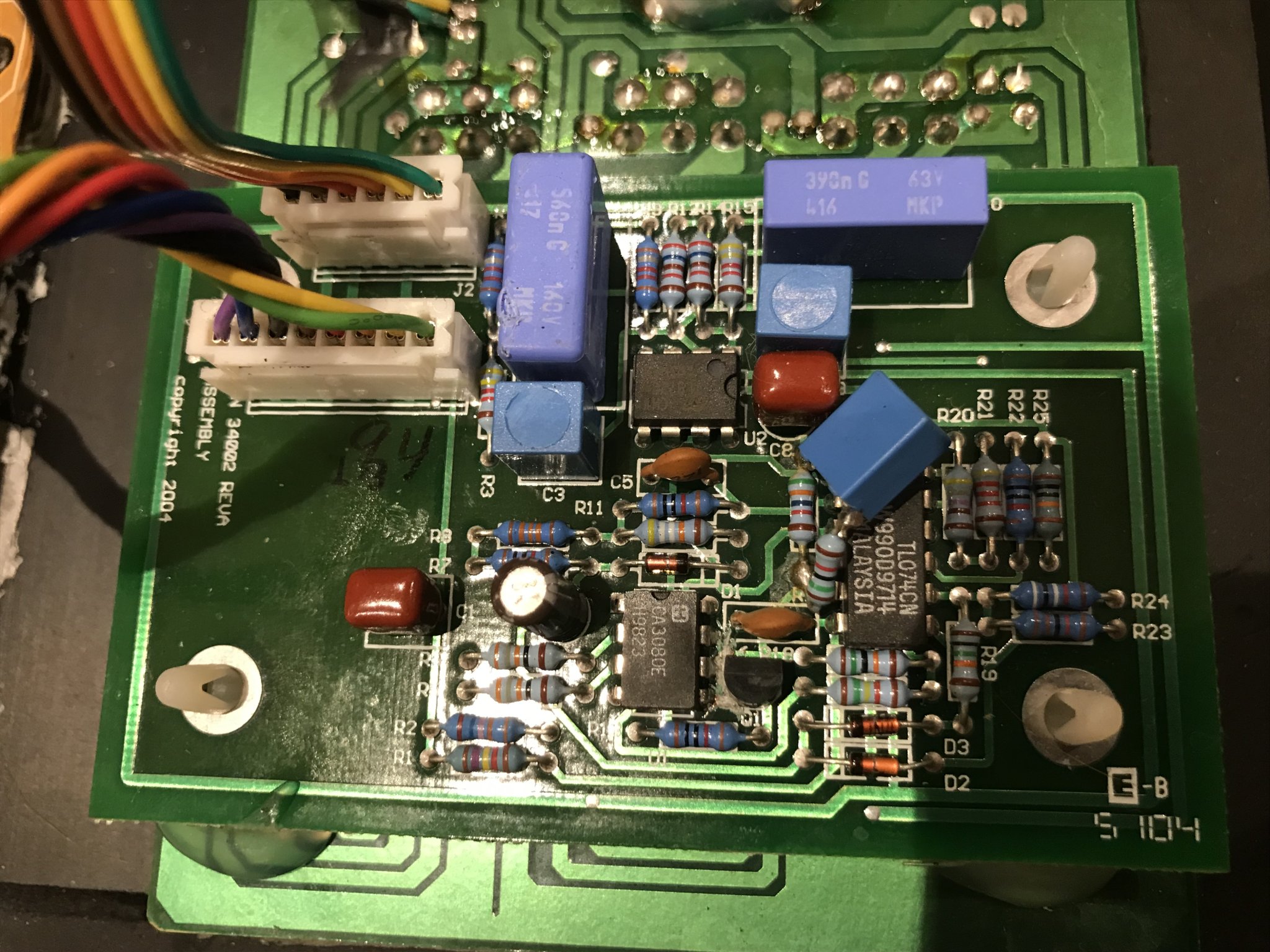

Your description of the bass sounding chopped is typical of a faulty limiter or compressor. The little daughter board mounted on the preamp PC board is the limiter/compressor that M&K added to the circuit. Can you get a picture of the board? Maybe we can figure out the input/output pins and measure the electrical response to confirm if this is where the problem originates.
You might also check on that limiter board to see if there are any electrolytic capacitors. If one of them is being used to hold the peak reference level for determining the limiter setting it could be what is causing the problem.

I have attached the pictures of the daughter board, about 3 weeks ago. It measure good With an ESR meter. I have already changed the small electrolytic cap, “C2”, which was a 1micro farad 50v.

You can bypass the limiter board by removing the pins for the green wires from both of the connectors and hook them together.
(The connectors still need to be in place though, to pass supply voltages and ON/OFF signal between pre and power boards)

The reason I ask, is that your description of "...the first half of A second the sound is louder than after this time." is exactly what you would expect from a limiter with a typical less-than-instantaneous attack time.
You should be able to play a 40Hz tone and slowly turn up the volume. At some loudness level, you should notice that as you continue to turn up the volume the woofer output does not increase.
Try the same thing with the limiter board bypassed. This time you should notice that when you reach that same loudness level, turning up the volume more will result in noticeable distortion. (ie the amp is clipping)
Looking at the parts on the daughter board, the limiter circuit appears to be quite similar to that used by M&K in their older subwoofer lines...not really a surprise I guess.
See the attached schematic for the MX150. You can see the limiter portion of the circuit right in the middle of the schematic, between R96 and R40.
