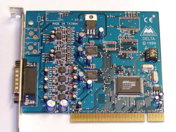

To do this, I installed an M-Audio Delta-44 sound card. This is a four-channel balanced I/O unit, that appears to have fairly good specs (96KHz/24 bit ADCs and DACs with 99/103dB SNR and 0.0023/0.002% THD), at least for the price.
I had a good look at it before installing it, and noticed that it appears to have a little room for improvement, at least at the quick glance before I threw it into the PC and tried it out.

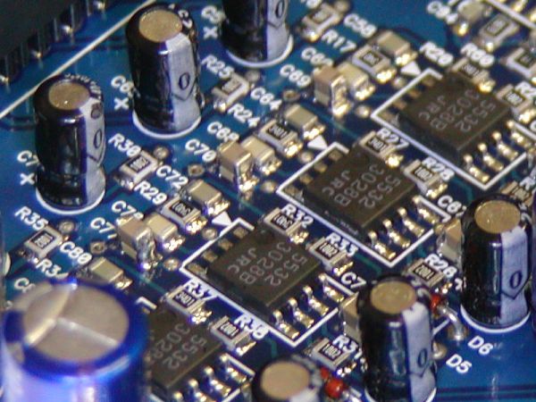

Firstly, it uses JRC 5532 opamps. These are reasonably good, but I figure I might get slightly better SNR and THD by substituting something a little better, say OPA2132s. I've got a couple of dozen of these kicking around, so I might have a go substituting them.
Secondly, the power supply doesn't look terribly special - I imagine it could be decoupled somewhat better.

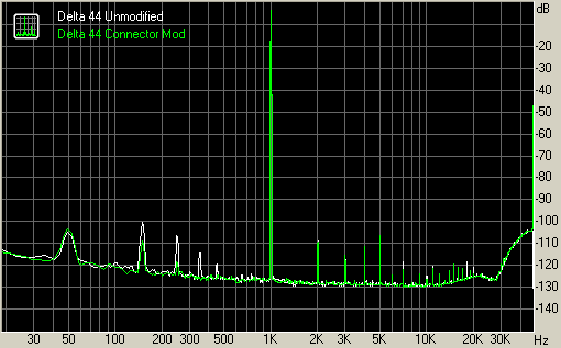

One of the main recommendations was to cut the mounting tabs on the DB-15 connector, which short the analog ground to the PC chassis. I did this, and had an immediate improvement in mains rejection, by around 6-7dB.
I also worked out how to get RMAA working under Linux (sorta, anyway). I run it under XP in VirtualBox. I couldn't get the sound working properly under VirtualBox, so I simply export a test .wav from RMAA, then use Audacity to record while playing the .wav. I export the result from Audacity, and open it with RMAA.
One question. RMAA reports the Delta 44 card as having a noise floor of -98.0dB unmodified, and -98.1dB modified. How do they calculate this? From looking at the spectrum, I make the noise floor about -98dB unmodified, and about 105dB modified...

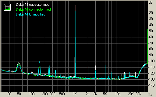

I increased the capacitance on the output of the 7805 and 2.5V reference line (C25 and C61) from 10uF to 100uF. I also added a 1uF 16V 0805 ceramic on top of the 100n 0805s that were bypassing these.
Next, I swapped the 10uF electros around the codecs for 100uF ones, and added 1uF 16V 0805 caps on top of the 100n 0805 caps that were bypassing the codec analogue supply and ref supply.
Finally, I added 1uF 16V 0805 ceramics on top of the 100n 0805 ceramics bypassing all the JRC5532 opamps.
The results of this mucking about is shown in the attachment. Harmonics of 50Hz are reduced significantly. However the 50Hz fundamental is still there (indeed up a couple of dB), and it's degraded the THD a little (RMAA reports 0.0013% rather than the previous 0.0011%).

It is difficult to get lower distortion figures than a 5532/4
when they are set up correctly.
They are however susceptible to common mode distortion.
Might be worth to see if it is at all possible to balance impedances
(R and C) looking into the + and - IP's of 553x opamps.
The only opamps I would suggest replacing them with is some of
the newer breed of National devices such as LM4562 and it's
cousins.

Yeah, I think I'm limited by the distortion limits of the AK4524 rather than the opamps. It's only supposed to manage 100dB SINAD and I've already cracked that.
