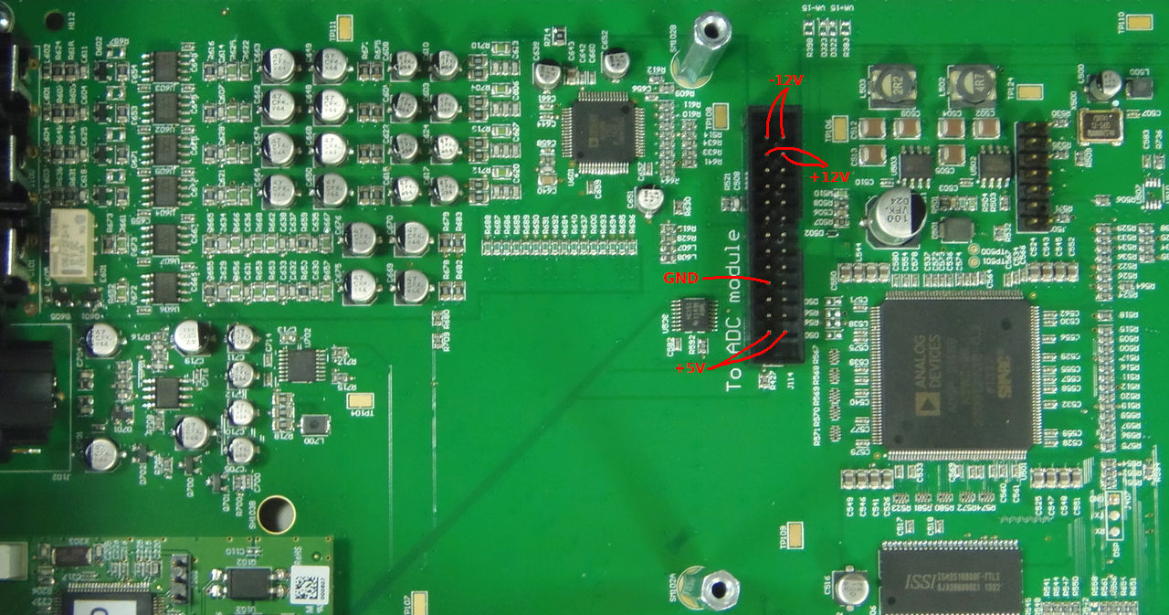

Please could anybody who has a Lyngdorf measure the voltages on the pins shown in attached picture for me? That would be of great help! (The attached picture shows the motherboard inside the Lyngdorf with the multi pin connector where the ADC module connects to.)

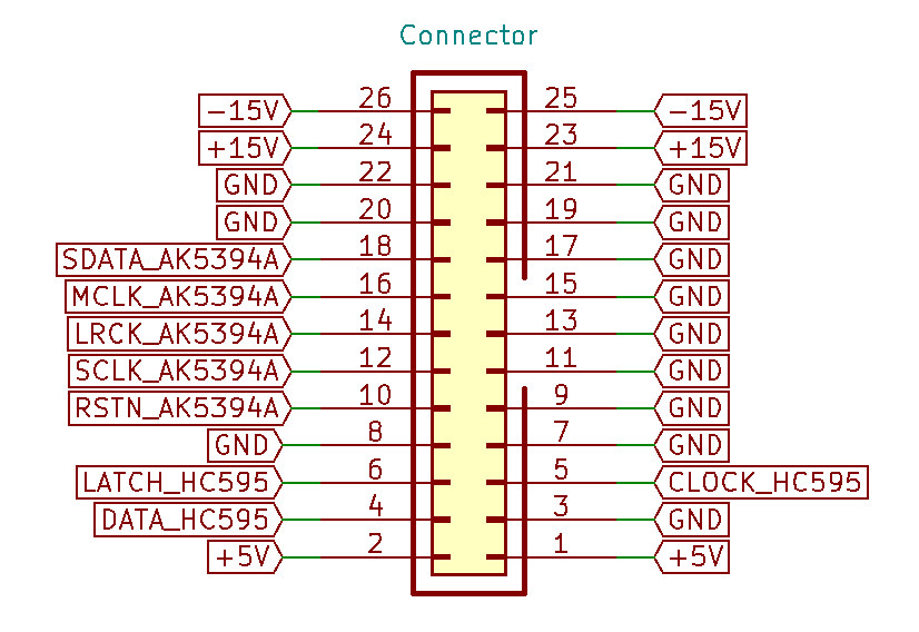

Yes, I simply overlooked that the relays sit between the source and the collectors of the transistors. Here a diagram of the connector shown in the TO:

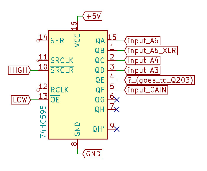

The diagram of the input selector (A3-A6 are the inputs, QF adds +6dB of gain, QE goes to a transistor labelled Q203 but I don't know yet what it does):
attachment.php

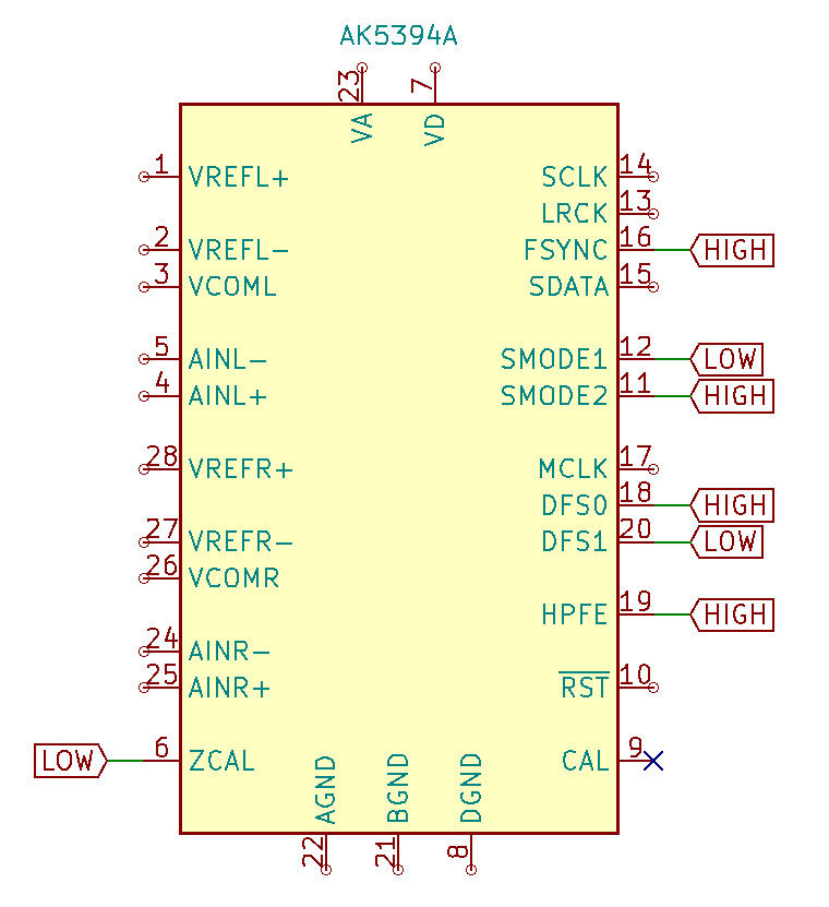

This is how the ADC is configured:
attachment.php
Following the tracks from Q203 there seems to be nothing really operated by QE, just a couple of diodes in series dropping the output voltage of Q203 step by step. It seems that Q203 is only there to keep the current draw constant during relay switching: I noticed that switching the +6dB gain relay causes exactly the same amount of current draw as Q203, but maybe this is a silly idea...?

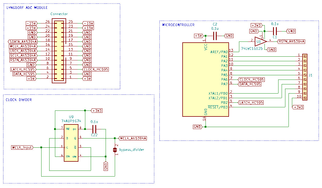

Some progress: I designed and built a power supply and MCU board for the ADC, see attached rendering. The MCU is an ATtiny and operates the input selector, the reset line, LEDs etc. The backside of the PCB carries a 74AUP1G74 based circuit which can take in MCLK and generates an output frequency with half the frequency of the input...

Update: project completed, tested, everything works. I used the small xmos board with i2s input from diyinhk. Sound is very good as expected with this ADC. I can post updated diagrams if anybody is interested.
