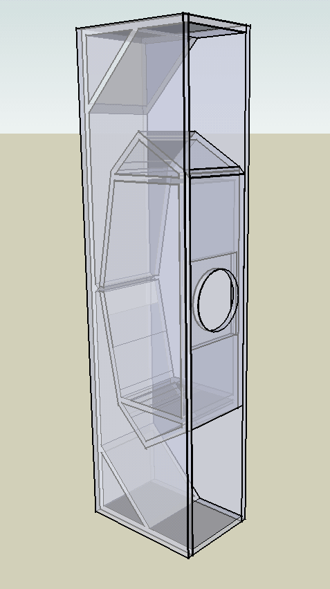

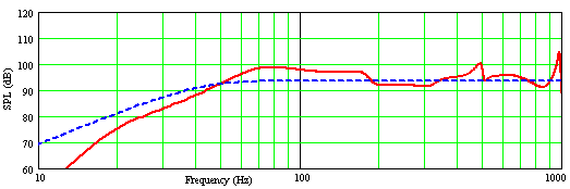

I dunno Bob. Normally I'd agree, expecially given the Qt, but Dave and I did a double BVR design for them, which according to MathCad at least, should work pretty well. Admittedly, it's not small though: 60in tall. And it assumes the factory specs., are correct, which is always a bit dodgy.
You can check out the various proposed designs here. It ran the gamut from a hole in a concrete sheet, to infinite baffle, to aperiodic, to Scott and Dave's double back loaded horn.

FWIW, the double-horn cabinet Dave and I did is my favourite of all the BVR boxes that we've done so far, at least in terms of the modelled performance. I suppose it should be, given that I / we had the benefit of having designed the other three before it, so I was refining my approach (the CSS double BVR has also benefited from this). It'd benefit from some bracing in the chamber to reduce panel resonance, but should sound interesting!

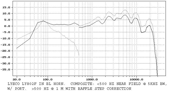

Reading this thread, I recalled that I have a pair of LY802F's
loaded in a modest BL horn. I haven't had time to properly
attend to them, but I did run some quick curves, of which I
offer the composite:
I reckon (assuming the drivers have the midrange performance I hear whispered they have) they should sound suitably impressive. Beats a normal small-vent reflex cabinet anyway.

Scottmoose said:
Seems to confirm that these units have pretty decent technical performance as well as getting some good subjective comments. How do they sound to you?
They do require some EQ, and the top end is not as extended
as say, Lowther DX55's. In the context of price, they are quite
decent, but as I said, I really haven't had time for more than
an initial impression.
