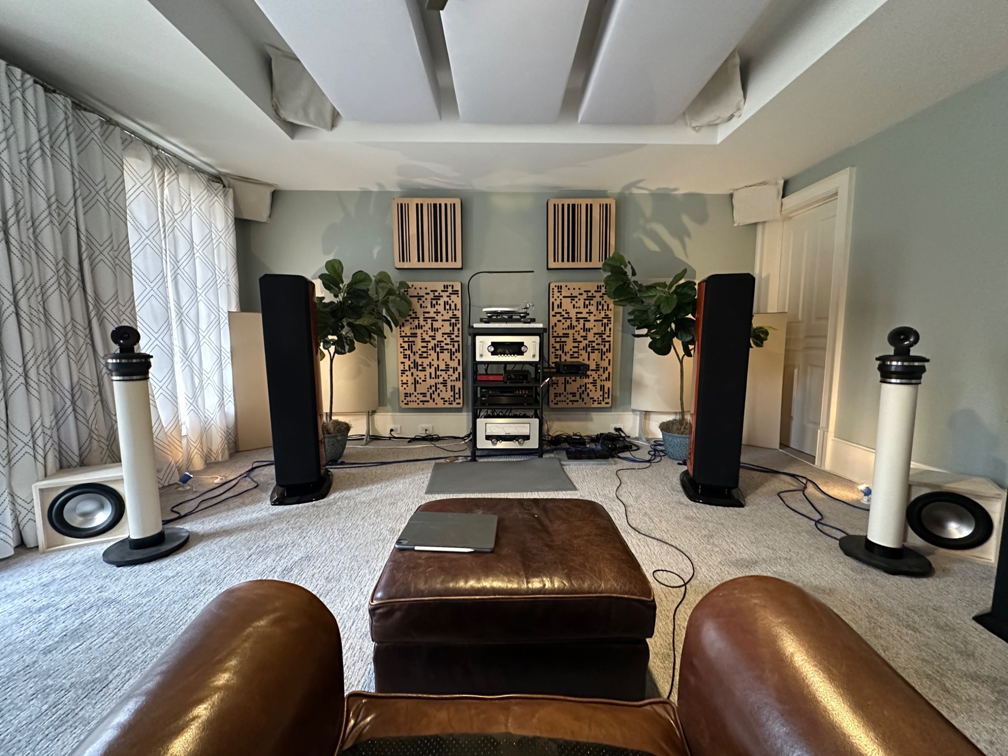

I first started my Linkwitz travels through the Orion. Like Anand, I met SL several times and he was always such a gentleman and as smart as they come. We all pick "our guys” to follow and revere. He is very much one of my guiding lights in Audio. After I lived with the Orion for a few years, SL came out with the LX521. I built that using the passive crossover between the upper and lower mids. It was great but I just couldn’t help myself when SL and Dave Reite came together to build the miniDSP file to provide for a 4 way fully active crossover. This was the LX521.4. Once SL passed away, Frank Brenner assumed the reigns. He now has many very professional and sexy models (Linkwitz.store) ready to just set up and play music rather than the kit form SL was always such a proponent of. You can still get the kit from Madisound and I believe Frank has them too.
Then I moved to a home with a much smaller listening room (18'x16.5'x8’) and I opted to build a pair of LXminis. Then after a few months of listening, I opted to expand it with the +2 open baffle subs.
For your technical questions, I refer you to Linkwitzlab.com. All of SL’s analysis is provided intact from his original writings.
My personal impression of treble from the 4” driver is that is it outstanding. My main system includes Revel Salon2s and the treble response is very nearly as clear, accurate and present as it is on the Salon2s. I have the LXminis pointed directly at me and moving them ever so slightly changes the sound stage and the treble response. But believe me, you won’t want for more high frequency information. Remember, the tweeter for the LX521 comes in at 7500hz. This 4” driver is outstanding!
Where the LXminis fall short is in deep bass response. Thus it isn’t surprising that there are at least 3 different subwoofer solutions. Dave designed a sealed sub, but there is also an open baffle sub (+2) and then the Studio (same as the subs for the LX521). I felt the sound from the basic LXmini was exceptional: very rich and with a tremendous sound stage. I have not heard too many other systems that have a sound stage this realistic. It has punch, it is dynamic and it is intoxicating. You feel like you are immersed and among the musicians rather than listening to the musicians behind the speakers.
IMHO, your question should be how loudly do you like to listen? If you listen above about 85dB, then these may not be for you (opt for the LX521). But if you’re like me and listen at more modest levels (80dB), then you will be thrilled with their performance.
Good luck with your decision! I hope my comments helped.
Paul
Reactions: wchang and Juhazi
