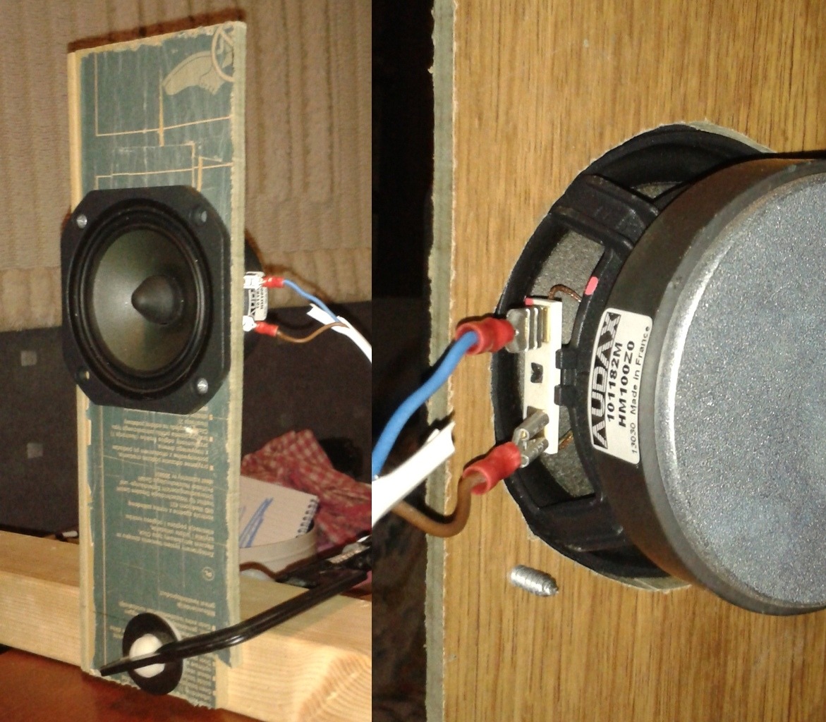

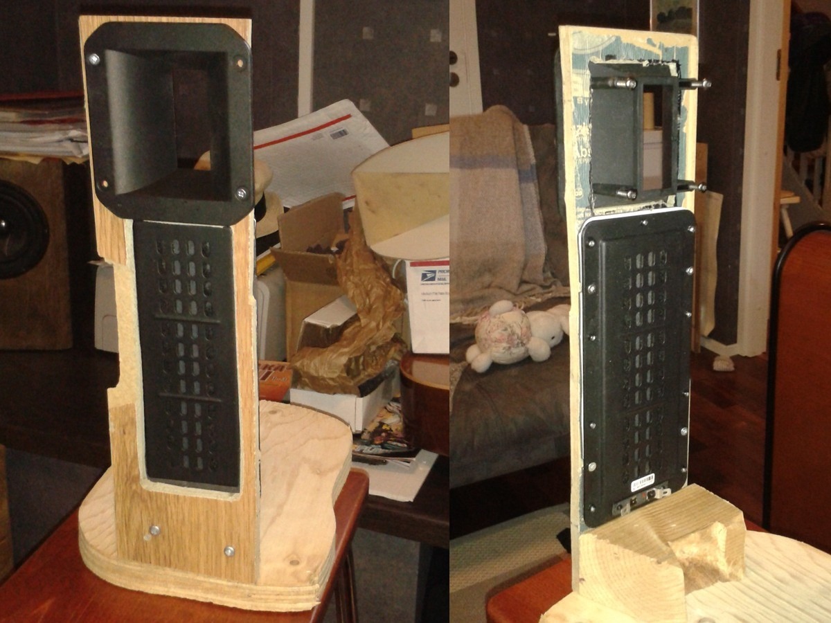

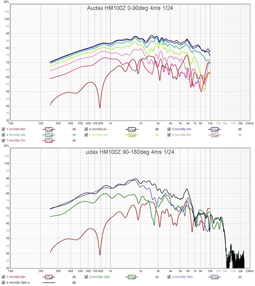

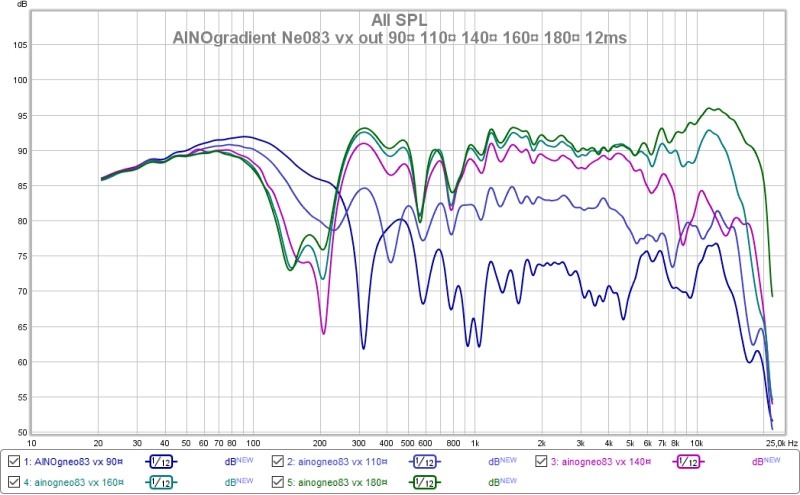

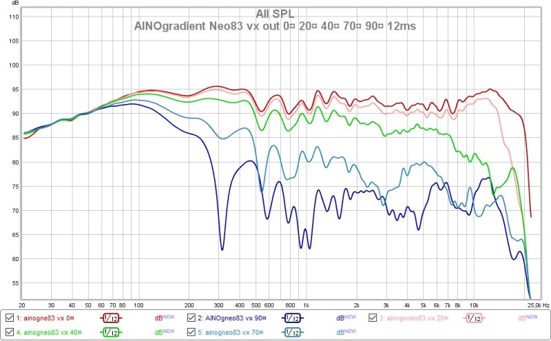

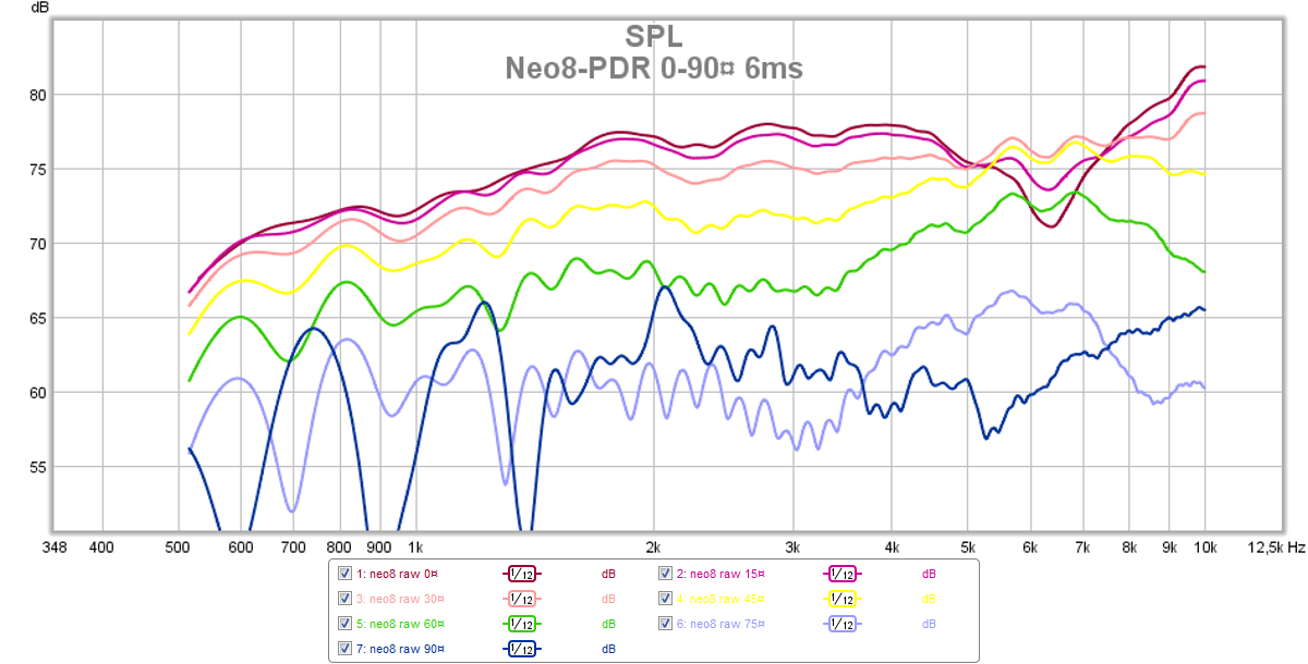

Well, actually regular cone drivers are not capable of dipole radiation above say 2kHz, because of the spider and motor on the backside. Only planar drivers really work. Minimal baffle is also elementary. I haven't seen backside response measurements of NaO speakers...
Looks like I haven't saved all my measurements of 3-4" cone drivers, they were so pathetic... But here a 4" cone driver vs. B&G Neo 8.
You must believe me, Neo8/3 backside response is smoother than frontal because I mounted them on the backside of the frame!
