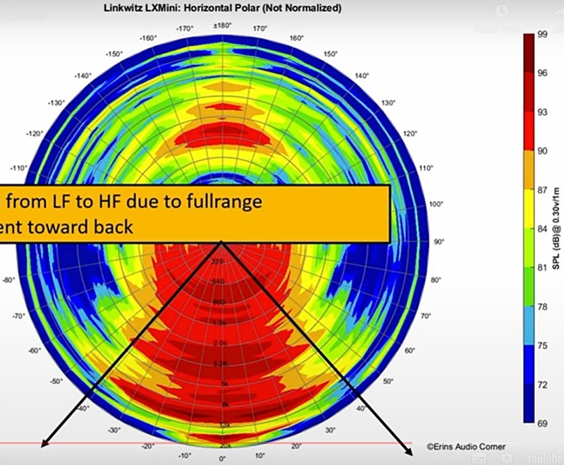

For dipoles, I must say the CTA2034A isn’t all that helpful- I went straight to the Youtube review to hear what you had to say about this speaker.

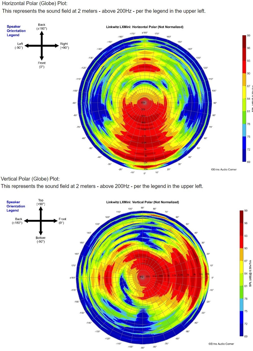

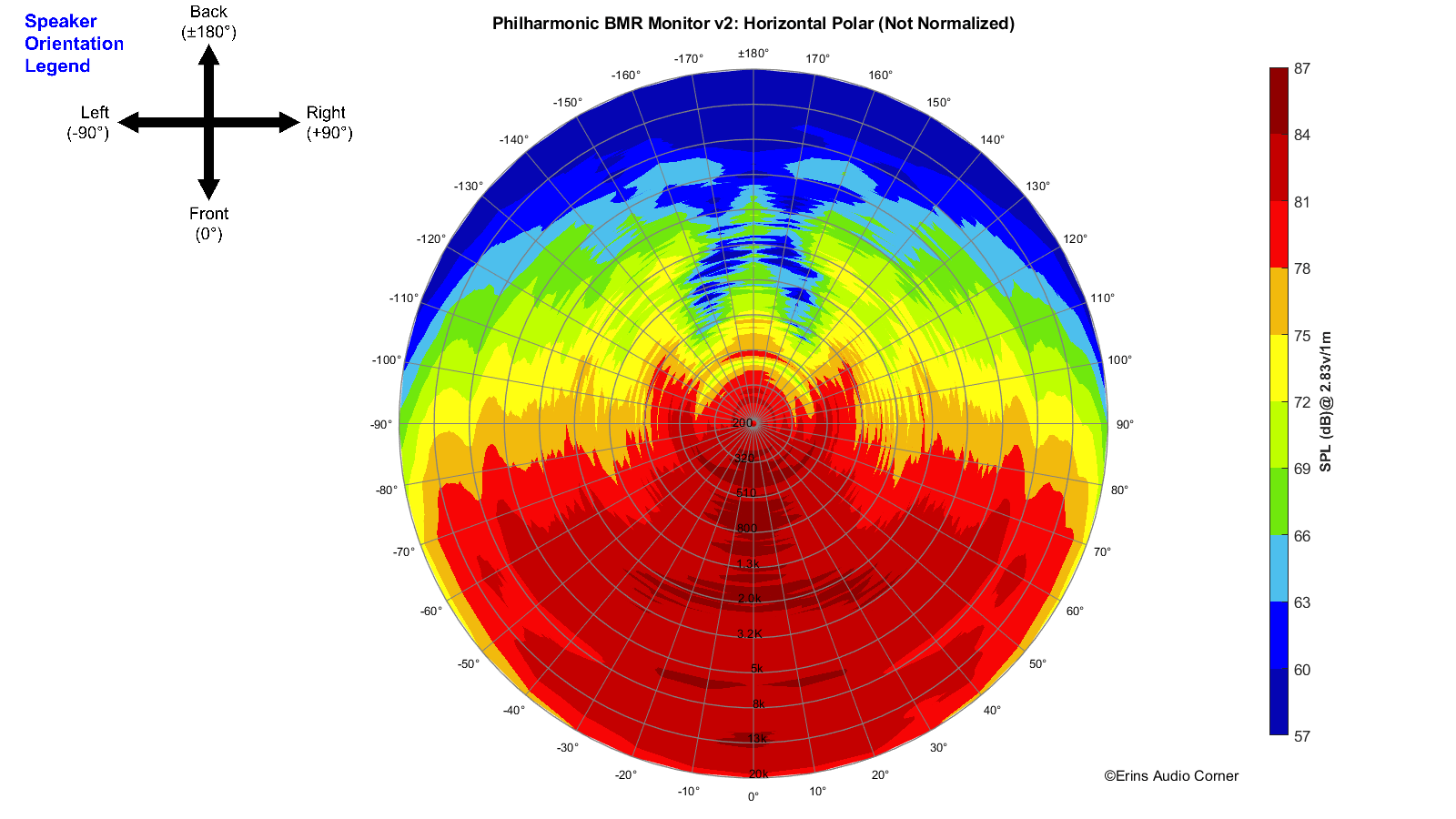

-don't like that sort of display for polar's either - on general inspection it looks like it's a very narrow beam-width all the way down to 200 Hz (..if you look at it a lot closer then you realize it isn't, but it requires some mental "prep." to actually read it properly - and that sort of defeats the point of a good graphical display).

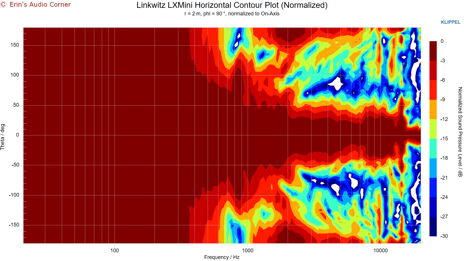

The standard frontal contour polar map (with gradients) is a lot easier to read IMO:
https://www.princeton.edu/3D3A/Directivity/GedLee Nathan/images/Plots/Horizontal/GedLee Nathan H Front Contour Plot.png
..and if you want to go radial then this *frontal polar (without gradients) is also easy to read and can be useful:
https://www.princeton.edu/3D3A/Directivity/GedLee Nathan/images/Plots/Horizontal/GedLee Nathan H Polar Plot.png
*and of course if you need to show some sort of rear radiation (as with dipole/cardiod/supercardioid/hypercardioid) then it doesn't have to be just frontal.

Well, you’re the first one I’ve heard say that in 2+ years. All the feedback has been positive aside from you. Even Bohdan used the idea for SoundEasy. We had an email exchange about it.
Regardless, if you had followed the link for the review you’d have seen the normalized contour you’re talking about is also provided. 😉
I watched the *video (at about 2am last night). 😉 (..and like it!) 🙂
BTW, do you see what I'm referring to - what it looks like lower in freq.?
*note: as a viewer, if I'm spending my time watching your video its very unlikely that I'm going to spend more time going to your link
- most of the time I just move-onto the next youtuber site in audio that I'm interested in checking on (..which is usually Joseph Crowe's youtube pages). It's also not that I can't read/understand that particular polar graph, but again - that it requires some unnecessarily added mental processing (enough that I had to pause the video - which is not something that would have happened with either of the above graphs, though the one in your video does provide full polar which is very useful for this particular speaker).

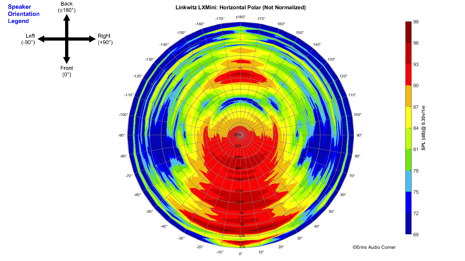

I dunno Scott, I think the polars are very intuitive. Perhaps it takes a bit of time getting used to, but it provides far more information at a long pixel stare, as well as a quick glance- I mean, just look at the red!- it's shooting forwards and backwards.

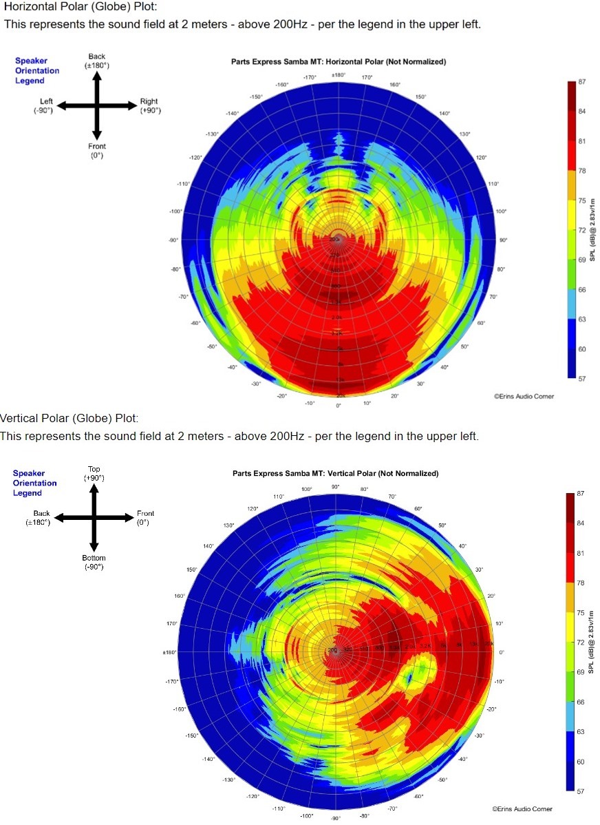

Compare that to Exhibit B (which I put as an attachment). It's another speaker with DIY designer origins, but as well engineered (or better) than many commercial manufacturers IMHO). Again, glance at all the red; that is clearly monopolar - frontal output, but wide dispersion out to nearly 90 degrees.
I'm almost ALWAYS give the Youtube video a miss, I like staring at the data in all it's full uncompressed pixel glory. 🤣
But that's the thing, different strokes for different folks, and Erin's providing more data (objective and subjective) than anyone else.

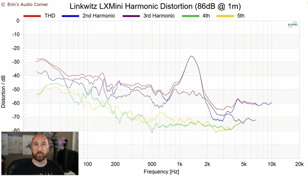

Abrupt non-linear distortion of all harmonics at a single frequency, elevated when driven at higher levels, may be due to a resonance somewhere eg. baffle mounting. If you ever have a chance, try with rubber washers between screws and frame and/or frame and baffle and it may go away.

Full horizontal polar and gradient - definitely more information. 👍 The only graph having even more is a balloon (which includes all of that horizontally and vertically).
Mentally adjusting for both the freq. response "rings" and the shrinking angle (as any given angle becomes more narrow toward the center) is a bit much. You can "vector-in" on any given angle and freq. and get the information you need (and it does have a lot of information), but looking at it as a "whole" not only does not give you a good idea of what the horizontal directivity pattern is, but actually provides you with an erroneous view of the loudspeaker's directivity. The LXmini's radial plot at a glance of the whole (horizontal pattern) looks like it is fairly uniform in directivity from 200 Hz up excepting about 4 kHz & 11 kHz up in the frontal lobe.
Of course - it's not a fairly uniform horizontal pattern from 200 Hz up and 4kHz isn't really a problem.
While it's a bit "wonky" to see the rear lobe in this graph (again, useful data - but you need to mentally process that the top and bottom of the graph is the rear horizontal output, which is a LOT easier IMO than the gradient radial), I can actually tell what the frontal directivity pattern is horizontally with just one glance (though IMO I'd prefer it non-normalized):
..but of course Erin provides this information on his website - so it's not really a problem so long as any given viewer has a pretty good understanding of what is being displayed in the video and is willing to go to the website for more information. That's a big caveat though for inexperienced viewers.

Balloon graphs are very demostrative about the basic difference of LXmini vs. boxed small 2-way. Forget the on-axis wiggles and look at what happens wider than 60deg off-axis! That sound is not counted for preference or reflected spectrum DI. Room response and late decayed energy of these will be very different, and that is what makes dipoles and omni/dipole like LXmini to "disappear" and to give sound that fills the room.

Someone replied to my YT video and said that the single driver itself (the 4" Seas) is the culprit and provided a link to the data showing it. I looked at the mfg impedance data and you see a wiggle at that frequency. So, apparently it's the Seas driver itself; not the enclosure/speaker design.
Yes there’s a dip in the FR and corresponding blip in the impedance response, as well as a rise in H2, that is known.
I’m a little surprised H3/H4/H5 rockets up at a higher drive level. If this is all due to cone edge resonance, then I was not aware.
