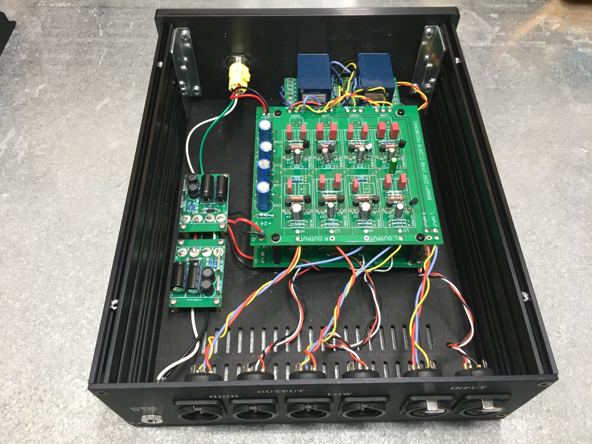

The two boards are 5" x 5". The largest capacitor is 16v 3300uF which I think is 1" tall (don't know which brand, so I'm guessing.) What is a minimum-sized case that would comfortably hold the two boards? I'm thinking at least 11" wide and 8" deep. The deep is to accommodate the 6 XLR inputs and outputs. (No RCA, No external controls, just the power input and 6 xlr connectors.) How tall? is 2" sufficient to give the 3300uF clearance + the board + the mounting stand-offs underneath?
It seems like the only case on the Diyaudiostore site that would work is the 80mm x 280mm x 330mm case. Seems like two 5"x5" boards would be swallowed whole with plenty of room left over, which is fine, but I'd prefer a 2" tall case to a 3" tall case. Any case suggestions welcome. I'm also getting pretty good at riveting aluminum together as I'm slowly building an RV based airplane in my limited spare time. I might just build an aluminum box from scratch for the sheer cool factor. Speaking of which.... how much cooling does the case need to provide? I'm thinking it's probably not going to get really hot inside the case, though I don't know if that means I can fully enclose it with no cooling holes/slots.
I also have a Mean Well P50A13D-R1B which has a +12V and a -12V pin.
The Mean Well supplies I have used are marked V+ and V- for the 12v, 36v and 48v supplies. I think the +12v and -12V is a 12v supply. Measure the voltage between those pins to make sure.

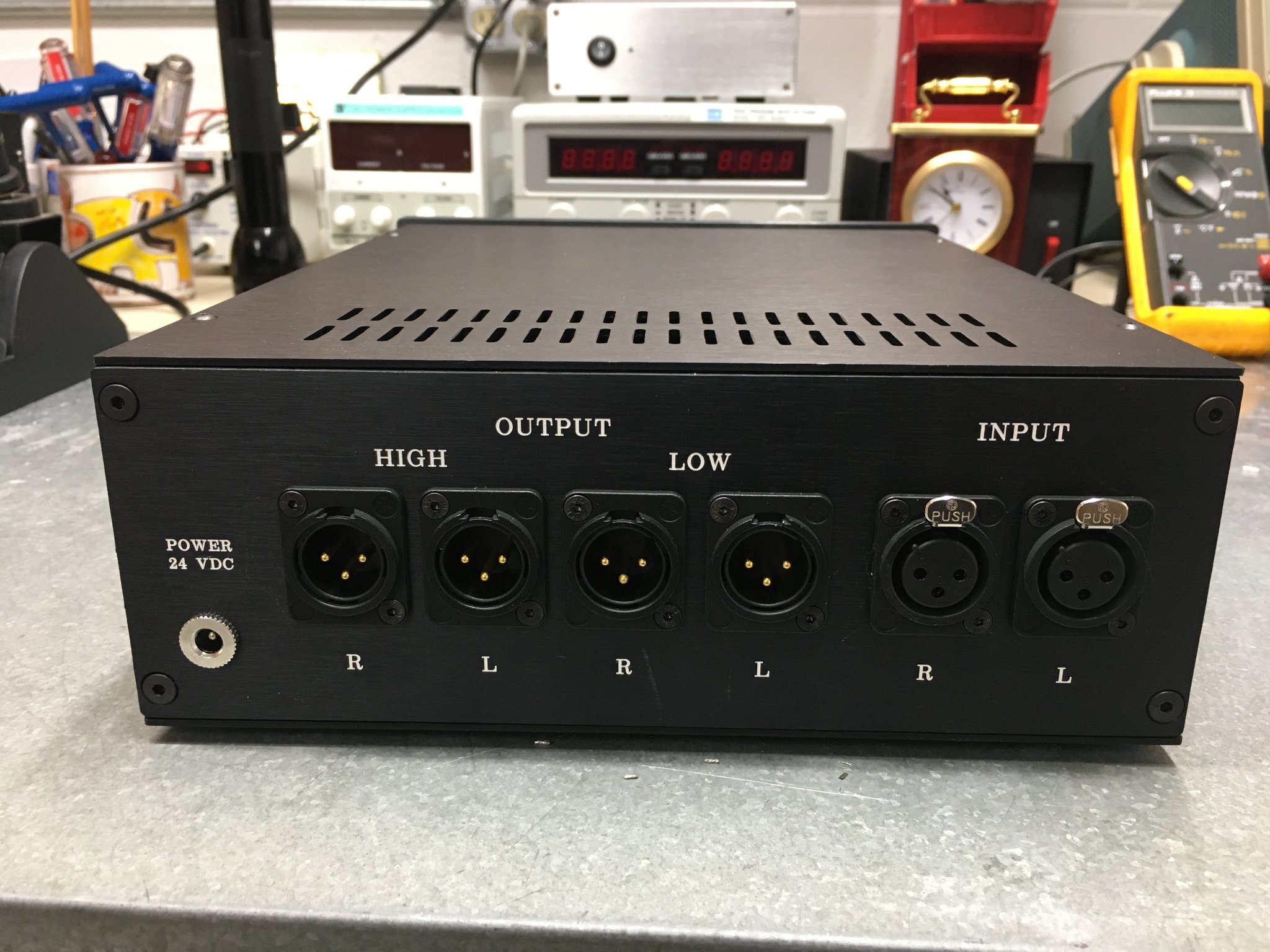

Mine is 290mm deep X 230mm wide and 85mm tall. Here are pics

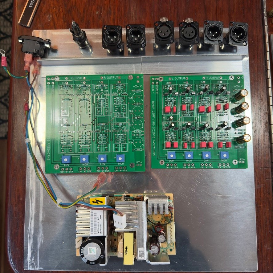

I have another question about this project.
I decided to liberate my Crestron 24V power supply of it's chassis and put it directly in the chassis of my balanced LXMini build. Now I'm wondering where I need to place it in relation to the other two boards, and do I need to build a shield around the power supply.
My thoughts are to put it in the front of the enclosure and run the ac input down one side, and put the two LXMini boards at the back as close to the XLRs as feasible. I think I'm going to put the inputs next to each other in the middle of the chassis, then put the two outputs on either side of those.
Advice? Or is this as good an approach as any?

I've got quite a bit of Belden 8423 left over from my first set of LX521.3 speakers I planned to use for the XLR to board connections. Mainly because it's tin-plated copper, which I've recently discovered is a much better conductor than silver, gold, and the other fancy coatings. My sailboat has the same kind of tin-plated wire. It keeps the copper from oxidizing. Hell, maybe I should try that since I've got a few feet left over from my wind instruments install. But I also have a boatload of Cat-5. Literally. 😆
I know I've got two ferrite beads somewhere, but no idea which box in my storage unit it might be in. So, that helps even with everything being fully balanced input to output?

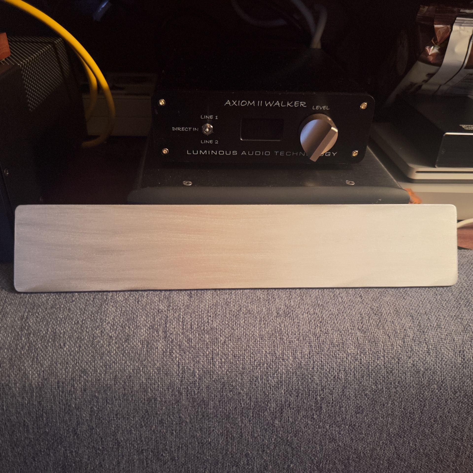

I made this brushed front panel out of a big thick sheet of 2024 aluminum I had in the shop. This is going to be so cool once I get it all together!

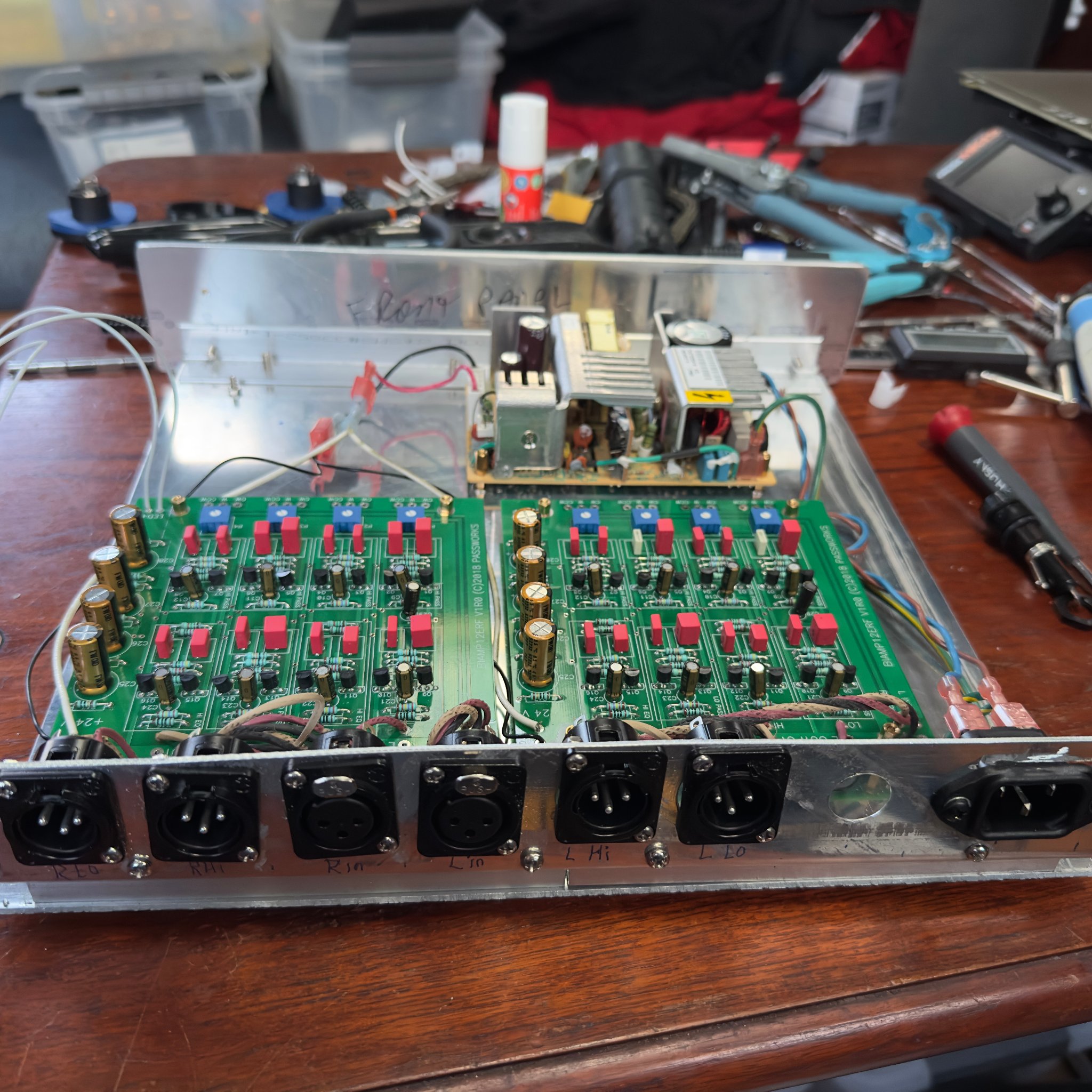

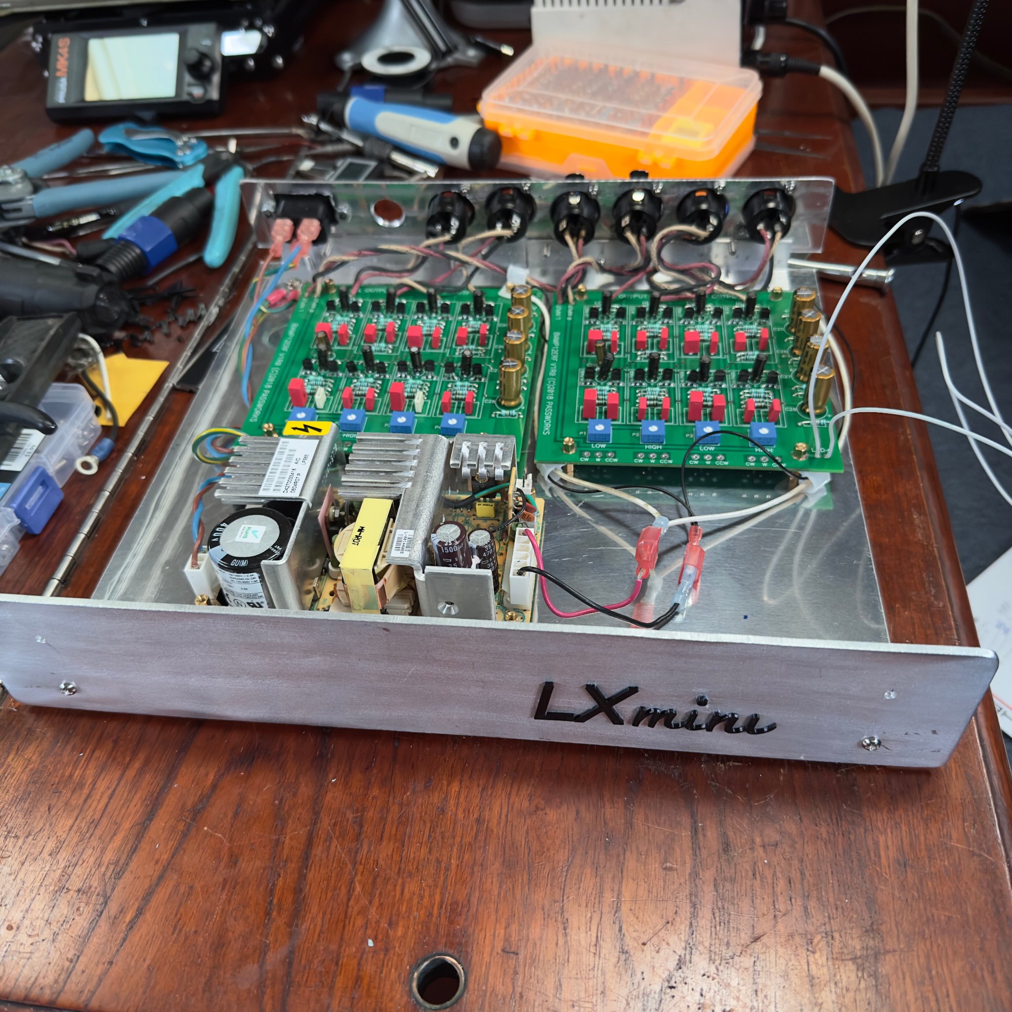

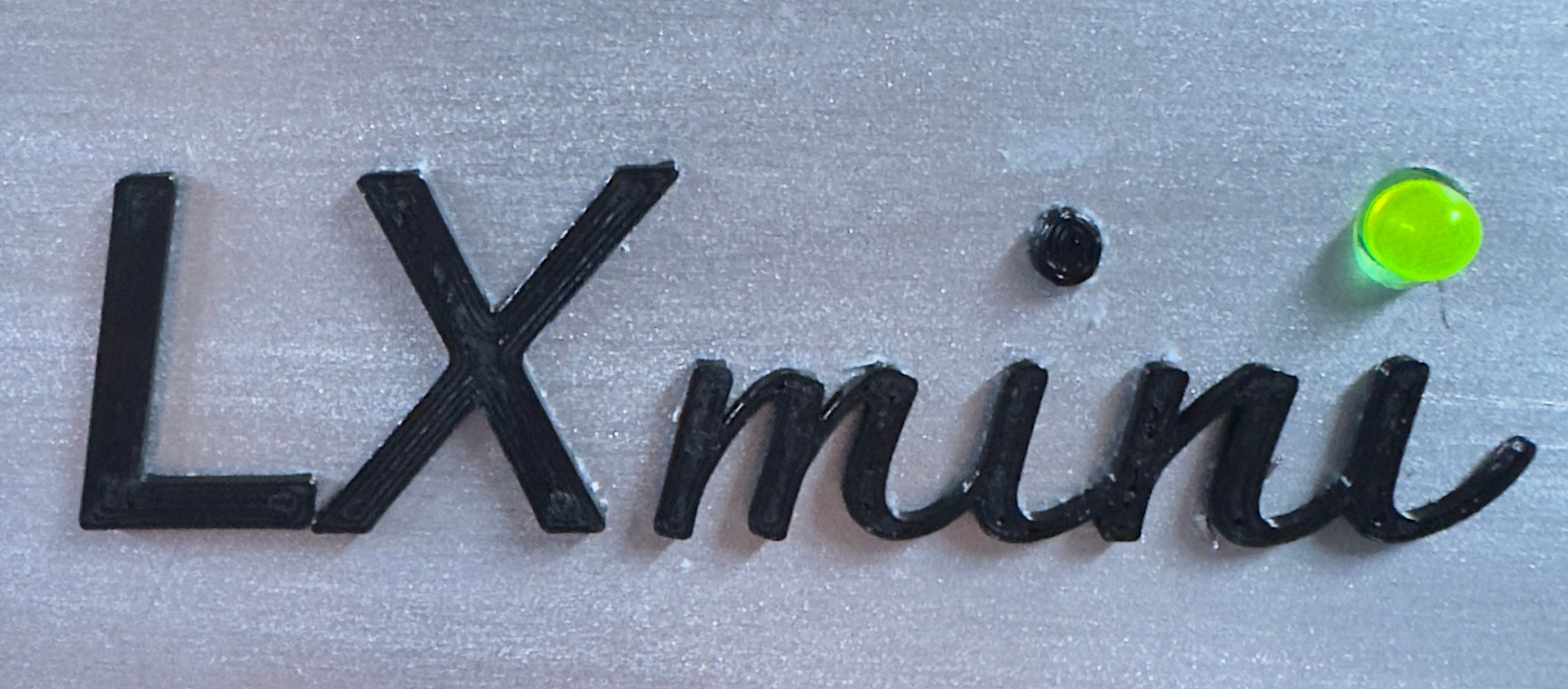

This was a fun project! The boards are perfect! My attempt at building an aluminum enclosure from bare aluminum sheet was ok; I learned some things that work and some I can improve on the next time. But I'm most proud of the logo/led integration. I have to pat myself on the back for that one. I used Adobe Illustrator to create the logo, Fusion to extrude it, then 3D printed it. Next time I also need to leave more room for the XLR wiring in the back and create a little more room for the AC input and wires.
