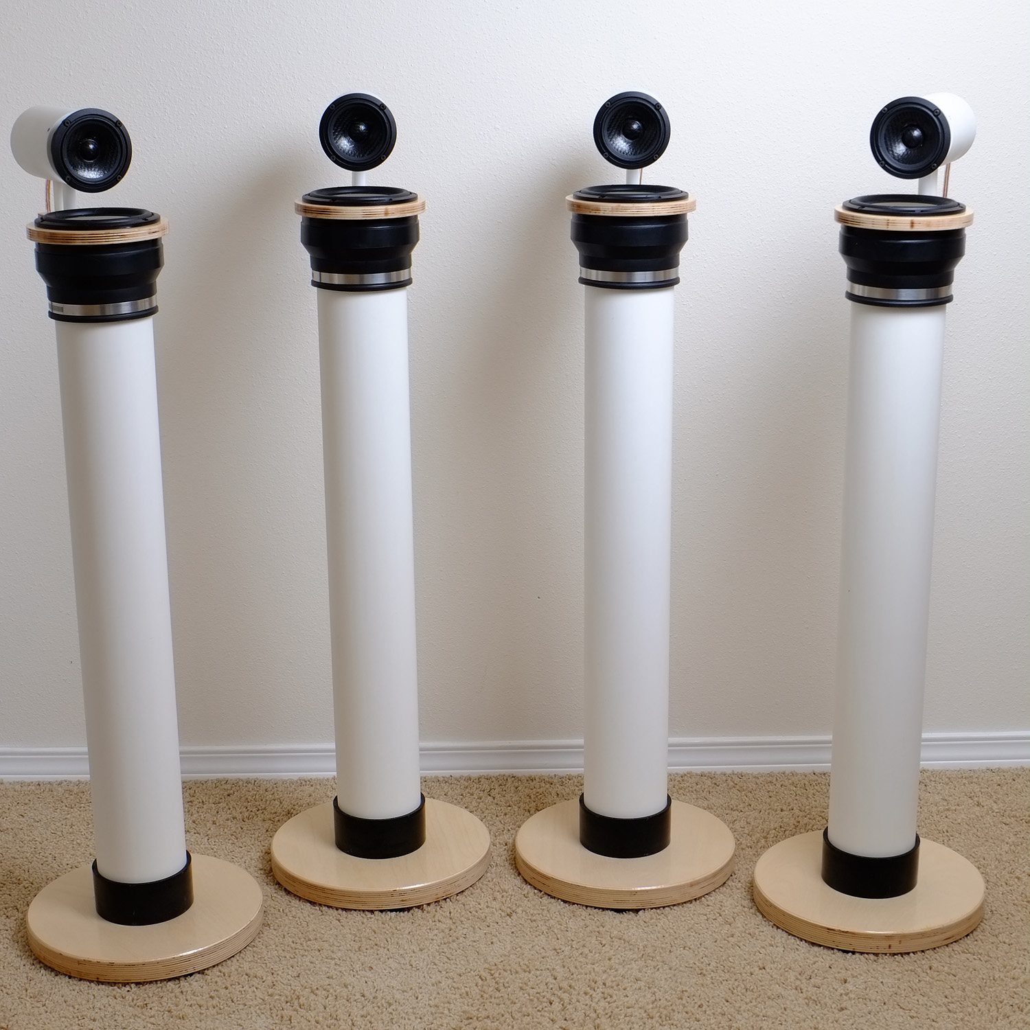

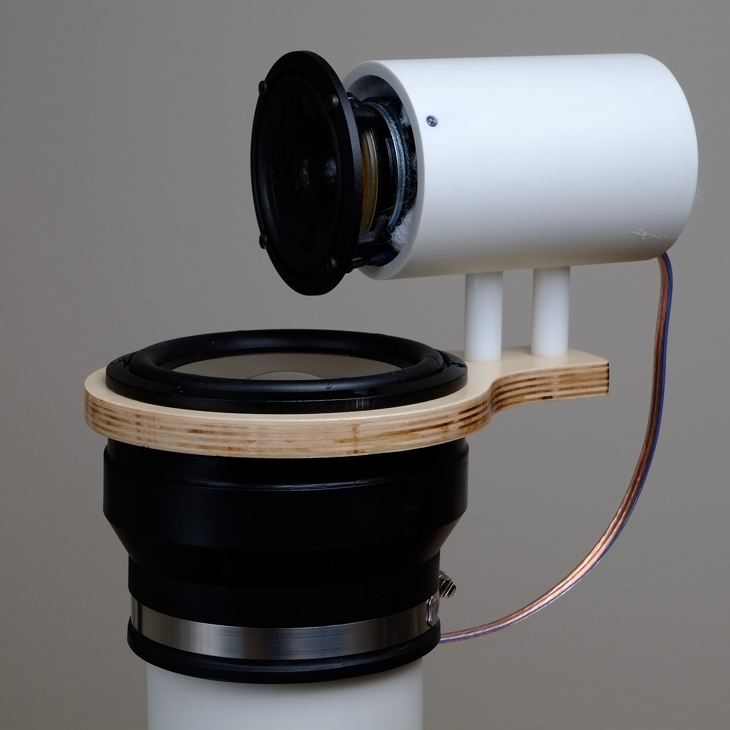

The one with the Seas SL midbass. The little fullrange still wasn't great (over-damped), but overall I preferred the result of the monopole vs the LX mini's open (and larger) fullrange driver.
I always thought he went in the wrong direction. Should have been high freq.s as omni and as you move down the midrange: dipole (through to the bass).
Yeah, that's not the original version. The Pluto transitioned through three versions. The driver switch to the aluminum Seas encompassed versions two and three.

The speaker response is omni at lows, transitioning to monopole at highs with transitioning cardioid in between.
There is no dipole behaviour when both the drivers combine. The 6khz rear response mentioned by SL is a very small bandwidth and sufficiently down down as compared to front radiation.
No, I would characterize it more as a dipole at high frequencies. The range from 1-6khz (measured directly behind the speaker) is essentially at the same level as front radiation. Simply walking around the speakers while playing is sufficient to hear this.
That said, the diffusing action of the tweeter "baffle" and the stuffing in the tube do cause an interesting radiation pattern off-axis....so there is a noticeable transition in the power response that would not be "textbook." 🙂
The LXmini's have trade-offs, like all speakers, but nevertheless a very interesting and satisfying speaker to listen to with good program material.

properly set up with excellent amplification the LX Mini's get there about as good as any speaker ever does. my one change is to use Mr. Pass's crossover and two rather large 18 inch H frame subs. Some people are never satisfied fully by just one set up but if I had to live with just one this would be it.
I built the LXmini about 5 years ago and upgraded them with Tom Christiansen's amplifiers (Mod 86 + Parallel 86) a bit later. The combination provides a very natural and satisfying listening experience. They are probably not a good choice if you like ear-splitting blow your hair back loud, I find them more suited to jazz, blues and classical than hard rock and the disaster that is pop music today will be revealed in its full misery.
probably the beaming from the fullrange driver.
i own the lxmini and the notion that these speakers do not collapse to one speaker when moving side to side is not true imo. where i have them setup only minor movements of my head on the couch make them collapse to one side.
I also own the lxmini. In my setup I find the complete opposite, I can sit considerably off center with no collapse of the stereo image.
i know they can work better in larger rooms, as for my apartment however it doesnt work, even though they are about a meter from rear and side walls. the funny part is that it doesnt happen the same way with any of my box speakers.
i can imagine pluto was better in this regard.
It depends on where the mid/tweets are pointing. If they are aimed at your ears in the sweet spot they collapse much less. I also have Pluto’s which have less directional tweeters. They are much less likely to collapse.
