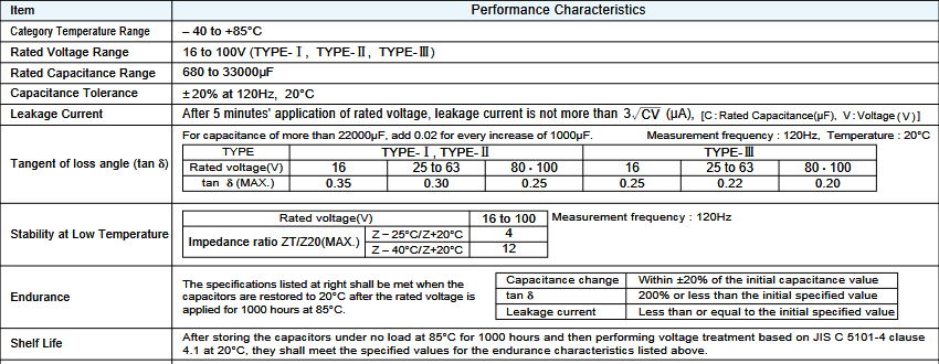

Does anybody have experiance with large power capacitors.
Im restoring an old Luxman amplifier and need to replace old 10,000uF 50V capacitors. I cant tell what original once type is !!
I have checked sheets and there are three types I , II and III
Anybody has experiance to advise which Type to use ?
BTW, the Type I is most expensive
https://www.hificollective.co.uk/sites/default/files/2023-07/Nichicon KG series data sheet.pdf

I've used Mundorf MLytic AG MLGO and they are widely recognised as being of very high quality:
https://www.hificollective.co.uk/search/site?text=Mundorf AG
I don't see ESR for the Nichicon KG, however the rated ripple current ratings do distinguish between types and are very good.
If the higher voltage ratings are not too expensive go for those (check derating).
Yes, Type III is most expensiveType I is the least expensive.
