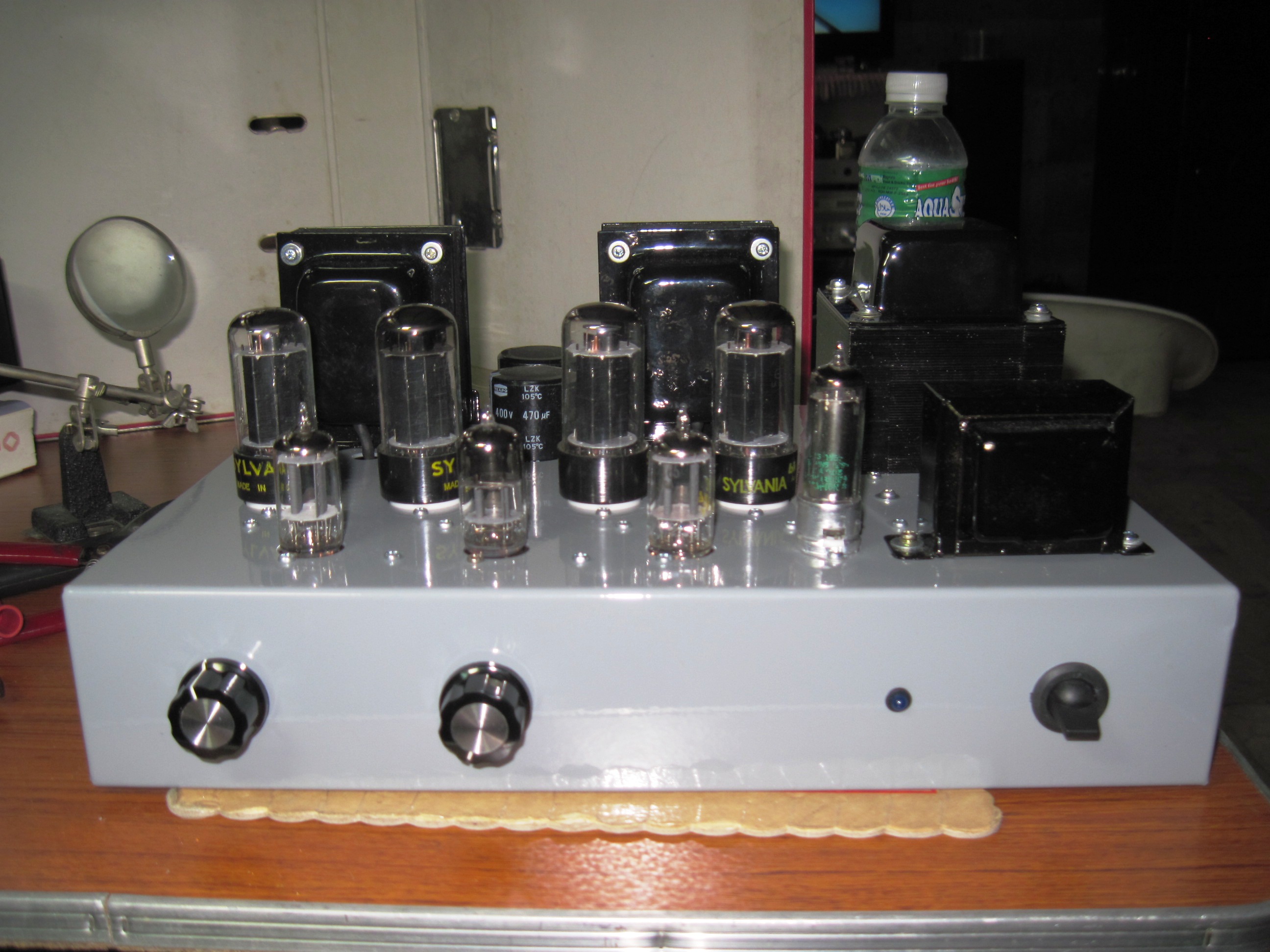

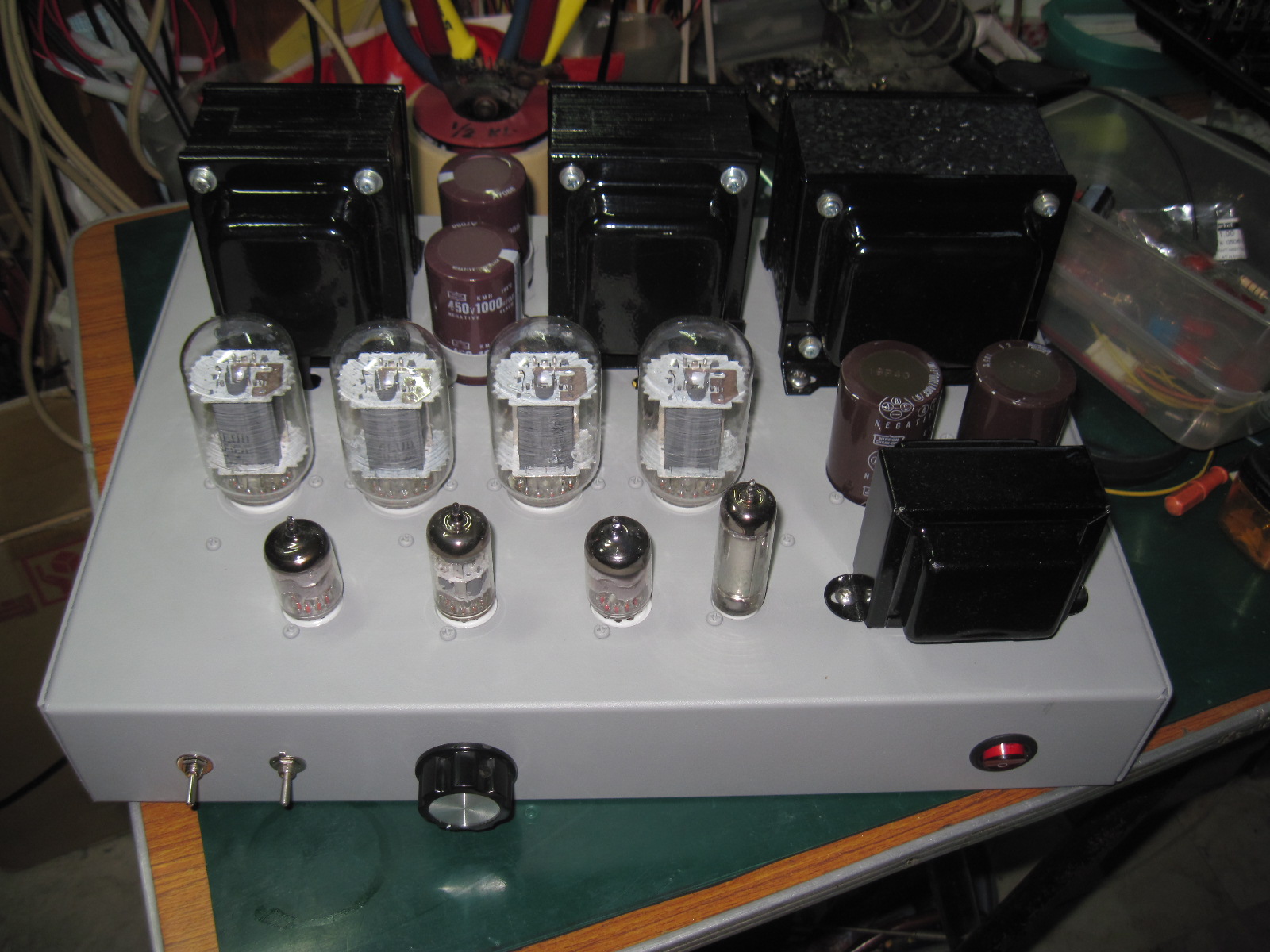

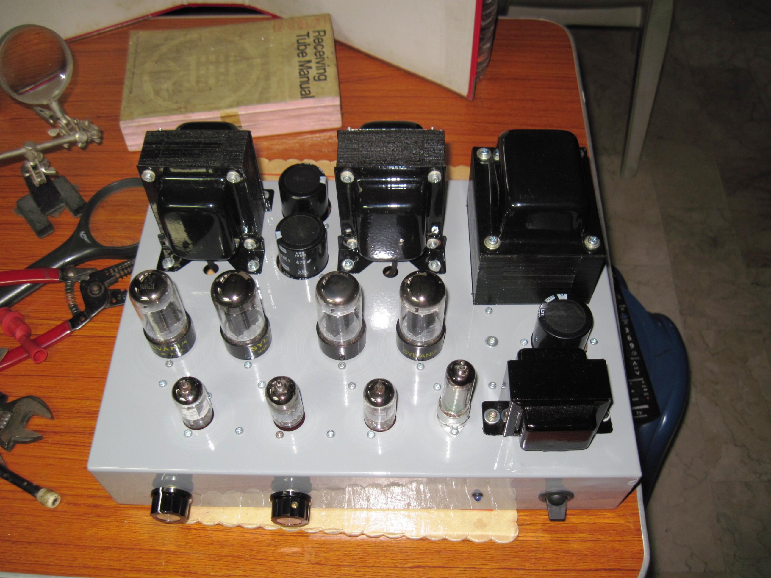

Tony, That looks very nice. I wish I could hear the creations of other members.
when i built my first 6LU8 pp amp, an oldtimer kept coming back to the house asking to hear it, on the third day, he picked up the ampa and took it home...
i also made a 12EN6 pp amp,
