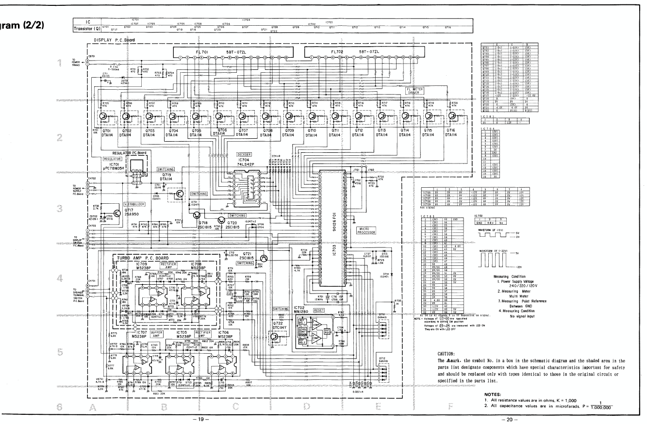

This is just the power meter schematic in the M-03.
It's just a complex A/D circuit and scaling. The display is high impedance (around 30 VDC probably) bias. Leakage will cause segments to glow. Of course noise on the input of the A/D will do the same.
Look after the simple stuff first. Then relax and break out the instruments. A tech use to these will have an easier time. I'll admit I haven't seen this before, and I was authorized warranty for Luxman. But just because it uses a large chip doesn't mean it is complicated.
Not easy to follow on a small diagram but it looks like the signal input is at the bottom left . Quick scope check on the inputs to see they are clean and zero and then a quick follow of the signal path through the opamps and confirm still clean and zero coming out.
