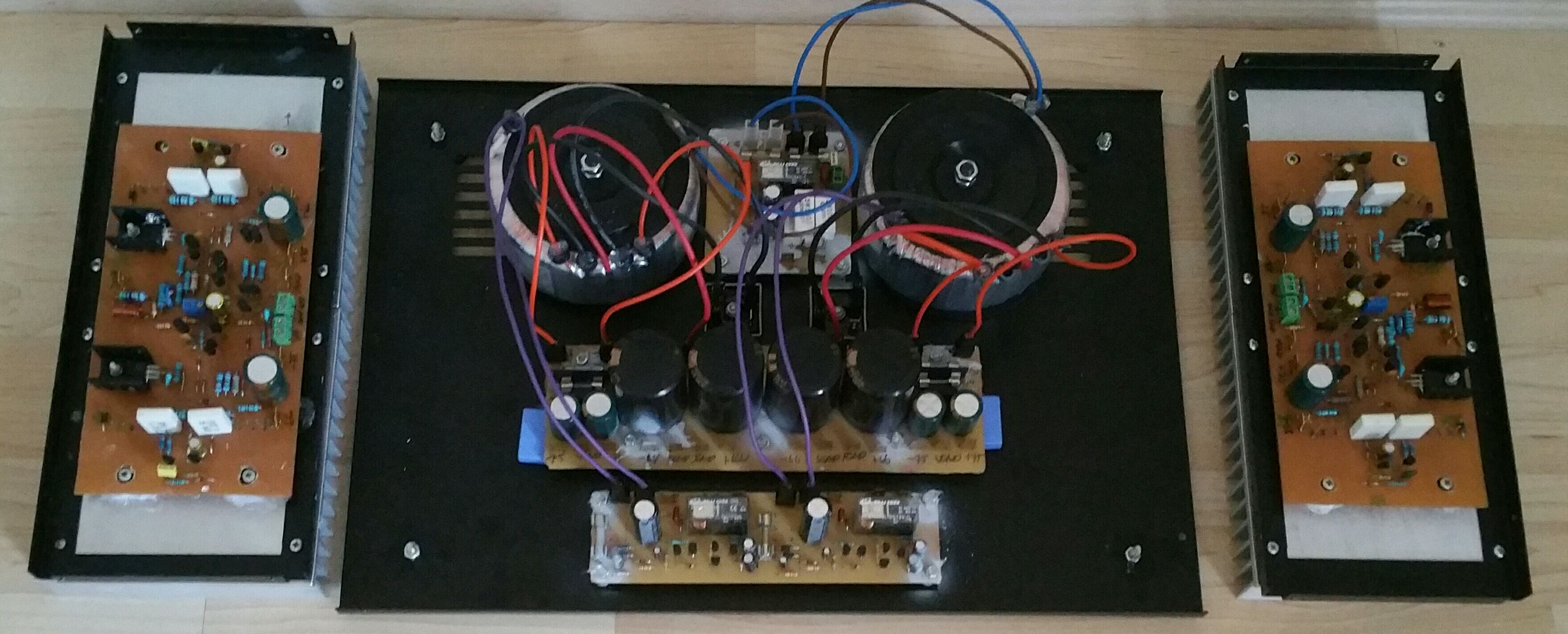

Yes why not build it, the M-02 is a very nice amplifier 🙂
Have you made a schematic for your rebuild project? Is it working well?
I have two of the M-02 amps actually, one unit is out of service for renovation. I am moving the power resistors to the topside of the PCB, to give better thermal balance, and improving a few other things - like changing the speaker terminals. But I think the original heatpipe cooling works at least as well as a typical conventional passive heatsink. Only problem was (is), that Luxman made the matching Preamp (C-02) too small to stack the M-02 on top of it. So most people put the preamp on top of the M-02, which of course blocked the heat rising out of it... Even so, many have survived 35 years so far, despite these terrible thermal conditions.

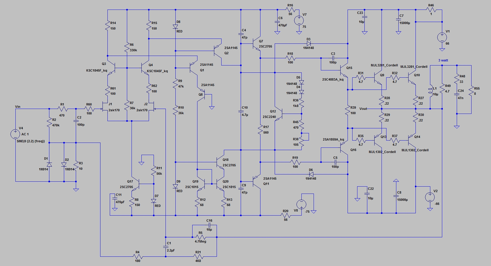

On the case of that Luxman M02 sim I can't get it to amplify, so I wonder what schematic Veysel used. Mine was based on that on the service manual, but I took away the output protection circuit.

OK, the model is fine now. A minor mistake.
Output power at 8 ohms is impressive: 246W @ 1KHz before clipping. THD at that power is 0.013%.

Here's the sim for the M02 clone I did, using available parts, particularly for the input fet.
But I'm curious about this working clone, particularly on how you solved the DC offset issue. A DC servo would be necessary with no NFB cap.
Hi carlmat
2.2uf is enough for dc offset
Q3 and q4 must be c2705
Output indicator 2uh
R2 if you use volume pot 470k, no volume pot 47k
Thermal diodes (2x1n4148) not enough for thermal compensation.
I dont like leds on current source im use 3x serial 1n4148 best.

Yes, I forgot the DC offset is controlled by the 2uF & 4M7 combo.
Legit 2SC2705 are hard to find these days, only fakes. SC1845 Are a good replacement.
According to a paper by Linkwitz, 10uH is a better choice for output inductor. In any case is something you could try and listen.
Yes, I would use a volume pot, that's why I put 470K.
Did you have problems with thermal compensation? Isn't it the bias transistor over output transistor or heatsink that keeps things stable?
I can sim three diodes instead of LEDs to see how they behave, but I think it's the actual audio quality that should define what to use.
