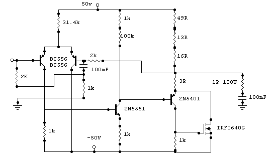

Well thank you for the emails - informing me that you really don't want to use a 2KW tranny and 279,000uF to have such a good low power amplifier, so I have reluctantly made the necessary modification to render the amplifier less sensitive to supply borne hash.
Yes it's the CCS for input stage tail current.
Imagine 1Vrms of ripple plus output commutation harmonics,lots of them 2nD,4th,6th,8th,... Ivrms on a 50V supply would modulate the stage current by 2% which will in turn modulate the IK current to the next stage by 2% from where it will be amplified by the very high Vas gain indistinguishable from signal! The over the top supply would suppress this. If we change to the CCS the divider is now the LED impedance/100K+collector - more like 0.005% and lower at high frequencies when the C across it lowers it's impedance.
Shown also is the original 31.4K which could still be inserted to ground to retain common mode signal induced 2% modulation for harmonic doctoring of the sound - but without the supply borne hash obscuring the detail.
My mate and I feel this is a far more stable design and much less needy of excessive Power supplies to perform.

Amplifierguru,
Your naughty file indicates that there is hardly any current in the LED . About 0.5mA ? Is that enough ?
Going by what's on this thread this might be one of those special varieties of LED's made in Tasmania .
Why Tasmania ?.....................Why not !

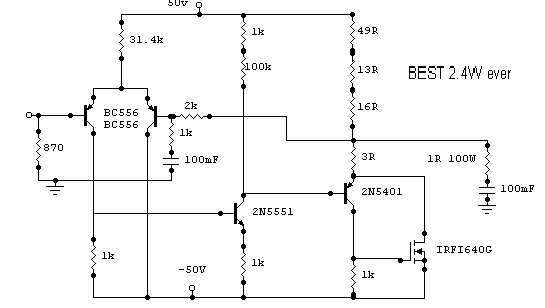

thanks Ashok & Jorge,
points noted and have morphed the wole design to something at least workable.
Trust it meets with your approval. Note in particular the "bloom" control to introduce common mode nonlinearity while retaining PSRR - for those who like to 'colour' their sound. In reality such a control could easily be added to any CCS input diff'l stage.

Guru
At least now we have a gate stopper - not as sublime as a base stooper but will do.
Change it for a 0.1% Vishay (well, Caddock may do if you do not have the real one) in TO220 (this is VERY important!)
And get ready for a big surprise!
