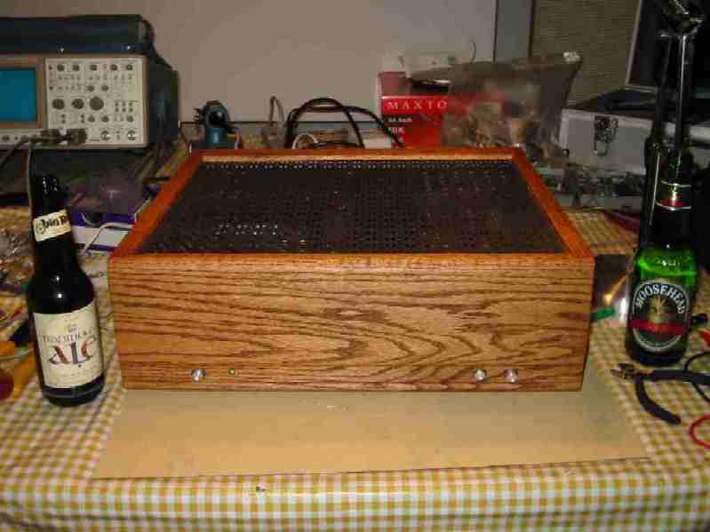

Ok, ok, here are a couple of shots of the new amp. The case is red oak with 1/4" aluminum base plate and steel top grill. Finished with watco danish oil stain (walnut) it came out pretty nice. The led on the front switches from red to green when the soft start circuit engages (very cool!) - thanks Paulb.
Dave
/note the correct geographic placement of the assembly aids 😎

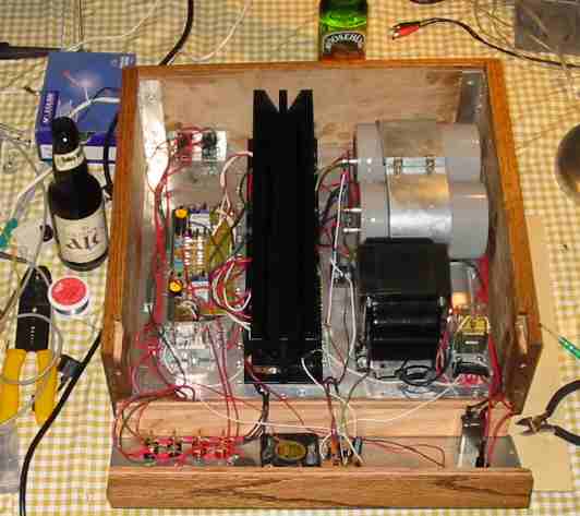

One more showing the innards. The transformer is a hammond 300va with +/-30V secondary. Caps are 68000uf computer grade. Lots of salvaged parts used, mostly from old computers. I used AT power switches for the speaker selectors and the on/off switch. I added the fan during testing cause that heat sink might not be big enough
Dave

A great looking amp AND a Tek 2465...
