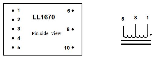

I think I have toasted a pair of these by applying too much heat when soldering leads to them🙁 I have 2 meters that act funny when I try to measure them and I get no sound from the amp when they are installed. Put the grid resistor back and works fine. I suspect I must have melted the internal connections to the pins. Could these be repaired or am I SOL?😱

This is a center-tapped coil. I would recommend to connect a 9V battery + pole to each pin 1, 5, 8. The - pole should go to your multimeter common. Check if the voltage appears on the other pins, with the multimeter in 20V setting. This method will not do harm to the choke, because the DMM has 10Mohm input impedance.
Direct resistance measurement is not a good method, because the DMM would try to send some test current through the DUT, and measure the voltage drop. But as soon as you apply a current on the choke, a high induced voltage will appear on it that confuses the DMM.

Worked perfectly, I am very pleased with your test😀 Although I perhaps should not try tests like this before morning coffee, both meters were next to each other and I could not get a reading until I realized that I had connected the battery negative to the negative probe of the dmm not turned on😱 Really appreciate your help🙂
