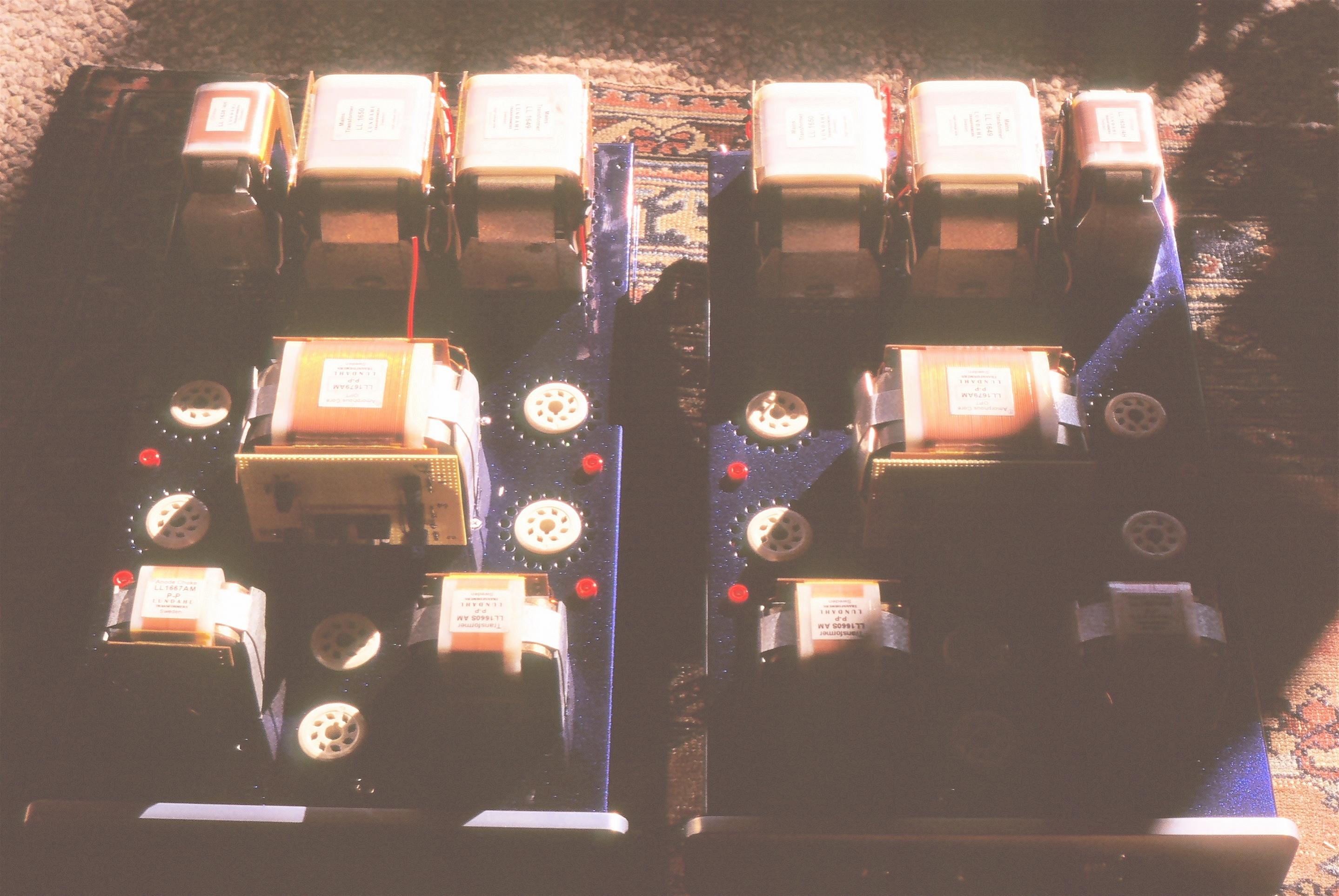

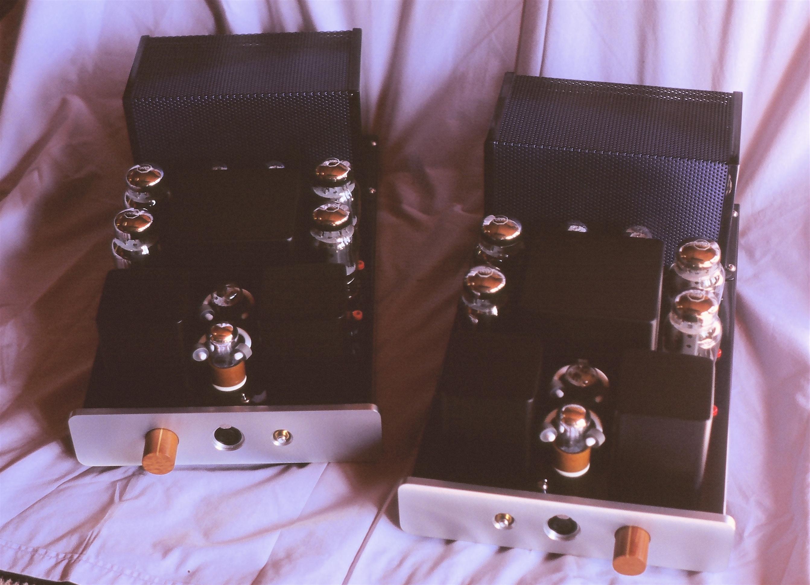

Here are some photos of my PPP 6550 (now KT-120) mono-blocks with LL1679AM output transformers. I have been listening to and improving them for the last ten years. Note all the Lundahl iron. I made Kevin Carter, the U.S. Lundahl distributor a happy man when I started this project!
Lundahl input transformers are top notch, also some of the line output and interstage transformers. I also use a LOT of Lundahl chokes but for some reason the power output transformers suffer from rather high interwinding capacitance and are accordingly limited in their high frequency and impuls behaviour. FWIW.

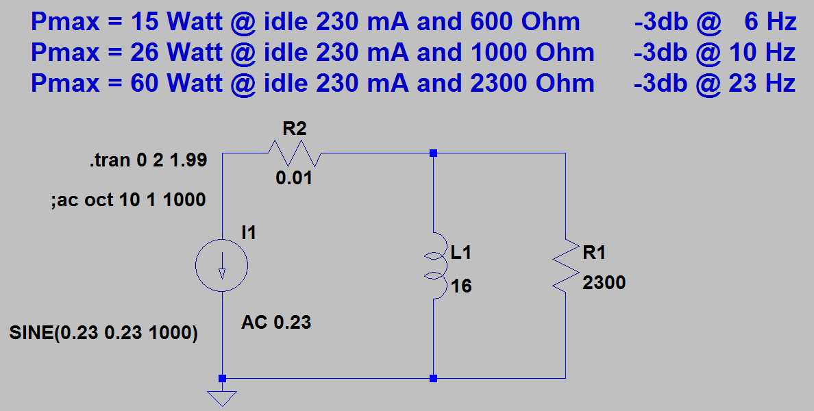

Hi there,
I am also confused by the LL1693 datasheet. Its single ended version with a 450µm air gap allows 230 mA standing current and can be wired to reflect 600 Ohm, 1000 Ohm and 2300 Ohm.
According to Pa = Isquare * R maximum output power @ 600, 1000 and 2300 Ohm should be
0.230 mA square / 2 * 600 = ca. 16 Watt
0.230 mA square / 2 * 1000 = ca. 26 Watt
0.230 mA square / 2 * 2300 = ca. 61 Watt (cave low frequency response)
However, the datasheet says
140 W @ 600 Ohm
70 W @ 1000 Ohm
35 W @ 2300 Ohm
That cannot be true, because with a given current as the limiting factor the output power must increase with R and not decrease. I think it is an error when they wrote the datasheet. Probably it should say
35 W @ 600 Ohm
70 W @ 1000 Ohm
140 W @ 2300 Ohm
But this would require a standing current of sqrt (35 / 600 * 2) = 340mA.
I neglected the static resistances of the coils. Or am I that wrong???😕

Your observation is correct. In fact with just 230 mA DC one will never get more than 16W into 600R and 26W into 1K. Again the power ratings are wrong (or are not consistent with the voltage ratings, if you like).
However the power rating should be assessed using the primary voltage available for the signal. Assuming the latter is correct in the datasheet and 0.9T are due to the DC current and 0.7T are left for the signal, one can apply 235V signal regardless of the primary impedance. This means 92W into 600R, 55W into 1K and 24W into 2.3K. These are the maximum power ratings @30 Hz in theory (i.e. with the correct DC current). Clearly 230 mA DC is enough only for 2.3K.
For the other two impedances the gap must be increased (which Lundahl usually can do on request) to allow more DC current for the same 0.9T (so that those 235 Vrms are still available for the signal). This will come at expense of primary inductance but it is ok being the impedance lower. Approximately one should need at least 330mA and 550 mA DC current to achieve 55W into 1K and 92W into 600R @30Hz, respectively. Changing the gap to withstand such DC currents the primary inductance should become approx. 12H for 1K and 7H for 600R.
The conclusion is that this OT is not really universal as other Lundahl transformers, in the sense that once you pick one configuration the others will be fairly or completely compromised.
