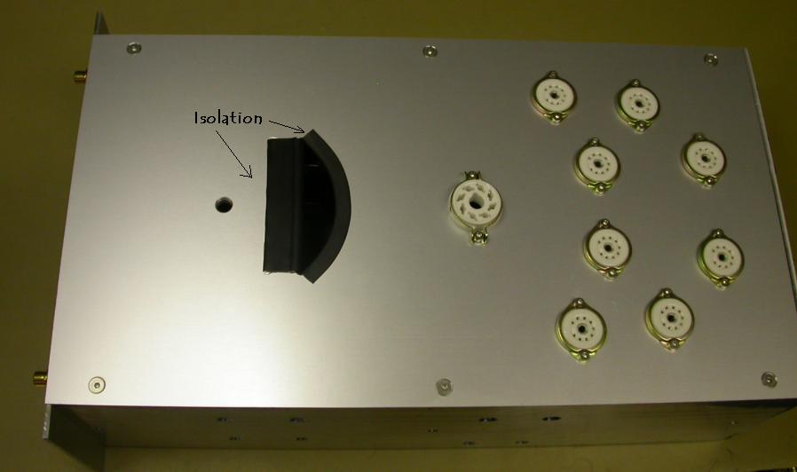

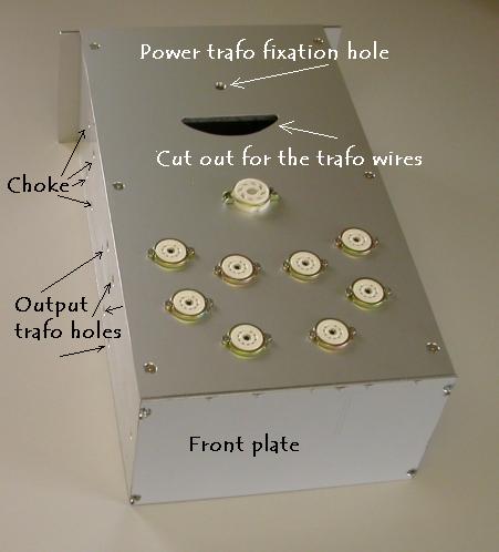

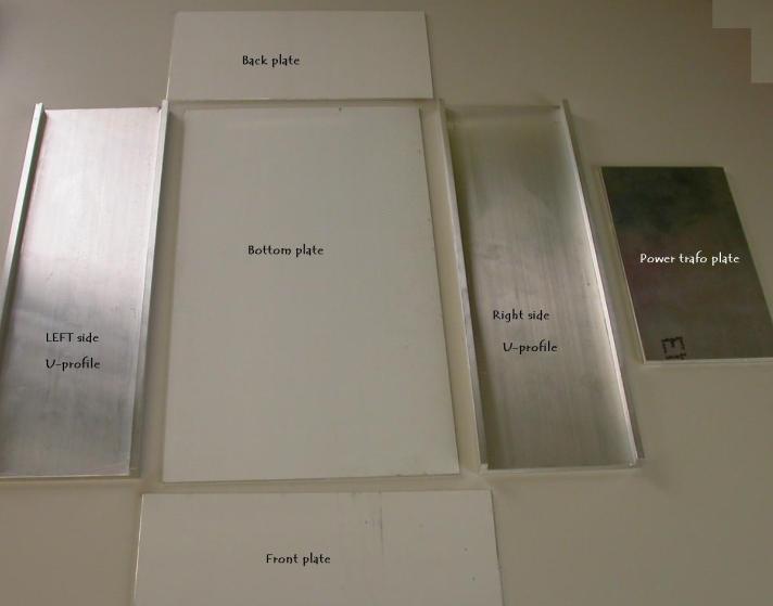

Here is the materail layout and the "dry" material assembly.
As you can see the left/right plates are made from U-profile.
The front/back/bottom/top plates are made from 3 mm thick brushed and anodized aluminum plates (the top plate is not on the photo).
On the left side you can see a "smaller" plate called Power trafo plate.
The purpose of this plate is visible from the assembly picture.
trif.

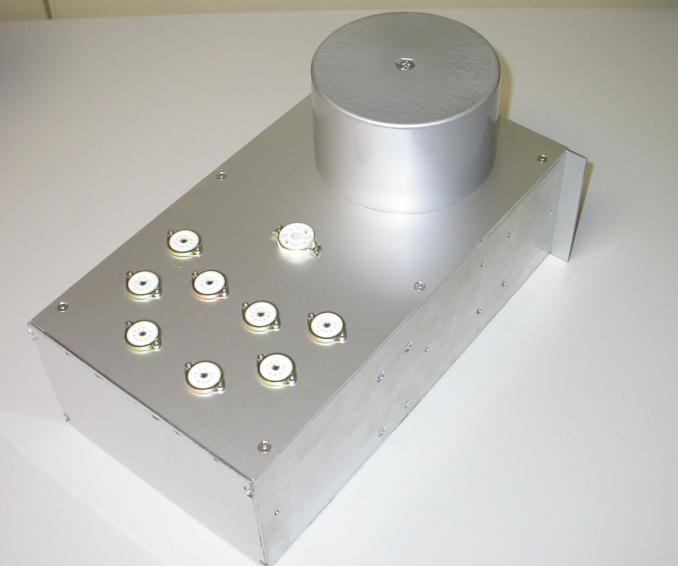

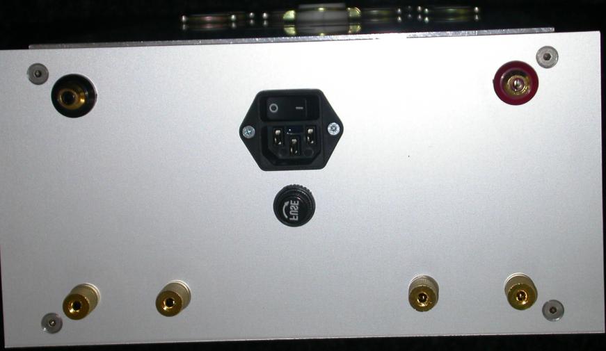

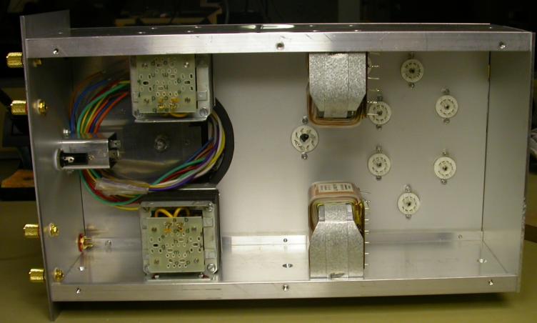

And finally the assembled enclosure. No inside electrical work is yet done. The power trafo is big, and will be on the top of the enclosure.
Note: the choke(s) (1 choke/channel) and the output trafos are inside the enclosure - I have indicated the fixation holes for these trafos.
On the front panel the hole for the potmeter is still missing.
trif.😉
The enclosure with the power trafo.
It is heavy.
About the topology:
the end-part of the amp will be like the BV, the splitter will be made by the 6922, but the front end will be different (also made by another 6922).
trif.
Karma,
Thanks for the good words.
I wanted to have an ellongated design, so the top plate is 400mmx220mm.
I have made sure that the center of the tubes are 50mm from each other. As I wrote, I will use 1 choke/channel (the chokes are also nicely visible in the "inner" picture).
trif.
