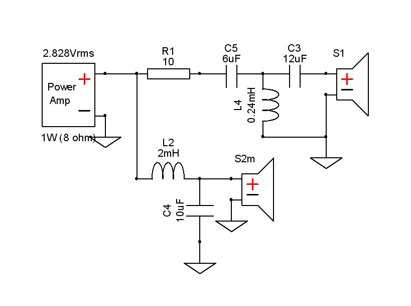

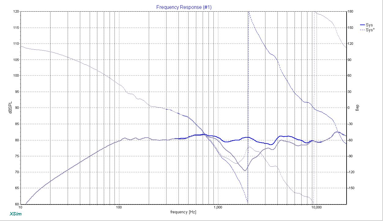

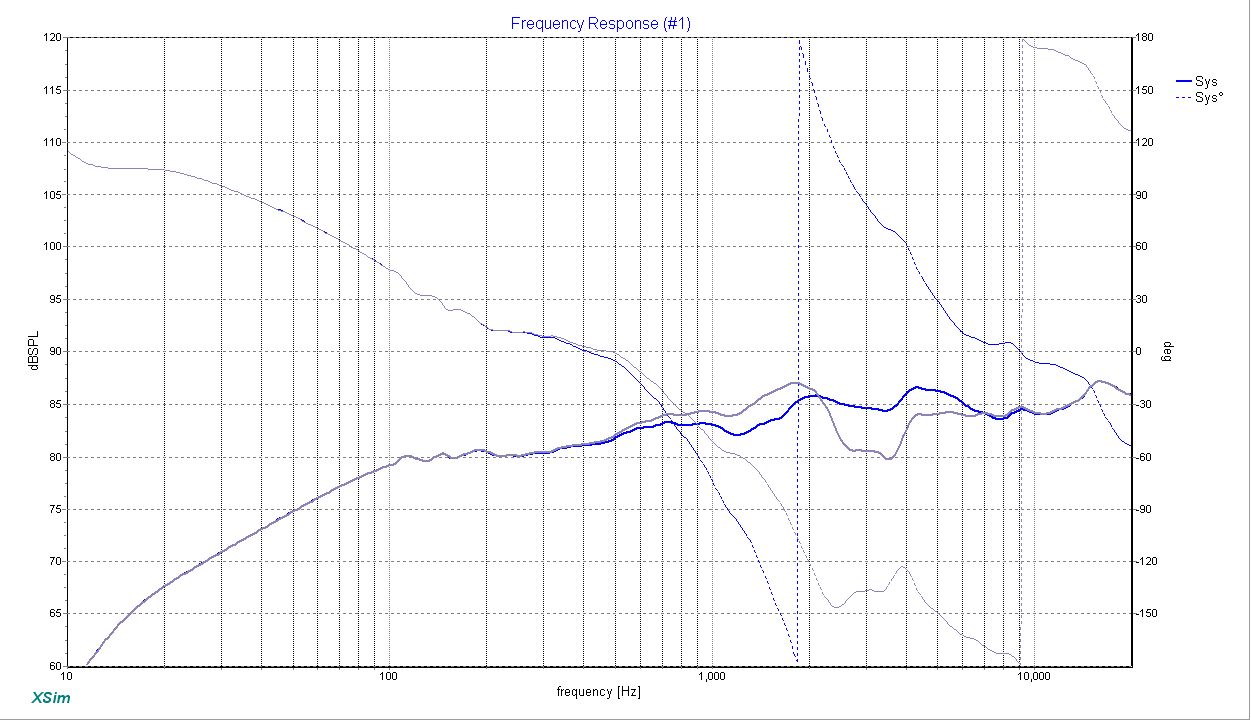

I have tried to make some sense out of the data available.
The cabinet was simulated as a very large sealed one, so
I haven't used any other impedance plot but the manufacturer's
in free air because the usual one modeled with TS parameters
doesn't track the measured one with enough accuracy.
Grey curve is out of phase, blue is in phase.

This is a pretty premium kit as far as components go and I am surprised that it doesn't sound good. Photos of your implementation as well as a microphone measurement would really help to pin point the problem. If you can afford a $1200 speaker in parts, a $60 mic and free REW software is a trivial investment to better sound.
Founder of XSA-Labs
Joined 2012
Sounds like you need more baffle step compensation. Your box volume is a little less than what was recommended. A mic measurement would clear all this up. Small floor stand or bookshelf speakers when away from floor and walls tend to have anemic bass due to -6dB. Falloff of bass from baffle step. My guess is it needs more resistance on high shelf filter.
