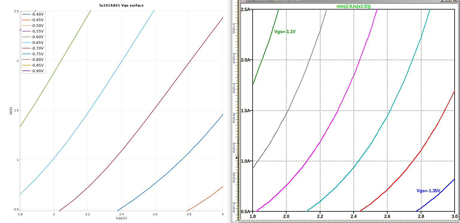

I finally got around to resurrecting my FrankenTracer and made plots for a single LU1014D mounted to a copper heat spreader. This LU1014D, out of a batch of 50 pieces appears to be genuine,

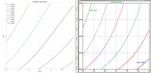

Here is a comparison of my LU1014D measurements vs. the SPICE model from Zen Mod posted at post #178 LuDEF.
Other than the Vgs range being offset (to be expected) they look quite similar,
