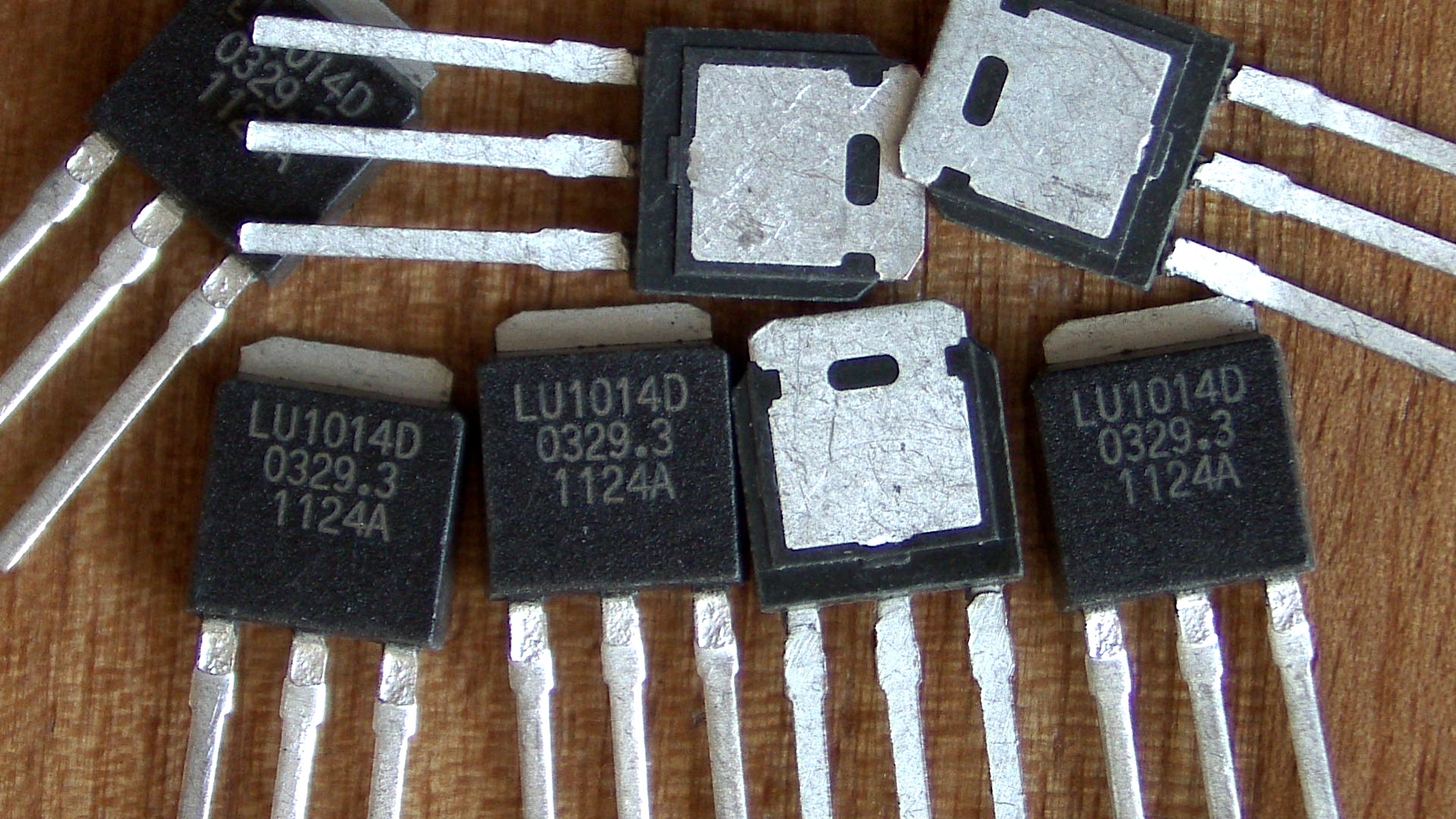

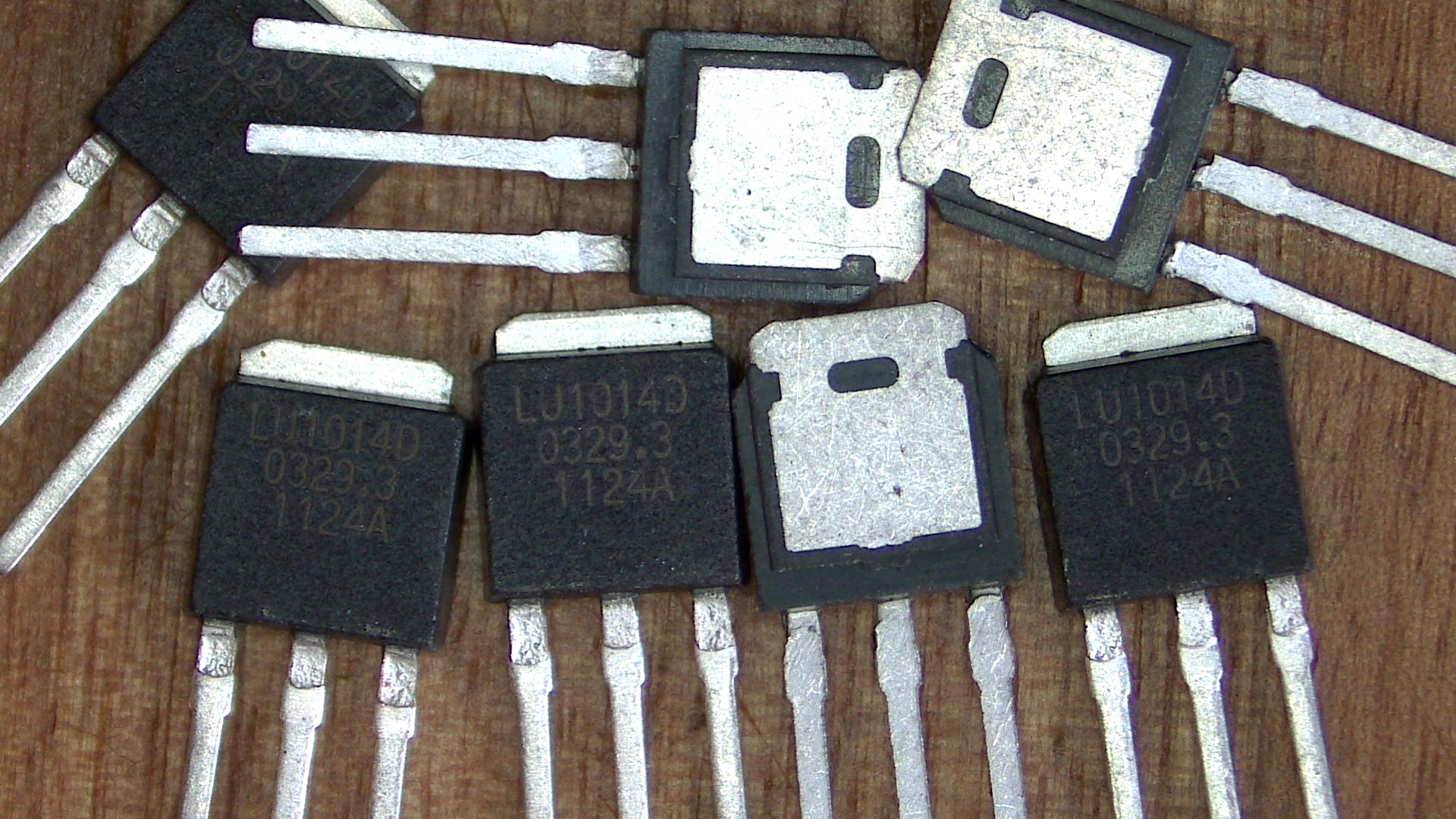

Closeups
If those marking are original, then those FETs are from the same lot and less likely to have been scavenged from old equipment. Just a guess.
maybe even pulled from pre-production bin; never used but prepared for mounting, needing short pins

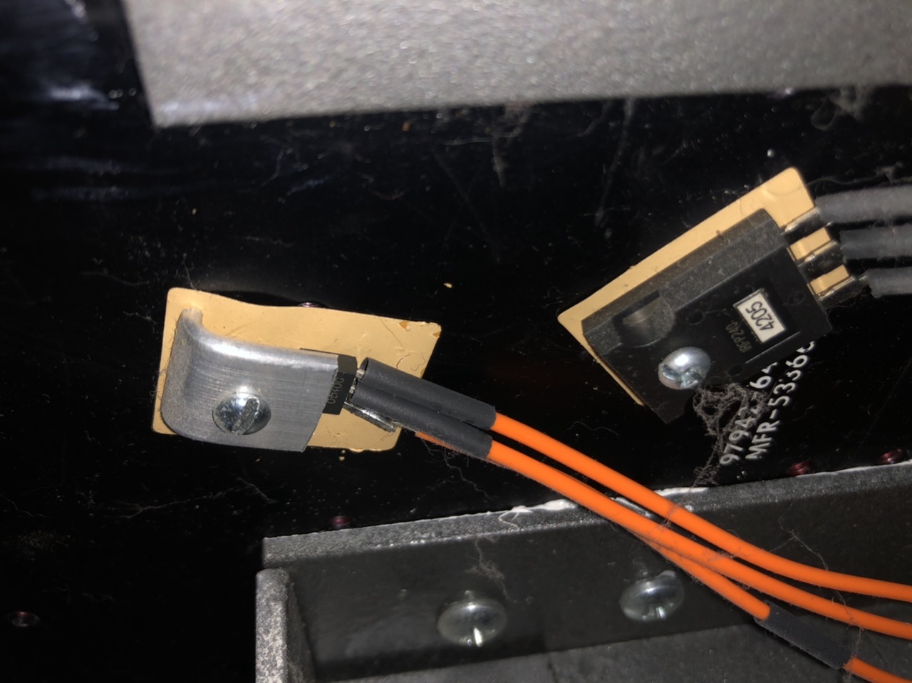

Where did you get that bent aluminum piece that's holding down your LU1014 from?
I drilled a hole in a small piece of aluminum, then bent it in a vice.

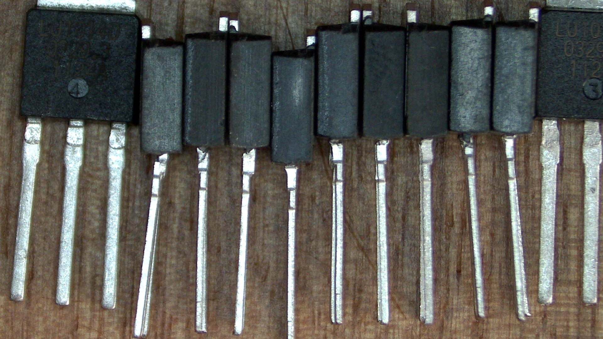

Closeups

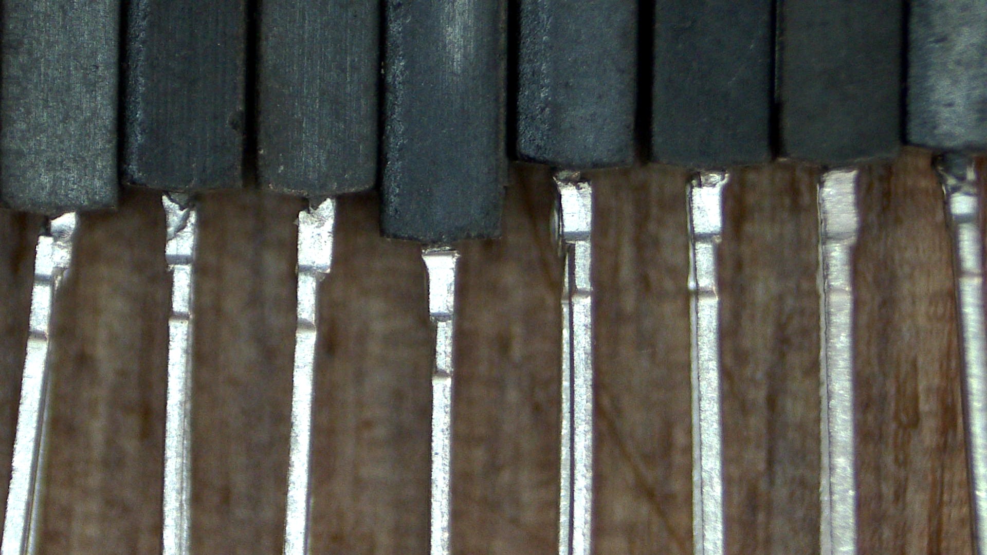

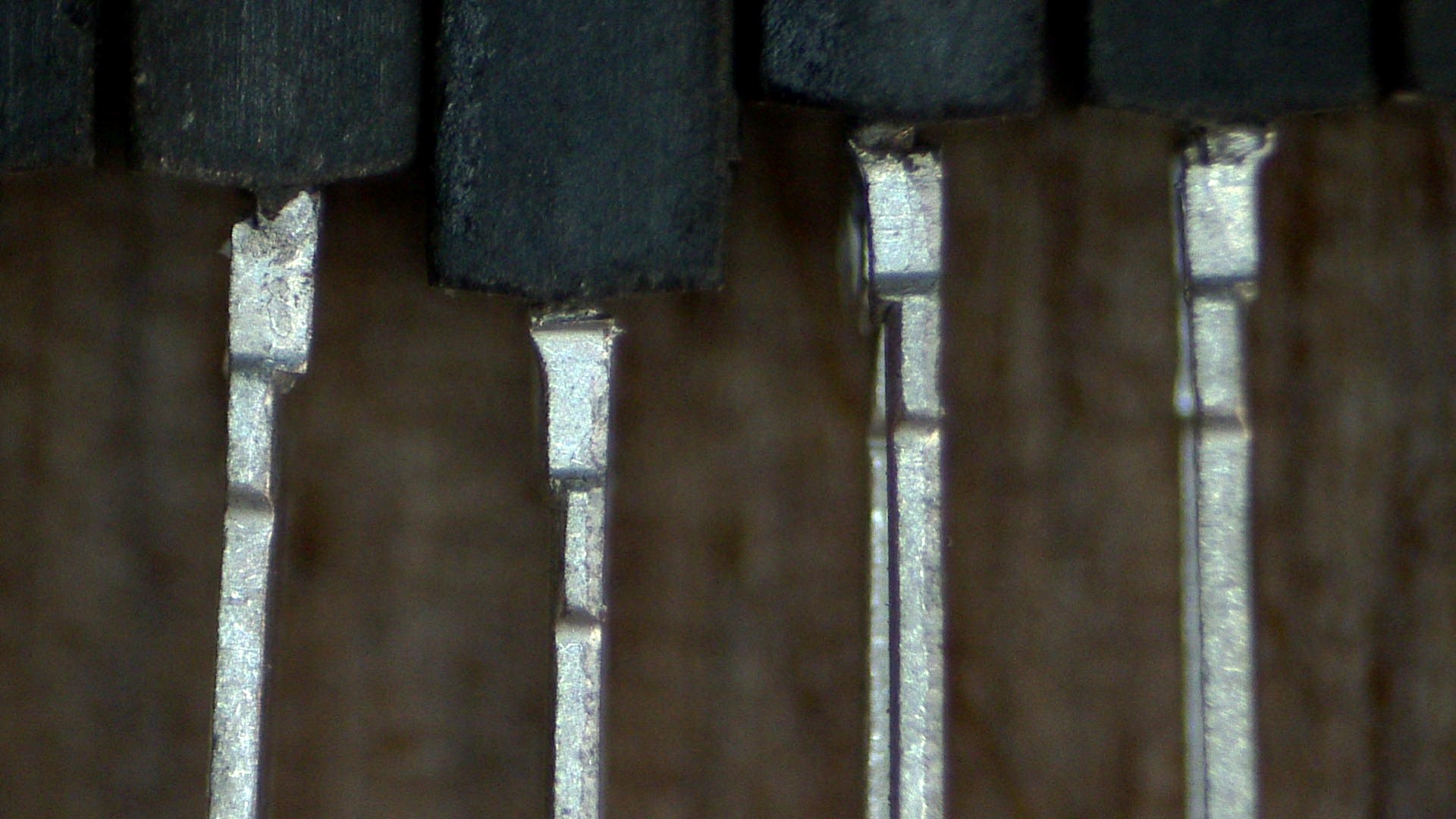

Please show close-up side view of the pins. If there is no obvious step, then it is just an odd-looking lead formation.
The LU1014 datasheet specifies a leg length of 6~7.6mm.

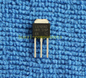

And this one is certainly a new invention.
An LU1014 with IR logo, on ebay.
The normal price from Grey and from Deep Surplus umteen years ago was already > 4USD per piece.
If someone offers you 5 pieces of the "same" at even less, you honestly expect them to be genuine ?
Patrick
Patrick
