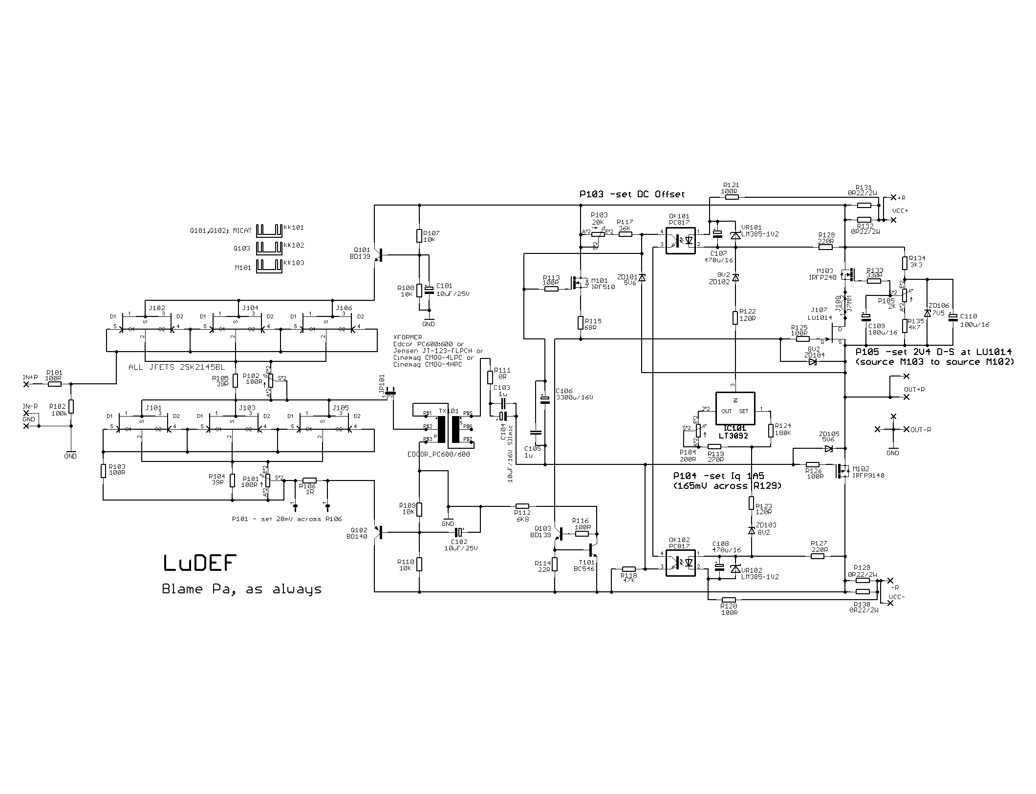

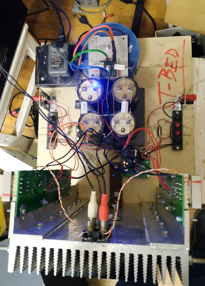

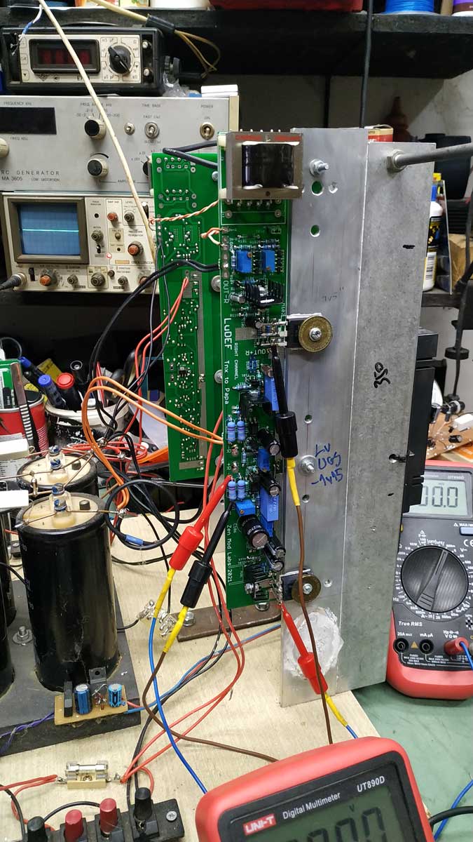

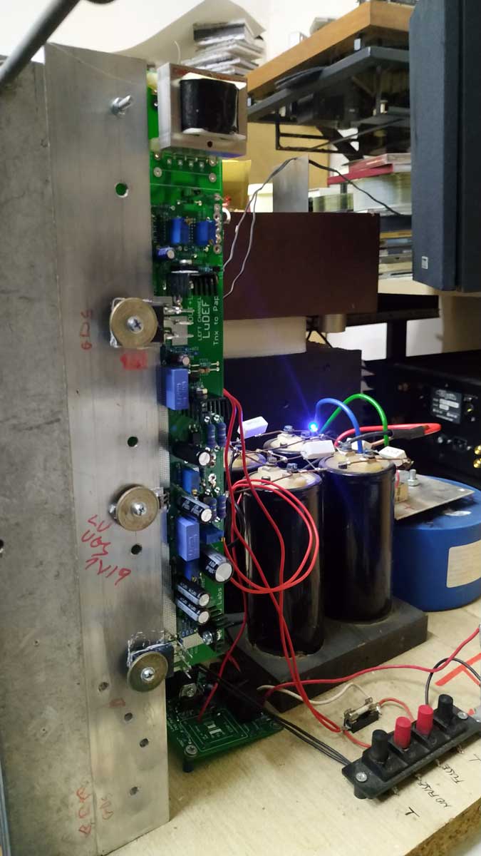

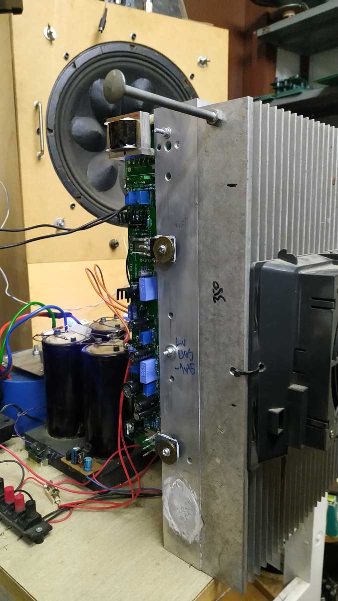

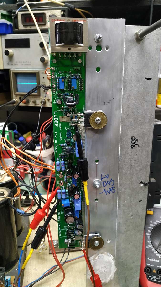

First one in last series of xformer FE amps
Even if I really like, adore and prefer level of Organicity, gotten with that approach (buffer- autoformer gain - no overall NFB loop) ....... what's enough, it is enough
so this one is one of "Look Ma, with no hands!!" thingies ( when I was a Kid, first time driving bccle without hands on bars, enduring endless flack right after) .......
So - this one, Look Pa, no SITs!!*** :rofl:

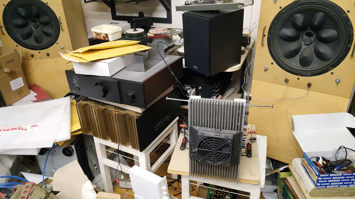

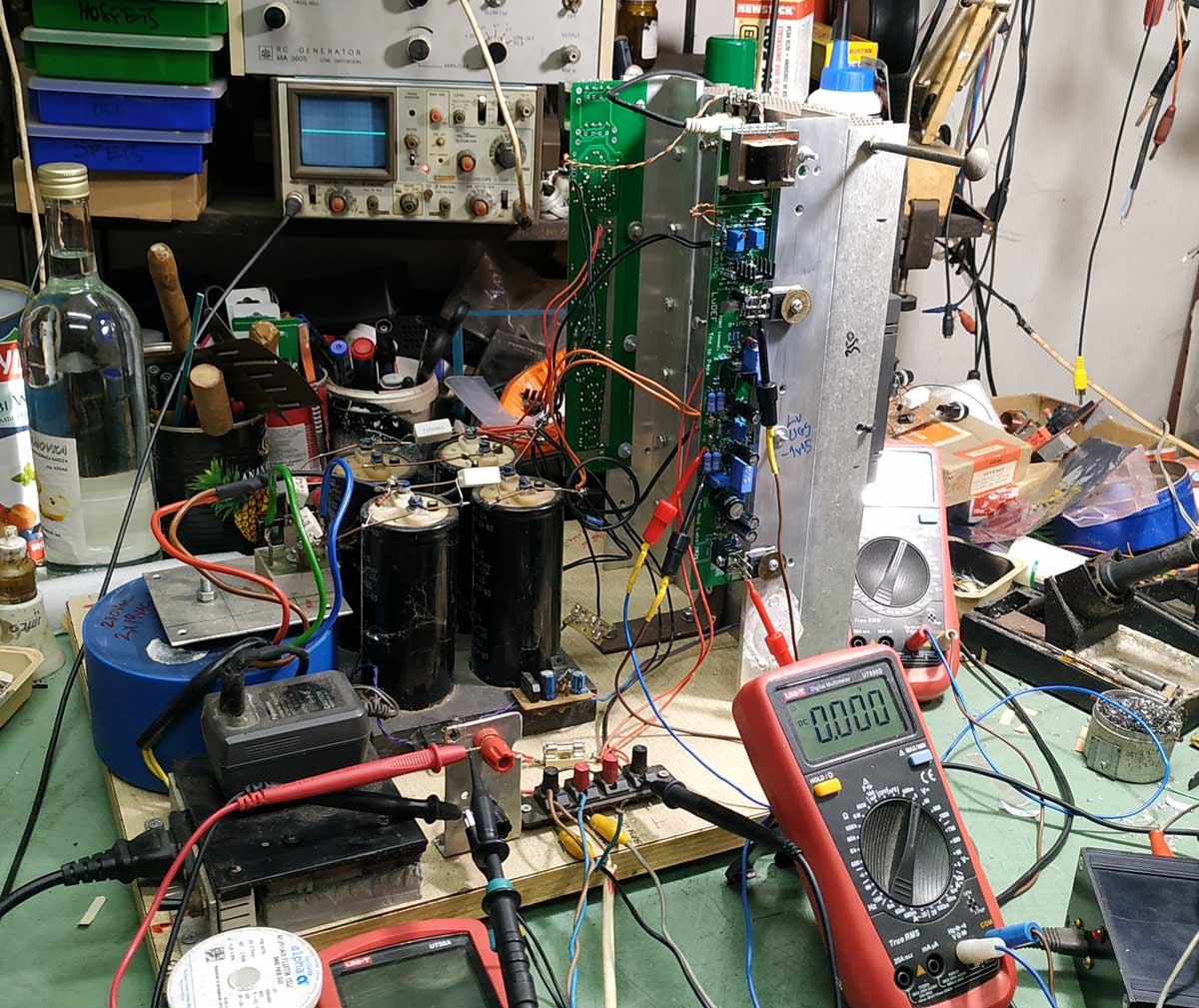

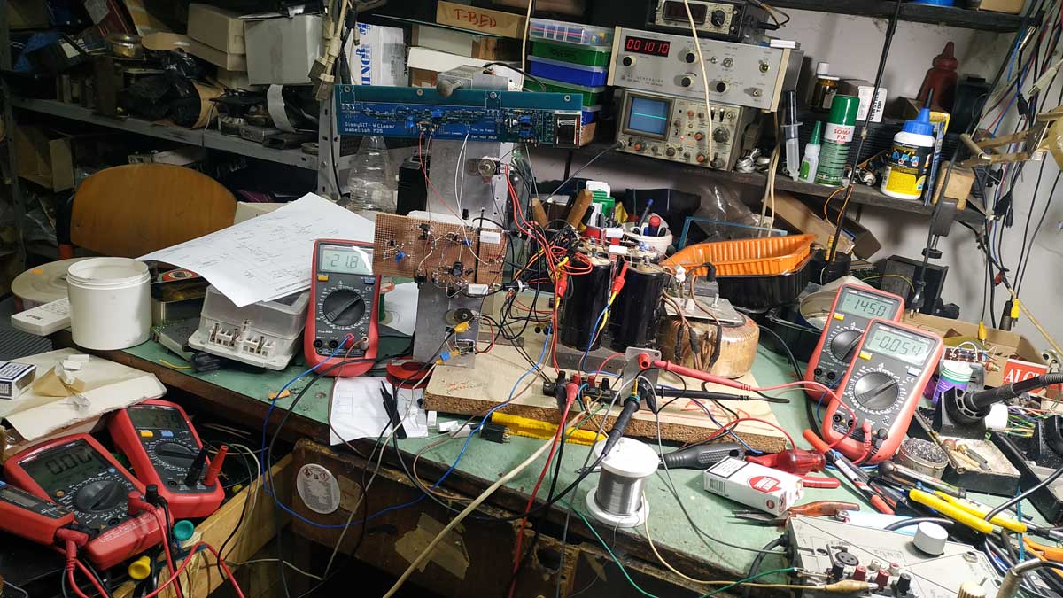

Had a short listening session this evening, right after finishing it on T-Bed, sorta overwhelmed.
Will listen more tomorrow, but have a feeling that I'm not going to change a thing, pretty much done that while prototype was in Ikebana shape
What sims predicted and I got in vivo - insane THD levels; can't explain, can't explain......

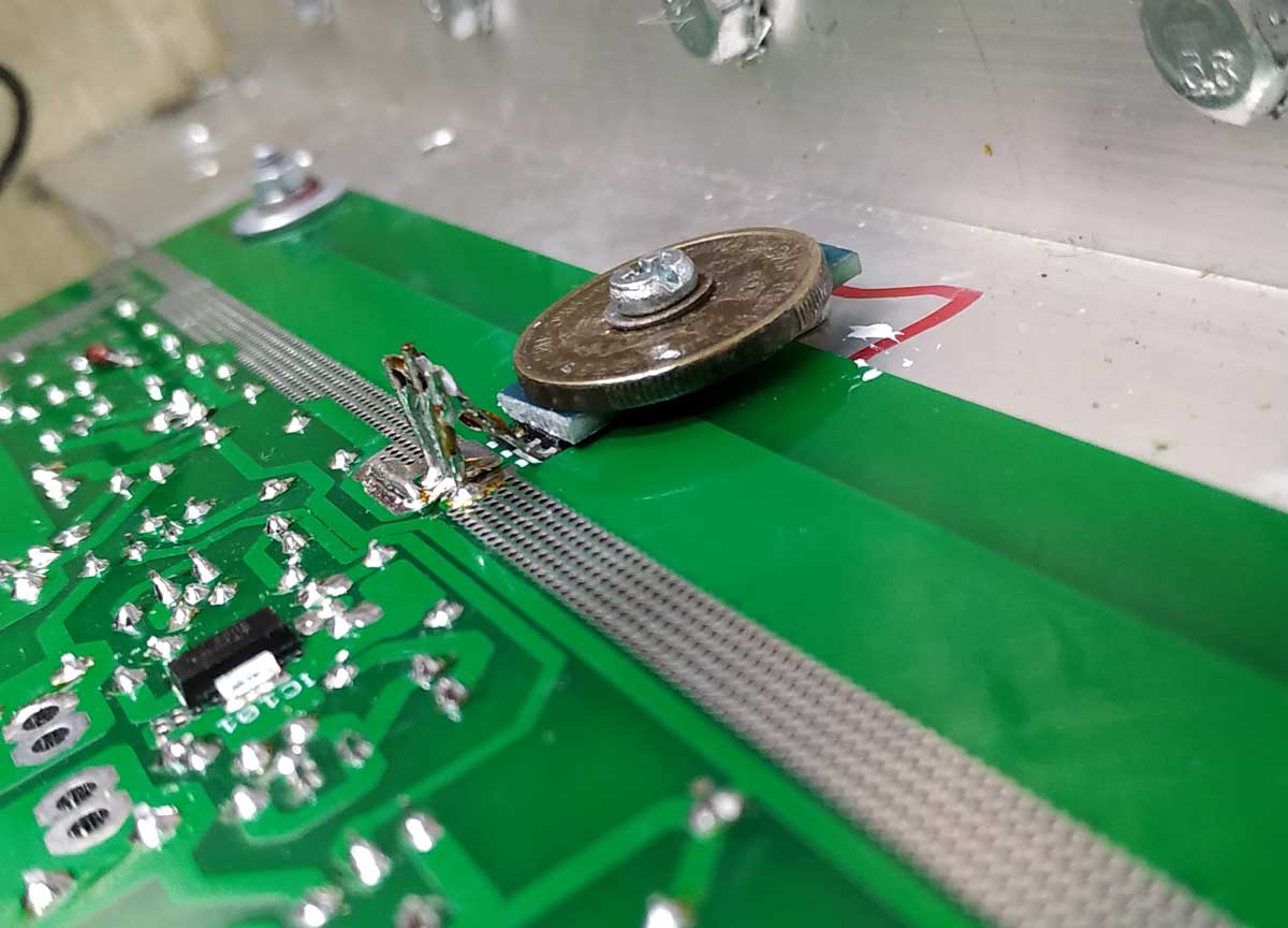

Of course - things can be varied a little, but as far as I'm concerned - only in one way - varying Uds of LU +/-100mV ( so down to 2V3 and up to 2V5, now sweet spot being at by Papa prescribed 2V4, F3 Beastie)
So, this one is first, more to come

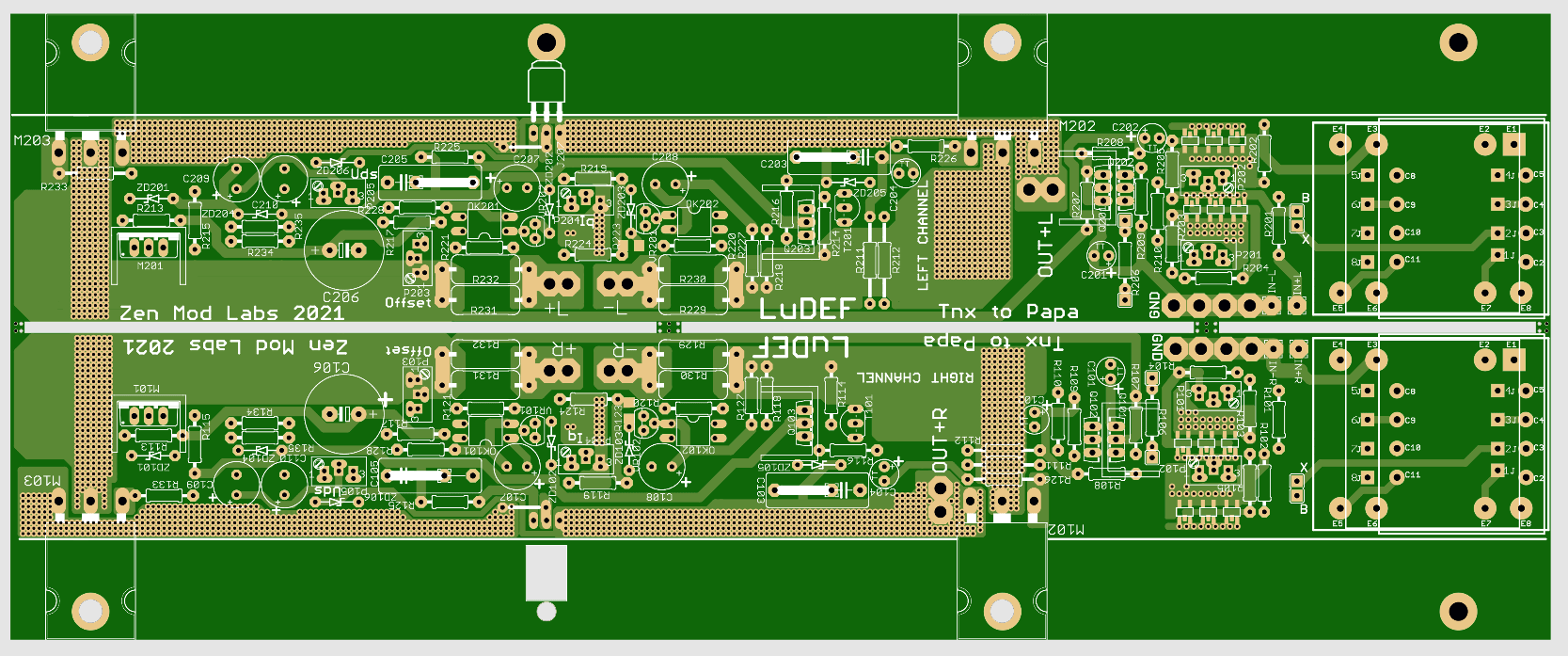

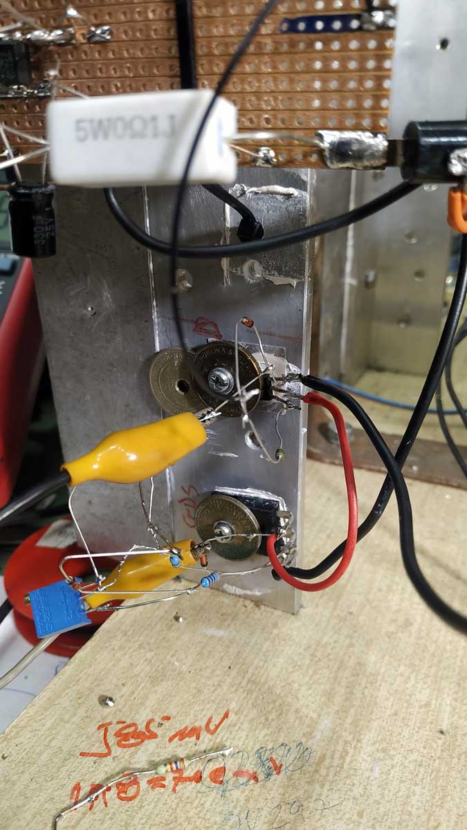

Rails - usual FW format ( Donut having 2 of 18Vac sec. windings) , Iq and rest of details written on schm

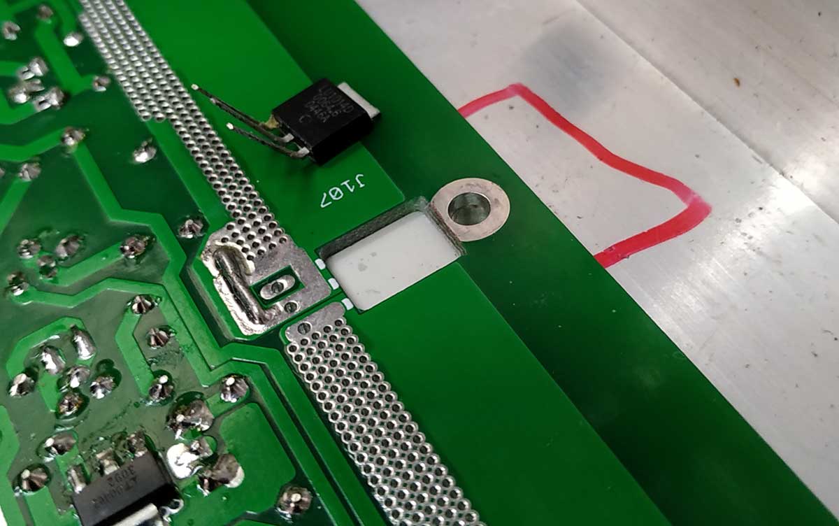

***Dilemma - is LU SIT, or not SIT?
:rofl:
edit on 30.04.
: PSU is regular FW Format;
my iteration of same is - per channel - 250 to 300VA Donut with dual 18Vac secondaries, two Graetz bridges, filter bank 33mF-0R1/5W-33mF, per rail

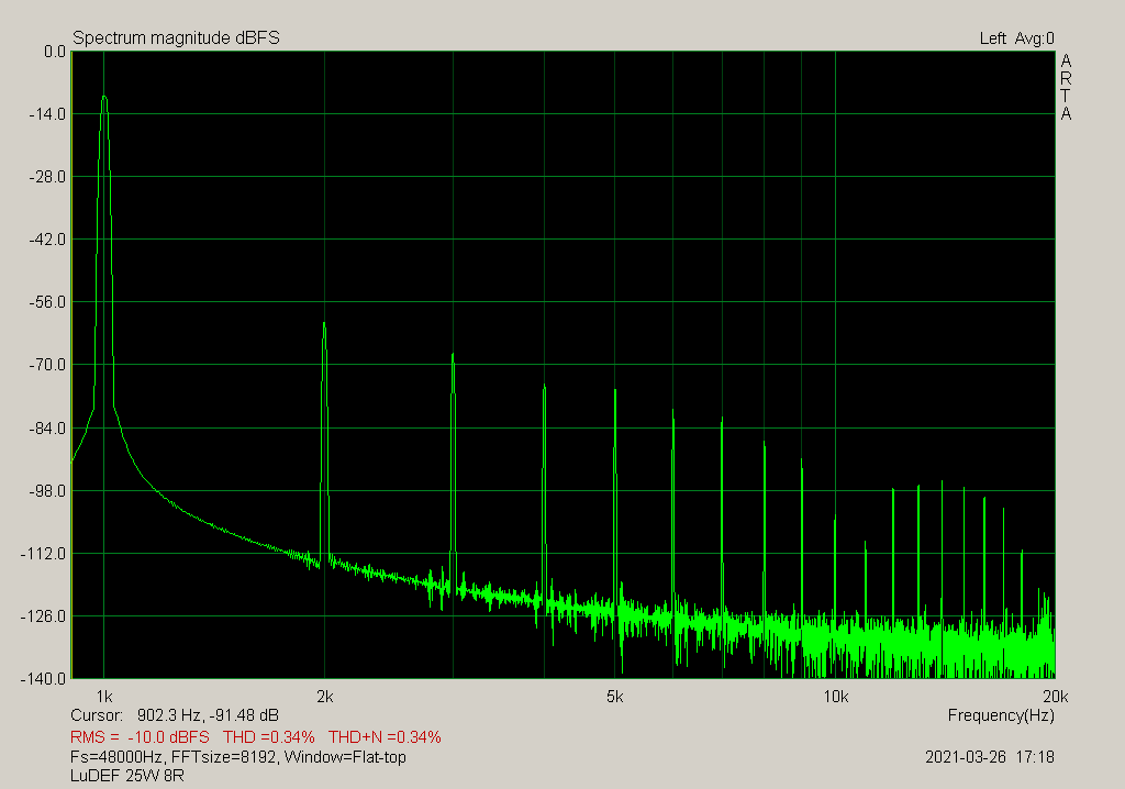

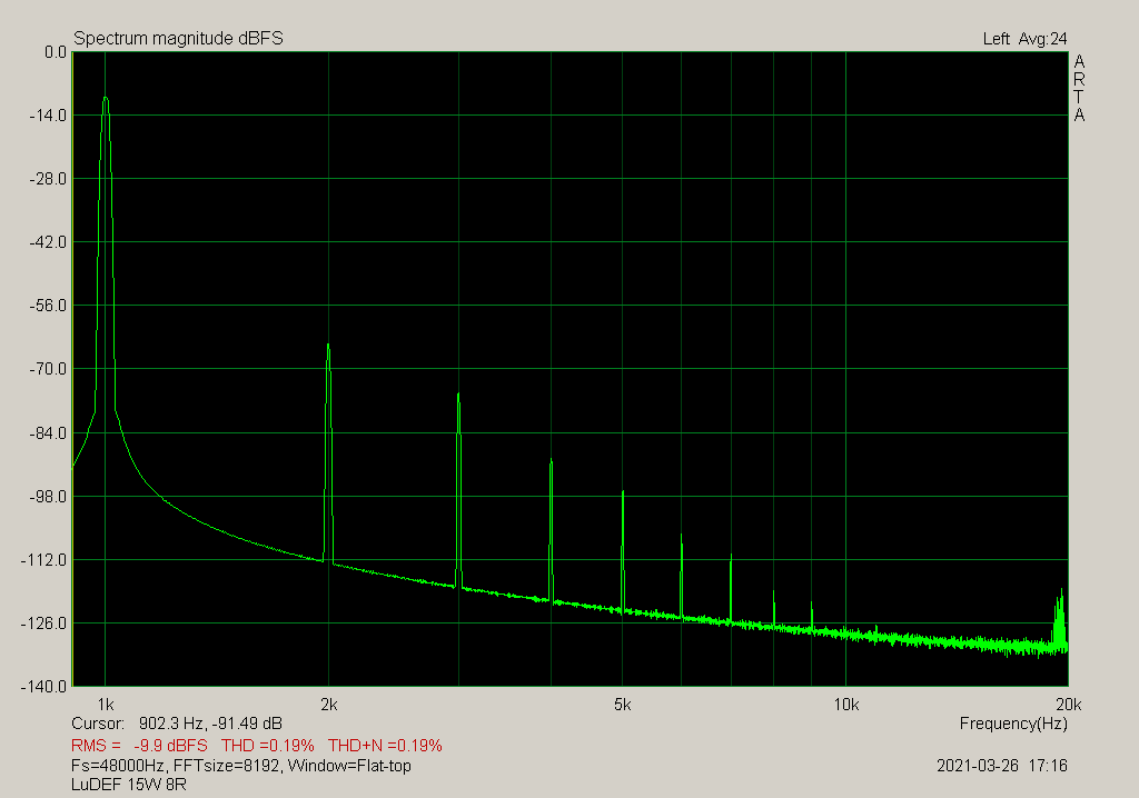

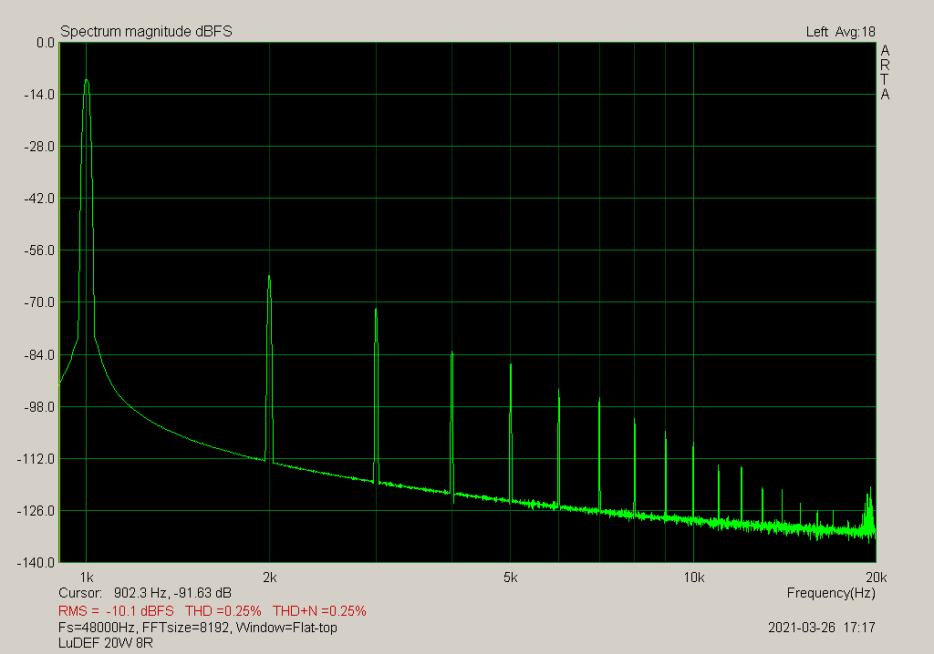

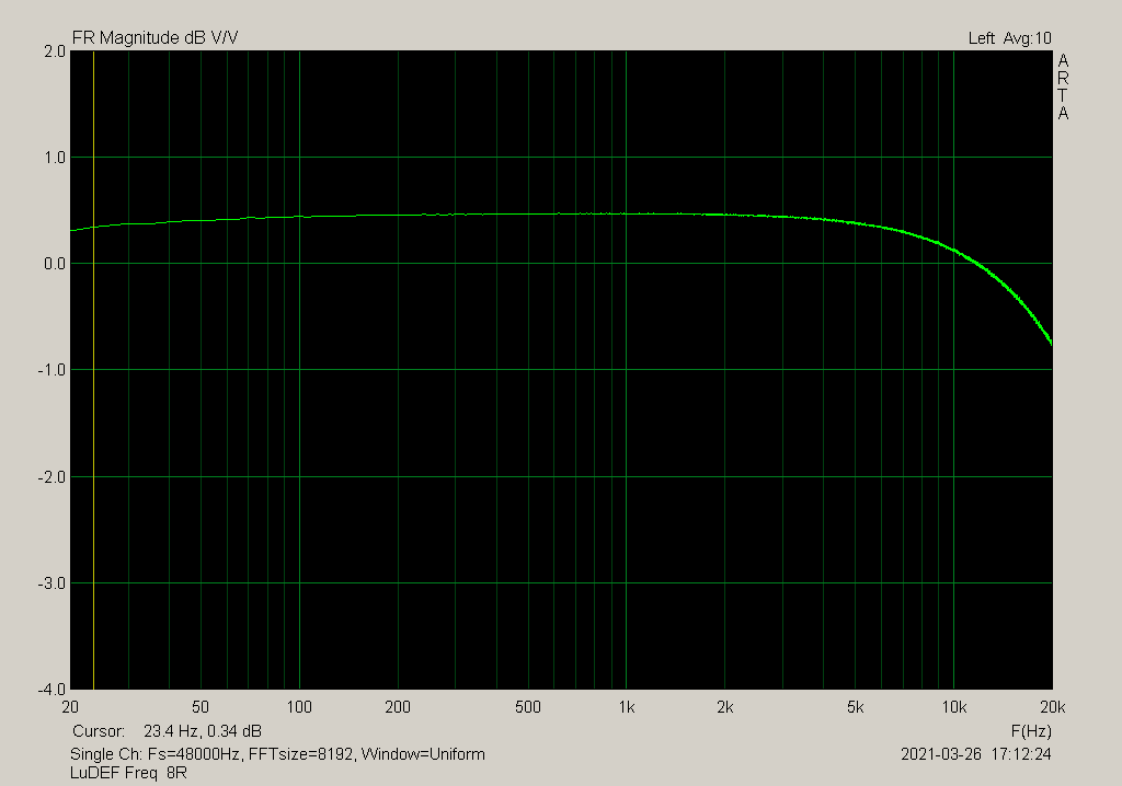

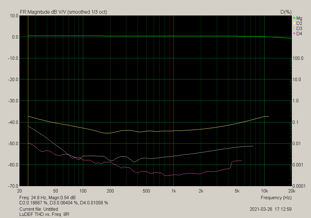

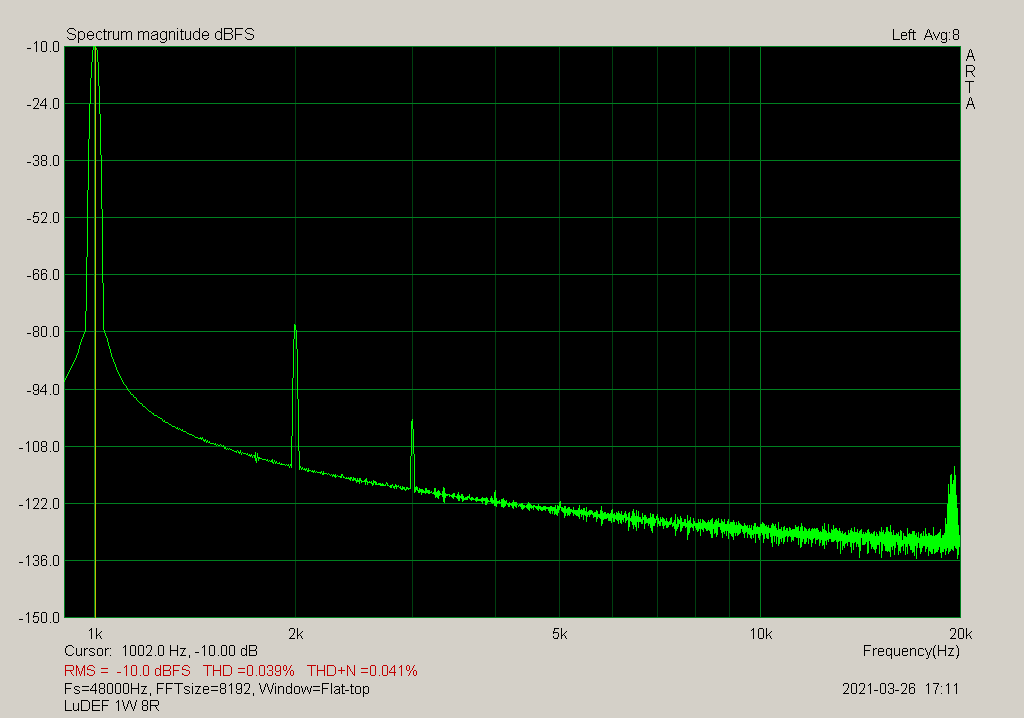

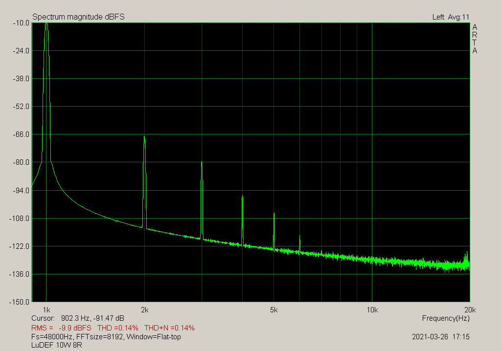

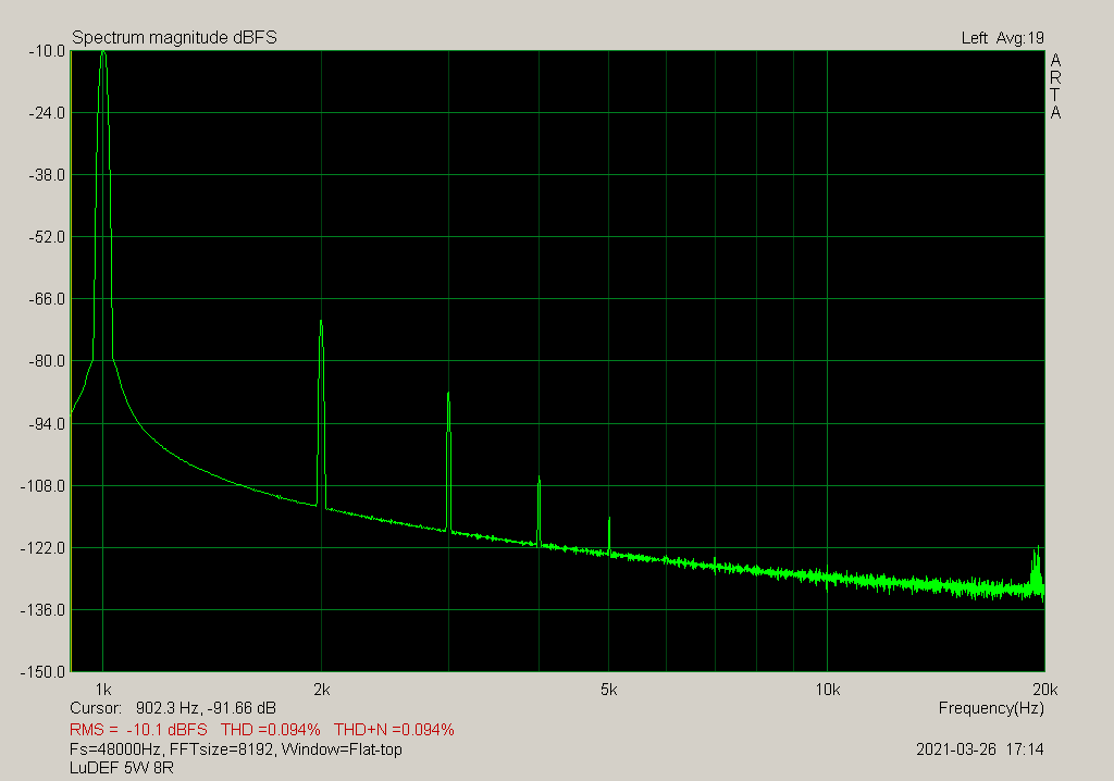

Measurements , 8R load
EMU1212, ZM's crummy interface box, ARTA

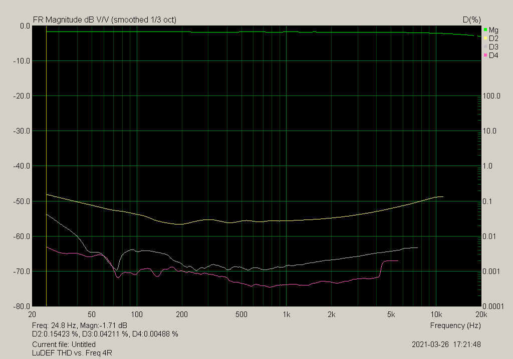

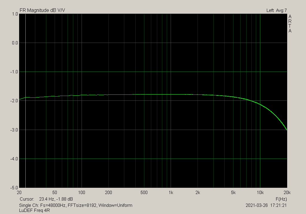

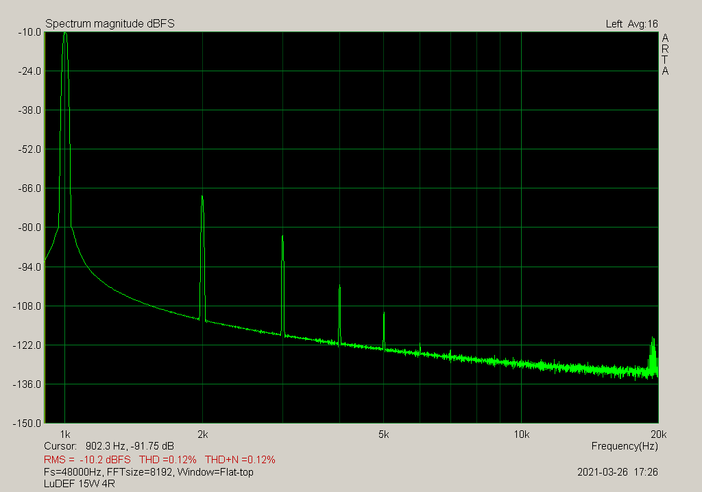

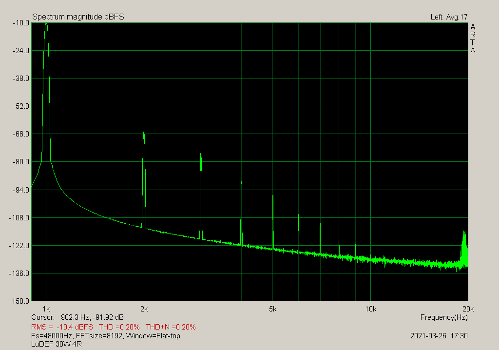

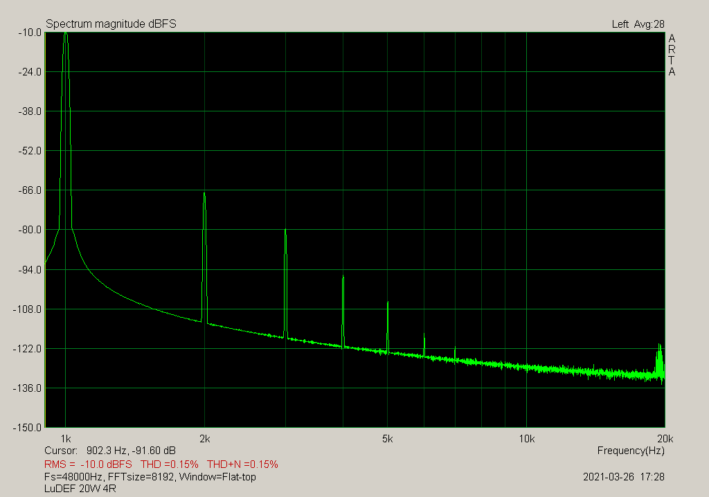

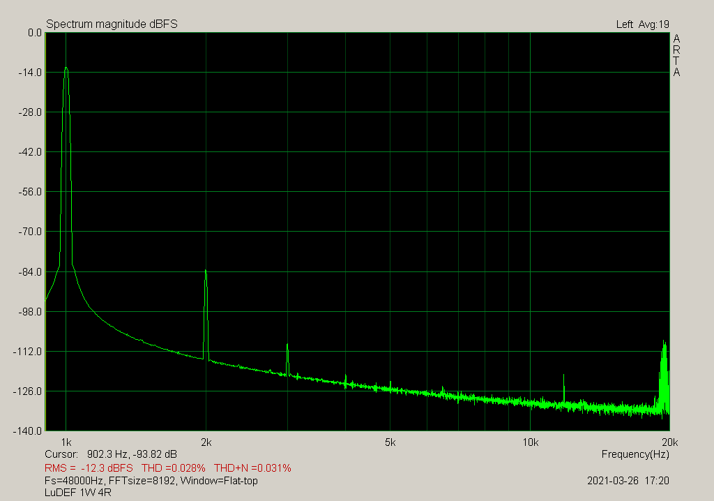

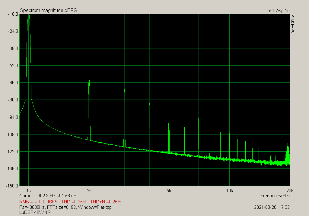

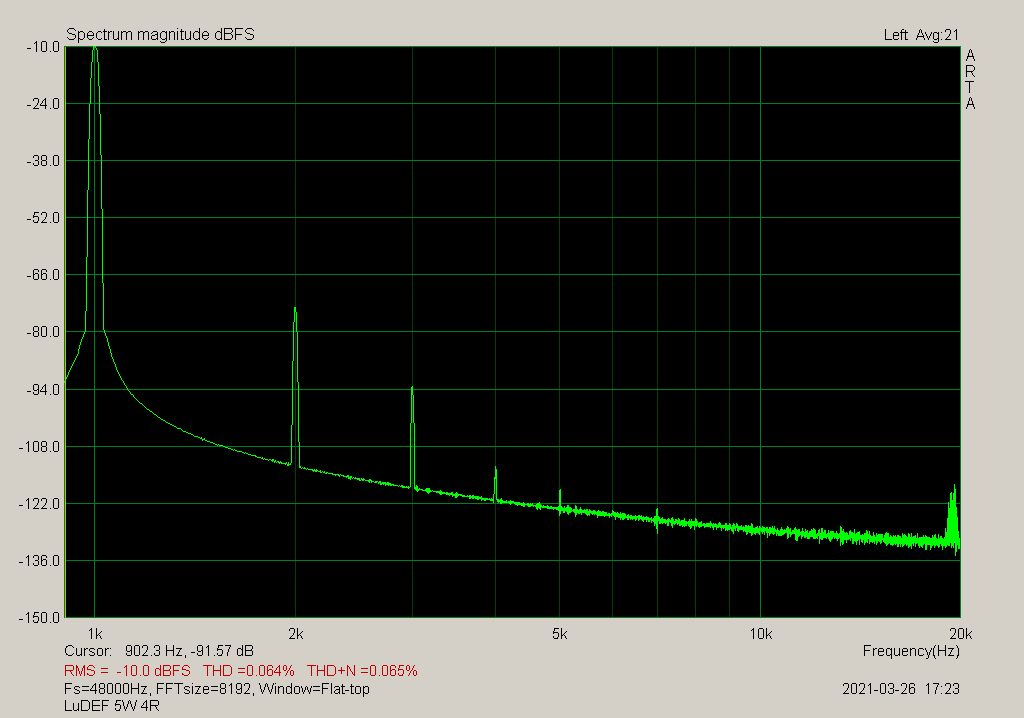

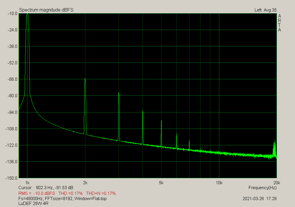

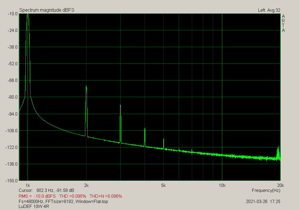

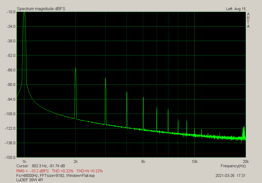

Measurements , 4R load

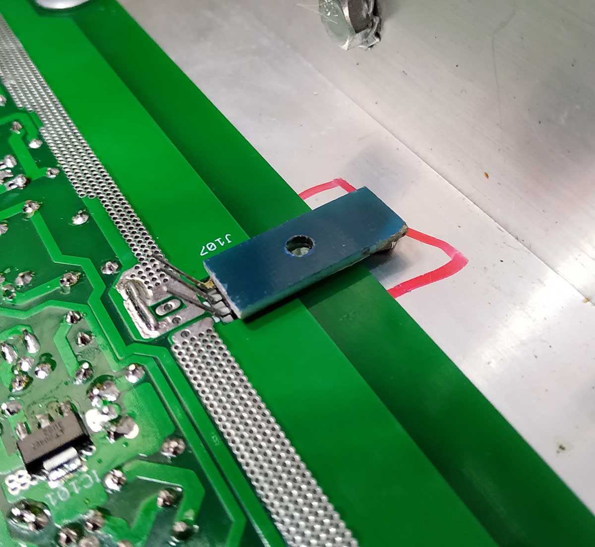

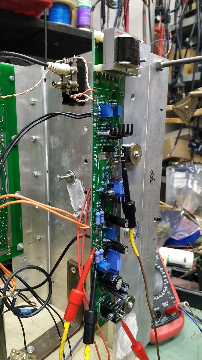

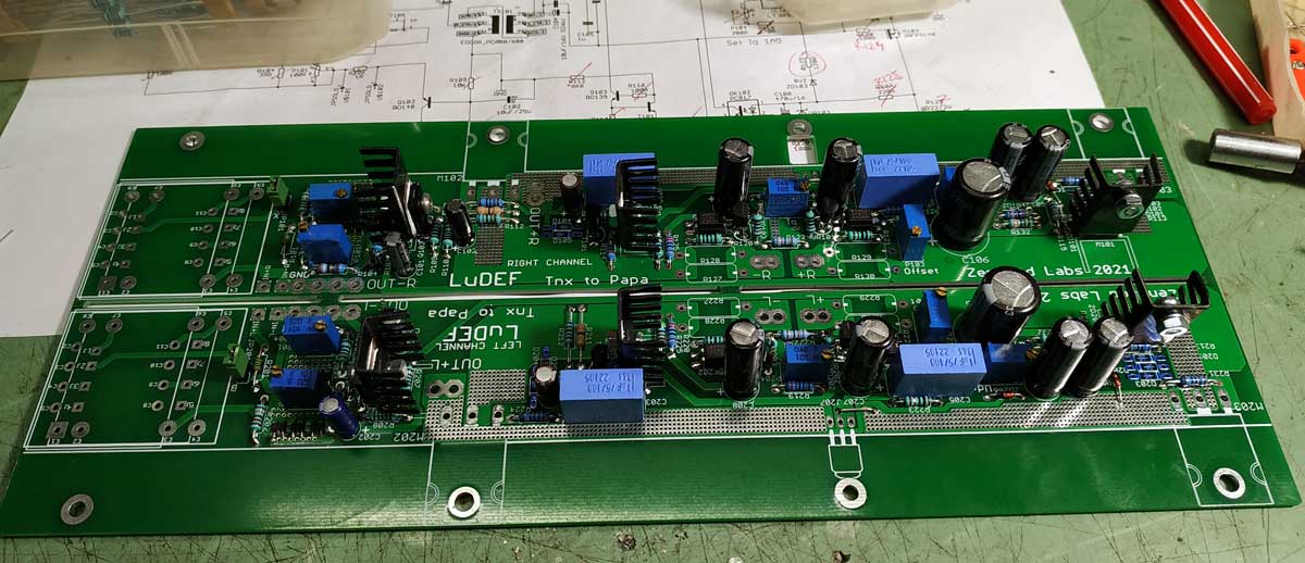

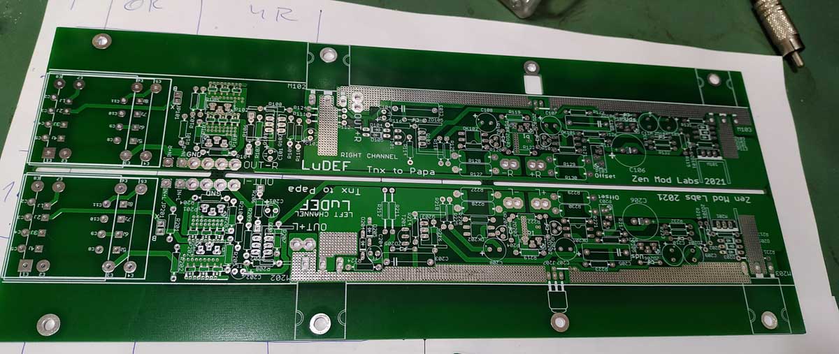

funny pics, will try to put them in some logical order

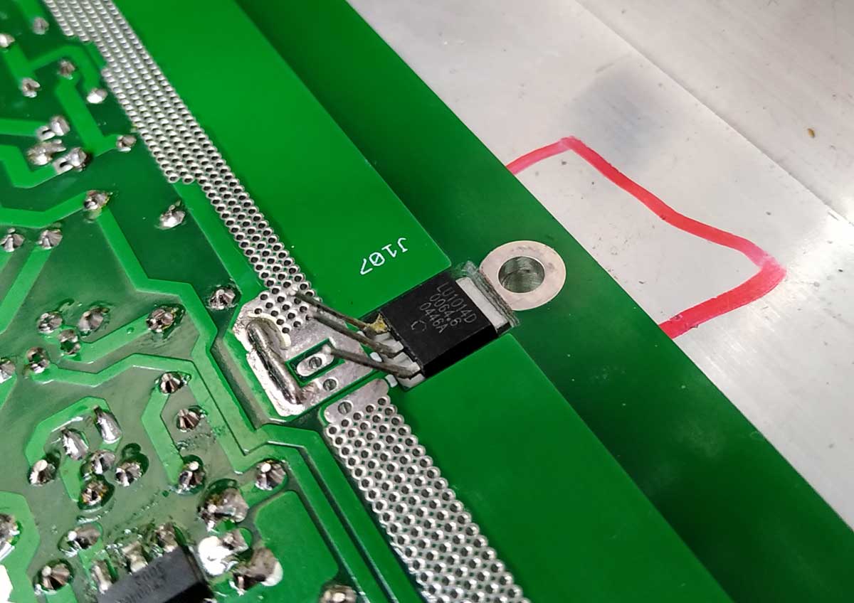

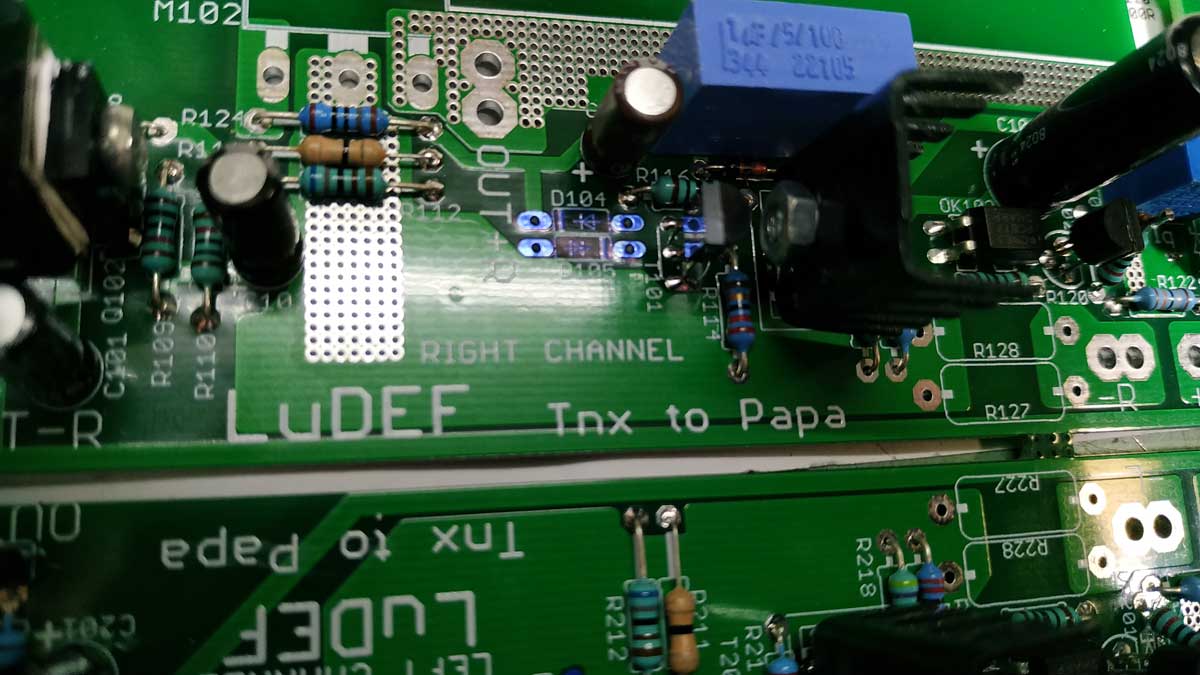

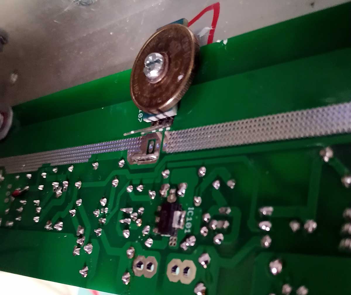

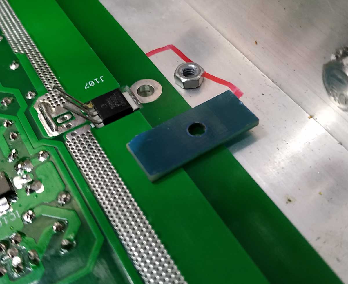

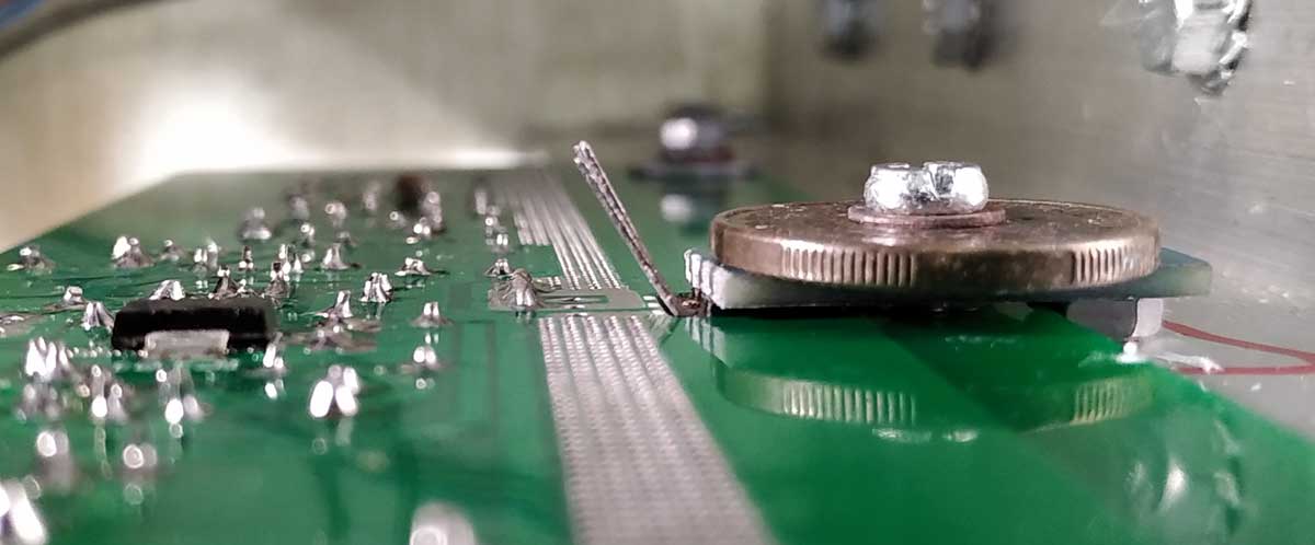

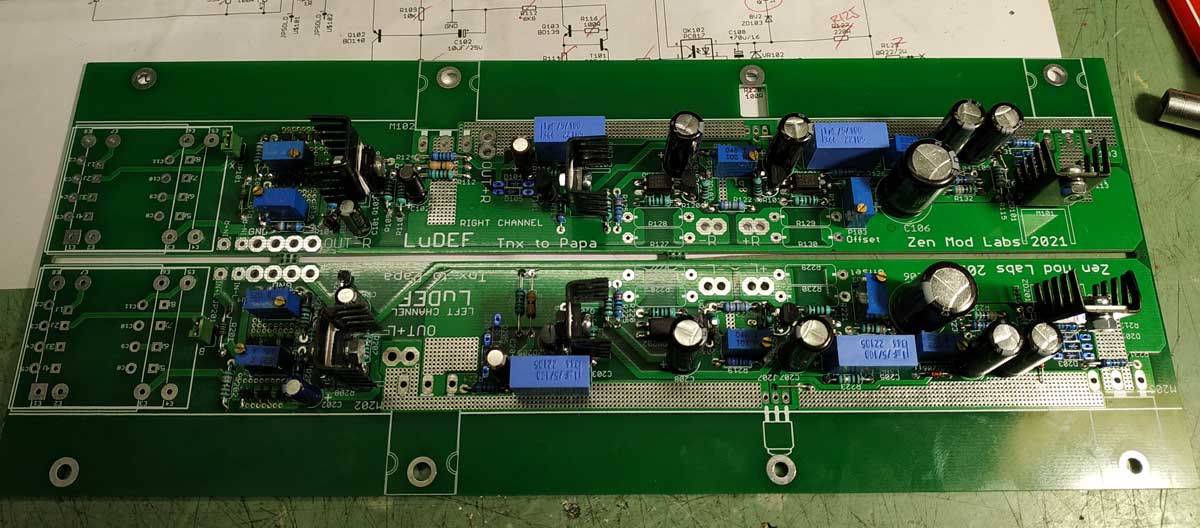

Looks like fun. :cheers:
oh yeah..... it was (an it'll be) fun .....

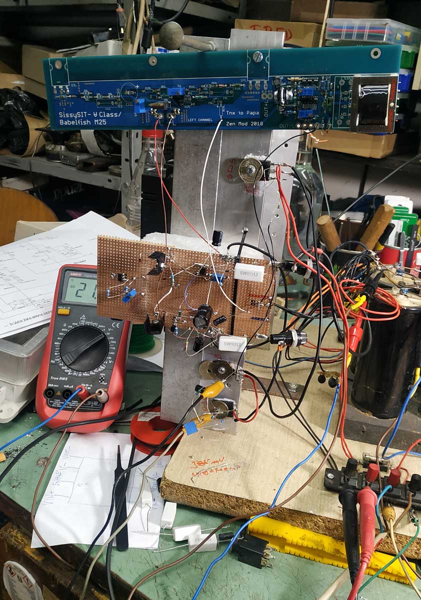

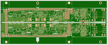

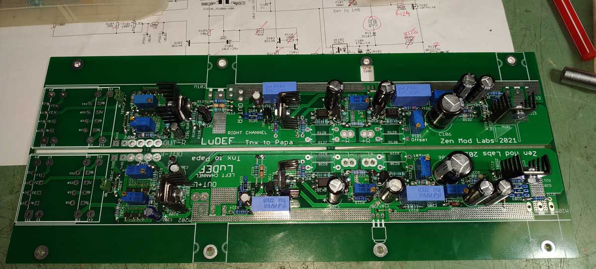

LuDEF
SissySIT R.3 (any SIT Ugs)
Babelfish M25 R.2
SET (Schade Enhanced Follower, called Schade enhanced Thingie)
Old Soul (Fat Germanium and usual mosfet in OS)
Old Soul Bip ( Fat Bipolar and usual mosfet in OS)
Il Penitente ( just Fat bipolars in OS) ..........
then all of these - with active FE and overall loopNFB, instead of xformer cell
we'll see which ones would live after final listening tests - all of them passed Ikebana Mono Sessions with ease .......
