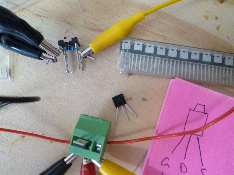

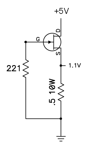

Using a hi-current supply thats a little lower than 5V, and three tested parts I'm getting about 1.1V at the test point.
...which suggests they're genuine parts?
Is this conclusive evidence that they are genuine? Or is there another source resistance value that can be checked to confirm the part.
I just had a quick nosy at the zv9 article again and using the test mentioned there (Gate to gnd, Source to 1R to GND, 3V at Drain) getting me a Vgs of about .9V at just under 1A. My 1R is two .47R's soldered together though, so I guess it could be a little under 1R. Still pretty close to the suggested 1A result though.

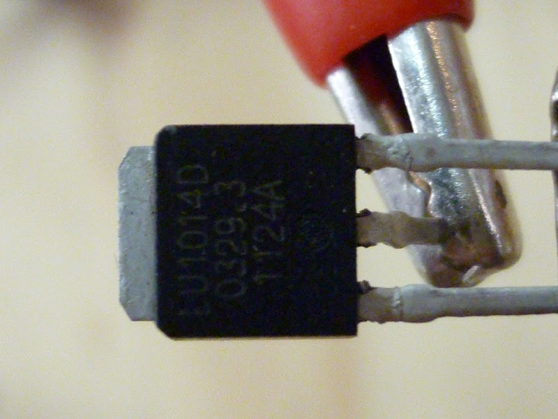

Excellent news! Thank you again for your help Nelson.

It's just that there are practically no depletion mode power parts out there
that aren't more valuable than the LU1014D.
Also, the bias figure is on the mark.
