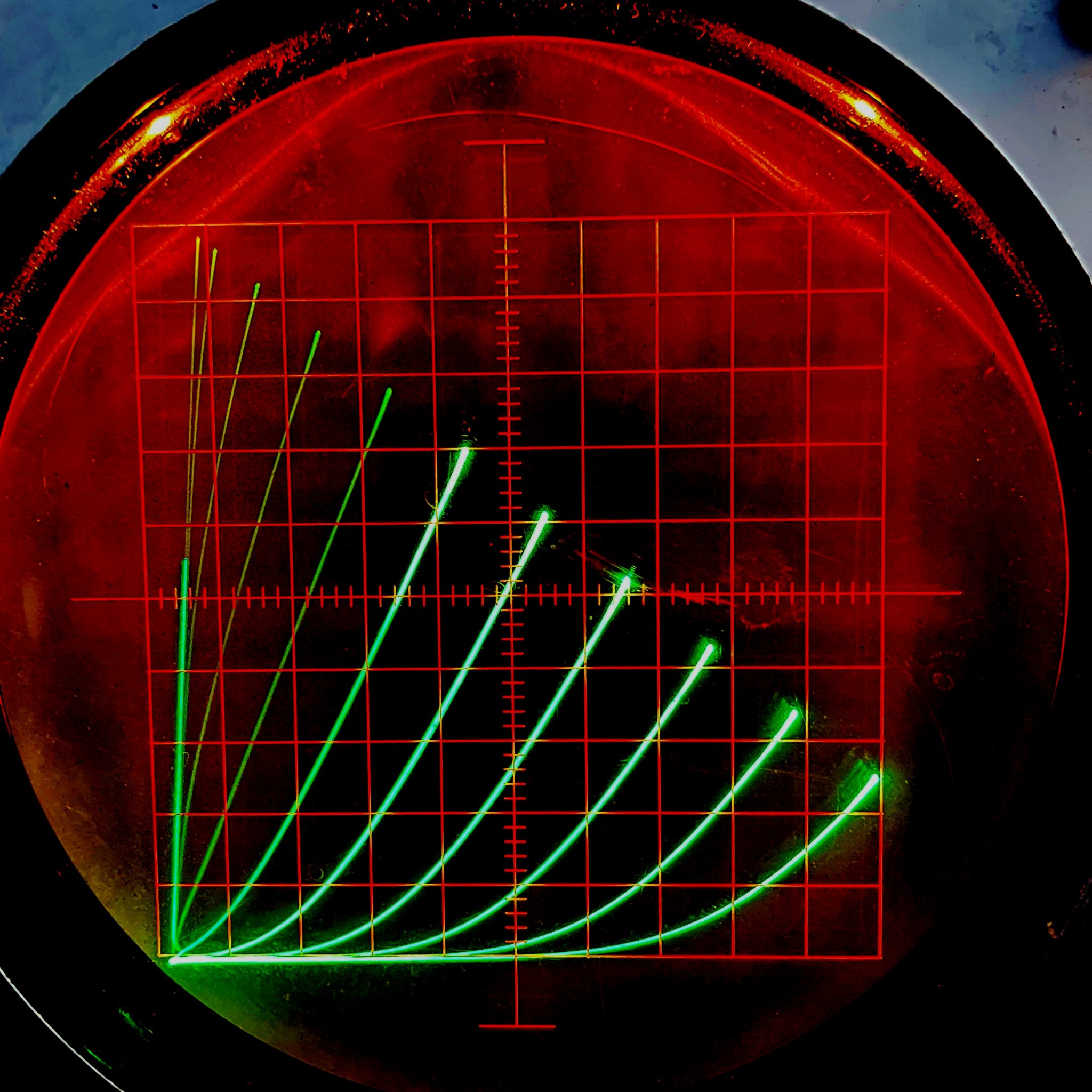

LU1014D are these for real?
GOT IT!
Turns out 2 cups of coffee was not enough...I am using one diode out of a 10A bridge and connected to the - instead of the + terminal....And to think I was an engineer for a 20KW FM and 50KW AM station in the 80's. 🙄
This looks better. So I think I can conclude these are real parts? That pic was at -.91 Vgs.
Cheers and thanks for the help.
PS I will probably build it into a nice project box now that I have it working. 🙂

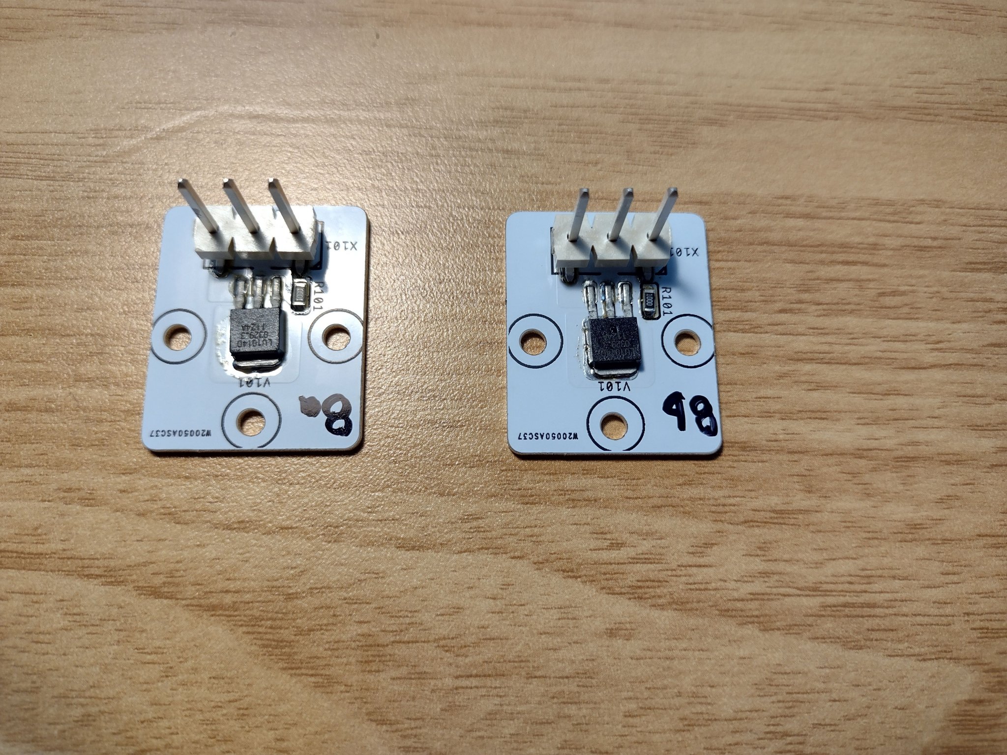

Once you mount lu1014 on the adapter, see xrk971 videos, you can run it pretty hard. It has very low Ron, so the heat generation of this little jfet is comparably smaller to common mosfets. I run 1.5A with barely warm heatsink. I target the same set values as in f3 or zen8 amp, ~1 VDC on source, little over 3VDC on drain.

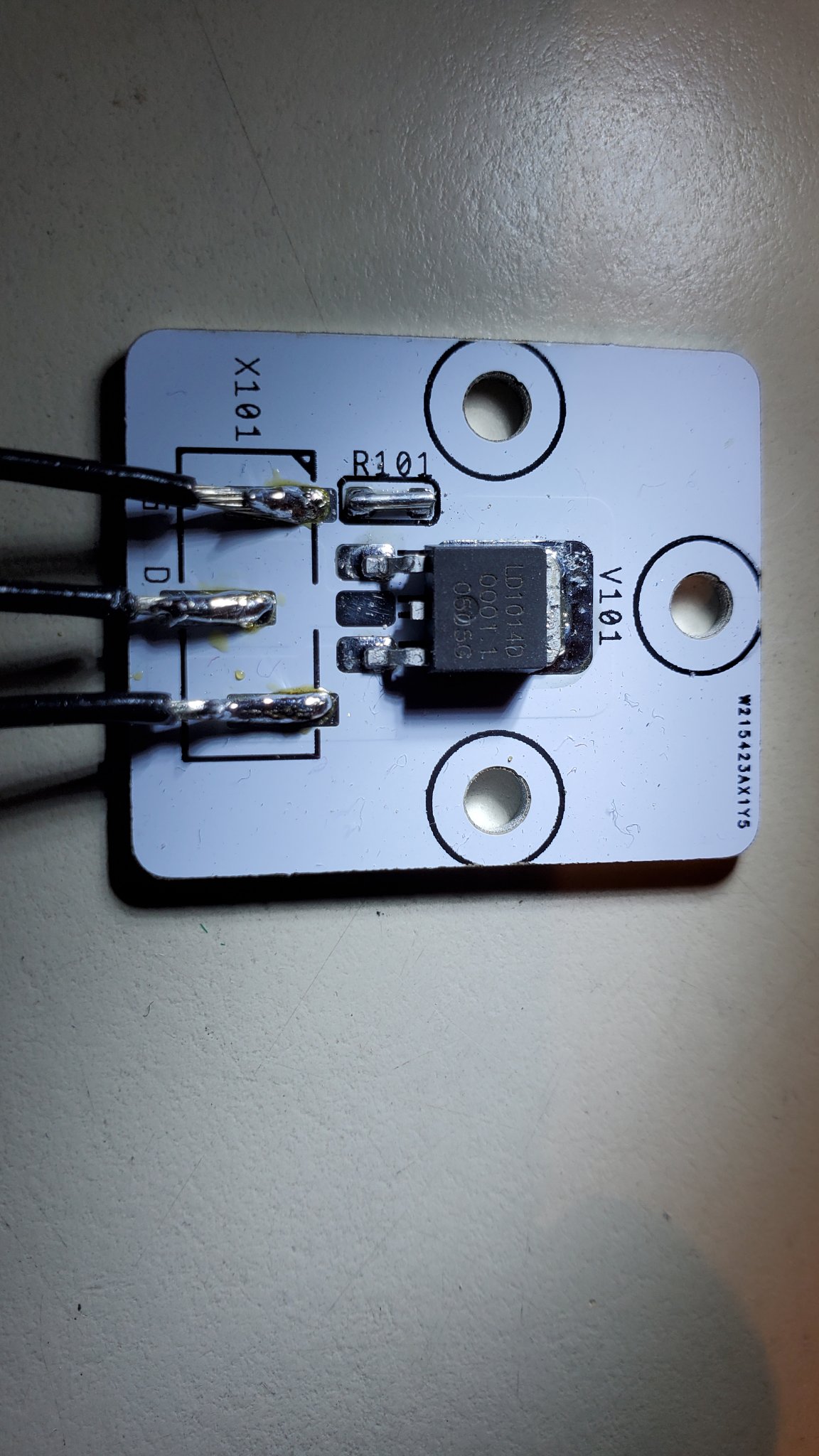

Congrats to Mr. Kilohertz. It took me more time than I'm willing to admit to get good looking curves out of my tracer. A while ago I purchased a roll of the SMD devices for nearly nothing, and so far the 4 I pulled test as expected. I've soldered one up to an adapter for testing my LuDEF board.

Woofertester is correct: big tab of LU (drain) connected to D pad. Used a heat gun and SMD solder for the LU - worked perfectly! Solder iron for the wire/pad connectors, with admittedly too much solder build up. But satisfactory for some initial tests.

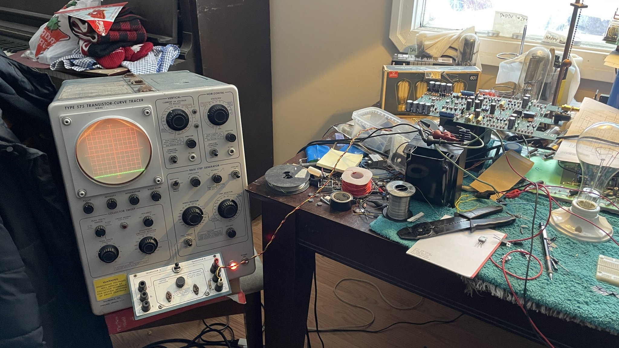

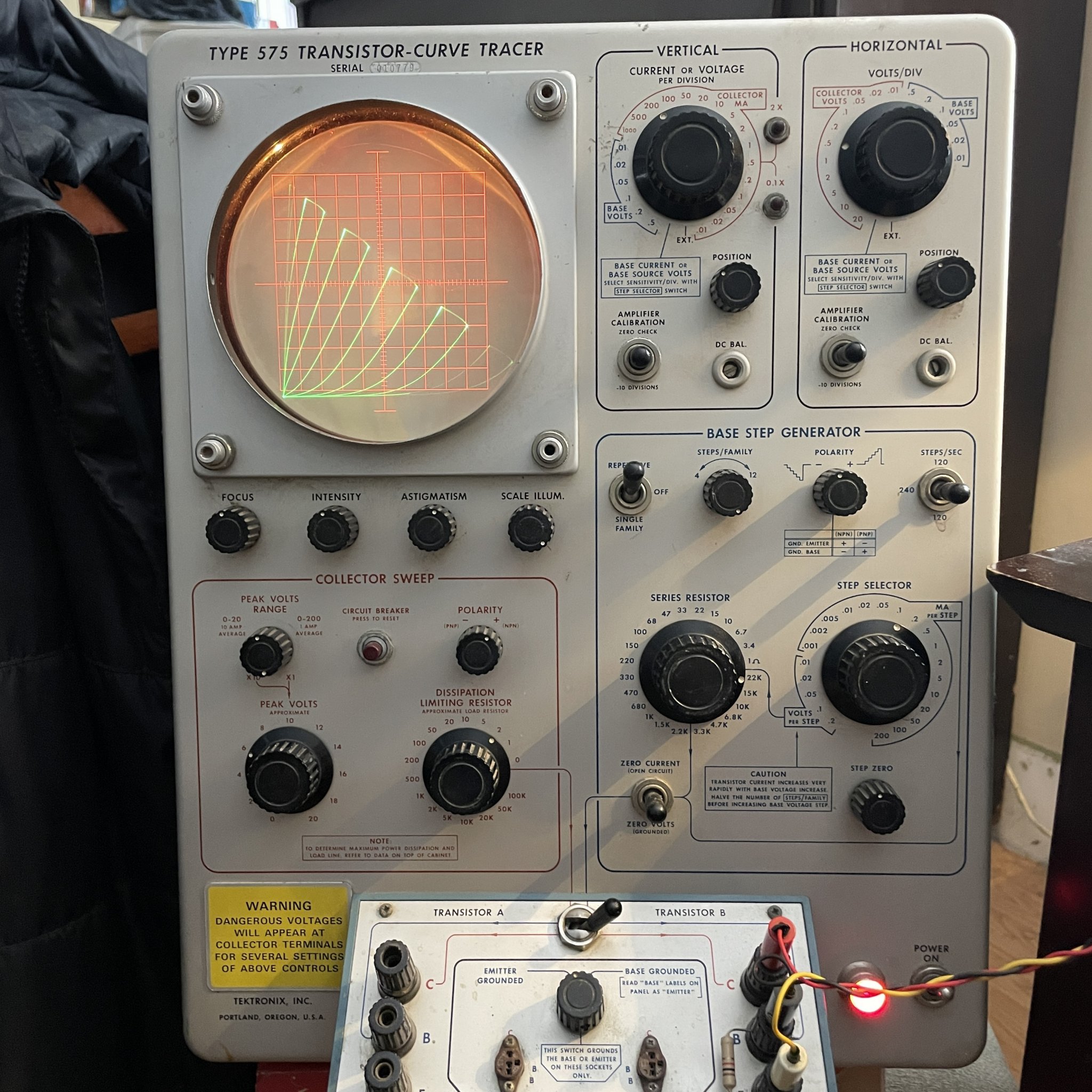

Okay another great afternoon at the ranch, plowed the driveway with the dozer and came inside and and started playing with the 575 curve tracer. I figured out how to make it work for JFETs and put these LU1014Ds to the test, I'd say they are real. It sure looks like a triode! Darn near a resistor on one of the curves. 😀
I've included a few pics of the setup in case you also have a 575, you can copy the settings. I put a 1K R across the B-E terminals (G-S) to convert the mA/div to Volts/div so 1mA becomes 1 volt on the display. I had the collector volts set to 6, load R was 2R, she got warm pretty fast when I dropped the load to 1R and cranked up the voltage. 😱
Fun fun fun.
Now to try some other devices I have, MOSFETs etc.
