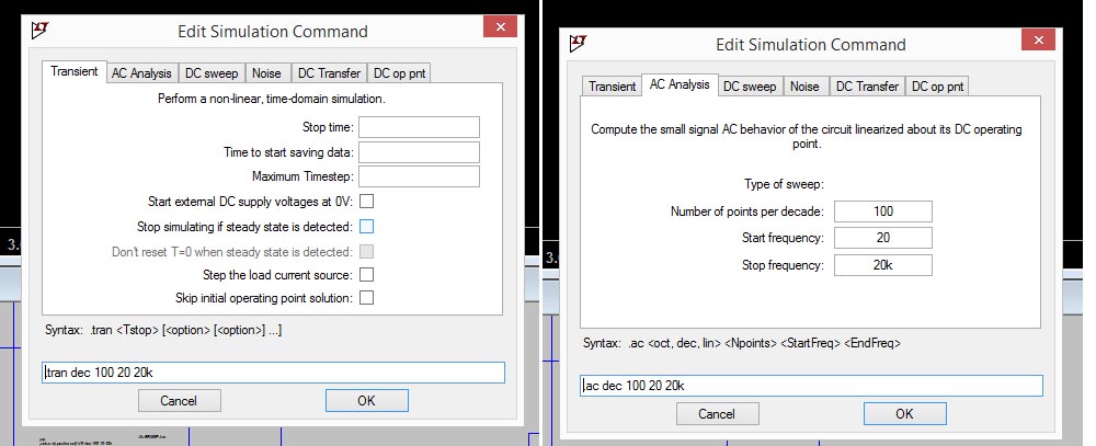

Then I found as you switch between Transient, Ac Analyst or DC and others it's not functioning or does not remember or does not pick up previous entry, so you have to edit these options and pick one among the commented out entries or have to repeat the entry which is very annoying. Not sure why it's like that, anyone got the same problems?
Nothing was solved with this problem?
I noted that one very quickly, and yes, it is VERY annoying.
What I fine even more annoying is when you are studying 2 or more plotted wave forms and then one will just disappear. Sometimes you can get it back by pressing "Zoom full Extents" or running the simulation again, but usually the best way to get it back is to check "Float window". But then you have to switch windows in Windows. Either way, it is a pain and I really wish they would fix those two problems. Neither happened in IV.
Other than those 2 problems, XVII works very well.
