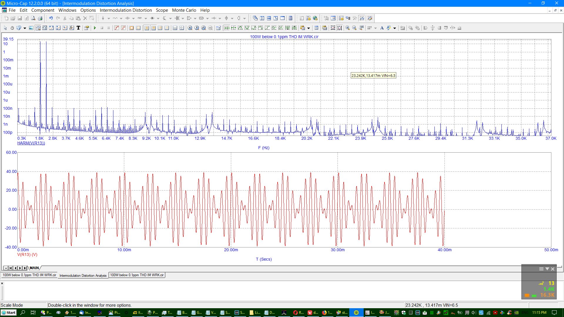

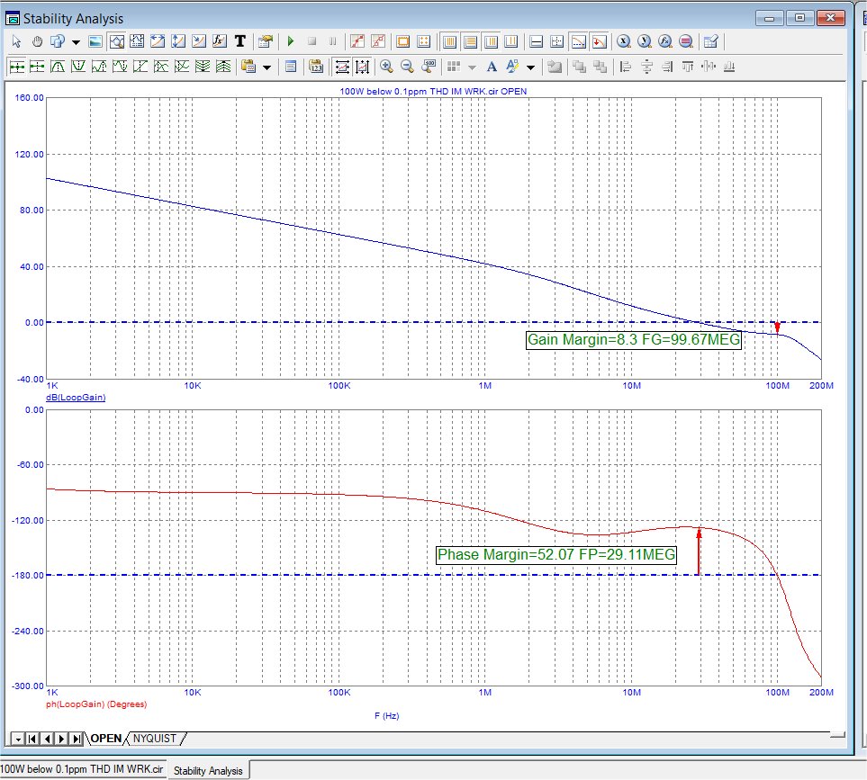

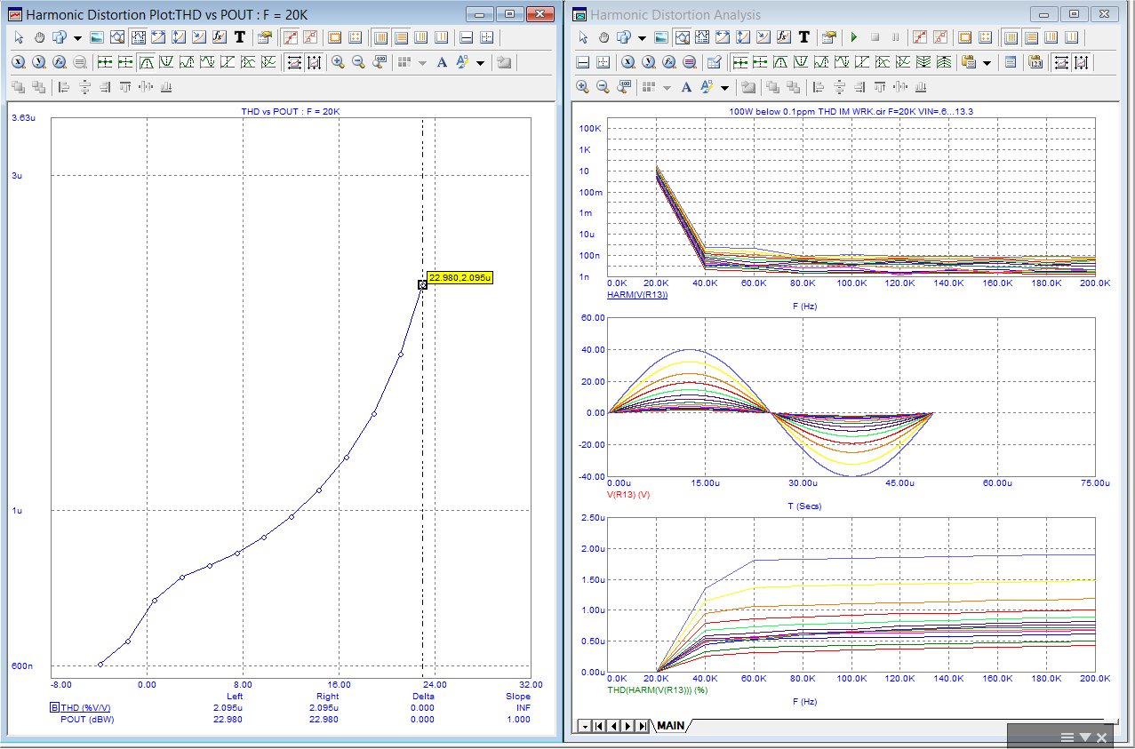

I checked my audio folders and it appears that I've been working on power amps almost daily, since 2013 (time flies). My initial designs with those simple topologies were at best in the 0.0X % range and improvement was slow until several months ago I applied some additional rules for lowest distortion. I'll have to verify if such a low distortion can be realized in practice, by constructing and measuring. The simulation pics regard THD (20 KHz), stability and IMD (1.9 & 2.3 KHz).

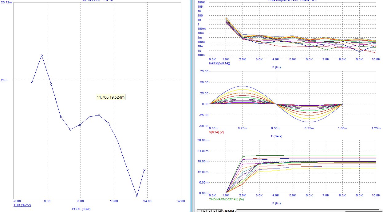

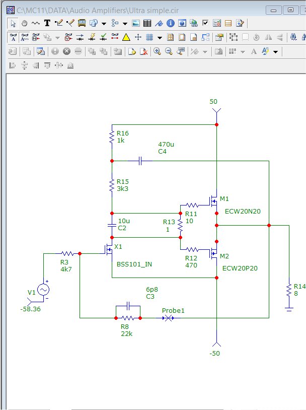

My pleasure. The circuit below has just 3 mosfets and yet simulates at ~ 100W (8R) with 0.025% THDmax - 1 KHz. Because of that and the simplicity, you could convert the amp to a practical one for single supply. Find out why THD at low level is higher than at maximum output.
And I think gannaji actually meant a 'click to run' file like a .asc for LTspice and that is what I understood can not be done with MicroCap.

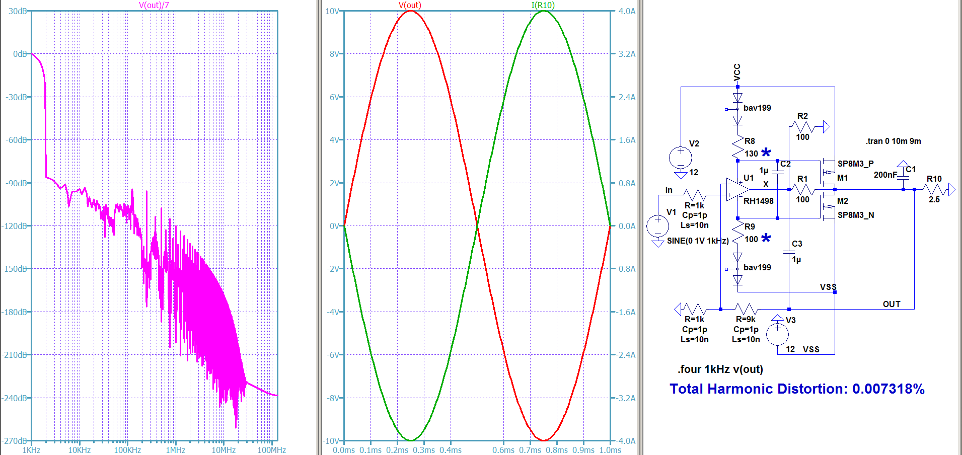

I've been comparing the uC and LTspice syntax. LTspice has much more functions for dependent sources. Also, uC has no ".Four" directive (Fourier analysis, not FFT).
For nonlinear inductances, LTspice has a Chan hysteresis model. Also, LTspice has the correct, branded operating amplifier models, in which the output current enters the power supply circuit. This makes it possible to control the output transistors by using currents through the supply pins. Here is an example:

... The simulation pics...THD (20 KHz), stability and IMD (1.9 & 2.3 KHz).
The simulation appears to show 2 PPM at 20 kHz and 200 W.
But you wrote
...it's easy to get 0.05 ppm (20 KHz)...at up to 200 W.
So these results are 40x worse than your claim. Can you show any 0.05 PPM simulation? Very curious to see the Tian probe plot, it should be spectacular.
Best wishes
David
Joined 2018
You might need (better) glasses or a visit to an ophthalmologist. The vertical scale on the THD graph is in units of u% - MILLIONTH OF 1%. That equals a scale of 10^-8 per unit or 10 ppb (parts per billion, not million). You could have realized that by reading the IMD graph with vertical scale in powers of 10.
