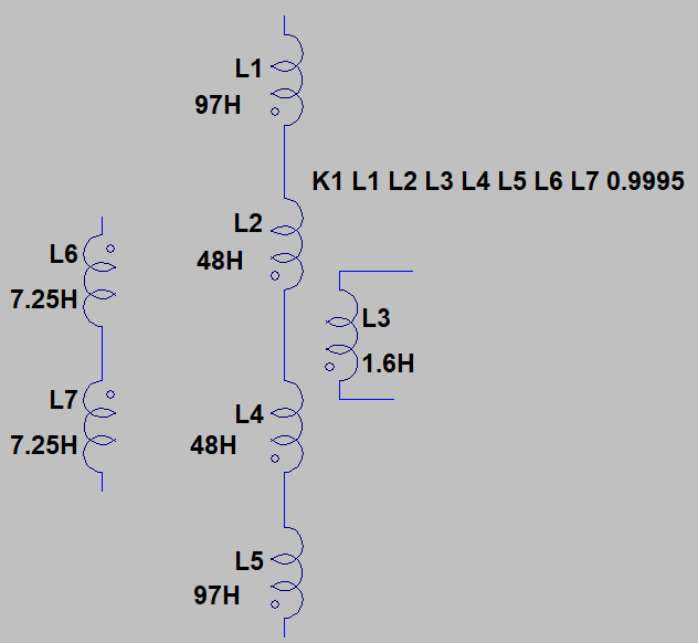

So it really is 10% of Ra. Here is the response from the manufacturer:
Hello.
Thank You for contact us. There are two cathode windings - one for each half of the primary winding.
TTG-CFB4000PP has a 4k Raa (anode to andode) - 2k between the anode and the center tap. Each CFB winding is calculated as a 10% of a half, so 10% of a 2k.
Best Regards / Serdecznie pozdrawiam,
Tomasz
This means that each cathode winding is 200R and the output voltage will be 24% at the cathode and 76% at the anode when CFb is connected.
Can't use constipated drivers...😀
The only thing one needs to do to get it right is to stick to their definition and calculate everything for 1/2 primary.
With CFb the total half primary impedance will be Za=[SQRT(2K)+SQRT(200R)]^2= 3465R. So the total primary load end-to-end will be 6930R.
If I start from Za-a=4K and Zc-c=400R I get Za-a=[SQRT(4K)+SQRT(400R)]^2= 6930R!! No mistake.
So going back to the initial question...
If the simulator input is the total primary inductance of 580H then the total inductance of the cathode winding is 58H. If the simulator want to know the inductances of each winding both anode and cathode the inputs will be 1/4 of the values above.

Final LTSpice transformer model
So, for the LTSpice model:
  • each anode half is 145H. 33% is roughly 48H. So upper anode winding is 97H and the lower is 48H
  • Each cathode winding is 58/2 = 29H. 1/4 of that is 7.25H.
So my final transformer model should be as shown in the attachment.
I'm driving the output stage with tubelab's Universal Driver Board so drive won't be a problem.
In reality if one doesn't use the UL taps when CFb is connected the amp will be still UL, unless the G2 is directly AC referred to the cathode. That would be what Crowhurst called the "modified ultra linear".
The UL taps could be used to bootstrap the anode resistors of the differential driver. They need to be cross-coupled to get the correct phase. This way a lower anode resistor can be used with more anode current or it could stay the same if the anode voltage is high enough to get the required additional swing (because the effective anode load would be flatter). All this also taking into account the next stage input impedance that in case of cathode feedback would be higher than without.

Question:
- do you have the transformer in your possession?
When so, use a signal generator and apply a voltage across the whole primary. Measure the voltage across the whole CFB winding. Then you know the correct ratio and then you can put the right inductance values into your sim.
Despite 45's firmness I still have my doubts; I don't trust the 10%Ra spec of the manufacturer, and his reply does not take away my doubt.
No, I don't have the transformer. Plan is to simulate a number of different transformers and configurations, and then make a decision. I am leaning towards this transformer and using both UL and CFB though. Toroidy do have a few positive mentions on diyAudio.
