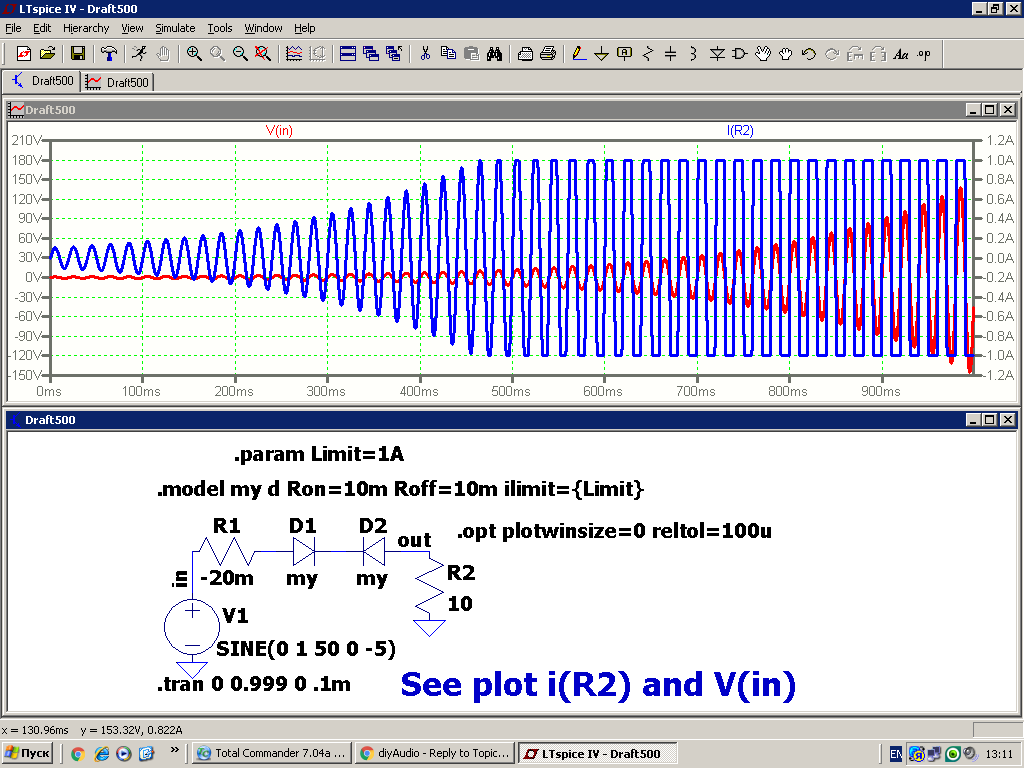

I tried setting the max current I wanted the the ac source to supply by dividing the source voltage by the max current to obtain the internal resistance value. Am I missing something, because it doesn't seem to work like I thought. I am a complete newbie though using Ltspice.

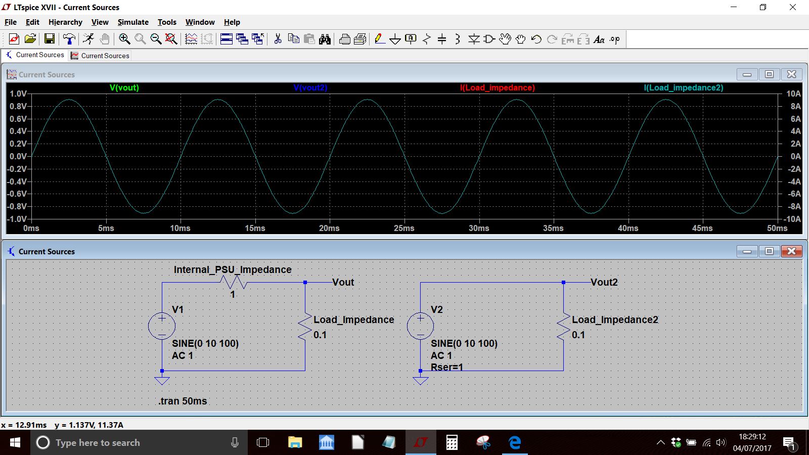

An AC or DC voltage source has zero ohms output impedance unless you modify (add a value) to the appropriate box when setting the voltage source up.
If you have a 10 volt source and divide it by (say) 10 amps then you get 1 ohm. If you add a 1 ohm in series with the voltage source then the current can never exceed 10 amps.

Do you use the series resistance parameter on the source setup page or do you add your own resistor external to the source? So if I am thinking correctly the voltage level will remain constant until the loads impedance is low enough to exceed the 10 amps in your example.
You can do it either way. The voltage source has unlimited current and a true 0.0000 ohms output resistance unless you either add your own series impedance value or add a separate resistor.
The voltage will not remain constant in either example, it follows ohms law. In the external series resistor example you have to take the output from the resistor and so the voltage at that point will vary in relation to the load impedance. Only a short circuit on the output will draw the 10 amps max. Anything higher than a short will reduce the current and also divide the voltage. The voltage across the series resistor and load will always add up to 10 volts.
