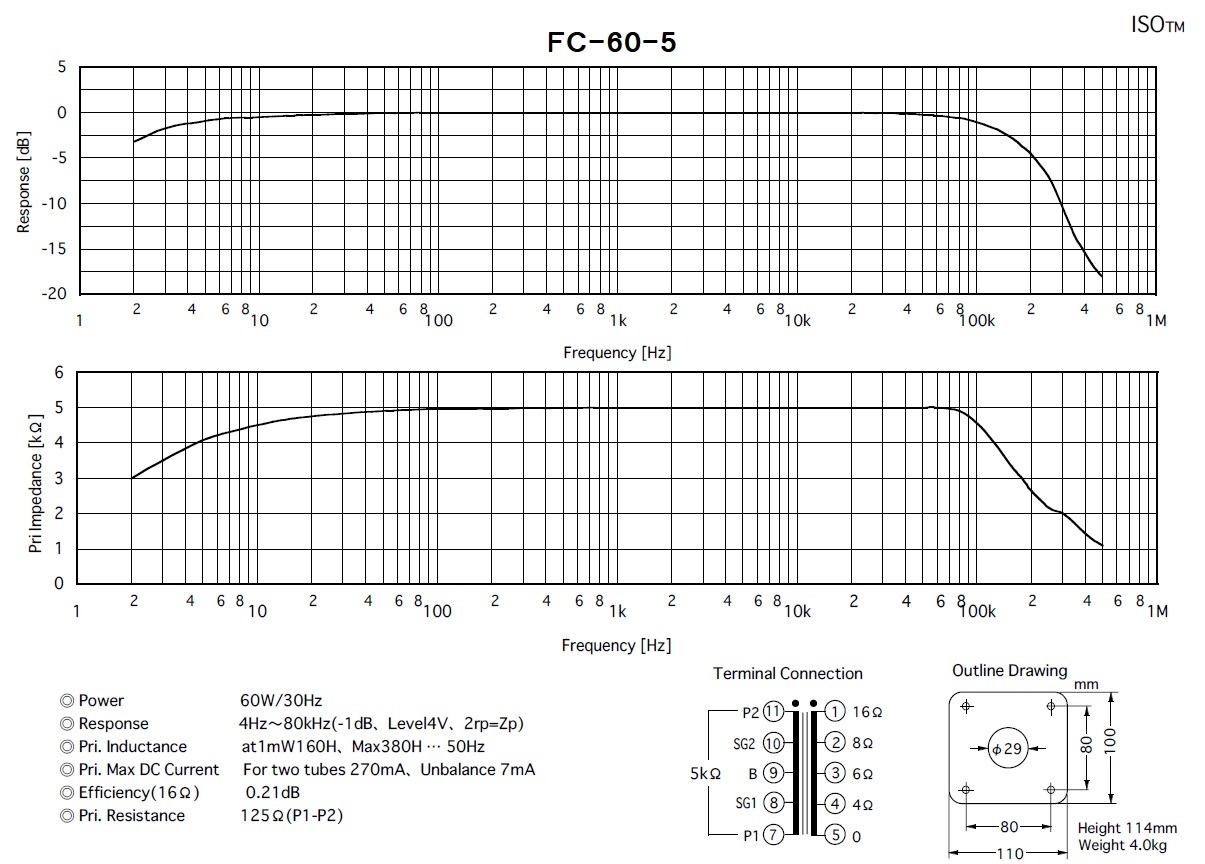

Does anyone have more detail parameters for this ISO output transformer that I can use for LTspice modeling? What primary inductance # should I use? Thanks.
A bit late…
Change the inductance until you approximate your -3dB point in low-frequency and then change the coupling coefficient (K) until you get the -3dB point at high-frequency.
I don’t know what to suggest for inductance, Mullard values might be close enough.

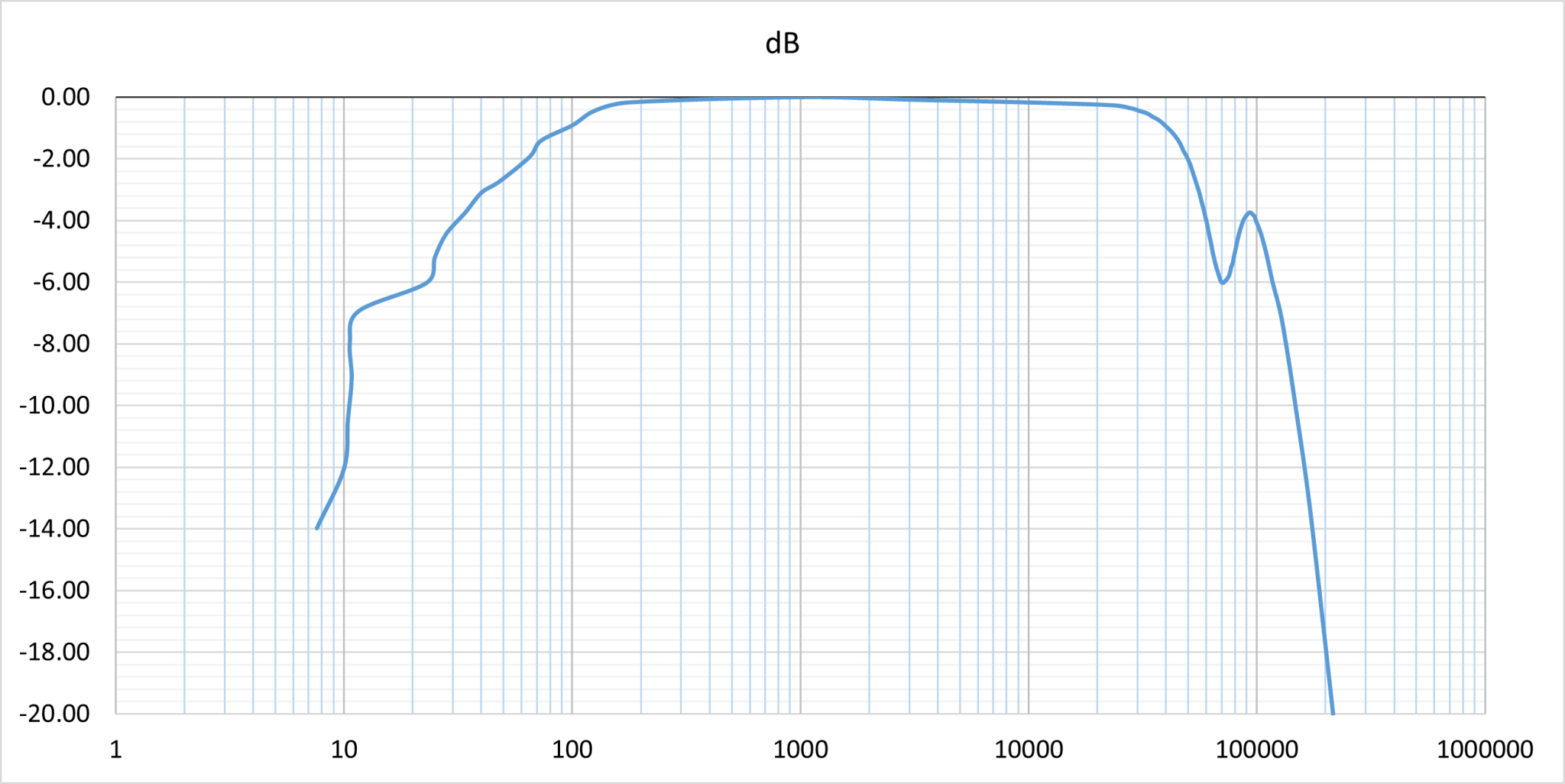

The HF -3dB point is a good start, but lurking behind is the ugly resonance caused by the series cap (prim. to sec.).
This is what I found when modifying my Leak ST60: -3dB@55KHz, dip@70KHz, and peak@90KHz
@Ite: thanks for your model; it allows the parasitic caps to be specified. However, in order to approximate the actual response above, I need to use around 10nF between prim. and sec., but the actual measured value is about 2nF. Any thoughts?

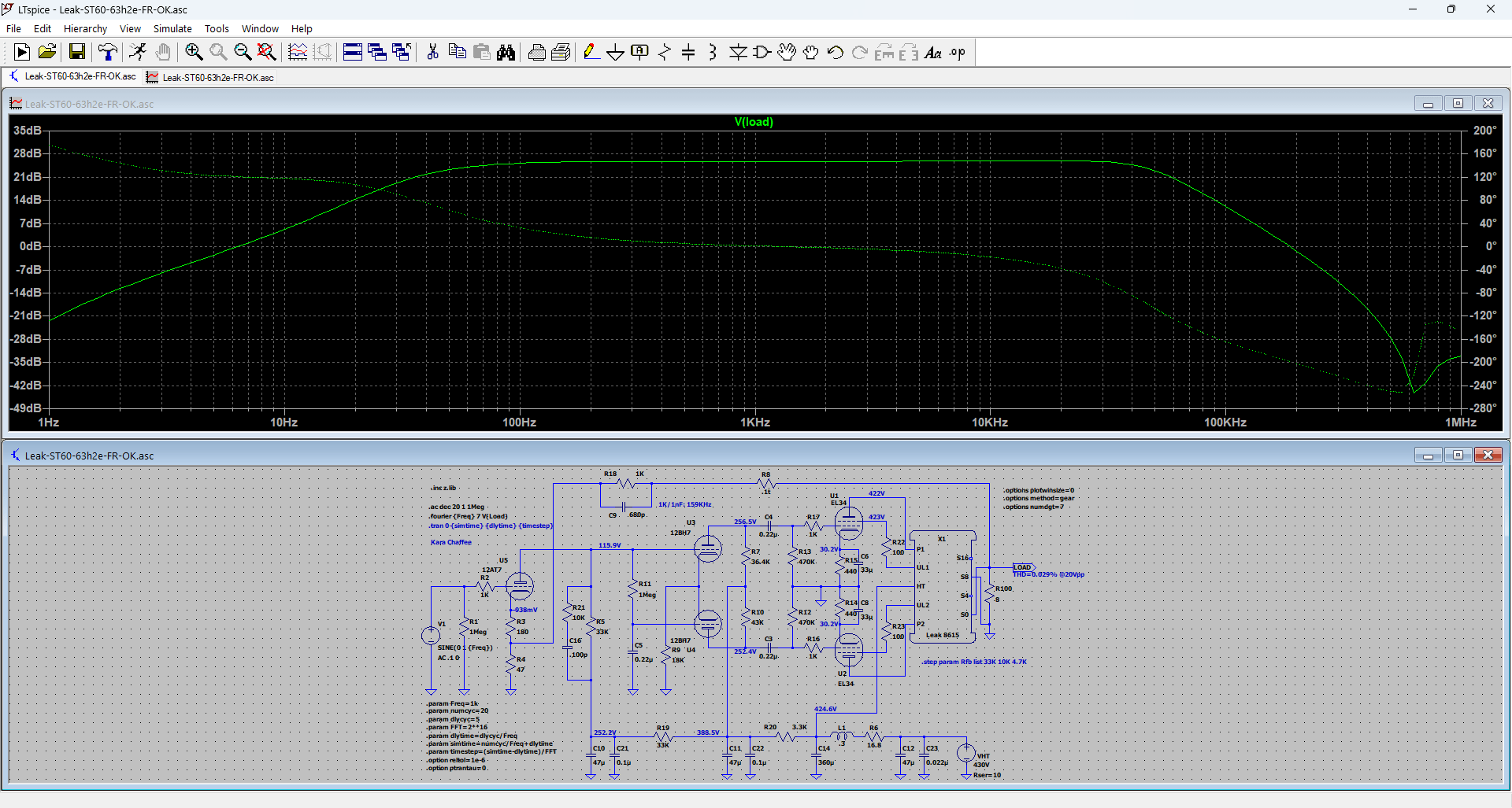

LEAK-8615 transformer model
@Zung,
I am not a transformer expert, more an LTspice WYSIWYG transformer model promoter.
In your Leak-enstein thread I saw the Ray Whitcombe info on how the transformer is constructed internally.
I made a model that follows that recipe and got some promising results!
happy diy,
Ite
@lte
Thanks for your efforts.
Sadly, in the actual circuit running open loop, your model doesn't give the expected results. I need to give it more thoughts, but currently, I'm tied up in others projects, so it'll be a while (busy retirement 🙂)

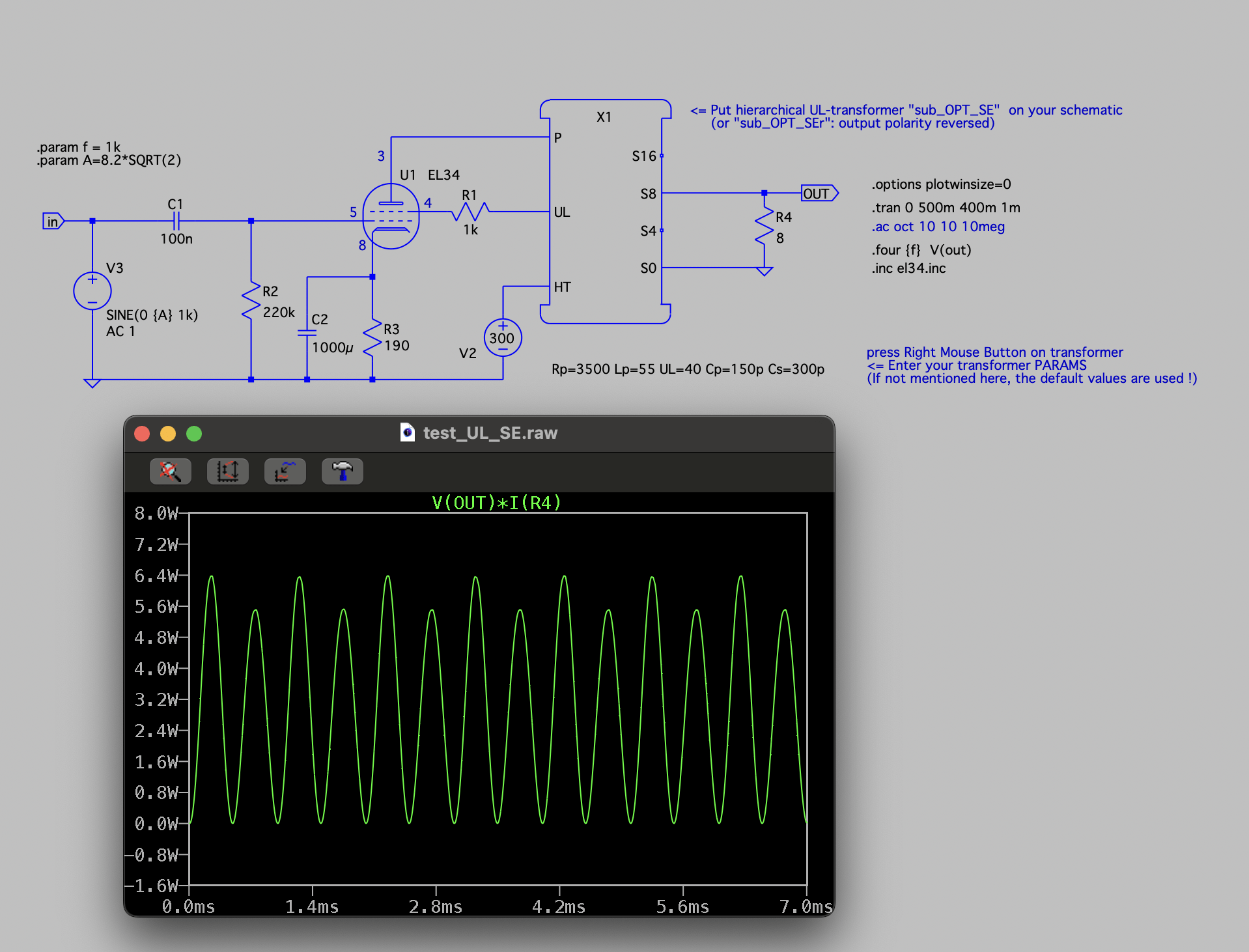

Hi Mo,
The asymmetry is caused by the distortion in the "out" signal. (use control-L to show it in the error log)
When you re-run the simulation with a lower input signal, the signal will have lower distortion and the symmetry will be better.
The distortion is not caused by the transformer model. It is only a simple lumped model, that doesn't incorporate core-saturation.
Press Right Mouse Button on the transformer, and click [Open Schematic] to view the model used.
The example circuit with the EL34 is only to show how to use the transformer model. It is by no means a perfect circuit.

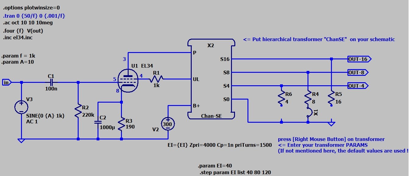

This hierarchical SE transformer model is different from the previous one.
This model has a non-linear Chan core that takes into account the transformer size and magnetic properties of the laminated core.
The LTspice implementation of a multi winding Chan-core transformer is based on the work of the late analogspiceman.
Calculation of the core geometry A, Lm, and Lg for an EI transformer is based on the 'Peter Blanken' transform.
