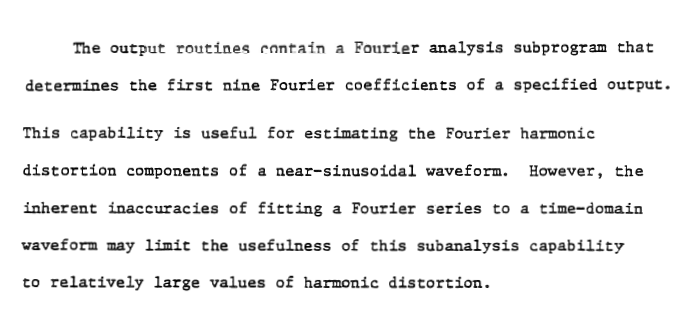

The way PSPICE performs .FOUR analysis is documented. Maybe/probably LTSPICE does it the same way.
PSPICE fits interpolation polynomials to the transient analysis sampled data; partly for smoothing and partly to interpolate the non-uniform-sampling-interval used in transient analysis.
Then it calculates the best-fit Fourier coefficients of the first N harmonics where N is a user chosen value (default is N=9).
Then it normalizes all coefficients, dividing each of them by the coefficient of the fundamental, the "first harmonic".
Then it squares the normalized coefficients and adds up the squares of harmonics number 2 thru N, omitting the fundamental.
Then it takes the square root and reports this as THD (expressed as percent).
Notice that if you change the number N of harmonics printed, you change the summation and thus you change the reported THD.
These calculations are what LTSPICE reports as its first THD number, the one not in parentheses. You can verify this claim yourself, by slurping the normalized coefficients into Excel and having Excel do the squaring, summing, and square rooting. Voila they match! Do it again with a different number N of harmonics. Voila!
