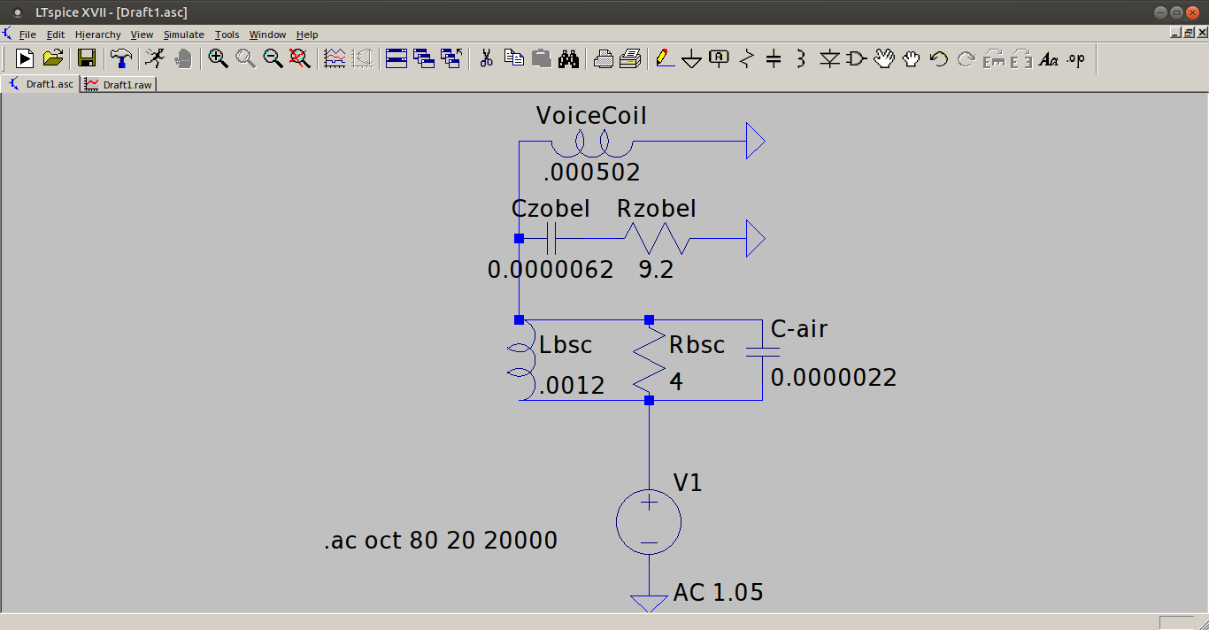

I recently realized how helpful LTSpice can be for running simulations and decided it might be helpful for others as well. I'm a novice user of LTSpice so take this all with a grain of salt.
I've been working with MJ King's "Simple Sizing of the Components in a Baffle Step Correction Circuit" and specifically Hong Nguyen's spreadsheet (based on King's work) to design a BSC circuit for a pair of speakers I built a few years ago. I have used various forms of equalization in the past and wasn't very happy with any of them.
Anyway, I wanted to really learn what this BSC circuit was doing - what each component actually does. I am a visual learner so being able to run simulations is helpful to me. Maybe it is to you, too.
So basically all I did was install LTSpice (it runs great in Linux under WINE, by the way) and then I spent some time getting used to the interface, how to place various components, rotate them, connect wires to the components, add and edit a voltage source, use hotkeys, etc. I won't include these basic instructions because a quick google will get anyone started.
I used Mr. Nguyen's spreadsheet to calculate (BSC + Zobel) component values and then built the simulation in LTSpice based on the diagram on the spreadsheet. To simulate the speaker, I used an inductor with a value equal to the voice coil inductance and also entered the series resistance of the voice coil. The AC voltage source wasn't easy to figure out. Basically, you have to click the "Component" object button and then find "Voltage", then place the object on the screen. It defaults to DC so you need to right-click it and then find a section named "Small signal AC analysis" and enter an AC voltage value in the "AC Amplitude" box. I started with 1.6 volts and then adjusted it later.
So once you get the voltage source, the BSC and Zobel components, wiring, speaker wired up and configured with the right values you can move on to the simulation. By the way, there are online calculators to convert uF to Farads, mH to Henry, etc. Make sure you get the correct values entered into each component.

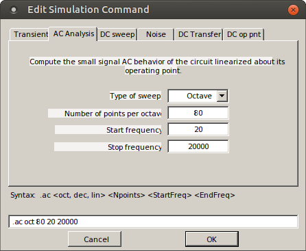

One of the screenshots attached shows the complete circuit setup, with an example of how to create an AC voltage sweep simulation. To set that up you need to go to the "Simulate" menu and then click "Edit simulation Cmd". My screenshot shows how to set up a 20Hz to 20000Hz AC "octave" sweep. Once that is set up, you can simply click the "Run" button on the button bar and new graph window will open to display the results - but there is one thing left to do. Take your "probe" (mouse pointer) and click on the "wire" just before the speaker voice coil. The graph will display the 20Hz to 20000Hz sweep after it has gone through the BSC filter (as you can see in the screenshot).
One thing to note; there is an extra component in my BSC filter here - the 2.2uF cap. I added this to pull the ~8kHz-20kHz range back up a bit, since my speakers roll off considerably after 10kHz. Removal of this component results in a typical BSC filter, where the response stays flat out to 20kHz.
Depending what AC amplitude (voltage) you specify, the "0 dB" point on your graph might not align well at all. I simply went and adjusted that value multiple times till the simulation accurately showed 0 db at the top of the bass curve (at 20Hz). This was for personal preference only.
