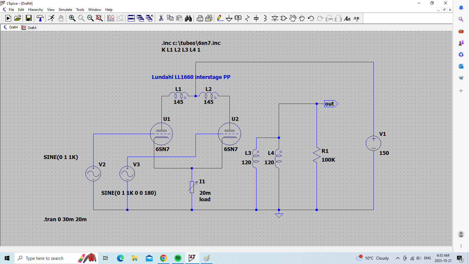

I've been thinking of building a 6SN7 LTP for a balanced input line stage using a choke as the plate load. I haven't seen much discussion of this approach. Anyone tried it?
What I'm considering is a Lundahl LL1667 which has two windings, one for each plate. I plan to use LED biasing, setting the bias point around 7ma per triode. Lundahl indicates that this choke is available with different air gaps to increase inductance for lower DC current. I'm hoping I can get up to 200H per winding based on my DC current requirements.
Based on simulations, this will start to roll off below about 200 Hz, but it's only down a small amount. I have a separate SS line stage for my subwoofer outputs which crossover to my mains at about 180Hz, so I think the low-frequency roll-off shouldn't be a problem. Anything else I should worry about?

6N6P will have much lower internal resistance (rp) than 6SN7, which working into the choke's limited inductance will yield better bass response. 6N6P are still readily available, even NOS in box. Or you could use JJ ECC99, which I think are available as new production.
6SN7 rp with 7mA Ip will be about 9k ohms or thereabouts.
6N6P rp with 15mA Ip would be about 2k ohms or thereabouts.
ECC99 rp will be similar to 6N6P.

My suggestion :- differential 6SN7 with CCS at the cathode. LL1660 PP inter-stage. This can be easily switched from balance or SE for input and output. The distortion is very minimal.

@kmtang - interesting idea. I don't have any experience with interstage transformers, but this might be a good way to learn a bit about how they work. I'll run some simulations to see if I can improve my understanding. It's possible the output impedance would be low enough directly from the transformer which would eliminate the need for another stage.

I would indeed look into a pair of LL1667 gapped for about 2mA, that should give much more inductance and still allow for some disbalance.

@kmtang - I've run some simulations using the LL1660 with the four secondary windings in parallel driving the load directly (with no source followers) and this looks like it might work really well. -3db at approximately 20Hz to 35Khz driving a 50K 500pf load, with a gain of about 13db (plenty for my purposes). As I mentioned, I don't really need the low frequency response since I have a separate SS buffer driving my woofers. I'm going to order a couple and try them out.

Please order the LL1660 with PP version. This would have much higher induction and will provide better low frequency response.
