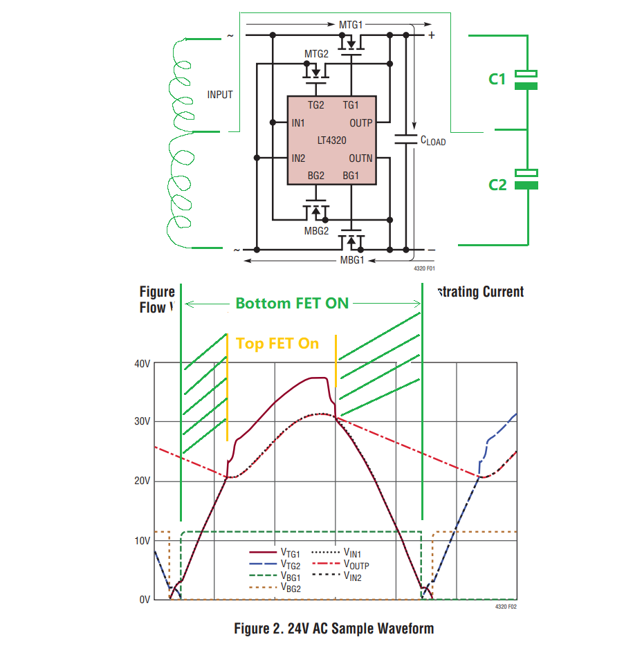

LT4320 is called something like an "ideal rectifier bridge controller". But the Figure 2 waveform in the datasheet shows it is a bit less than what you would call "ideal", in that the bottom FETs conduct over most of the input AC voltage cycle, much longer than the duration the top FETs conduct to charge up the output capacitor for.
Apparently such behavior results in the negative node of DC output gets tied to the bottom AC input node most of an AC cycle, and if we were to hook up a center-tapped transformer as well as the split-rail output capacitors, C1, C2, as we usually would to construct a full-wave split-rail PSU, the bottom capacitor C2 would be shorted out by the transformer windings through the bottom FETs during their extra conducting time period (hatched). This appears to be why "it doesn't work".
However, if we could somehow gate the bottom FET drives in such a way that they conduct and cutoff in sync with that of the top FETs', therefore, eliminating the extra conducting time, we probably could make it to work with a center-tapped transformer and be able to make a split-rail PSU with one LT4320.

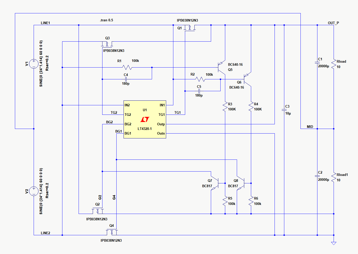

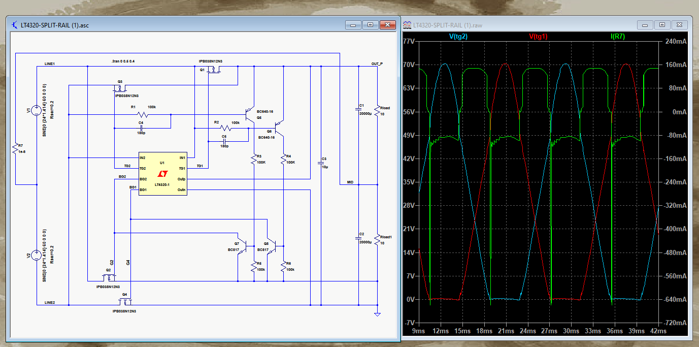

I came up with a circuit as attached, for a 2 x 24 Vrms input. LTspice simulation indicates it would work just fine.

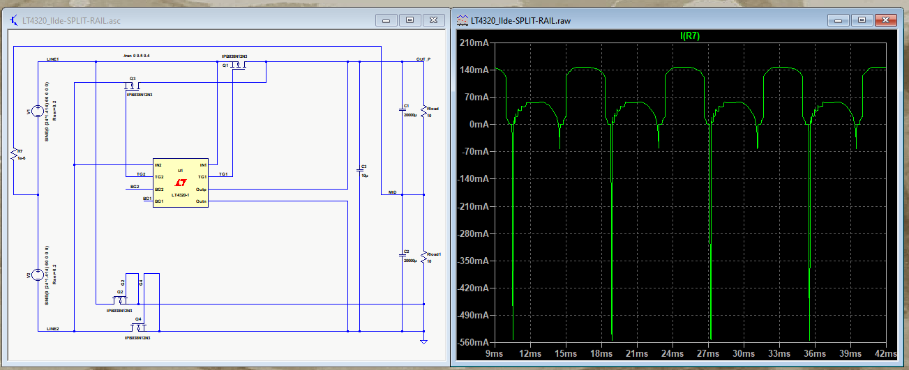

I didn't further the pursue by building an actual prototype, and I am glad I did not. The circuit seems to work fine in simulation when we look at its input and output voltages, yet by a closer inspection I discovered current spikes over the link that ties the center tap of the input and the center tap of the output. Under the load condition in the simulation, the current spike amplitude is abut 600mA, and it coincides with the top FET arm starts tuning on. It looks like this:

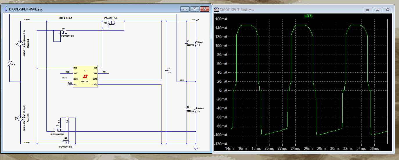

A) Straight diode bridge made with body diodes of the MOSFETs. MOSFETs stay shutoff. LT4320 out. There is no current spikes.

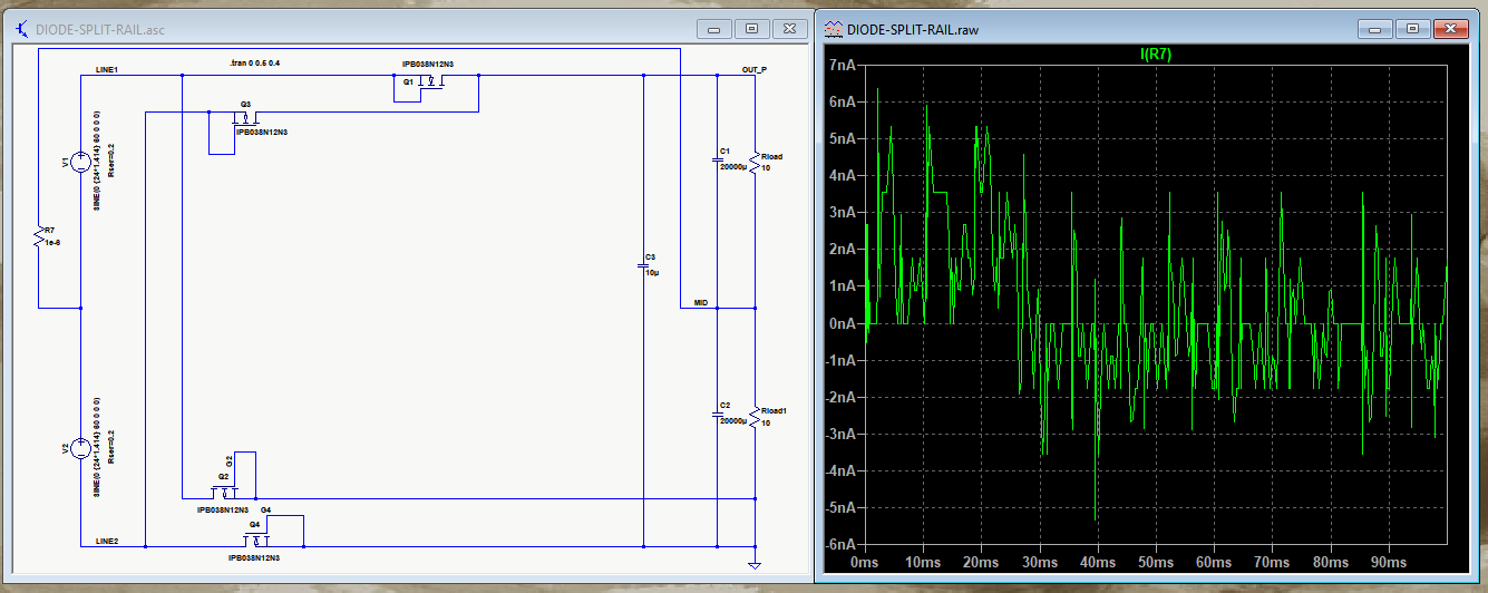

B) again straight diode bridge made with body diodes of the MOSFETs. NOSFETs stay shutoff. LT4320 in circuit but idling, not driving the MOSFETs. There are currents going on the GND link.... I don't like that
