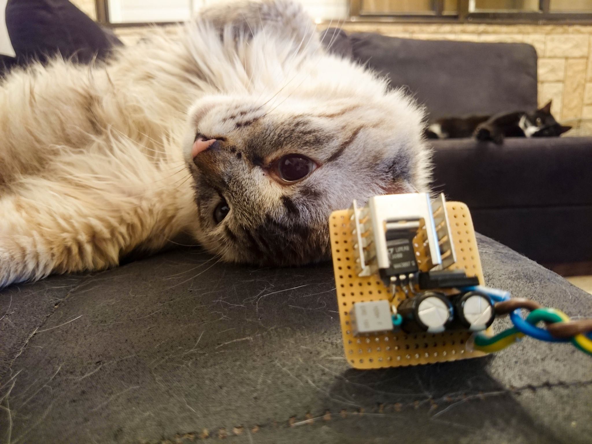

LT3088
Experiment 2

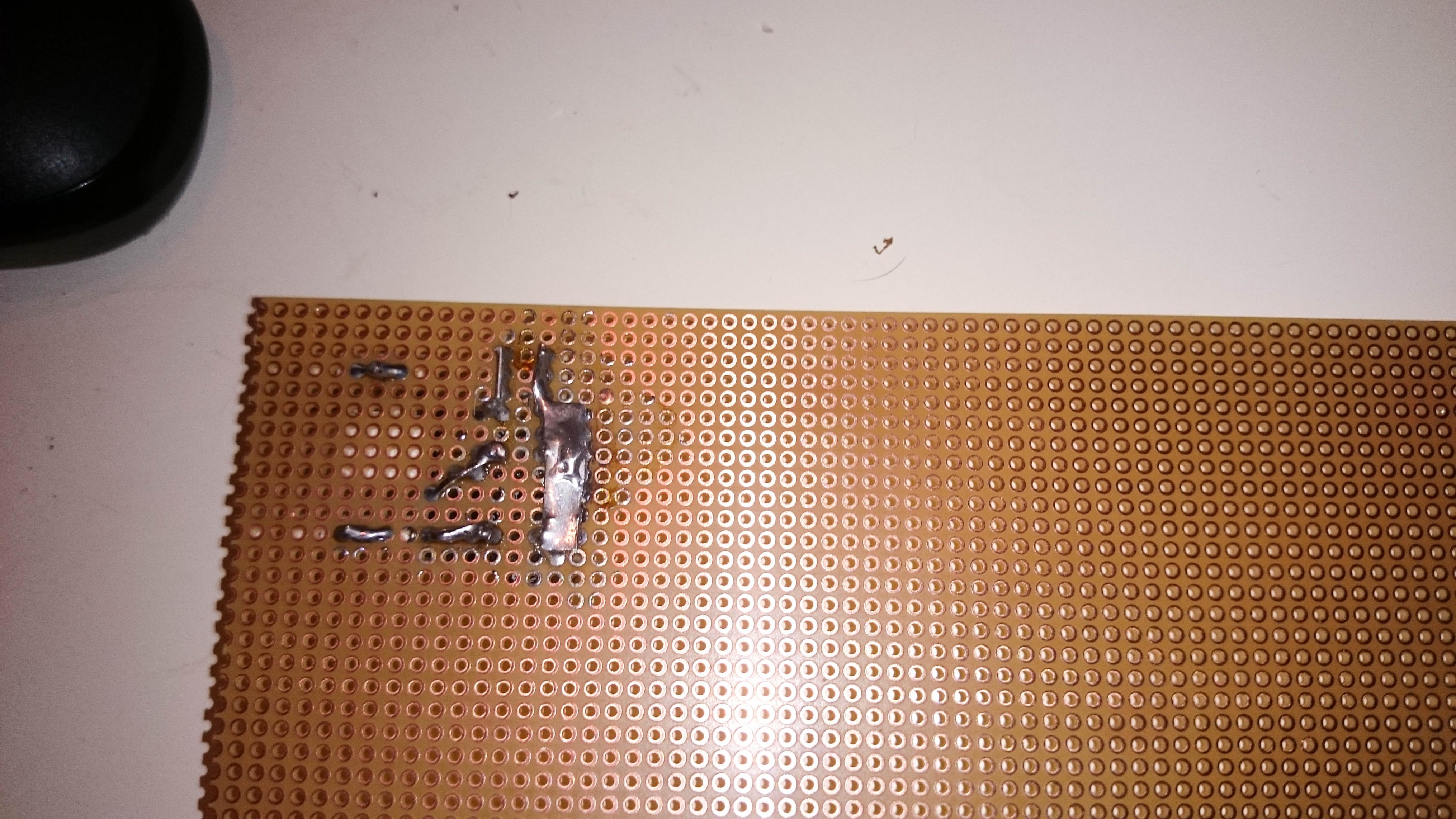

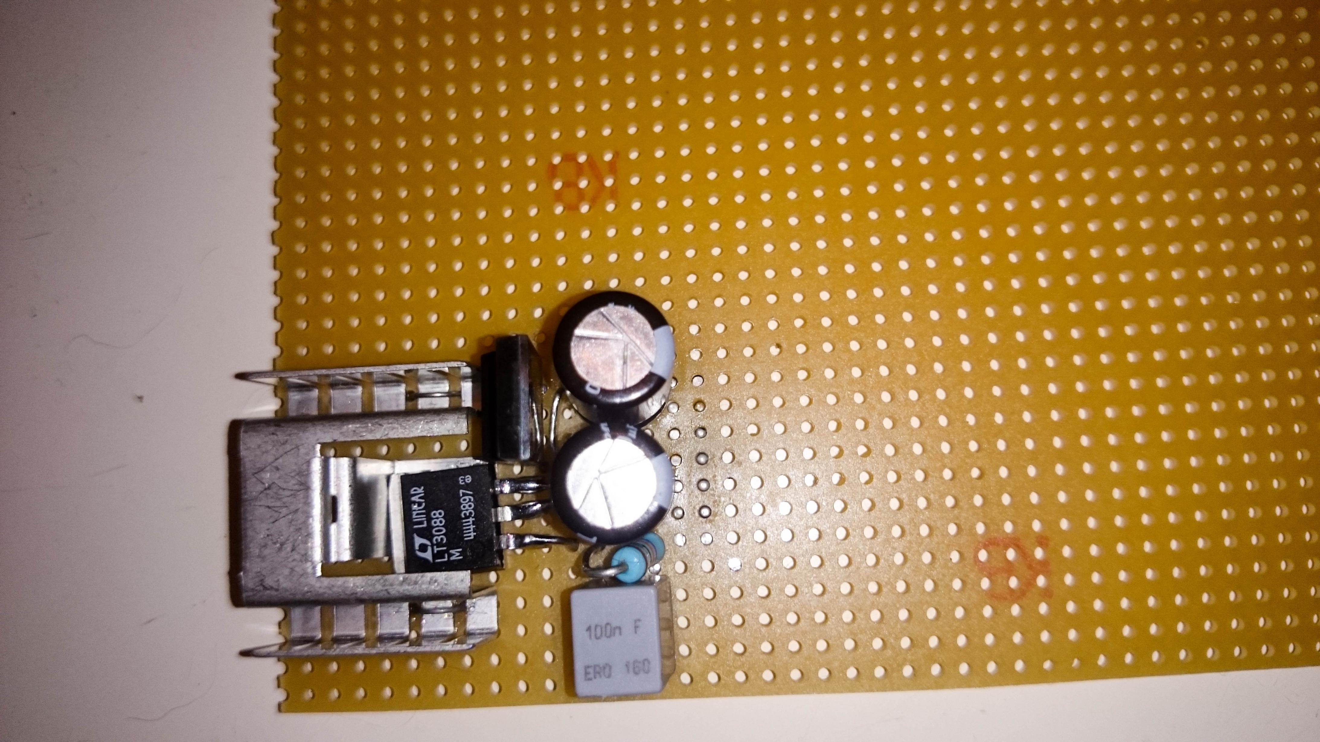

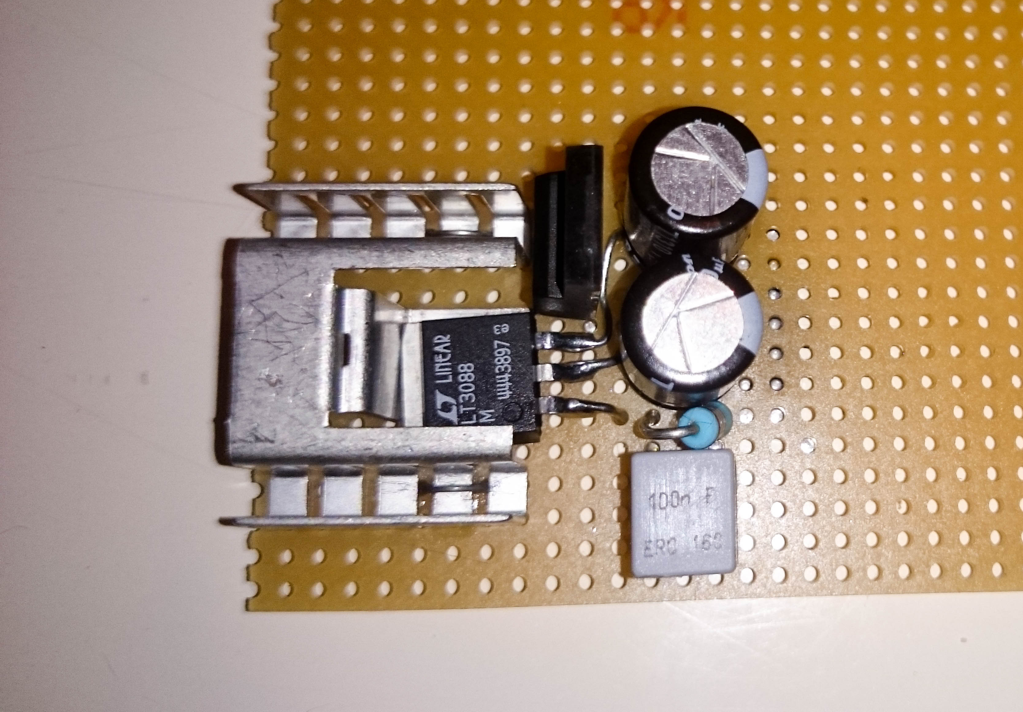

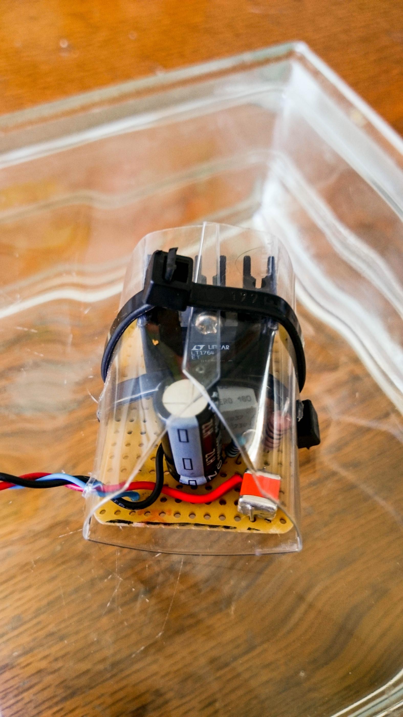

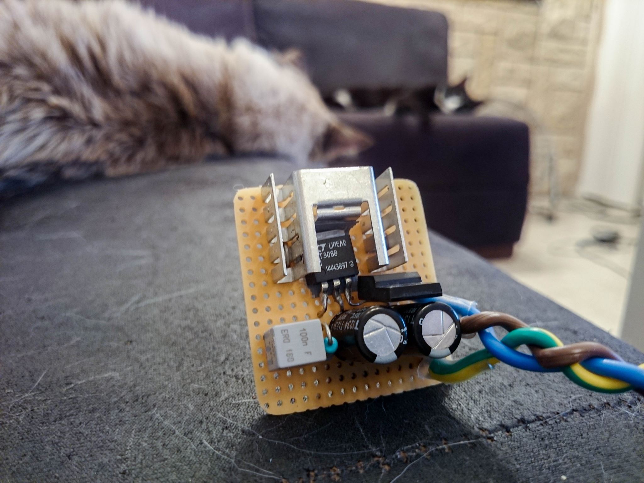

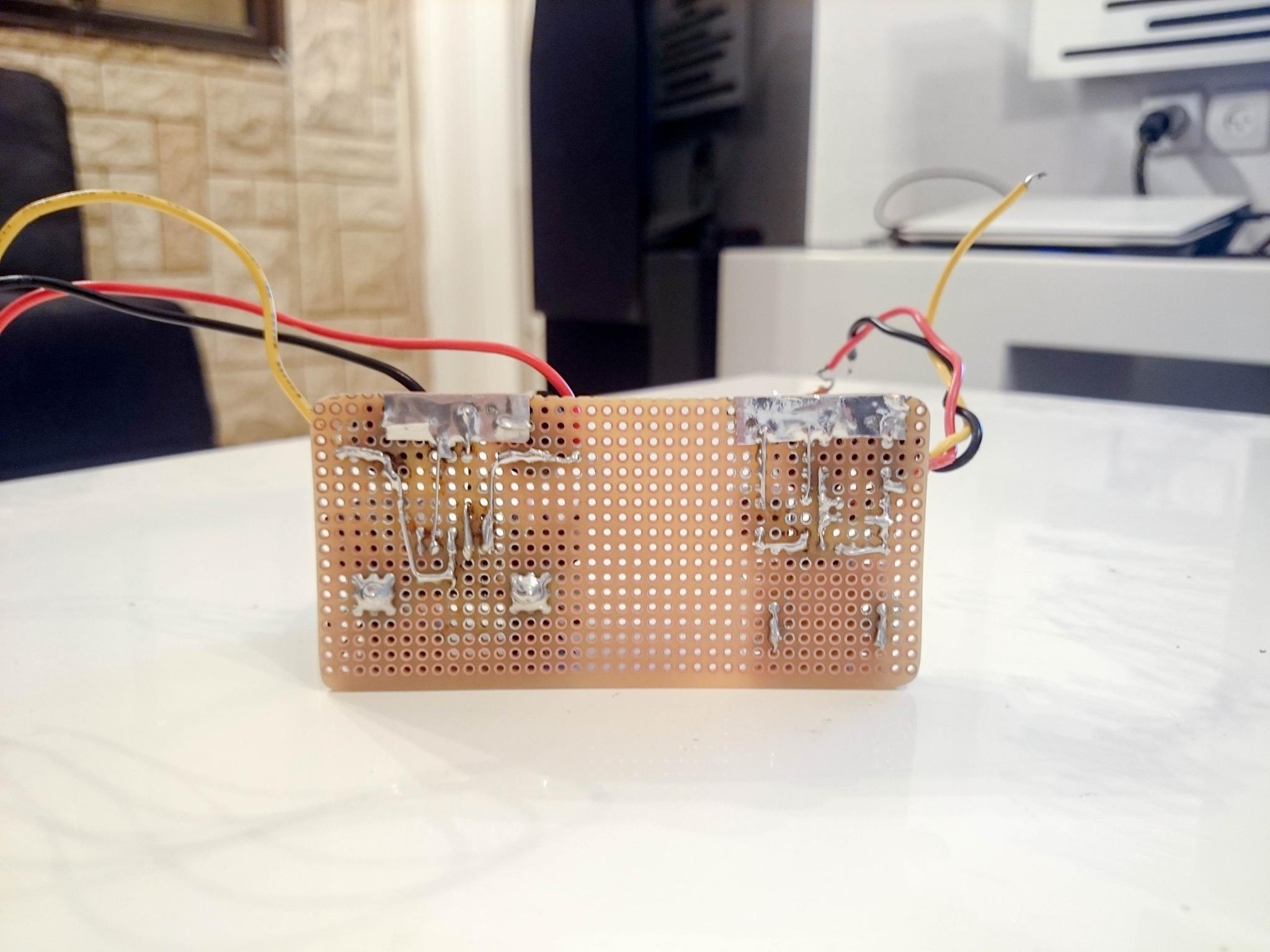

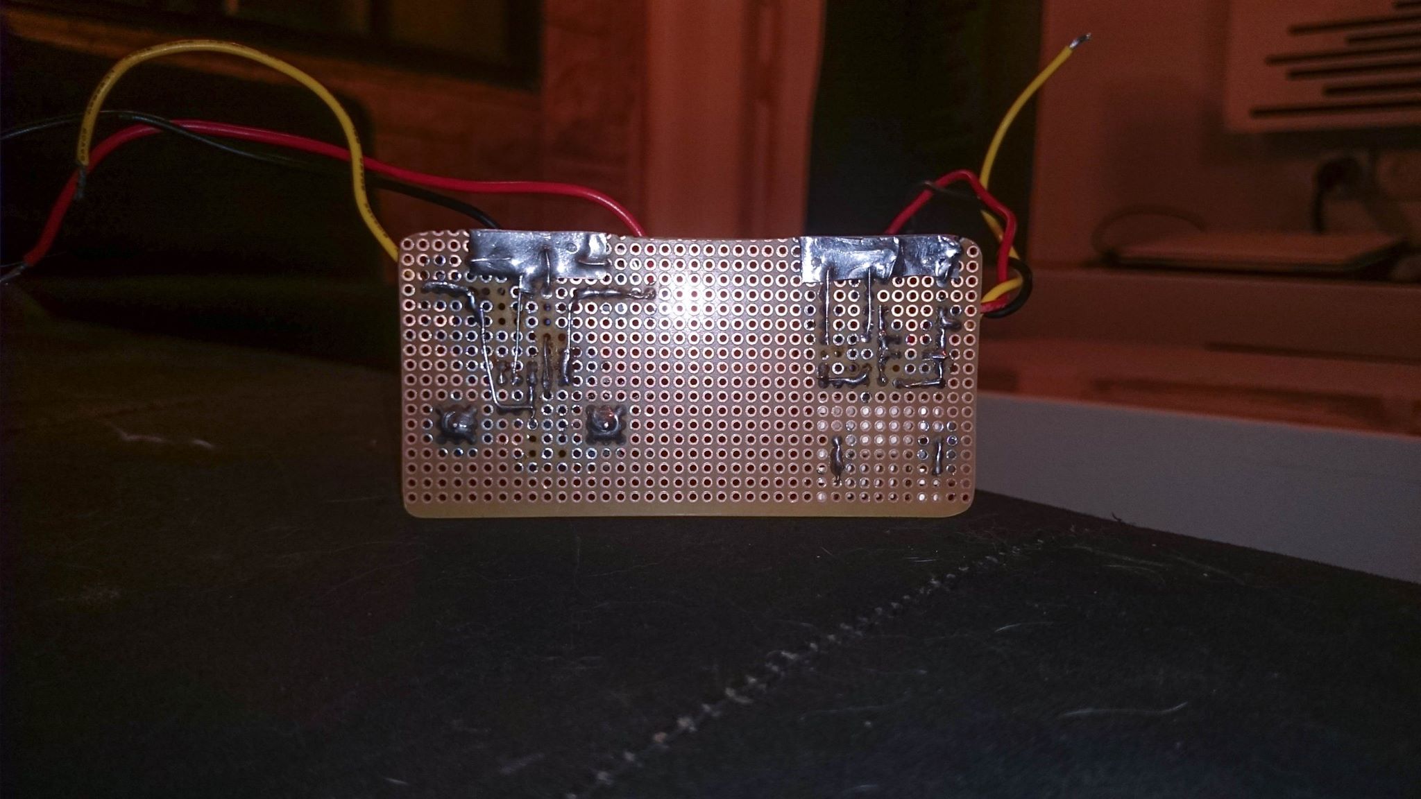

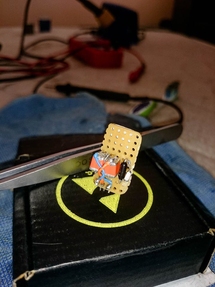

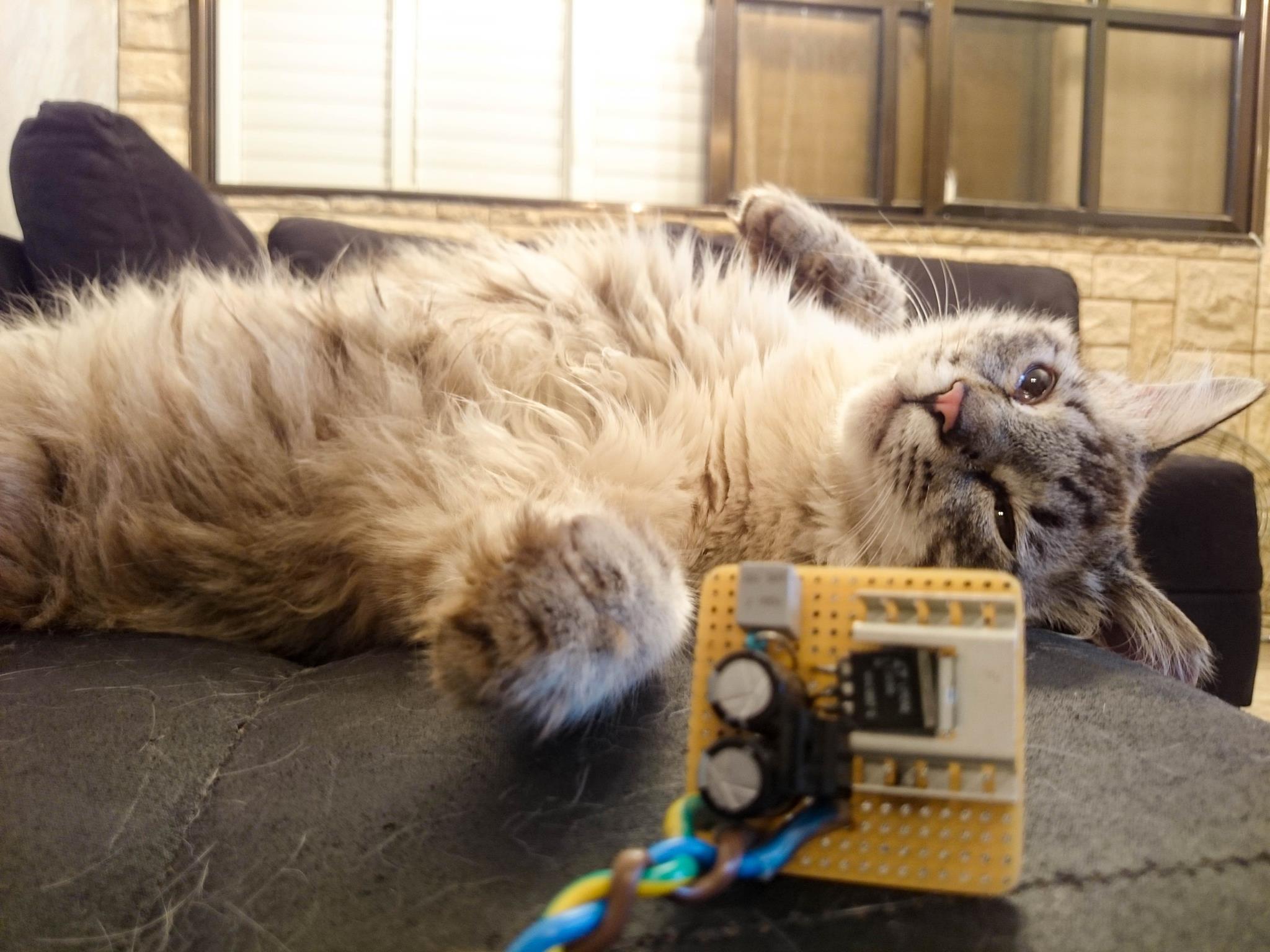

A prototype of 5V Voltage Regulators thet I built now
Based on the LT3088
For a DAC

ready
now
Just left to Test
The performance

Works perfectly
Success clean and stable voltage 4.97V

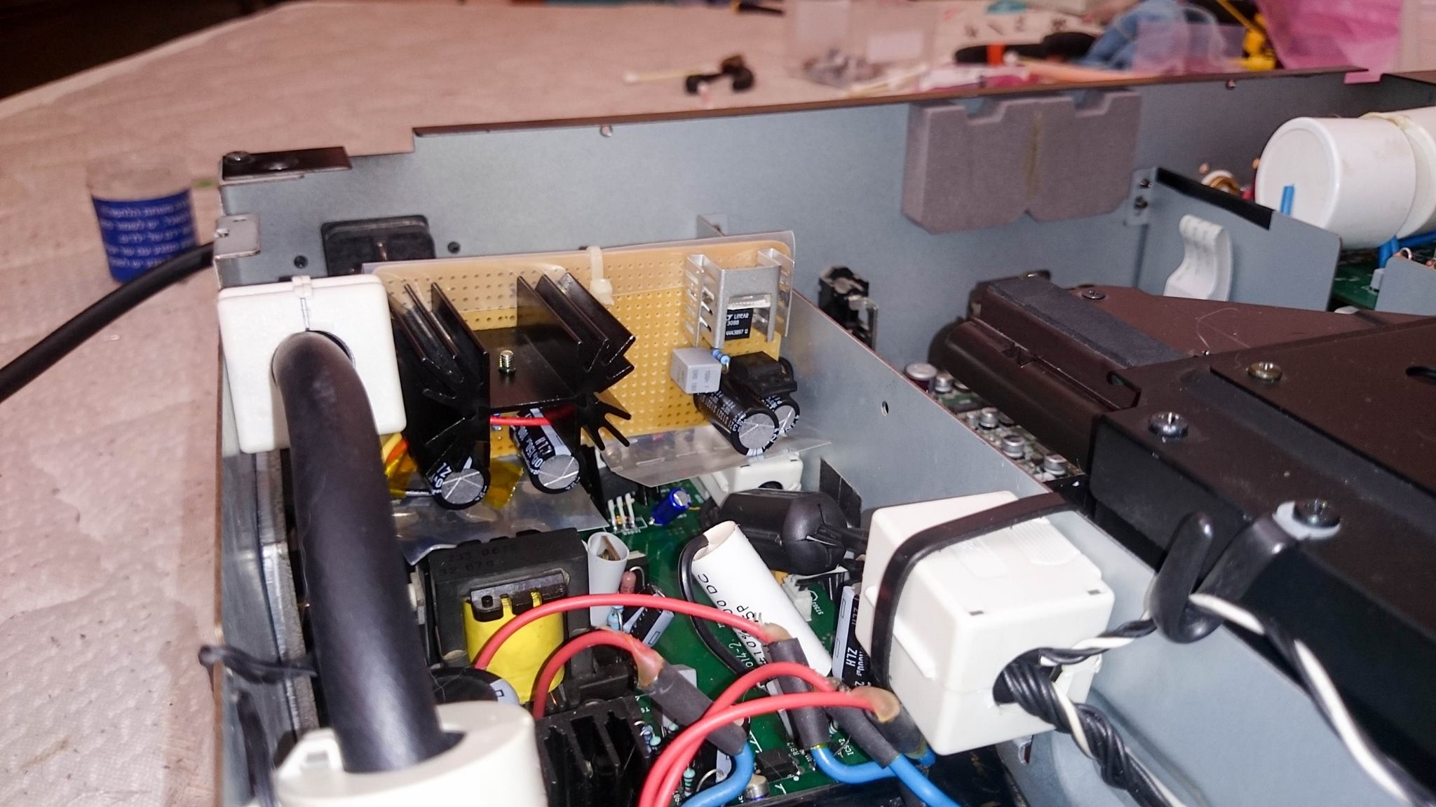

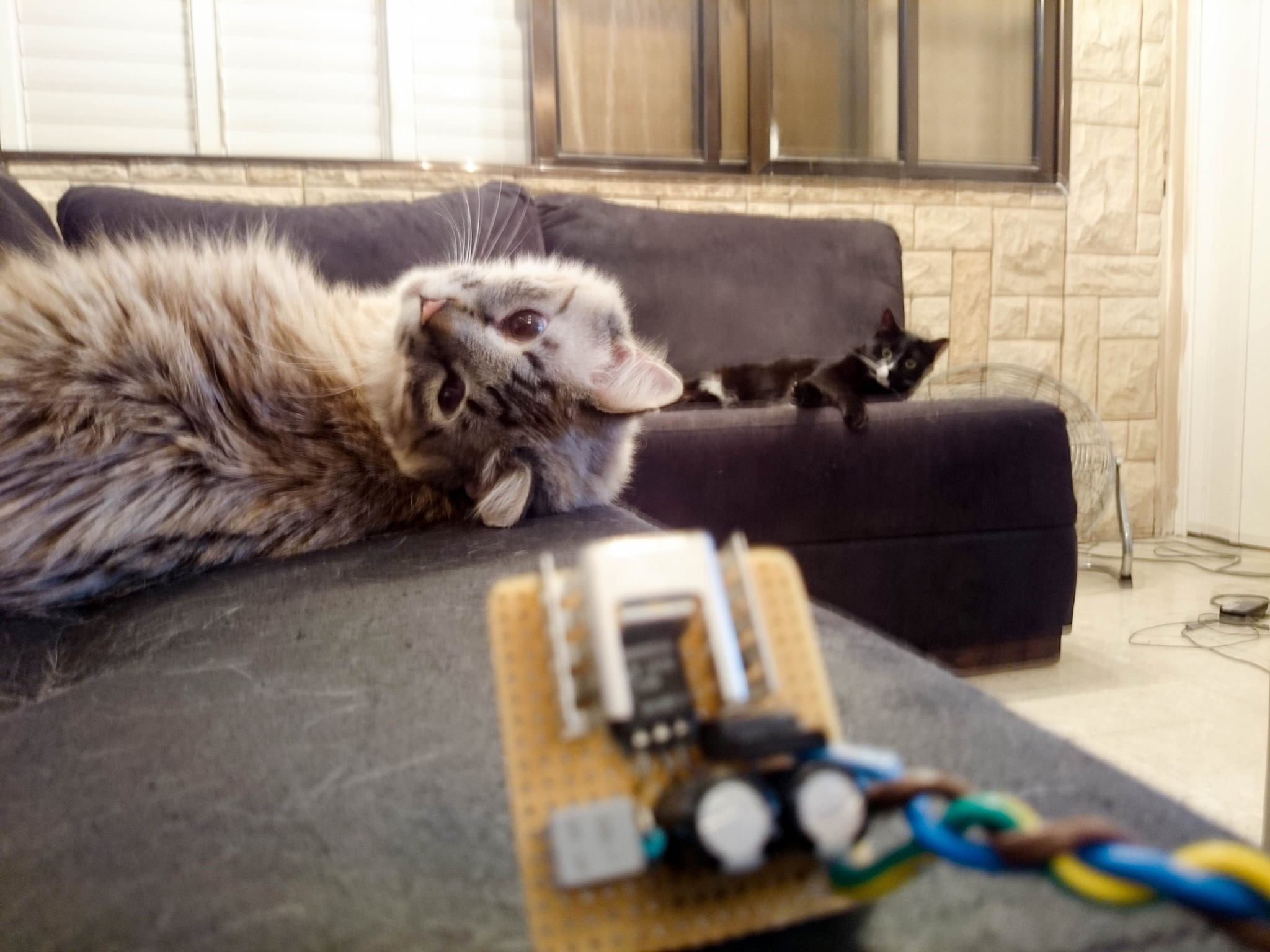

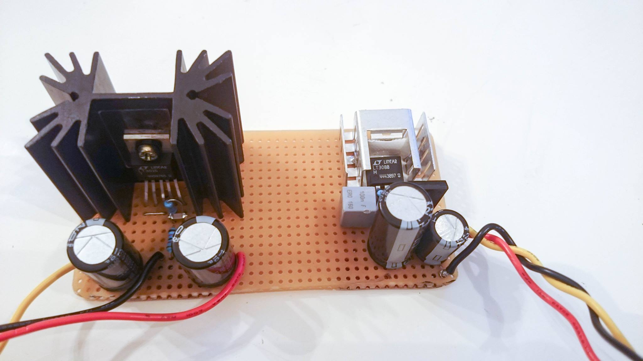

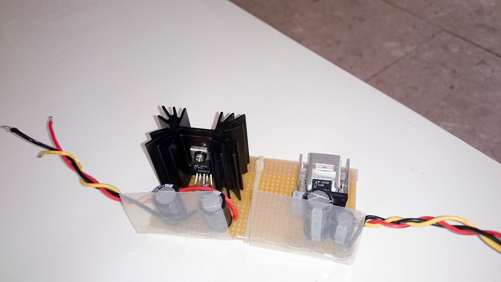

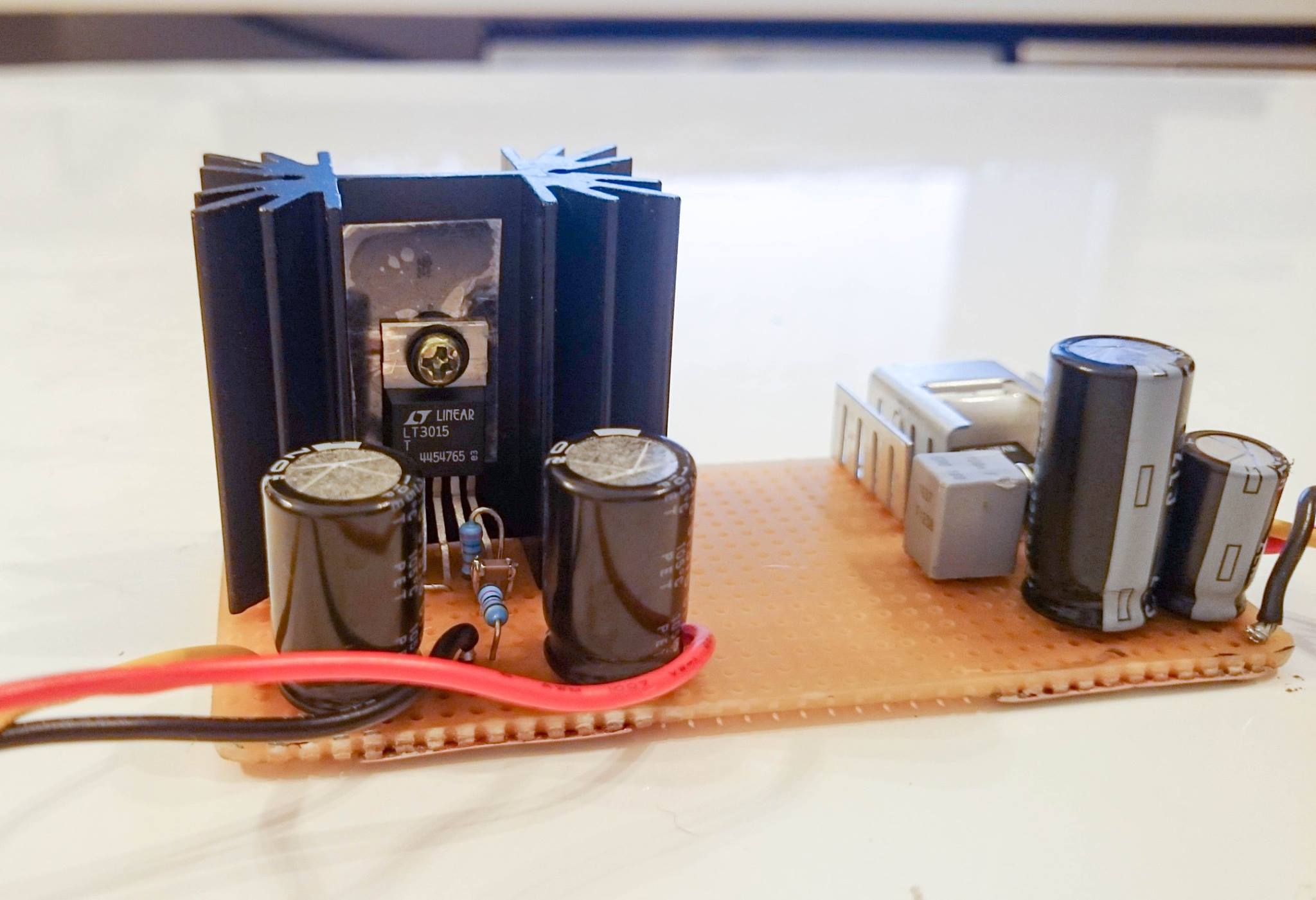

PSU I created based on
the Voltage Regulators
LT3088
LT3015

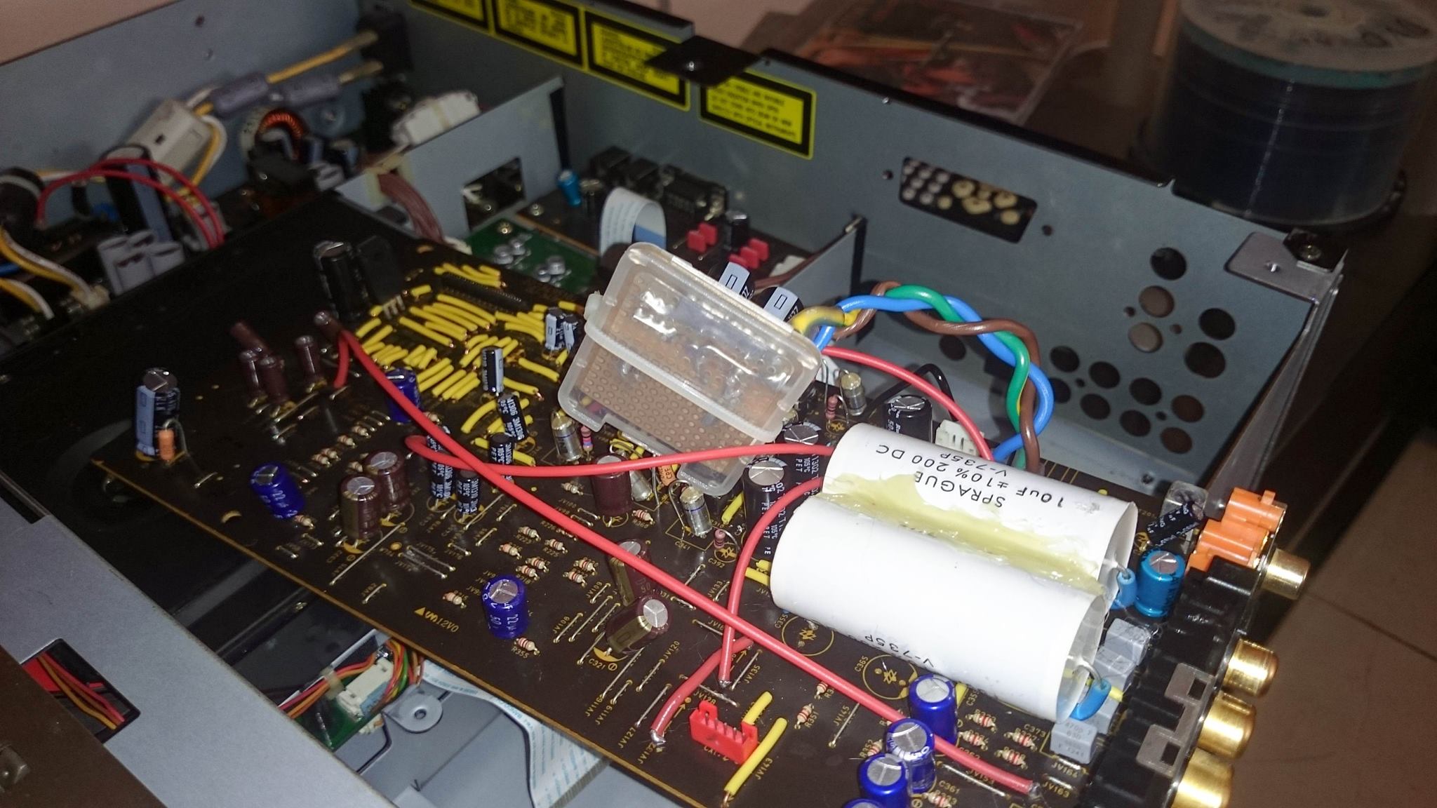

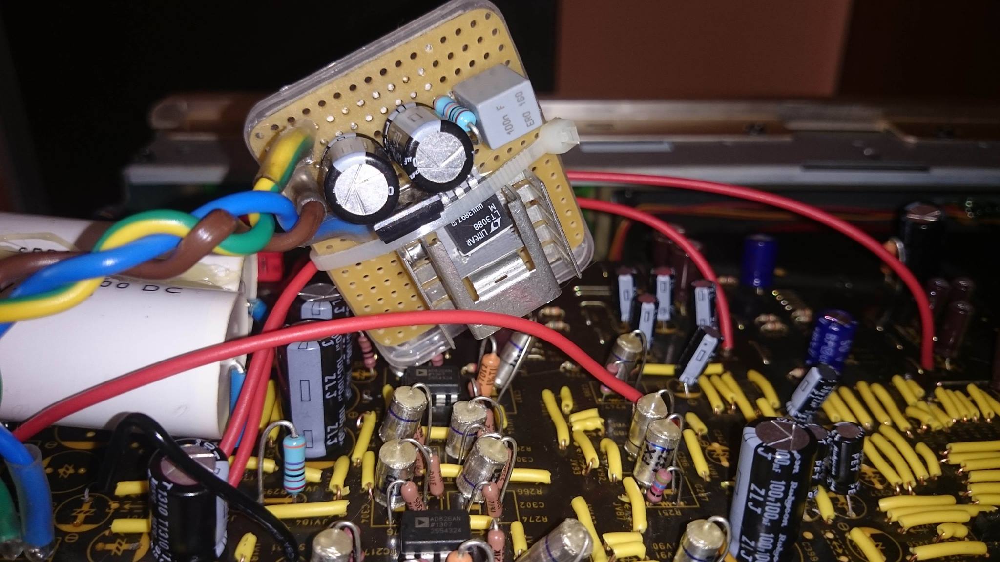

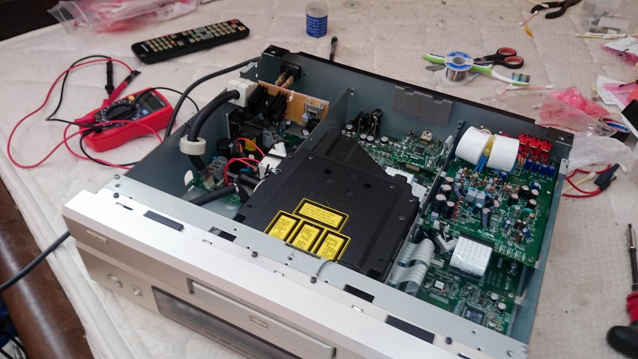

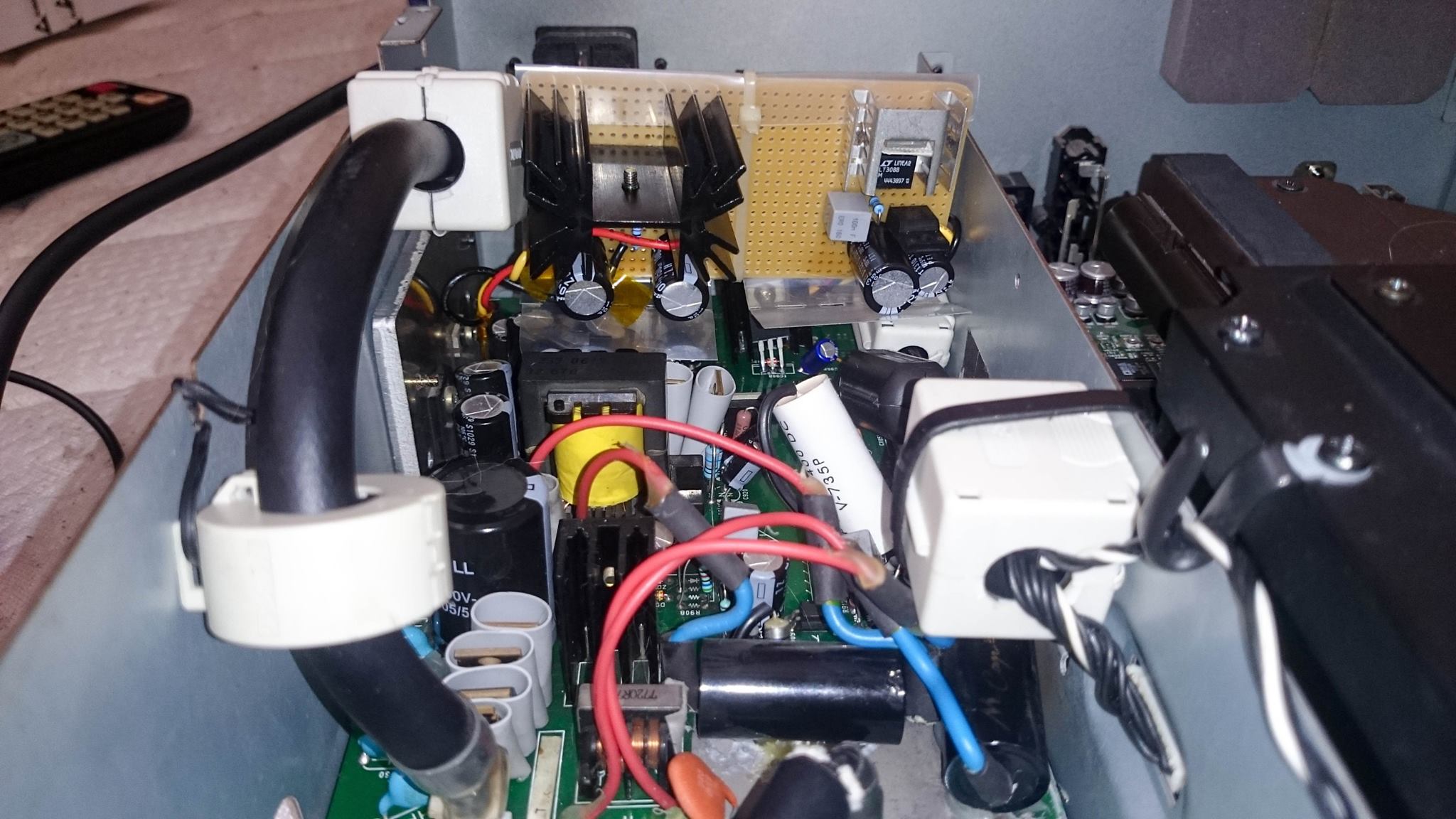

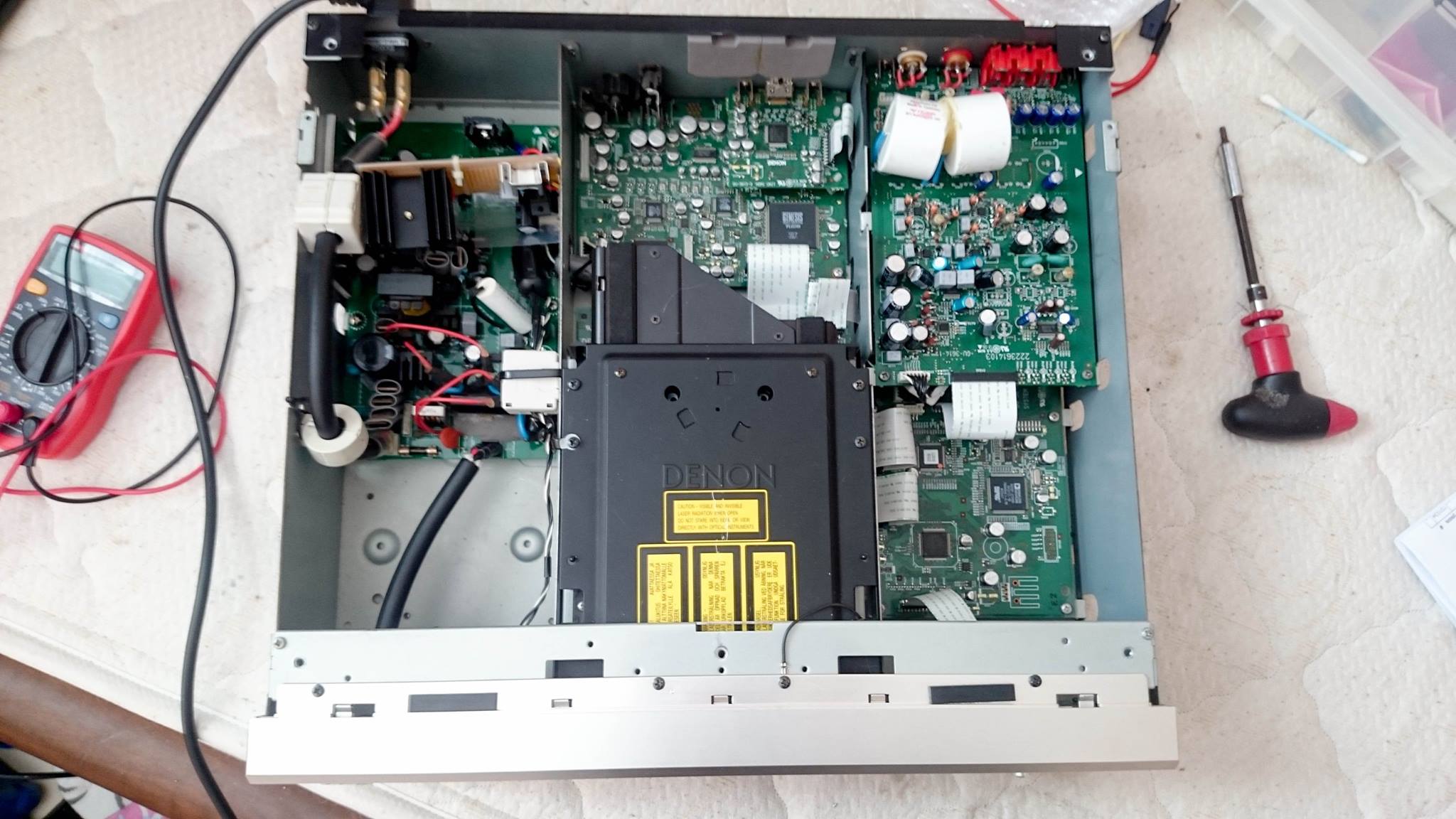

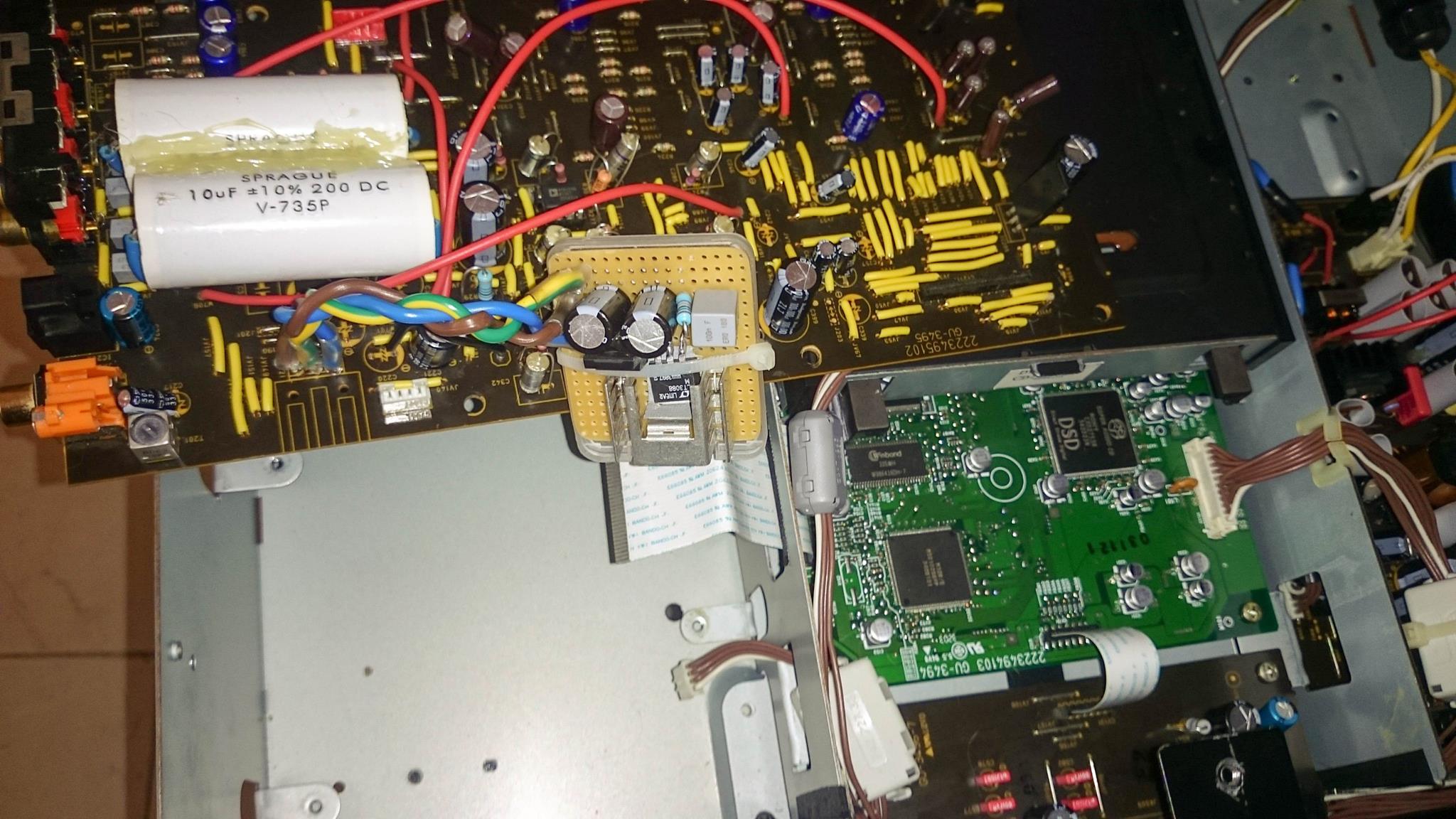

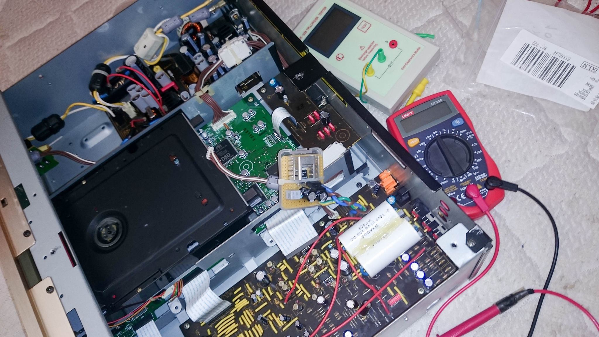

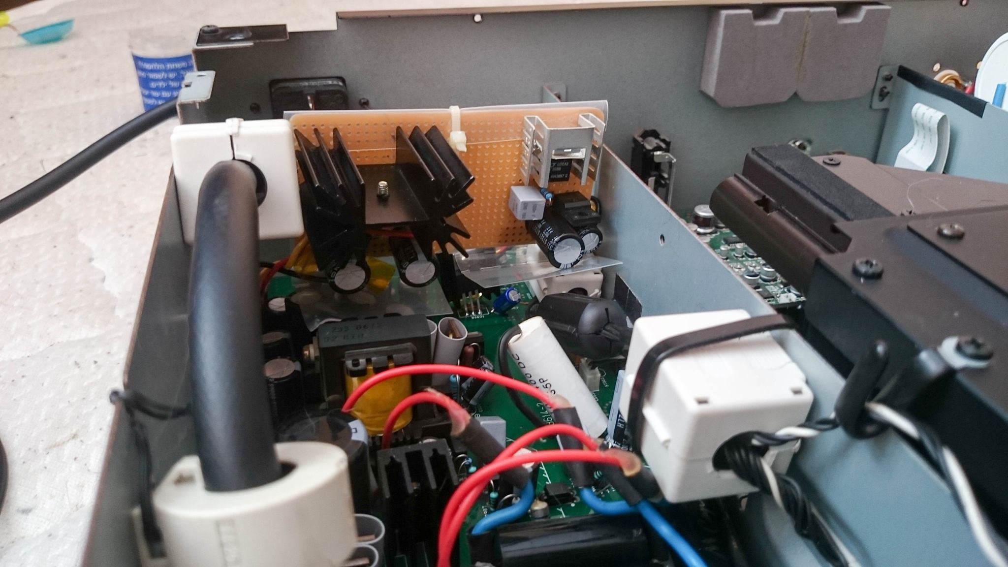

My review On the
LT3088
LT3015
After the conecting the power supplie
9+
9-
thet i build
To Denon 3910 I can say that the LT3088 and LT3015 Voltage Regulators are the best I've encountered .
They simply amazing.
After connecting the circuit in Denon I put a CD of Norah Jones And wow.. the bass is so accurately almost did not recognize my amp BMC AUDIO CS2
The separation has risen to another level
i Did not expect to such a change for the better
That the DENON before sounds awesome.
All voltage regulators That experimented with them
This pair is different level
Simply Recommended 🙂

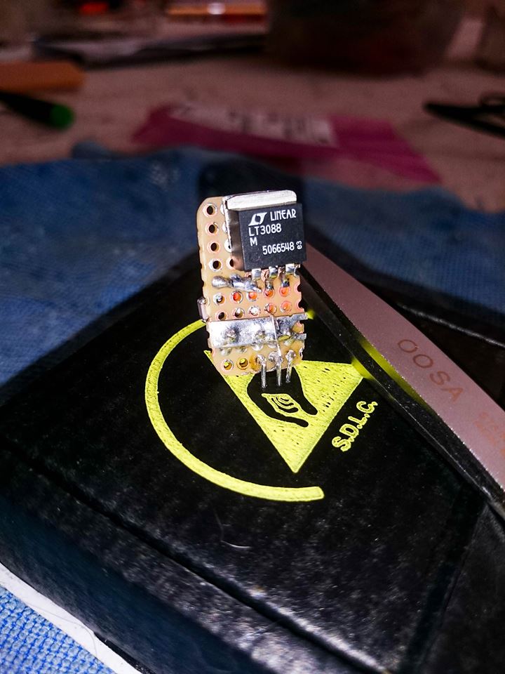

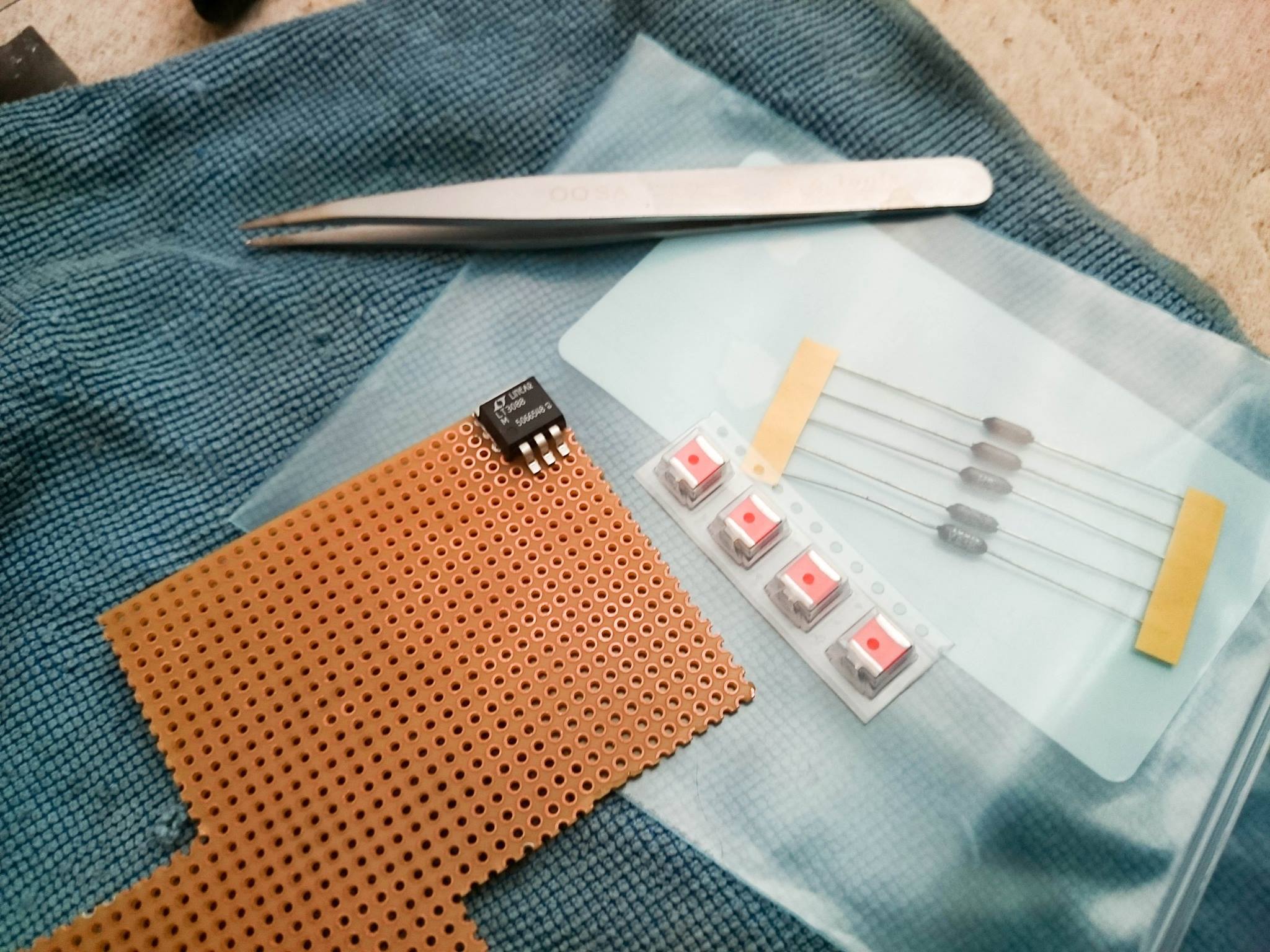

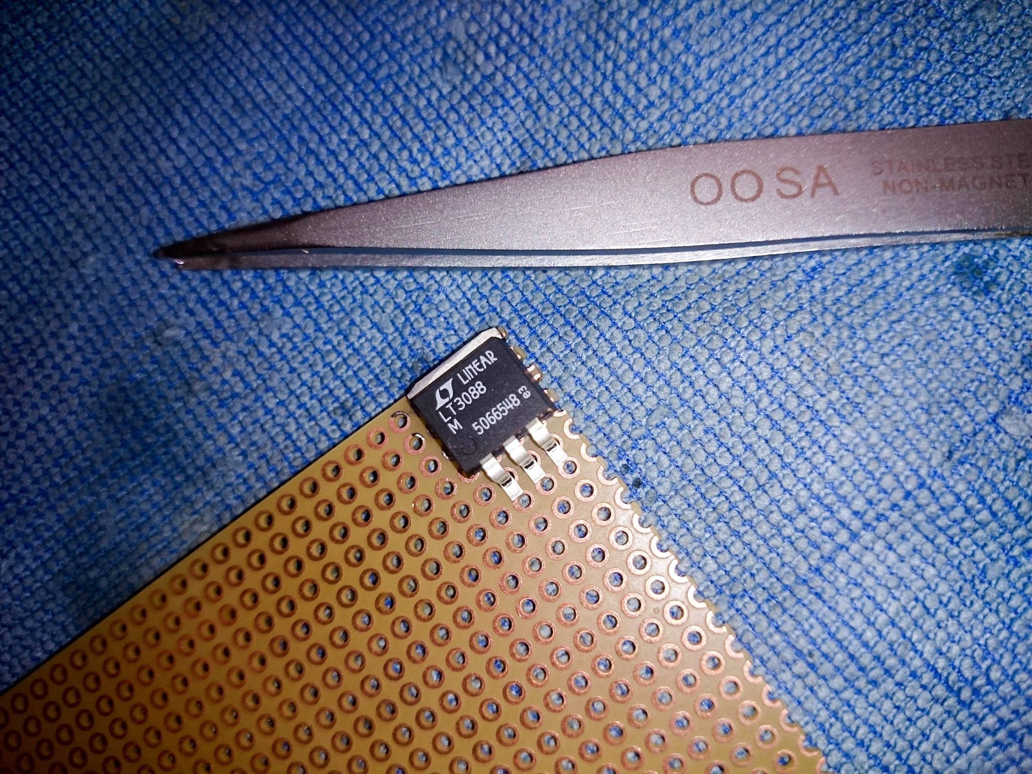

LT3088 5V
parts list
2 vishay Solid Tantalum Chip Capacitors, TANTAMOUNT™,
Ultra-Low ESR, Conformal Coated, Maximum CV
597D107X0040H2T
1 c0g cap 100n 50v tdk
CGA5L2C0G1H104J160AA
1 resistor 0.1% 100K TE
H8100KBYA

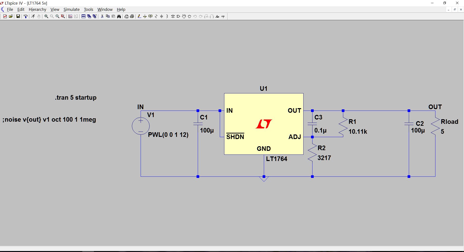

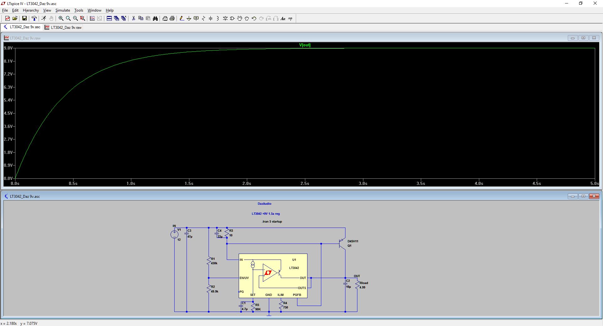

When building a 23.3V regulator for my phono preamp, using Rset=470k and bypass Cset=1µ (for reducing noise) I needed some time to find out that for stability an output capacitor is needed (I used 100n).
The datasheet says on page 12 "The LT3088 does not require an output capacitor for stability", but this seems to be true only when when Cset is zero.
Gerhard
Gerhard
i use on the lt3088
Cset =100nf c0g/np0 tdk - or- vishay film cap 1837 100nf
Cout = 100uf vishay Solid Tantalum Chip Capacitors, TANTAMOUNT™
Cset 1uf is to big 10 time slower
Be careful from Output load
If you do not have the minimum load on the lt3088 its go out of regulation
