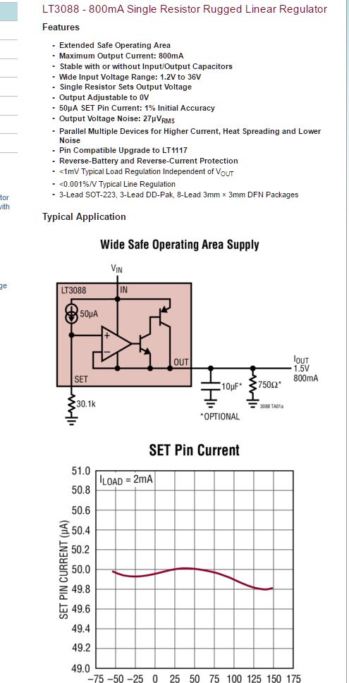

Does anyone here use
New voltage regulators lt3088 from LINEAR TECHNOLOGY
Low noise 27UV
One resistor sets the output voltage
3pin SOT-223
and no expensive 4 $ in farnell
I'll buy a few units
Sounds very good deal
( One thing bothers the Ripple Rejection in 1mhz is 20DB Not the best standard in our day )

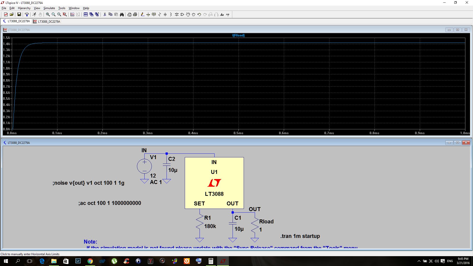

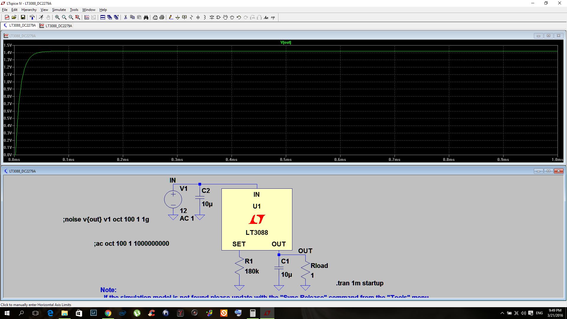

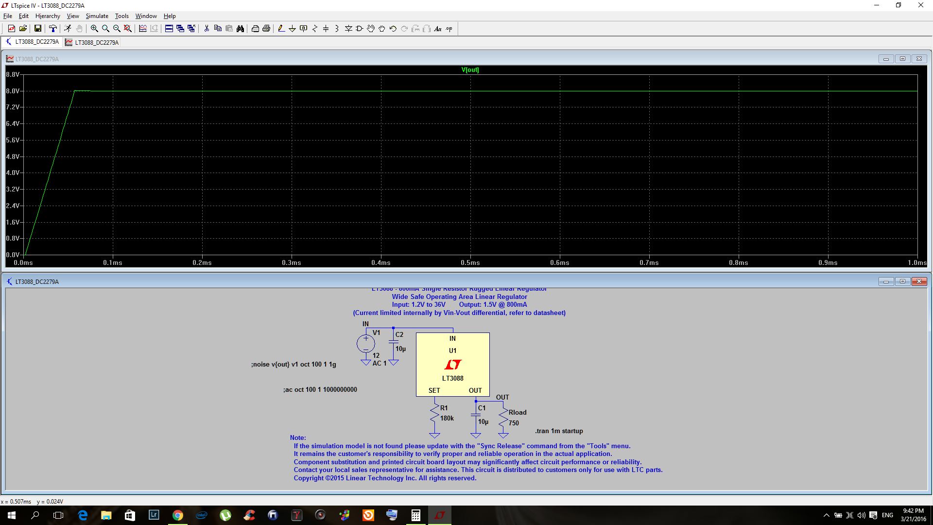

I did a simulation in LTSPICE
outpute 9V volt
Rset = 180K
you need minimum of 2 mA on the output - R loud
no loud -no reg

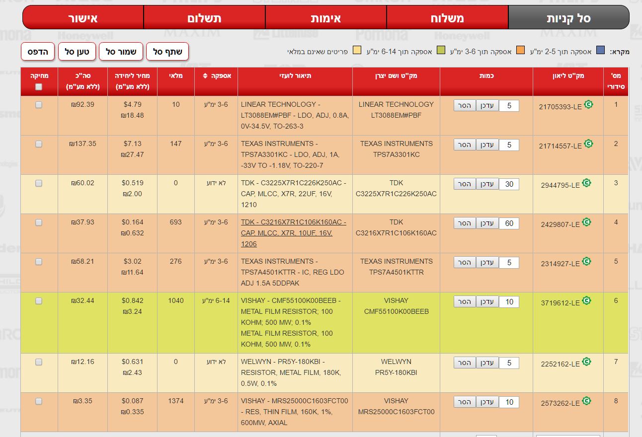

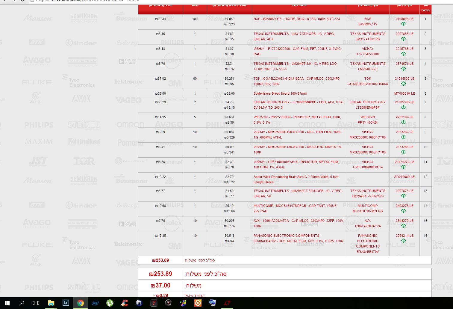

I'll buy the whole list and do experiments in building voltage regulators with several different types
LT3088 (I probably use it a constant current lm334 on the outpute of the lt3088 )
TPS7A3301KC
TPS7A4501KTTR
9+
9
8+
8
5+
5
3.3+
It's a shame
I did not find for sale Resistors 160K 0.1%
Only 1%
All resistors small values
I already have

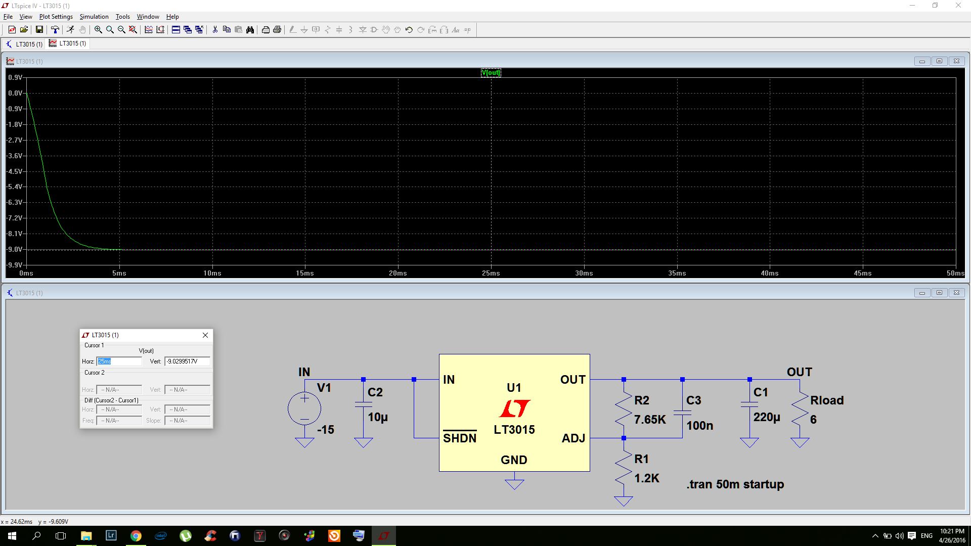

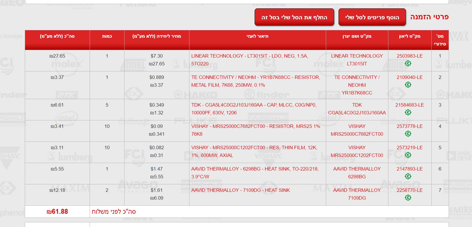

I must ask you a question?
I ordered the LT3088
And a multitude of components
Especially also ordered C0G capacitors TDK 100NF
60 units

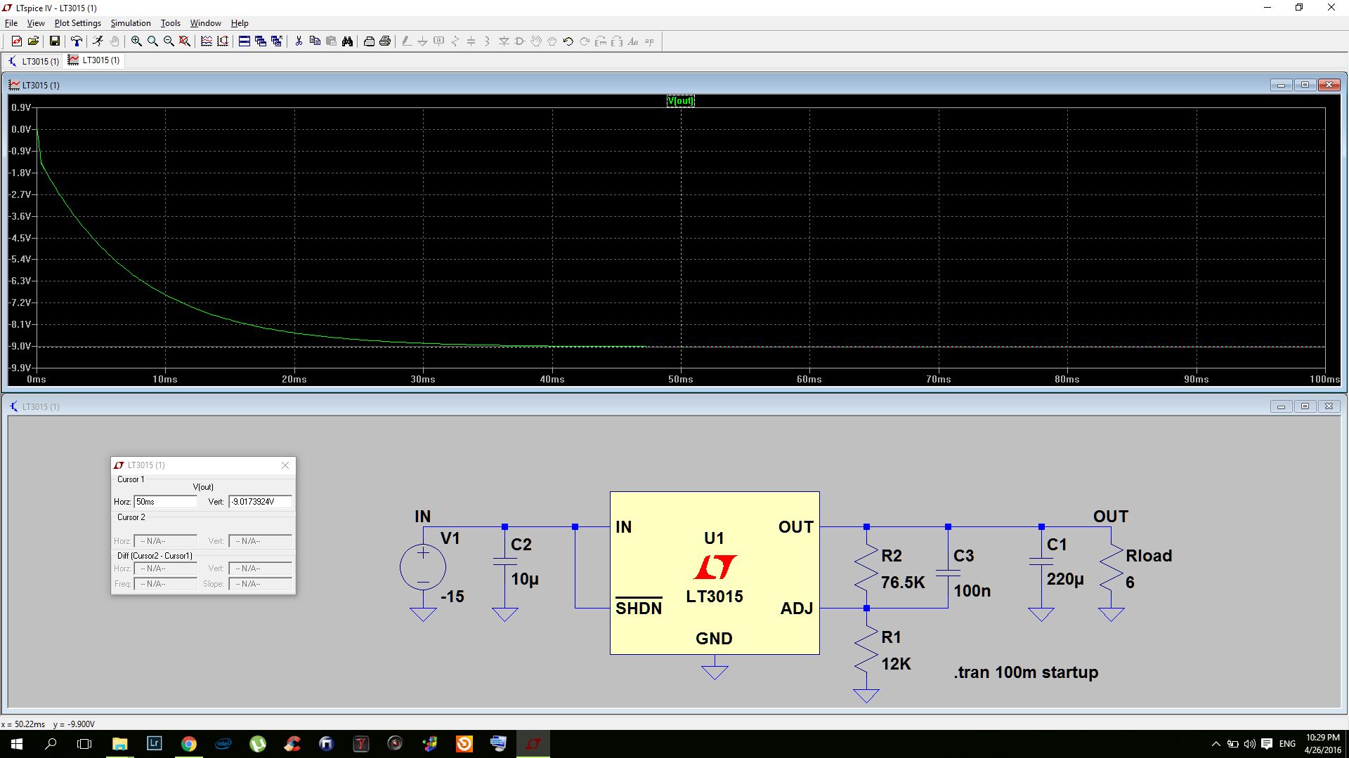

Now I would like to order the LT3015
It will be used to -9V
I must decide on the values of resistors
How low I can go down
I go on
R1 -1.2K
R2-7.65K
I want to go for low values Because that the Cadj
Will 100NF -C0G / NP0
If the value of the resistors R1 will be as they are written in the table 12K
This slows down the start-up time significantly.
I must decide on the resistor values today
because of
I opened a large order in FARNELL
And I did not put the LT3015 yet
dazzz - hey I'm sorry about the delayed reply, I hadn't subscribed to this thread. I'm just now circling back to do a post in another thread here and saw your questions.
For the LT3015 (and for the LT3080) I actually use a through-hole film capacitor for the set resistor bypass and a solid polymer organic electrolytic for the output capacitor.
For the bypass capacitor I used a 0.082uF 50V Kemet MMK5823K50J01L16.5TR16 at Mouser, $0.45. I believe my thinking there was that I couldn't get 0.082uF in C0G/NPO ceramic, just X7R, so I went with film. I would be a little hestiant I think with X7R ceramic in this particular application. The capacitance might wind up voltage-modulated a bit. Then again if your rails are 9V and the capacitor is rated at 50V (or 100V) that effect should be minimal, at least with X7R.
You should be OK with 100nF. As I recall I considered that since it was a more common value, but there was some formula in the datasheet and 0.082uF was all I needed. Since I was using film the 0.082uF was a bit smaller I seem to recall than the 0.1uF.
On the output a X7R should work just fine, although I would double whatever they say the minimum is. So if they are suggesting 2.2uF I would go with 4.7uF given that it is X7R. In my case though I used the solid organic polymer electro. They are small and all have low specified ESRs. I used the 22uF 35V 35SEPF22M at Mouser which specifies a 35mR = 0.035 ohm ESR, for $1.05. Those solid organic polymer caps have huge leakage current, so they wouldn't be the best for battery powered. A smaller X7R ceramic would probably be better. My gizmo is AC powered so it didn't matter.
For R1 (adjust to ground) I'm using 2.55K and for R2 24.9K in series with 30.1 ohms. I put the 30.1R in there as a fine-adjustment resistor.

You are right about the set resistor bypass capacitors, they do cause a startup delay! Defnitely has to be taken into account for your project. For my project is doesn't matter because there is a headphone relay on the output with a 3 second delay for this very reason. It doesn't matter if the two power rails don't exactly track on startup, the headphones are not connected until everything is stable. Your 1.2K and 7.65K should be OK. As I recall there was a minimum load issue with the LT3015 and my values were meeting the minimum load. Since your values are even smaller you should be fine.

Thanks for the reply bro
Yesterday I made a order on the LT3015
I almost ordered the LT3091
But it requires a little more components
The LT3015 will be an excellent partner for LT3088
I also ordered a good heat sink
to Match the
T0-220
TO-263

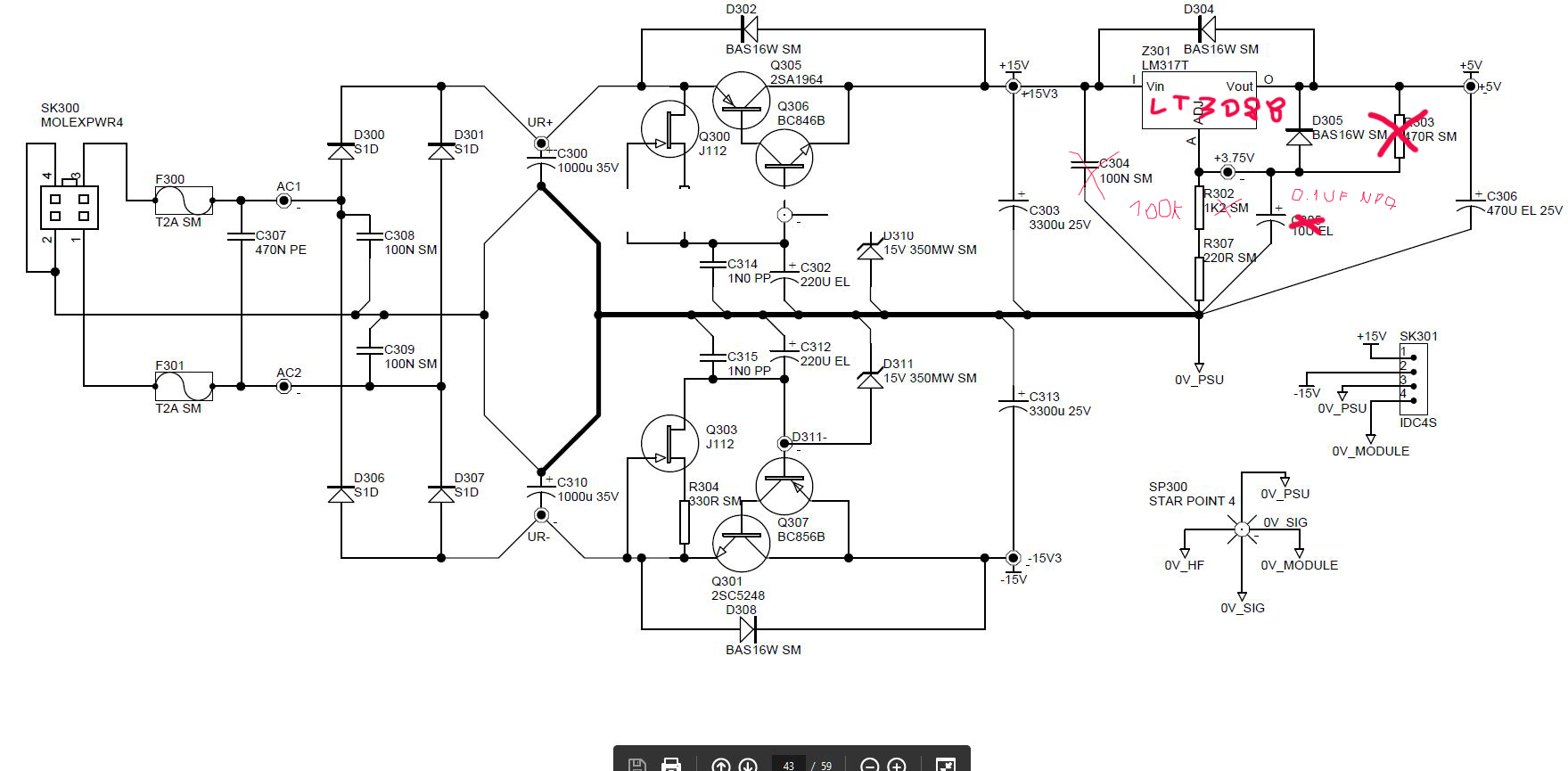

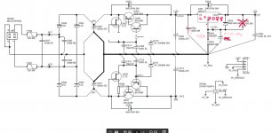

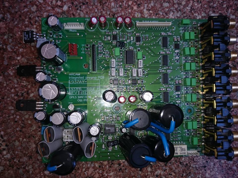

I'm going to use LT3088
As a substitute for LM317
In the psu Preamp project on the ARCAM FMJ32
I only hope that will be enough 800ma
Since the LM317 is 1.5A

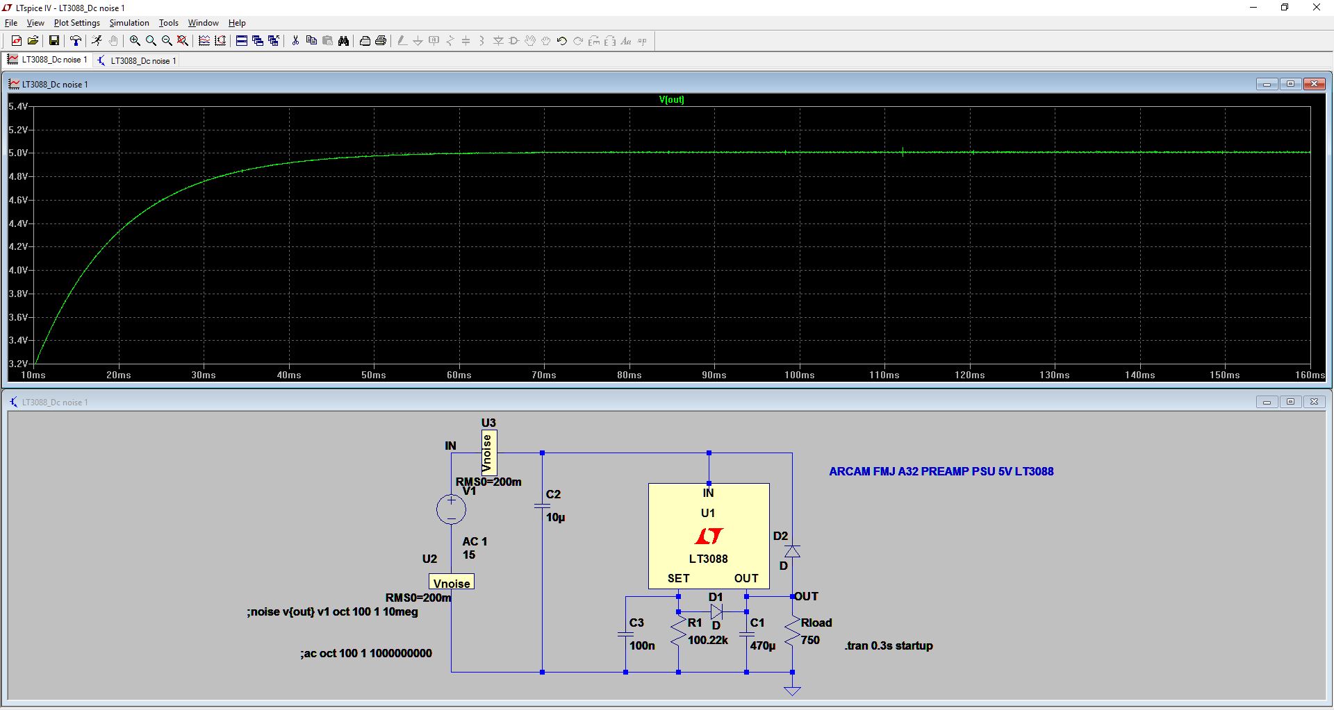

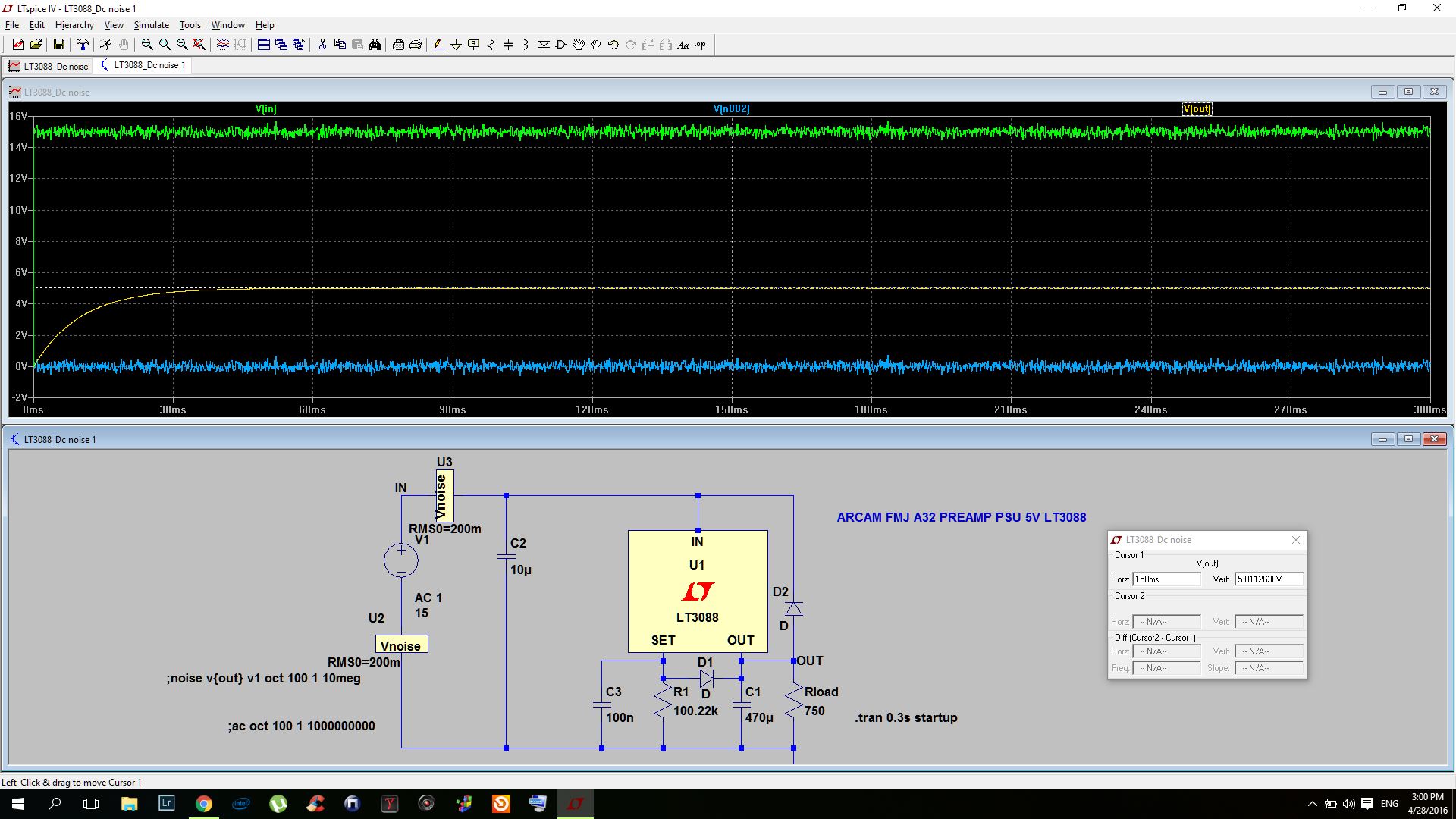

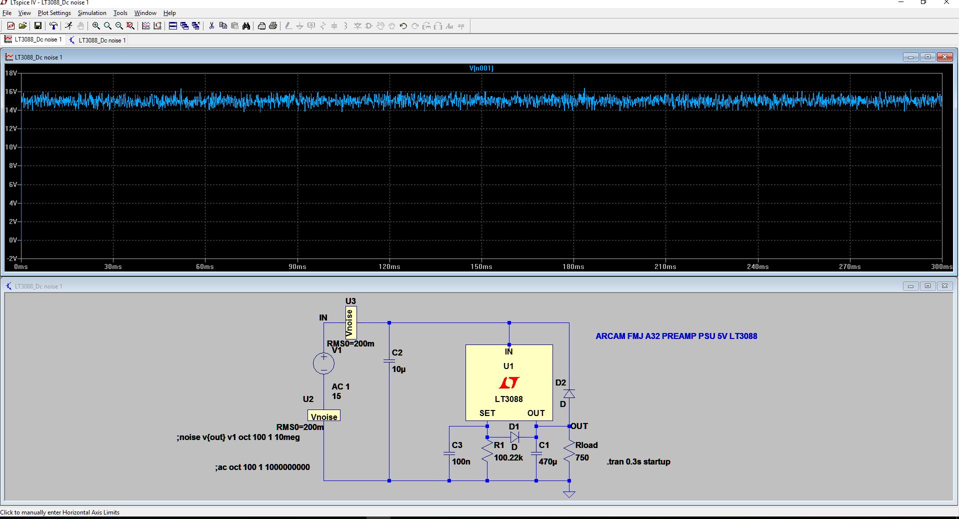

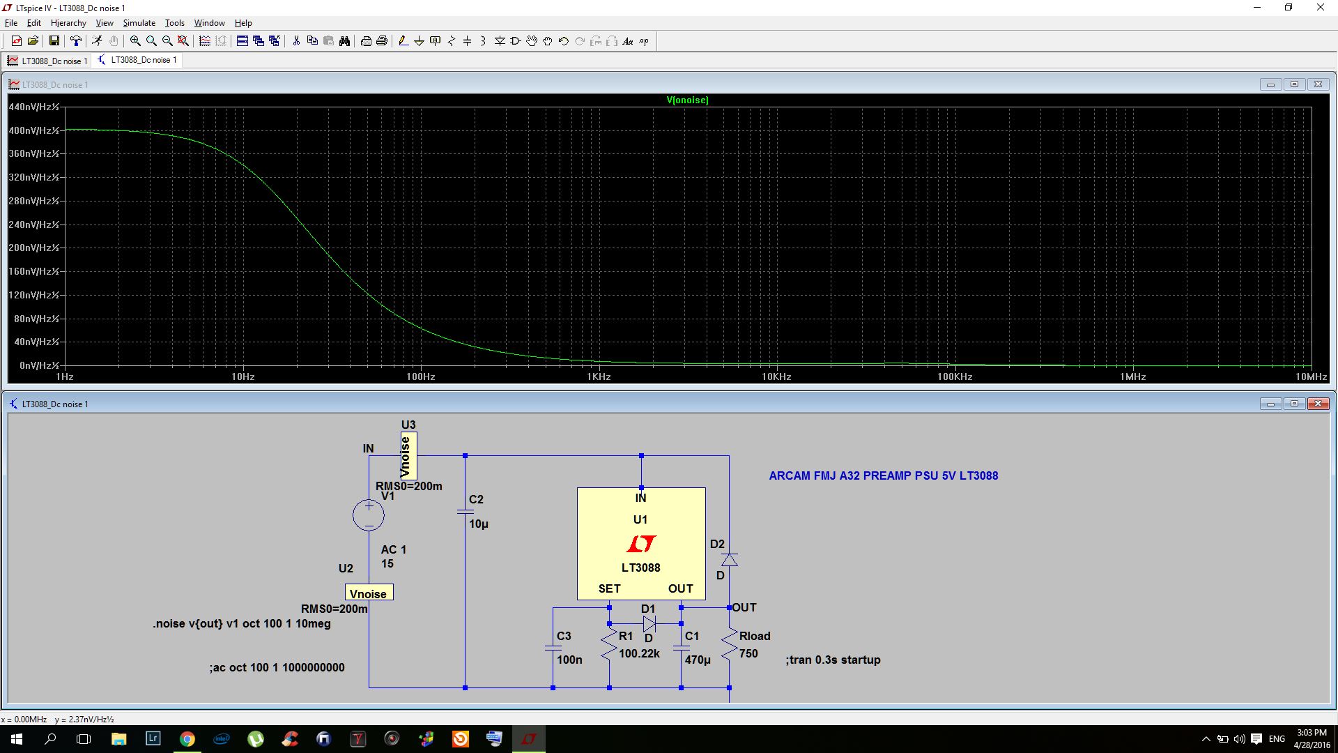

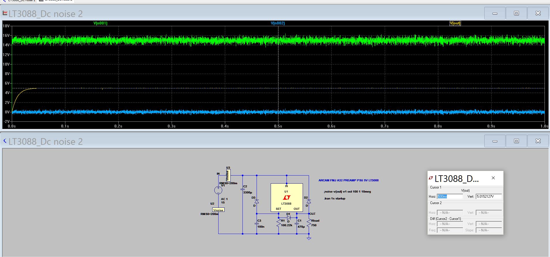

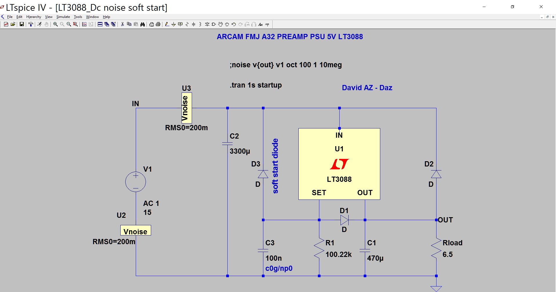

LTSPICE NOISE TEST FOR THE ARCAM 5V REG LT3088
INPUT 15V 400mv ripple noise
  • LT3088_Dc noise 1.asc
If you have the space two of those 3088's can be paralleled for more current. The 3080 is the same way, allows several in parallel for more current or power dissipation spreading.

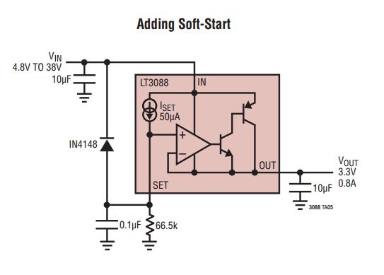

agdr what you Think
This idea to add soft start diode ?
  • LT3088_Dc noise soft start.asc

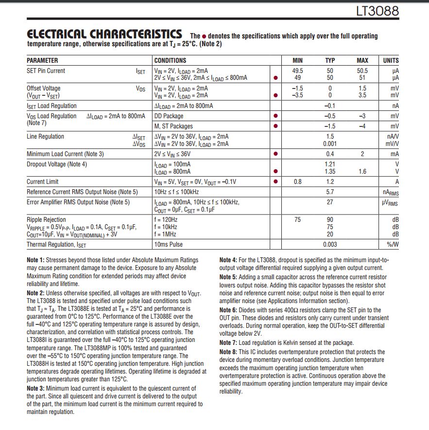

minimum load
First experience with the LT3088
Such was not successful
I replaced the preamp my project ARCAME FMJ32
The regulator provides a voltage of 5 V
Digital volume
And display.
(I changed the LM317)
The resistor in ADJ switched to 100K
the cap in Cadj switched film capacitors 100NF vishay 1837
Output voltage 4.93 V
But as soon as I turn the volume knob voltage falls to 3 volt
So a tip to keep minimal Output load would be helpful
for naw I returned to the familiar LM317
