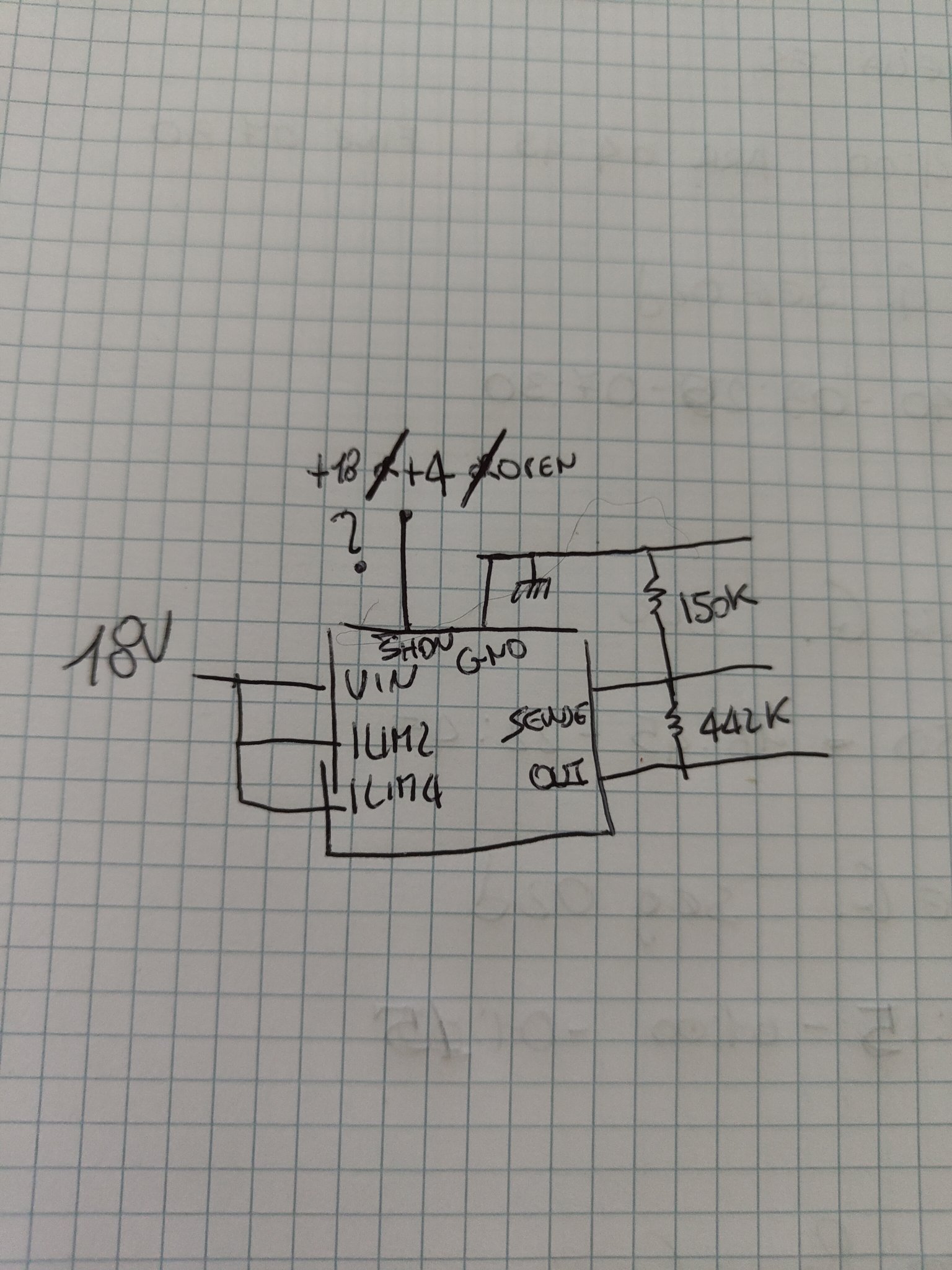

I'm trying to make the lt1175 regulator work but it always comes out and only a voltage of 0.25 .... I connected the shdn to -vcc then to -4v left open and yet it doesn't work, am I doing something wrong? I send you the wiring diagram

Is it a fixed 5V (LT1175-5) or an adjustable (LT1175)?
If it is a fixed one, the resistors set output voltage to -20V which cannot work. If it is an adjustable, output voltage is set to -15V.
Which output voltage do you expect ?
According to datasheet :
You have to install an output capacitor; ie. a 10uF ecap and also an input one not less then 33uF ecap, good quality one.
Shtdn should left open, this will enable the regulator.
