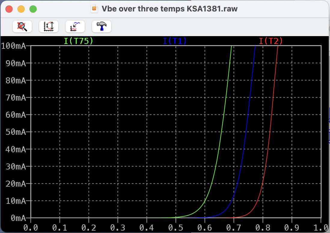

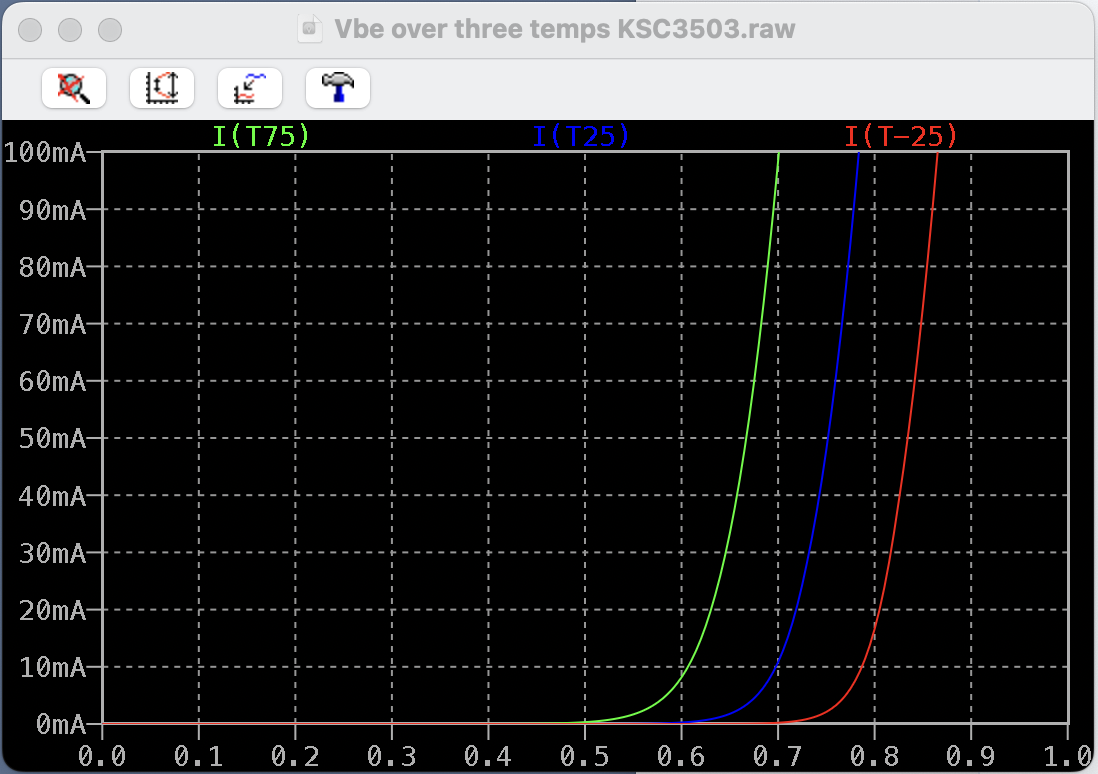

I made some Vbe plots using an EG of 1.15 for both devices. These look correct in shape, but are off a bit still. It could be a function of device variations? These should be comparable in format to the data sheet. The current polarity is upside down for the PNP transistor. I couldn't figure out how to get the curves to go left to right and bottom to top with negative values.
You're right, EG should be 1.15 for the KSC3503 as well. Don't worry about the simulated curves not being exactly the same as the ones in the datasheet: on the one hand, curves shown on a datasheet are either an average of a number of samples or correspond to a single sample that the manufacturer took as representative, so there will always be variation between an actual sample and the datasheet, and on the other hand, Spice models, complex as they are, are only a mathematical approximation of a much more complex physical device, so getting as close as possible to the measured and/or datasheet curves, even if you can't get a perfect match, is the best you can do.

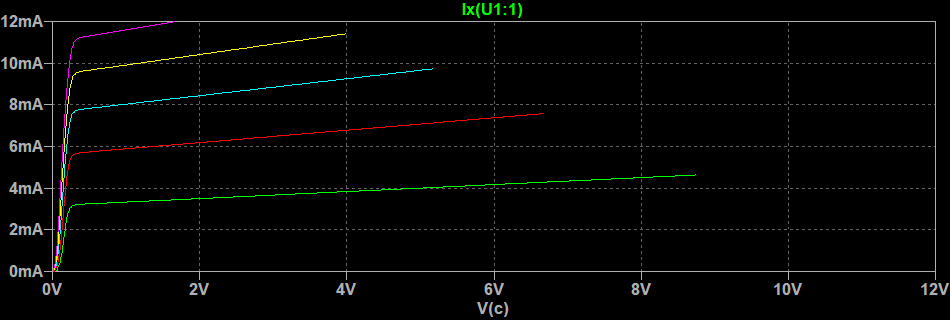

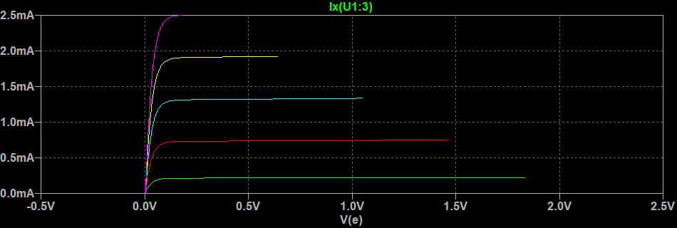

I've just looked at the PZTA42, it doesn't look good. These are the forward and reverse curves with my model, simulated vs. measured:
And this is what I get with Nexperia's model, same set of forward and reverse Ib values, same X and Y axis scale:
Actually the reverse one doesn't look so bad, but the forward doesn't even show quasi-saturation and the Early effect is way too much. I don't know why they would try to model these effects by using a sub-circuit with additional components (the standard Spice NPN model already has parameters to model all that), but it looks like they didn't quite succeed...
