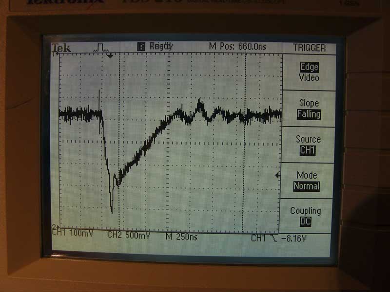

Transient response test update
Using my load switch i was able to successfully test the transient response of my prototype power supply.
I used a 0.33 amp load and looked at the effect of swapping output capacitors - 10uf and 1500uf (both panasonic FC).
Left scope pic - 10 uf (500 mv/div, 500 ns/div)
Middle scope pic - 1500 uf (500 mv/div, 500 ns/div)
Right scope pic - 1500 uf (500 mv/div, 100 ns/div)
Below is a Figure from:
http://www.linear.com/pc/downloadDocument.do?navId=H0,C1,C1003,C1142,C1041,P1754,D17358
that explains the transient response profile. The 10uF cap transient response seems well matched to the representative profile, but, the the 1500uf does not.
Also, the duration of the transient response is consistent with those reported in the above article, but the amplitude is significantly greater. I don't have an explanation for for the difference in transient amplitude. Things may improve when i move from the prototype board to the circuit board. It could also be that i was not measuring directly from the output pin of the regulator. I expect that the test conditions were better optimized in the linear article.
Note** The load switch takes less than 20 ns to switch. I may try to improve the switching time with the use of a faster transistor.
LT1033 vs LM337 transient response
today i compared the transient response of the LT1033 to the LM337.
i also tried 3 different output capacitors but the results were consistent across the different cap types so i am only showing scope pics with the 10uf panasonic FC output cap.
The transient response of the regulators was very similar. The peak voltage deflection of the LM337 was always a bit smaller than the LT1033 - about 10%. However the time to settle was longer with LM337 than the LT1033 - about 20%.
I did not look at the variability in transient response across regulators of the same type so i am not sure if these small differences will hold.
Take home message- LT1033 and LM337 have a very similar transient response.
here is the scope pic of the LM337 transient response to the same load as in previous post (note the wobble as the voltage returns to the set point):
here is a scope pic of the LT1033 transient response (note the relatively reduced amplitude wobble as the voltage returns to the set point)

regulator variability
Tonight i compared the transient response variability of the LT1033 and the LM337
LT1033 = 281 +/- 1.09 mV, n=10
LM337 = 281 +/- 2.67 mV, n=6
i'd call that an identical response, but the lm337 is more variable.
this variability was also reflected in Vreg. i frequently had to adjust the vertical position on the scope with each lm337 to keep the transient response on screen. I only had to do this only once with the LT1033.
