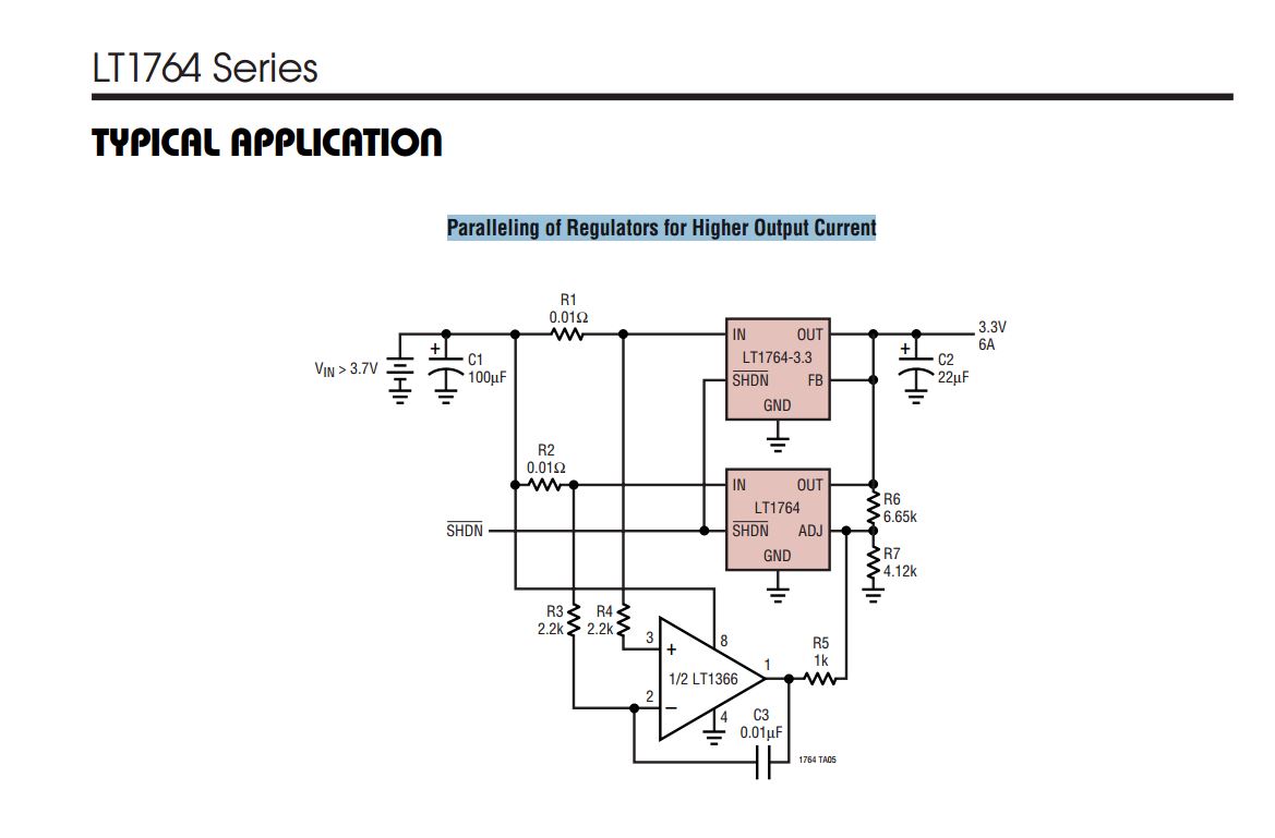

Evidently the Linear Technology LT 1083 regulator is no longer being manufactured. Has anyone found a viable substitute that will handle 7.5 amps of current?
Paralleling 2 LT1764 (3A) Regulators and you get 6A Output Current

Well, I'm looking for something for a higher volt application (power amp)---35 volts, 6 amps would do.

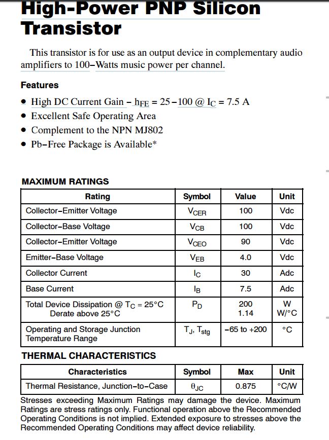

I do not know 5A is enough for your requirements.
if So you can use the LT3080 + High-Power PNP transistor
And you have Voltage Regulators up to 36V
With 5A output current
Best regards David az

There is no reason why this circuit cannot be modified to give more than 5A. Paralleling the pass transistors with separate emitter resistors to enforce sharing.
These boosted regulators do require care with stability and are sensitive to output capacitor ESR
